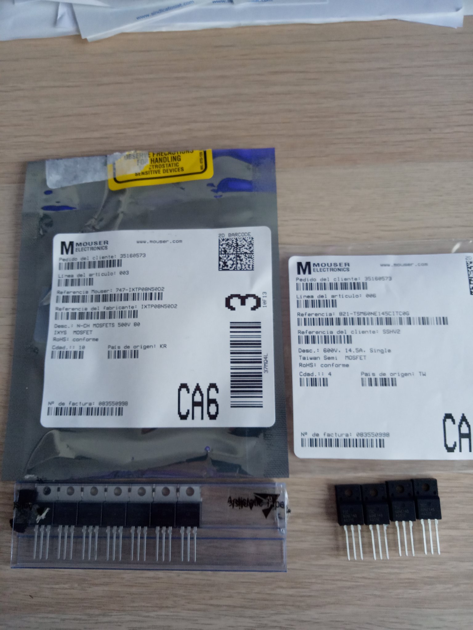

Well changed at SSHV2 the two cascode CCS Q1 & Q2 for IXTP08N50D2 and Q3 SIHP8N50-D-G3 for TSM60NE145CIT COG, also made a couple of cascode CCS as load with IXTP08N50D2.
SSHV2 sett to 60mA because each cascode CCS set to 20mA, difference between Vin & Vout 20V.
All is working and measuring OK but the SQ is very bad compared vs a resistor as load, sounds very thin without bass & mids, so still something not good to use SSHV2 together cascode CCS with DHT with filament bias resistor.

Nice that it electrically works with all those different semiconductor types. Especially Q3 being a fully plastic encapsulated type is good for safety.
