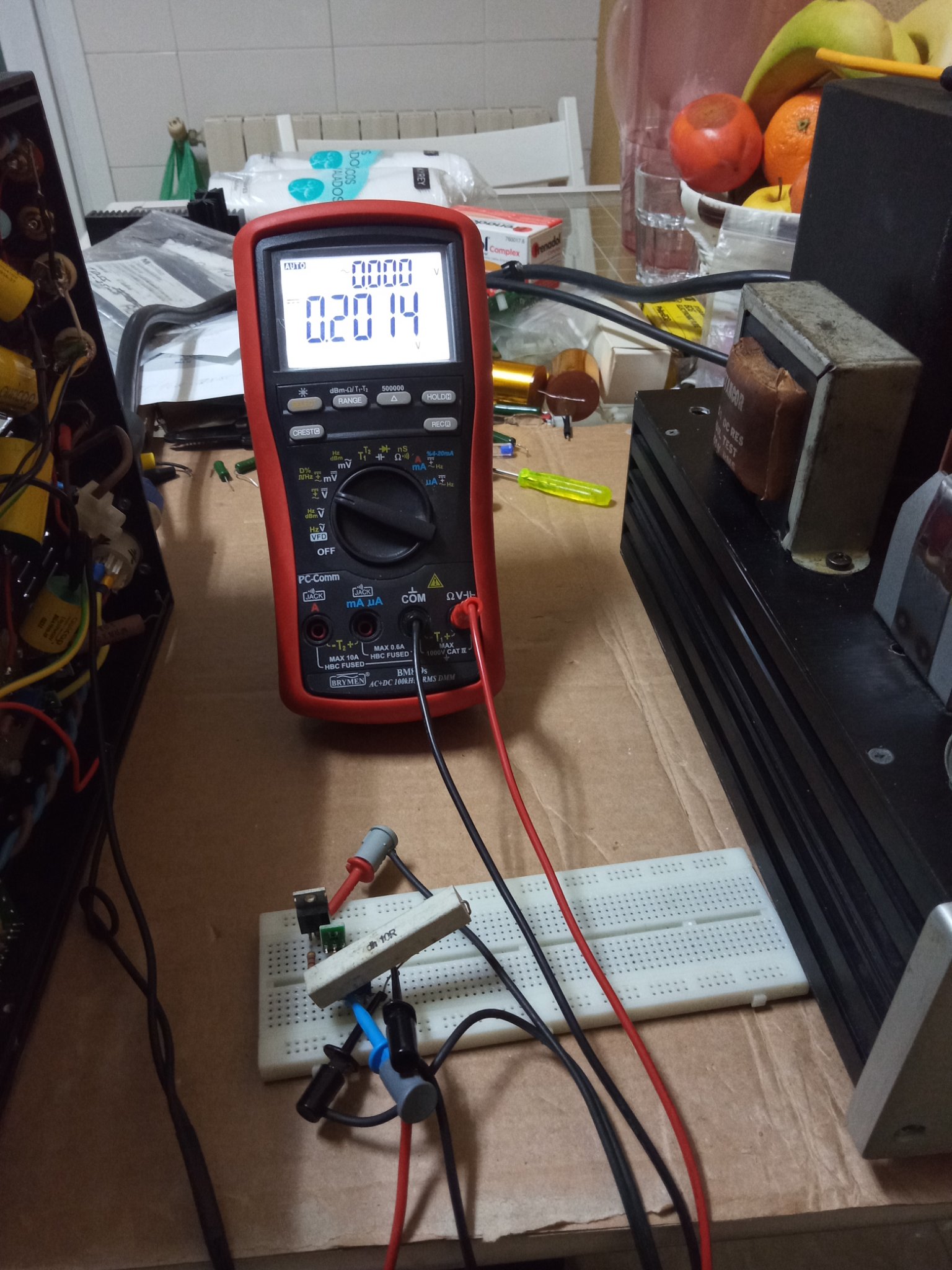

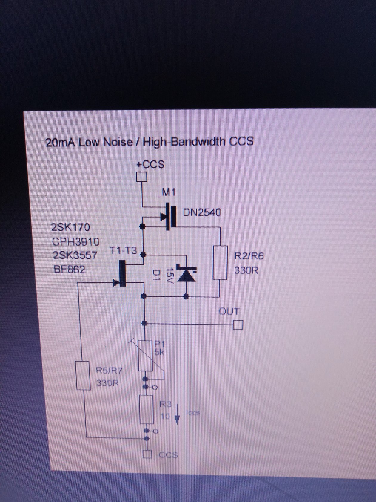

I'm sorry Salas, that's I have with others CCS not the breadboard.
Breadboard reach 40mA but can't go lower than 39mA, used 5K trimmer to set the current an 10R to measure it, the drop voltage across the CCS is only 17V. N. B. Used in real circuit.
The not breadboard CCS drops the voltage across the CCS 125V and only reach 13mA.
The CCS breadboard is exactly the same like attached schematic, only change gate stoppers are 470R.
When using such D-Mosfets at relatively few mA vs their full capability, Vgs should manifest higher but relatively still close to Vgs (th) "threshold". Its the point where they just turn on/off. It takes two to three times that voltage to pull max current. Its also an indicator of more IDSS i.e. the more -Vgs it takes to shut a Mosfet off, the stronger drain current it should pull when Vgs is zero. Because samples differ, predict at about mid value between min max of the stronger values type.
