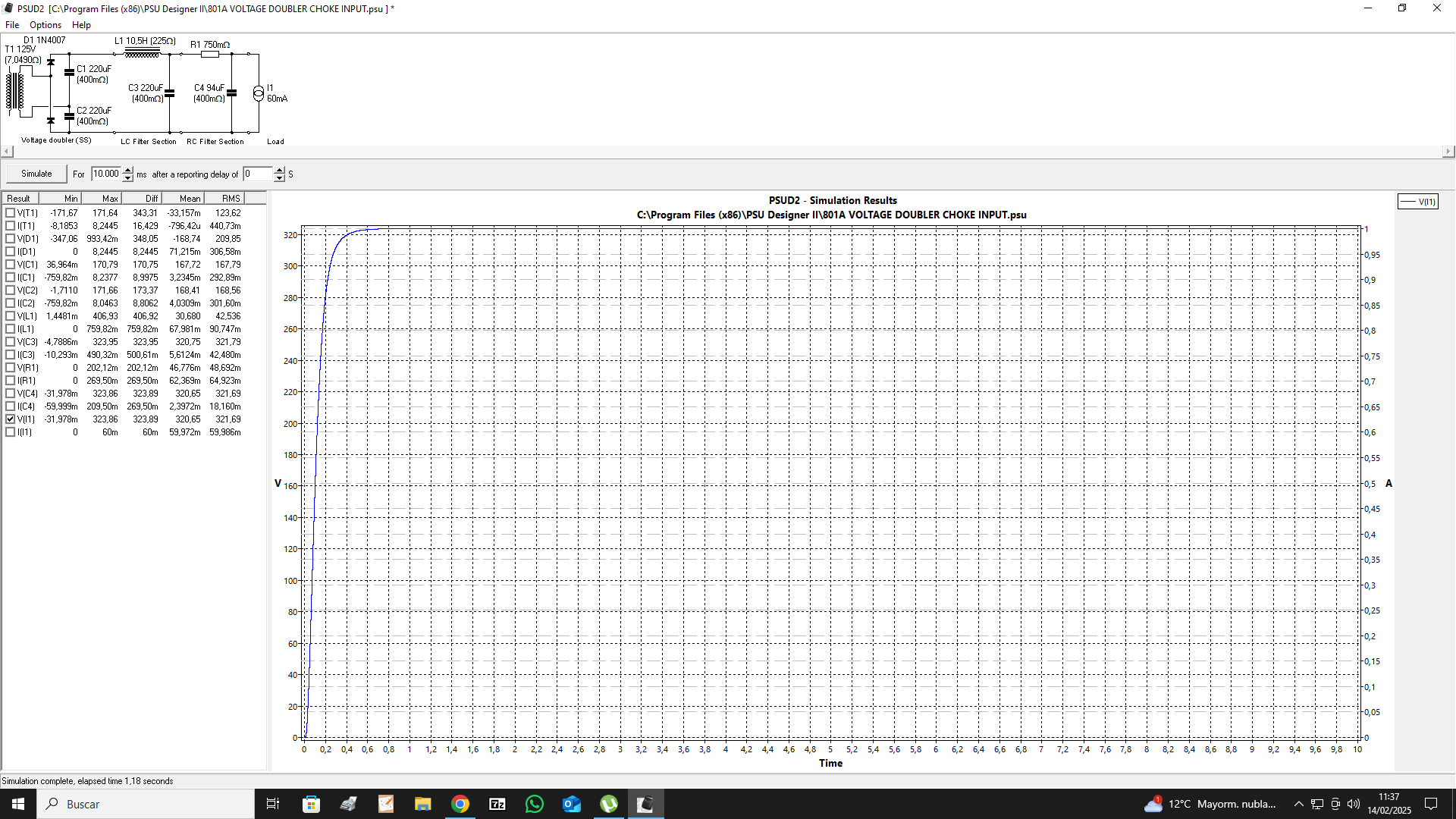

I have a couple of quick questions, I almost built the boards BUT I would like to make a few substitution to use what I have here and avoid making a Mouser order:
in the RC 0.47u and 3ohms instead of 0.33/1.8 combination, 5uF instead of 10uF for the big cap and 2x75k in place of 2x68k.
Could that work?
Could that work?

Should still work, does not look unstable with those Zobel values. 5uF just means less noise filtering mainly in the subsonic region. Does not affect otherwise.I have a couple of quick questions, I almost built the boards BUT I would like to make a few substitution to use what I have here and avoid making a Mouser order:

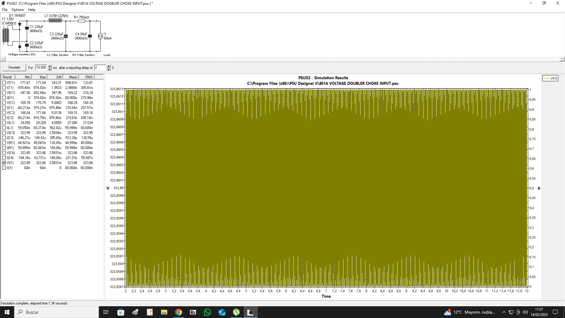

Yes, but it's really weird that PSUDII doesn't show any kind of problem....Cool, you mean the raw voltage supply?
Well Duncan said to check all connections if are OK or not because PSUDII simulation is ok, he checked with LTSpice with same results.
What's the formula to calculate?CCS max setting depends on individual IDSS of Q2 in combination with how much VGS is enveloping it by Q1. Usually capable of achieving circa 100mA max setting in this circuit.
