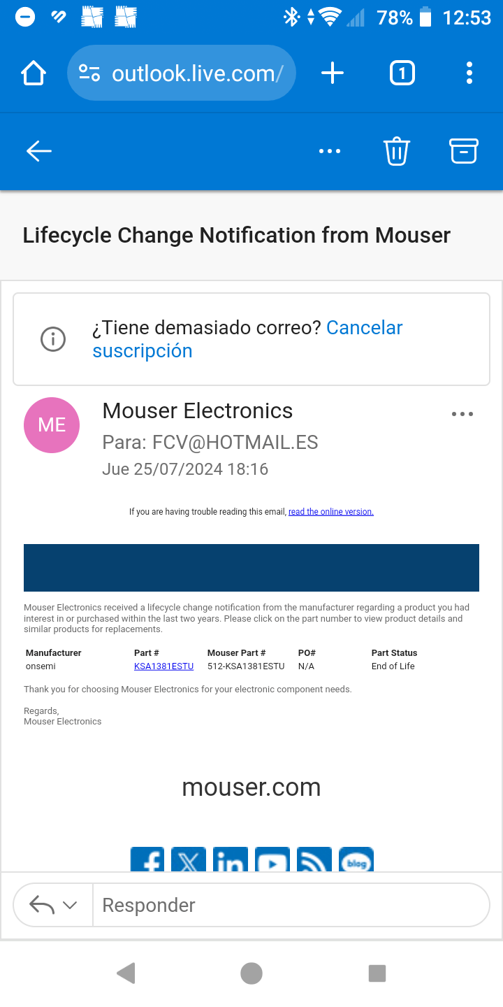

Thanks for notifying. Pity to plan EOL, its a very good high voltage PNP transistor. Linear and fast. Used as VAS stage in good amplifiers too. They also plan EOL its NPN mate the KSC3503DSTU I see. They are both available for a while, we better buy some.
MJE350 works there but in general its not as linear or as fast. Not sure if it has an audible impact in this application.
