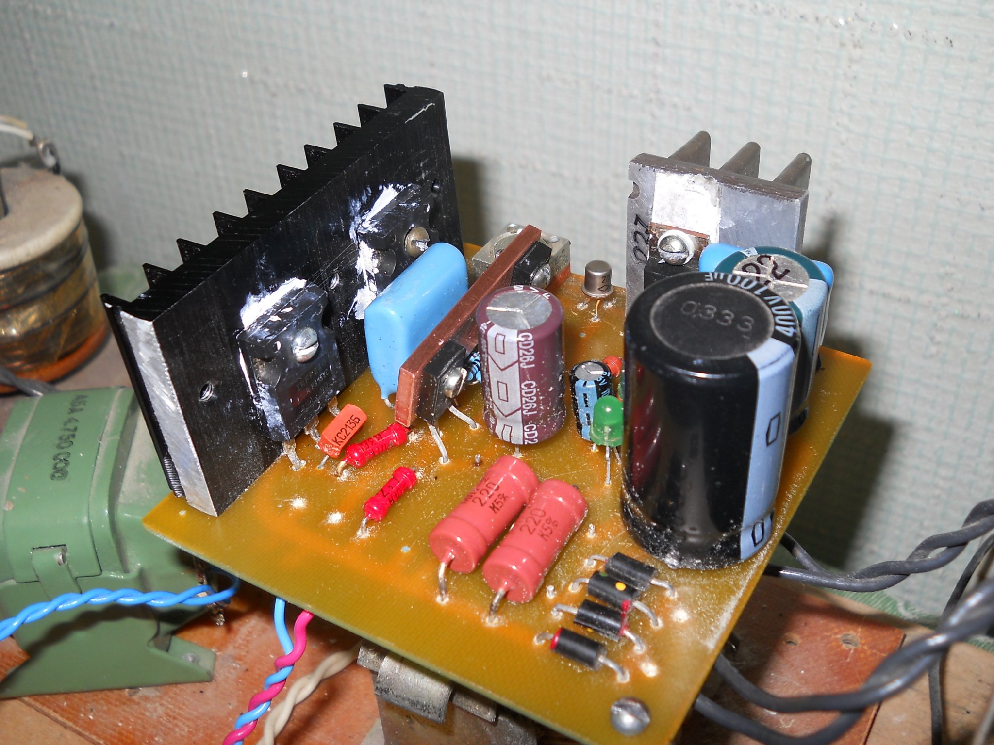

What you use this SSHV for? Sounding good?

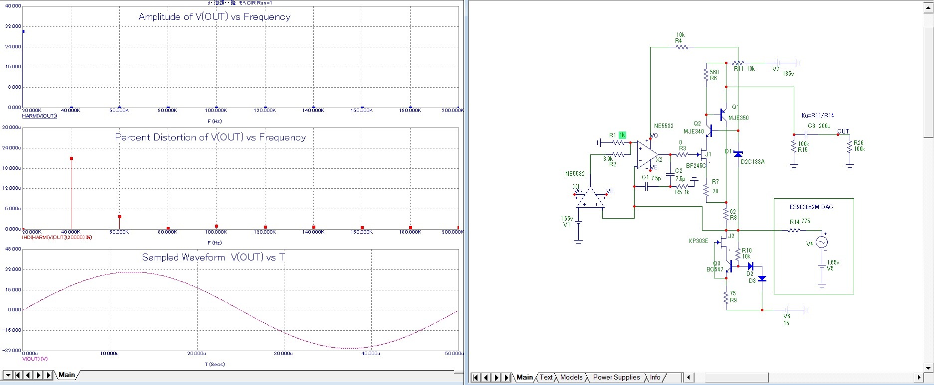

The stabilizer feeds the voltage amplifier with the input signal from the current output of the DAC, where R14 is the internal resistance of the DAC. The input resistance of the circuit is close to zero. The circuit can also work from voltage signals. To do this, we remove the input bias of 1.65v, install the R14 resistor with a resistance of 600-1000 Ohms and it will be a linear converter of the input voltage to current. The sound with the stabilizer has become noticeably cleaner, especially at low frequencies, the depth of the sound stage has increased.
