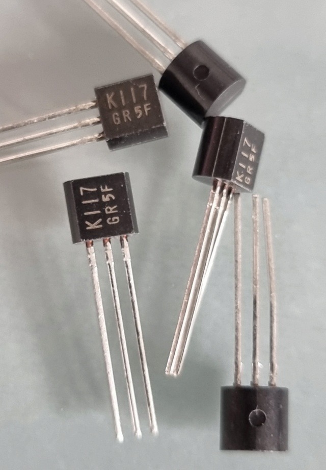

I'm thinking to buy couple of pcb from teabag... I already have 8pcs K117GR5F (hoping they are not fake) instead of the specified 2SK117GR... may I use them or? I'm not able to understand if there are differences between the two codes... I can only find a very old data sheet from Toshiba that is absolutely not clear
here they are...

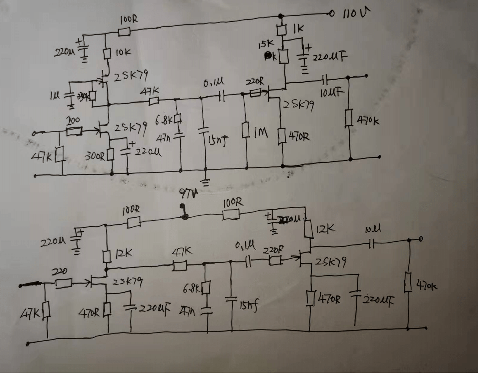

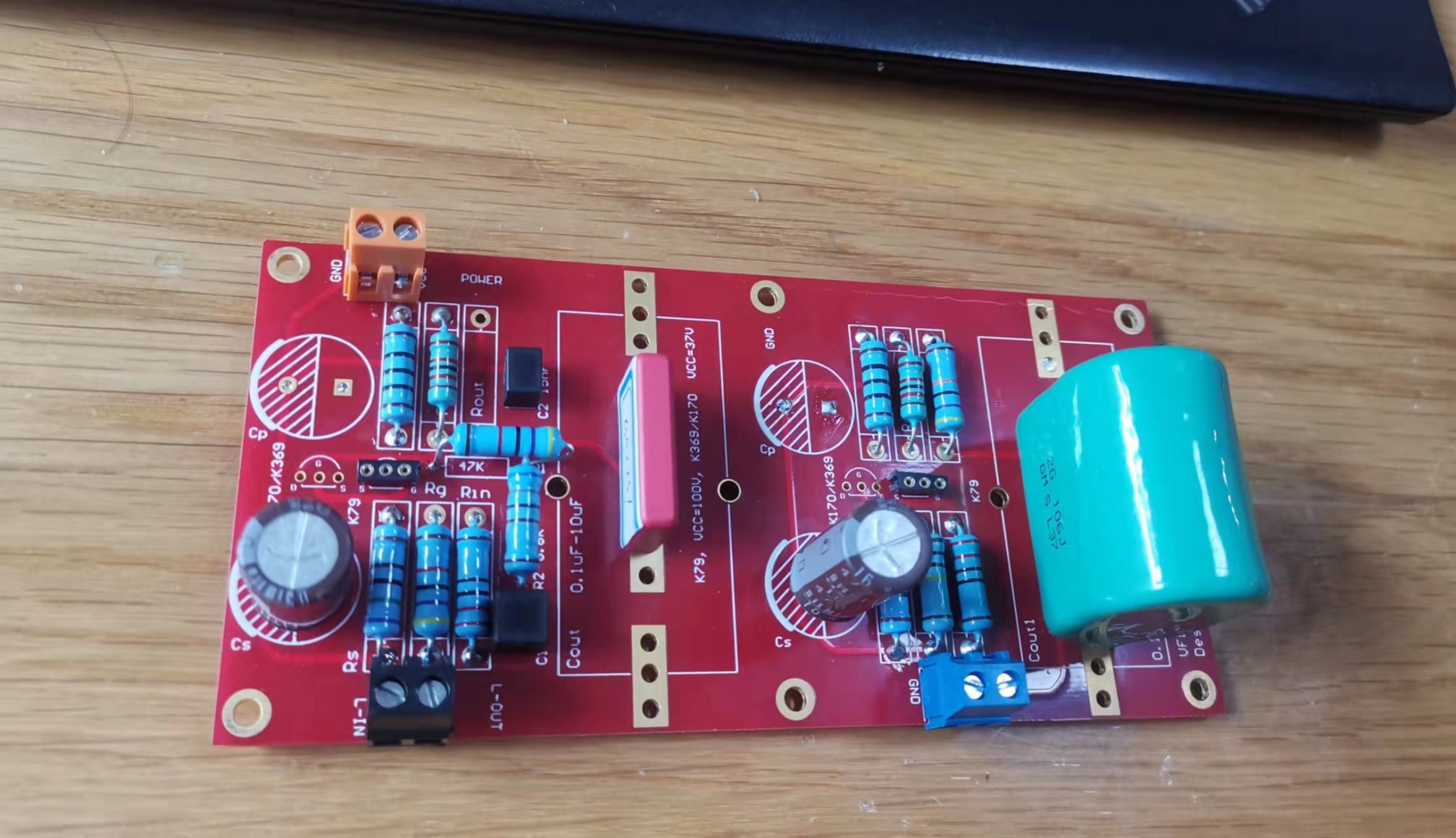

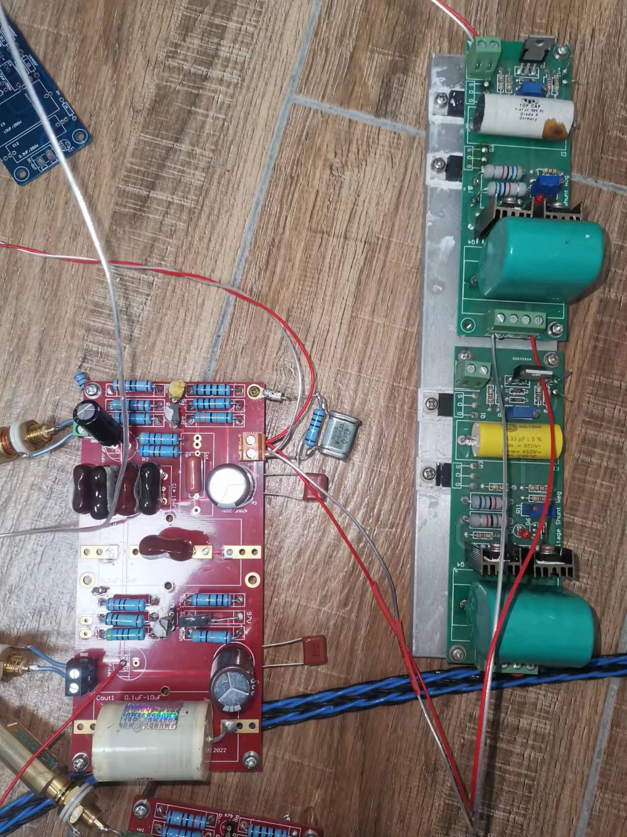

yes,it is hum phono noise.it is base on the MM model and add SUT before it.
I have tried two version of schematic, one is your version and only change some resistors and JFET and another one is also base your version cascade mode and change the jfet to k79.attached please find for two version of schematic.
Hum in prototype phonos can be due to many reasons. Layout, wiring, lack of shielding, lack of chassis, ground loop, PSU ripple if there's also buzz sound. Needing to investigate all those aspects.
By the way, that top FET looks more like a CCS? Would be gate biased with a voltage divider and output from the drain as typical cascode?
next plan is use chassis firstly also will rerouting the ground. I will follow it and check more
You are right.that is my fault to draw the schematic.the first stage output from the top K79 Drain pin.
