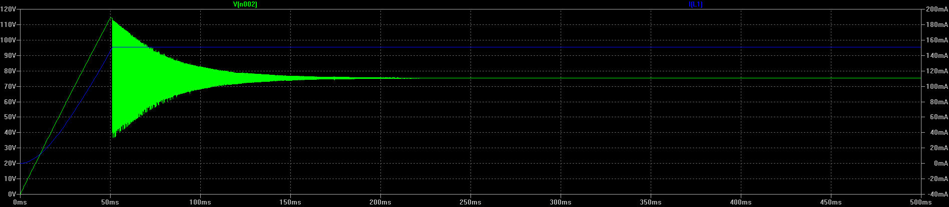

Are you sure, that SSHV2 shunt regulator is the best option?
IMHO the main problem (bump) due that field coil is paralleled last C, so at the beginning practically shunted it.
The charging current (which is minimally added to used DC current, so in case of resistive load almost static) firstly magnetizing the field coil, than charging the last C. This is produces overloading in first L, so there are swinging.
The -last- C//L tank is resonant, due it there are swinging too, till field coil magnetizing up.
If you use SSHV2, in the first time the CCS starting magnetize the coil (which is -at the beginning- practically shunting the SSHV2 parallel regulator) with full CCS current.
The voltage will be firstly high (almost B+), then lower, about Iccs*DCRcoil (with some ringing).
When coil magnetized, the regulator will working as regulator.
