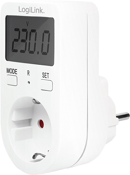

You can change that 1uF DC input decoupling capacitor to 0.1uF and see if there's difference in mA indication on that choke. You can also use a cheap wall power monitor for indication to avoid probing in raw HV places like chokes etc. But don't forget it installed when to critically listen. Avoid that device's unknown impedance and other possible effects between audio equipment and wall power after noting consumption readings.
