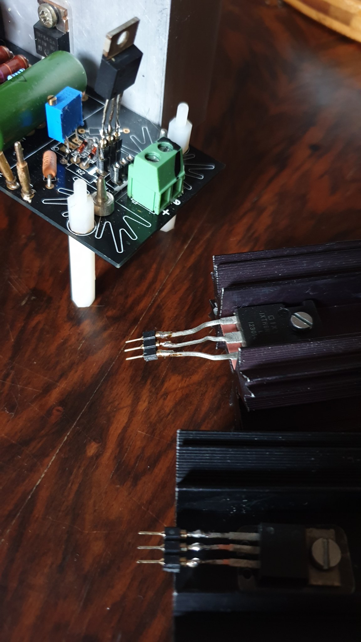

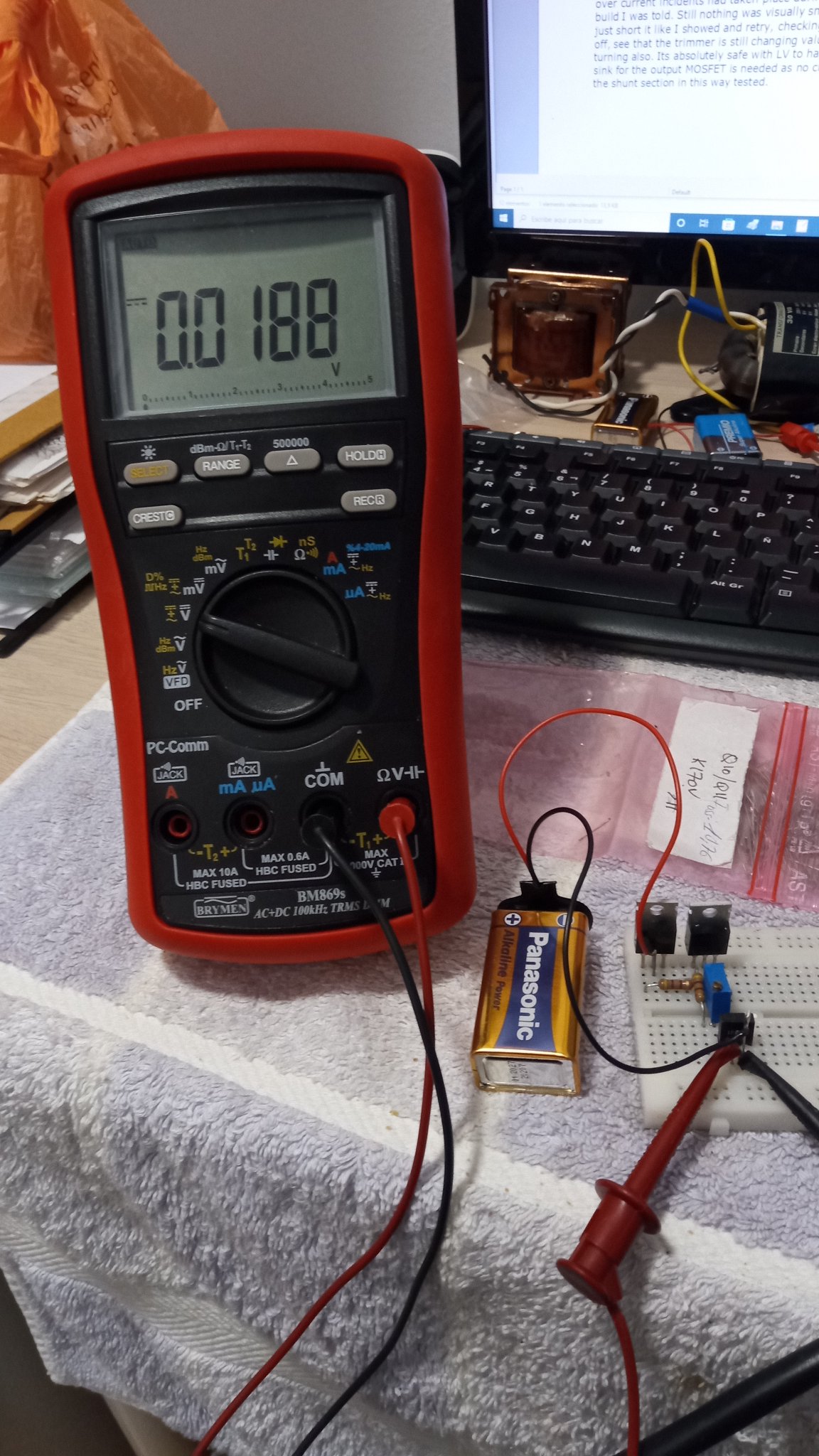

Today I tried again, this time using the CCS isolation trick, tying F+ to F0 and leaving the S terminals open, then powering with a 9v battery.
IXTH6N50D2 has same odd beavior as in HV environment, no Vgs readings. Otherwise it looks healthy, my multimeter is able to open and close the door.
I'll give a break, it won't take long to receive new, more suitable parts.

Seems like it doesn't get triggered at all in this scheme that 300W DMOS. Needs much current to develop a bit of Vgs. Or it doesn't fit well and misses a connection.Today I tried again, this time using the CCS isolation trick, tying F+ to F0 and leaving the S terminals open, then powering with a 9v battery.

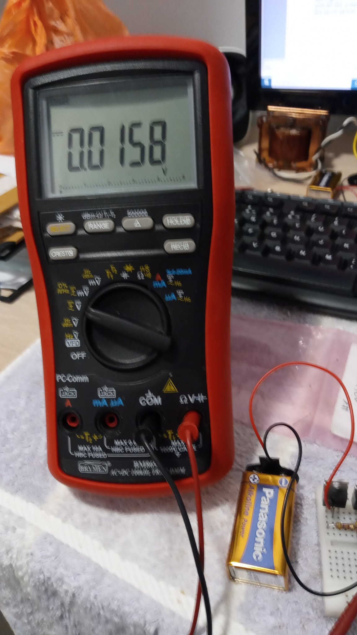

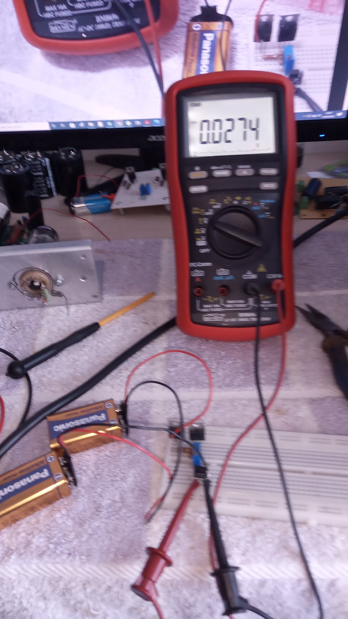

Done in mine breadboard with two cascode IXTP01N100D to help Jordi pics showing min. & max. current, the resistors used to measure the CCS current is 1R so min. 3.3mA & max. 27.4mA*Better use two 9V batteries in series for 18V LV CCS test because nearer to real life parasitic capacitance and Idss as this circuit is usually applied.
**The way you now test with the FF shorted trick and extension pins you practically breadboard. But on FR4 material. 😎

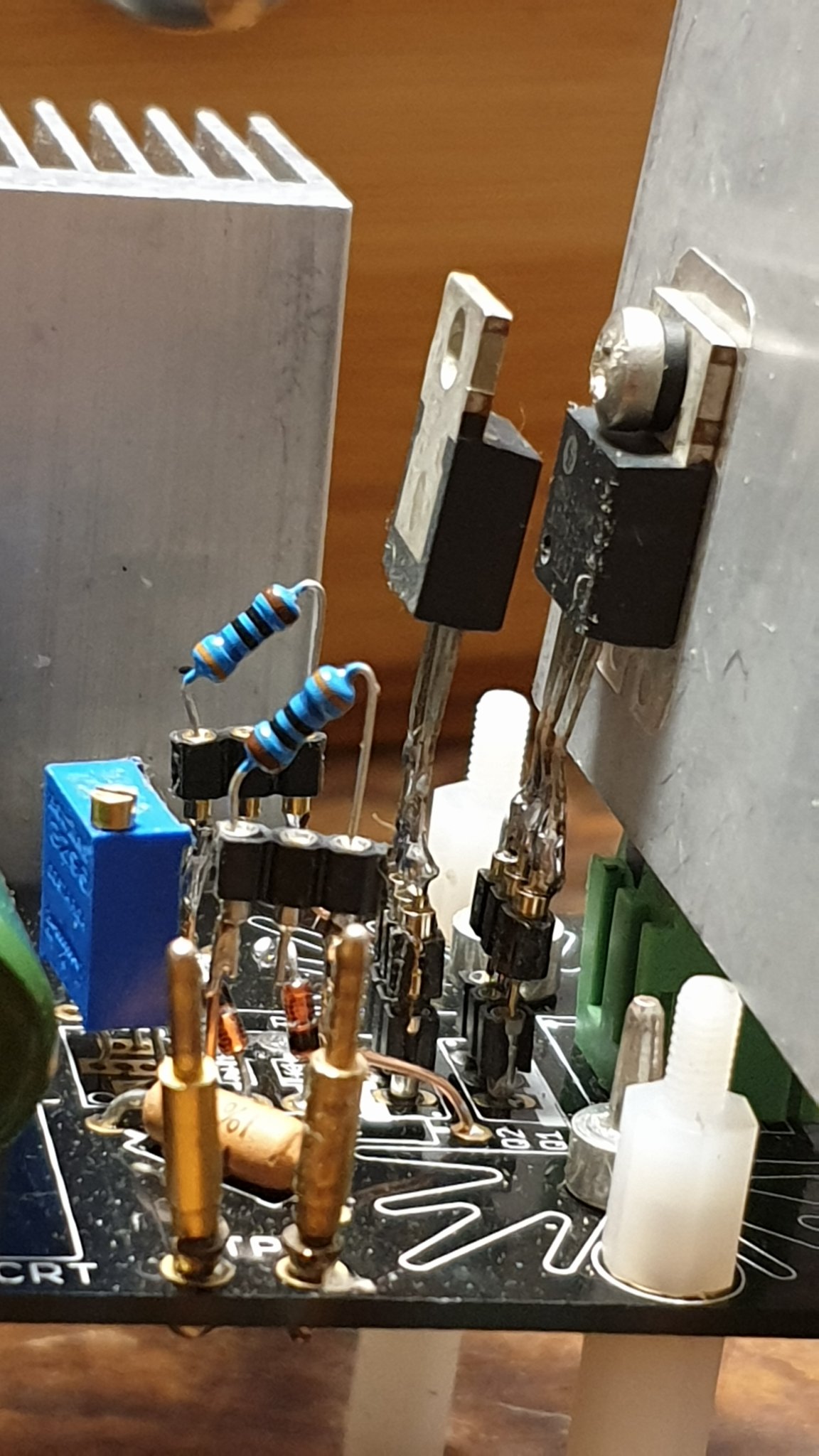

I have received IXYS, but noticed that perform worse current capability.
At same R1 R2 = 100R:
DN2540 can reach 134mA.
IXTP02N50P reach 100mA.
IXTP01N100D far less, 42mA.

First try on IXYS is sucessful, but I doubt can set them this way because D2 burns at touch after half minute. Time enough to take this measurements based on settings: R1,R2=360R @ 170mA @77Vout.
DN2540 ==> R4(R3)=7,6R and 90VDC in
IXTP02N50P ==> R4 =7,2R and 95VDC in
IXTP01N100D ==> R4=0R and 108VDC in.
