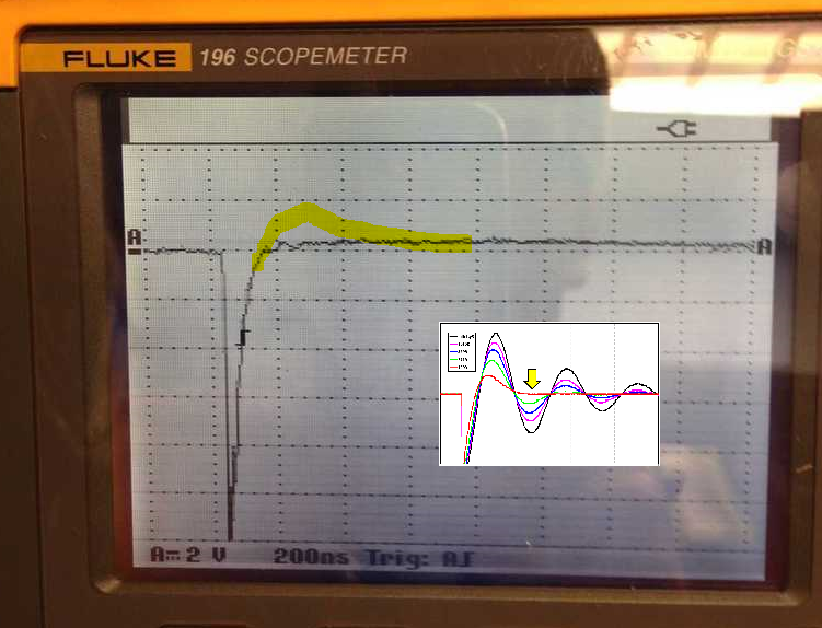

My first attempt at using the Quasimodo appeared to go flawlessly but still left me a little puzzled.
Here's R infinity which looks exactly the same as other posts.
Here's R tuned to remove all the ringing. Very nice flat line with no hump.
And here's a pic of R tuned too far and the ringing returns.
The thing that puzzles me is that my ideal R is 4.7 ohms which is quite a bit lower than other posts I've read.
Dan 😕
too big a resistor is equivalent to having no snubber and you see long lasting ringing.
Too small a resistor is equivalent to just hanging a capacitor across the transformer secondary and again you see long lasting ring.
Your first and second pics confirm this.
With a useful range of resistance you see the damped ringing, or the jump plus one half wave.
I have not yet seen the jump without any half wave. That would be the equivalent to a Bessel Filter step. Would that be a good target to find and adopt?

Great start Dan! You want the second lumpity bumpity in the waveform to just barely flatline, as shown by the yellow arrowhead in the QM design note figures. Member BYRTT has kindly copied it into posts 904 and 905 above. Your goal is to juuuuust barely ooch your way little by little, until that trough flatlines. Then stop!

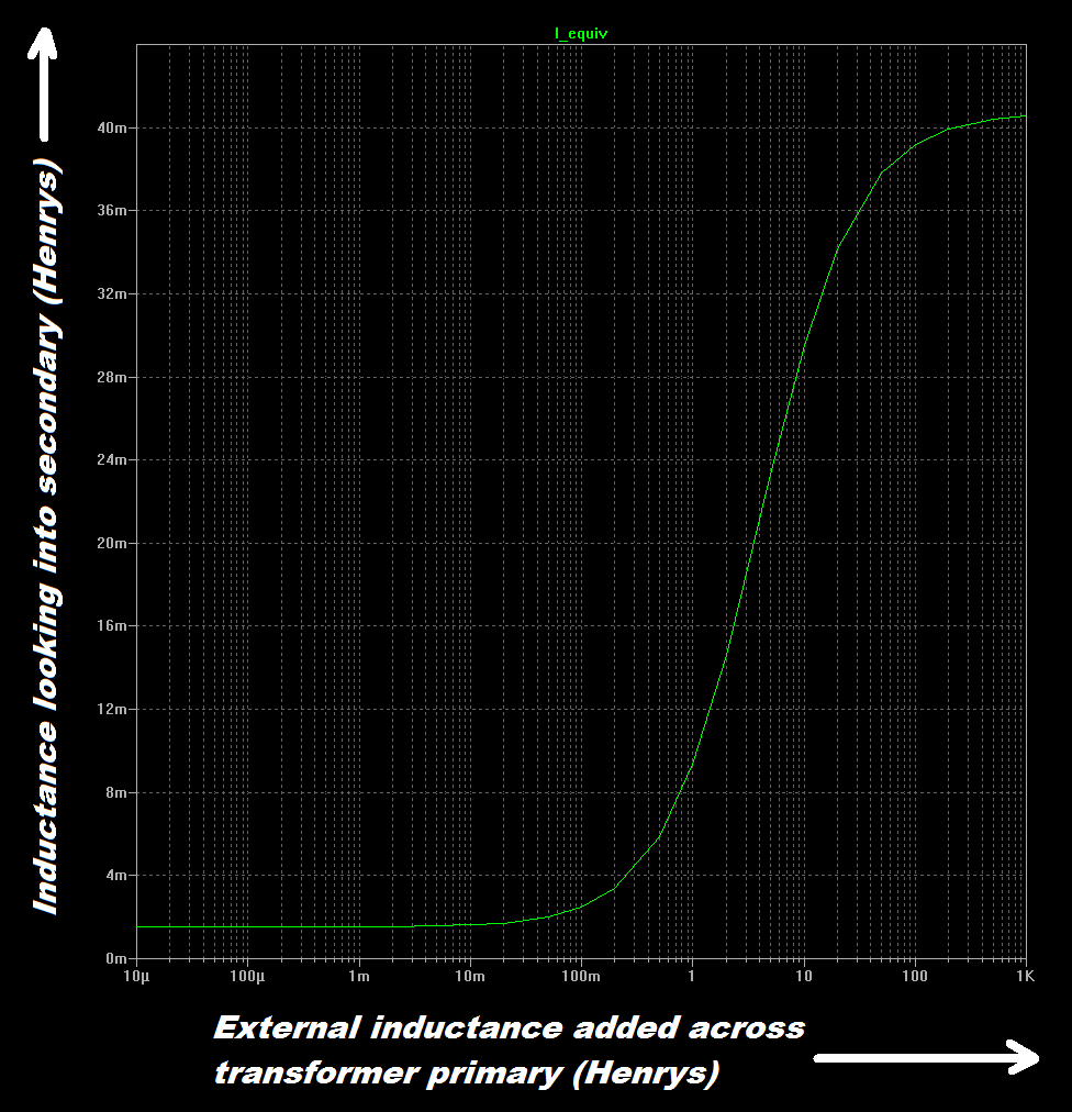

Surely that is to be expected? With the primary open you are measuring the secondary inductance, which will be large. But with the primary shorted you are measuring the leakage inductance, typically ~1mH for a split bobbin, but can be much higher.
Yup - just tested a random ~150VA split bobbin on my bench. Secondary inductance 40mH with primary open. With primary shorted leakage inductance is 1.5mH
Hmmm, what happens in the vast gulf between "primary open" and "primary shorted"? How can we interpolate and study "primary part-way shorted" ?
One way to do it, is to realize that "primary shorted" means "primary connected to a zero picohenry inductor". Since a zero-valued inductor is a short circuit, this seems valid. Similarly, "primary open" means "primary connected to an infinity henry inductor". Since an infinity henry inductor has infinite AC impedance, this seems valid.
So I did that, in simulation. I made a 230VAC primary, 23VAC secondary transformer whose secondary magnetizing inductance was 40 millihenrys and whose primary magnetizing inductance was 4.0 henrys. It turned out that the mutual inductive coupling coefficient which gave a secondary leakage inductance (primary SHORTED) of ~ 1.5 millihenrys, was K=0.9812. So I used that K value.
Then I disconnected the short across the primary and connected an external inductor to the primary, whose value is changeable in simulation. I verified that when Lexternal=0, the (leakage) inductance looking into the secondary was ~ 1.5 mH in simulation. I also verified that when Lexternal=Infinity, the inductance looking into the secondary was ~ 40 mH in simulation.
Then I simulated 25 values of external inductance, between zero and infinity. Results plotted below.
At the far left side of the plot, external L is very small. Almost zero. And the inductance looking into the secondary is ~ 1.5 mH. At the far right side of the plot, external L is very large. Almost infinity. And the inductance looking into the secondary is ~ 40 mH. In between, the inductance follows a smoothly rising curve.
