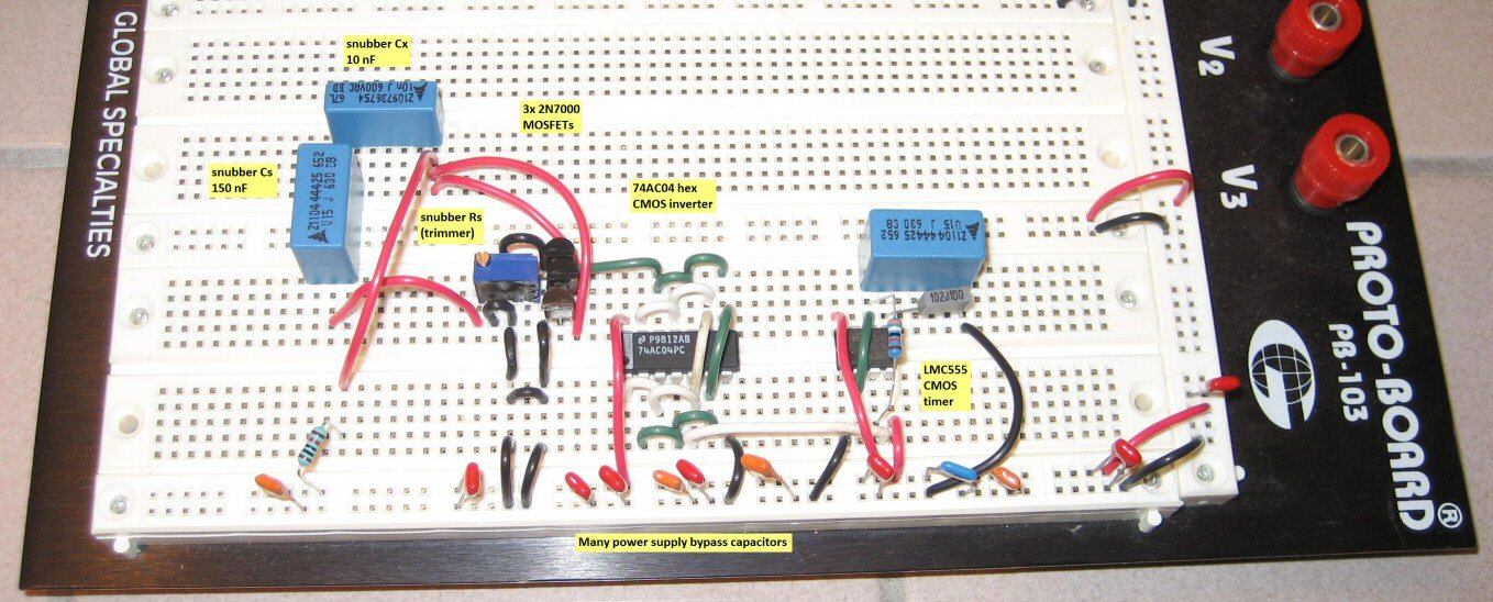

Just lashed up a Quasimodo from 90% of the bits from stock. Only things needed were the shottky's, the MOSFET driver, MOSFET and 1k trimmer. Used a chunk of proto-board. Only one missed wire around the 555, at which point it woke up and worked perfectly.
First test a random inductor to confirm operation, and have tested two transformers thus far:
Chinese R-core, 18V + 18V, 40VA. Measured parameters on bridge - leakage 980uH, C 90pF. Rsnub was 100 ohms for 240V primary
500VA toroid (old ILP unit, 35V secondaries, 240V primary) Leakage 10uH, C 1.1nF. Rsnub 18 ohms.
There is some higher frequency stuff knocking about that others have noticed.
Hagerman's analysis (scaled in proportion for different Csnub) gives 120 ohms for the first Tx and 18 ohms for the second. So all is in agreement on a sample of two very different transformers between Quasimodo and Hagerman.

Congratulations sawyers! Glad it worked for you. I myself was not able to measure leakage inductance even remotely accurately without Quasimodo. At the time I thought the issue was (a) leakage inductance varies with frequency, i.e., power transformer cores are not linear at frequencies above 10 kHz; and (b) the inductance value I wanted/needed, was L at the resonant frequency of the secondary RLC circuit. Unfortunately I did not know what that frequency was!

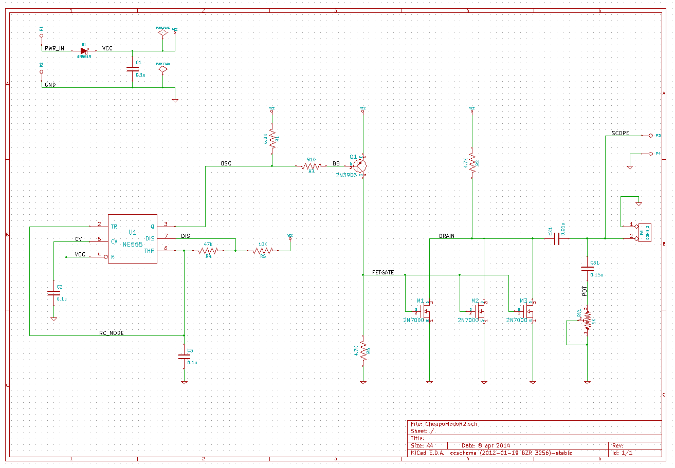

Nic, I would be glad to send you all of the electronic parts to implement the low cost version called "Cheapomodo", and you could plug the circuit together on your solderless breadboard / protoboard. Presto you can now test transformers and optimize snubbers! Since the collection of parts is so cheap I will simply give them to you for free, you don't have to send them back to me. Just pay postage from California-USA to you. EUR 2,65 at most. The only thing I ask in return, is that you post a photograph of your protoboard with your assembled cheapomodo, and an oscilloscope photo showing it in operation.Would somebody in the EU have a Quasimodo rig to lend me?
The schematic is below. It's simple and cheap.
I use an ancient Marconi 0.25% Universal Bridge TF1313A - it is a tube design, but works perfectly. The tricky thing is setting the Q at the null. Because of transformer resistive and magnetic losses the Q for L is really low, about 2-3. So it is an iterative and somewhat tricky thing. But you can easily measure down to single uH's. For C the Q is much much higher because it is dominated by dielectric losses. Two frequencies choosable, 1kHz and 10kHz.
I actually also measured the capacitance on a GR capacitance bridge I have to verify (since the Fluke DVM was telling me porkies) at a fundamental level, and the Q when measuring winding capacitance on a toroid was 140. The GR and Marconi agree on capacitance which was good confirmation.
I subscribe to Linear Audio, so have read your matrix of experiments on rectifiers - very interesting. Yes - I picked up the 6-parameter curve fit; yeesh!
Since that time I discovered the "Quasimodo ExtraLight" approach which finds an optimum snubber using only a function generator, an oscilloscope, a series resistor, the transformer, and the snubber-to-be-optimized. No PCB, no battery, no oscillator, no gate driver, no MOSFET. diyAudio search will find it for you.
I toyed with the idea, since I have several different suitable function and plain square wave generators, but thought I'd just do a general Quasimodo fixture (since I had most of the bits already) and not worry about remembering how I hooked everything up next time.
