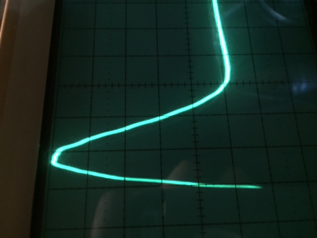

Scope Photos
The first picture is with .01 cap and .15 cap and 30 ohm resistor.
The second photo is when I increased the first cap from .01 to .022.
I have not done any listening yet
The first photo has the high frequency squiggles some of you have talked about
Moving up from the .01 to the .022 first cap really improved the scope picture and I had no need to increase the .15 cap
Tonight I will find I will listen to the choices

I attached it to a large split bobbin transformer in circuit with 10000uf capacitance across the rectifiers
For the first cap I used a ,01uf
I can use any cap for the tuned cap
As I turn down the pot it gets better and better but never completely flattens out
If I lower the resistance further it creates new bumps
It's about a 33 ohm resistance
What's weird is that a .01 cap with the 33 ohm
Resistor works and if I increase it no better
I can reduce ringing but can't critically damp

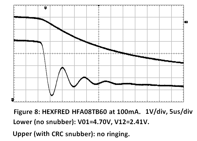

The great thing about Quasimodo is, you can use it however YOU want to. No Snubber Police are going to knock down your door, open up your DIY gear, and check whether you've built Approved And Orthodox snubbers. Do whatever you like!
The Quasimodo design note even contains a section (pp. 12-13) that shows how to use QM to optimize a 1R+1C snubber if that's what you want to do.
I've gotten email from some pretty top notch EEs who tell me they are using QM to optimize a 1R+0C snubber (!!), namely, 1 resistor and zero capacitors. Maybe the sound of no capacitors at all, is more pleasingly euphonic than the sound of the best possible capacitor. In a snubber. May be! The only cost is a little more power dissipation.

Naah, the 1R+0C snubber folks are extreme minimalists who feel that adding a capacitor merely to reduce the power consumption of the snubber (as explained in Quasimodo design note appendix A below), is silly. Omit the capacitor, eat the extra power, and take pride in your schematic which has fewer parts than the other guy's schematic. Fewer parts means more minimal. More minimal means more better -- to an extreme minimalist.
However it must have occurred to many readers that this is something which could, in principle, be adjusted by ear. If diyAudio member Jay is correct, that it takes at least two hours to perform a listening test, then a dedicated experimenter could try about two resistor settings per day. In five days he could try R=Infinity (i.e. no snubbing resistor at all, i.e. zero damping), and also try the resistor settings which give damping = 0.1, 0.2, 0.3, 0.5, 0.7, 1.0, 1.5, 2.0, and 3.0. Ten different snubbings, ten different listening sessions of two hours apiece. Maybe what the ear prefers, is not what pleases the eye on the face of an oscilloscope?
