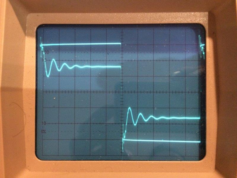

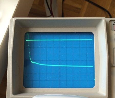

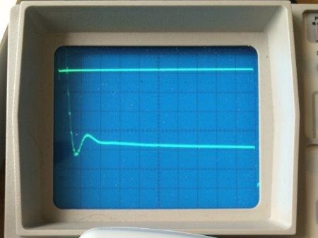

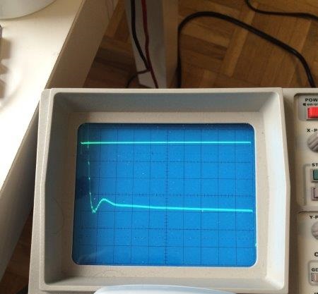

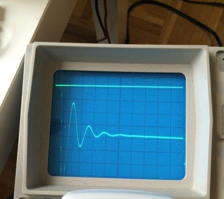

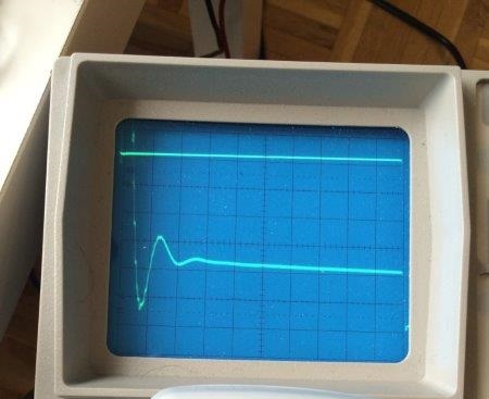

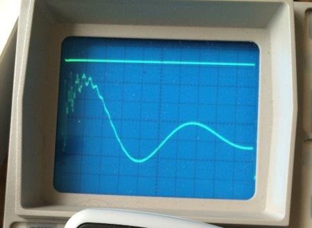

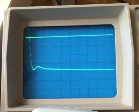

Simple, no-math transformer snubber using Quasimodo test-jig
next round:
R1 = 1k, primary winding shorted, one secondary shorted
To find the ringing I had to look into much higher frequencies, my scope doesn't store anymore at this speed.
Pictures show:
No snubber, only Cx Rs=inf, Rs=100, Rs=33, Rs=0 Ohm
Again, I can dampen the ringing, but I can't eliminate it.
Square wave is 1V/div, Channel 2 is 20mV/div, 0.5us/div#
Did I do it right, this time?
It's surprising and suspicious that you only set the knob of your 20-turn trimmer potentiometer to resistance values that happen to correspond to standard E6 values of fixed resistors. Don't do that! The whole purpose of a 20-turn trimmer is to give you incredibly smooth and fine-grained control. Start the knob at max-resistance and slooooooowly wind it down to lower and lower resistance, while watching the scope face. When the waveform's second lumpity bumpity completely flattens out (see yellow arrow in Quasimodo design note Fig.1), stop winding it down. Yank the trimmer out of the test fixture and measure it with your 3.5 digit DMM on ohmmeter setting.
I printed your scope photos onto sheepskin parchment and took them out into the woods. I smeared them with ceremonial oil and set them on fire while praying to Ozymandias and smoldering the ceremonial herbs. I received a prophesy that (a) your transformer's leakage inductance is probably in the neighborhood of 270 nanohenries; (b) if you continue using Cx=10nF and Cs=150nF then probably the waveform's second lumpity bumpity will disappear when Rsnub=14 ohms. Now you should know that Ozymandias is sometimes wrong, and she never makes a guarantee, only a suggestion. But it's worth noting.
When Quasimodo gives newcomers a surprising result measuring a transformer, I usually recommend stepping back and using QM on known inductors (whose answers we can calculate in advance, thus we know what Quasimodo should report).
Please see post #257 and post #487 for ideas about how to certify a Quasimodo (even an ExtraLight) using a fixed inductor of known value.
While you're ordering a 270 nanohenry, ±5% inductor from your electronic parts distributor, go ahead and also order a 20 turn 1K trimmer and a 20 turn 100 ohm trimmer.
Thanks for going through the ordeal with all the preparation, burning and praying, I really appreciate that. Apart from the mystic figures I presume you have received the blessing that my little pictures are acceptable for worship given the ritual objects I have consulted: tranny, caps, etc.
I have to share a secret, though, and I beseech you to spare me from the stake: this isn't a 20-turn pot, it is a 500Ohm trimmer, parallelled with a 100 Ohm E6 resistor.
Its, with the rest, what I had in the box. (Btw 304 Ohm is probably E192). Admittedly, it is difficult to tune this at the low values in question.
Also in the box I have two 22 Ohm resistors, and I find that with 22 and 11 Ohms for Rs the lumpity bumpity comes back up nearer towards the trace I show for Rs=0. This isn't meant to question Ozymandias, of course.
My whole test rig involves lots of aligator clips, unshielded cables and stuff. Given the high frequencies, I guess I should start firming up. Maybe I find a 20-turn trimpot on the way.
In your note I can't find traces beyond optimal Rs. Is my observation valid that with Rs = 0 the ringing is back, but with slightly different frequency?
Oh, and would you suggest other Cx and Cs values for my case?
When Rs=0 the secondary circuit does not contain any mechanism to dissipate the oscillatory energy. There are three energy storage elements but no energy dissipation elements. There is an inductor (transformer leakage inductance), a capacitor Cx, and a second capacitor Cs. What do YOU think the damping factor might be?

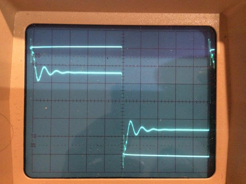

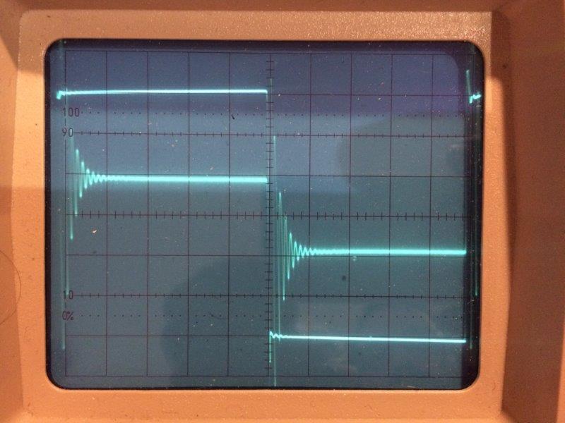

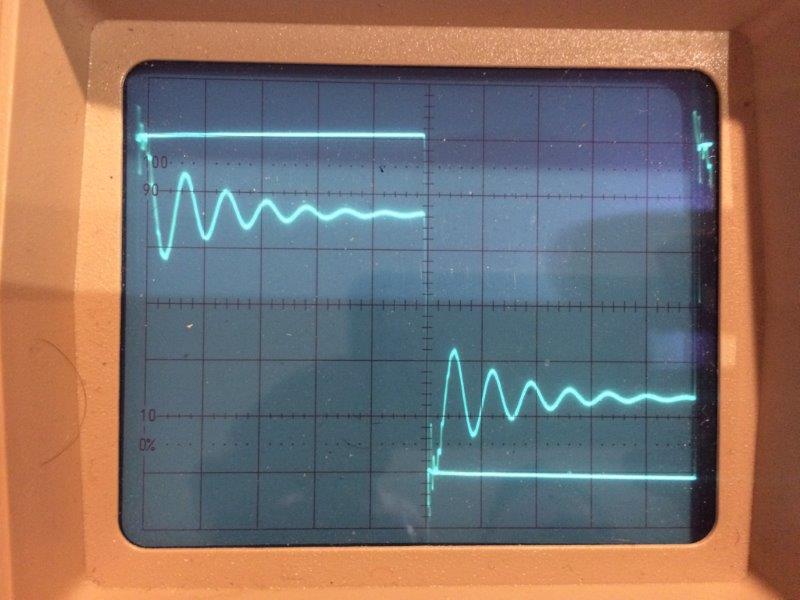

For those interested how pictures look like when using a 6Vpp square wave generator (and better wiring than before) injecting current into a Toroidy 400VA 2x18V transformer via a 1kOhm resistor, here they are.
5mV/div, 0.5us/div, Cx=10nF, Cs=150nF,
the Rs values measured for each trace are
47.5, 38.0, 32.3, 13.3, 11.7, 9.6, 1.5 Ohm
Note, however, that the DMM measures a closed circuit as 1.5 and a 10Ohm resistor as 11.4 Ohm.
The last picture shows how a vanishing Rs results in a ringing with much lower resonance frequency. I presume in a regular Quasimodo you can't see that as the dang from a charged 10nF capacitor goes pfffft, when paralleled with an empty 150nF cap.

Don't forget that your QMExtraLight approximate "current source" stimulus has a Norton equivalent resistance of 1K, between the oscillatory node and AC ground. Thus the 1K resistor dissipates some of the oscillatory energy, so its resistance is effectively in parallel with Rs as far as damping is concerned. This is more and more important when Rs grows to approach 1K; or, stated the other way, it is more and more negligible when Rs falls (Rs << 1K).
Quasimodo people and Cheapomodo people see the same thing you see when Rs approaches zero. LTSPICE simulation people see it too. The differential equations are the same in all three cases, and they don't tell lies. When Rs=0 the Cx/Cs ratio just acts as a (capacitive) voltage divider at high frequencies; it affects the amplitude of the bell-ringing whack, but not the risetime. The ringing is still visible on even the crappiest scopes with the crummiest vertical gain (0.5V per division?!!?)
