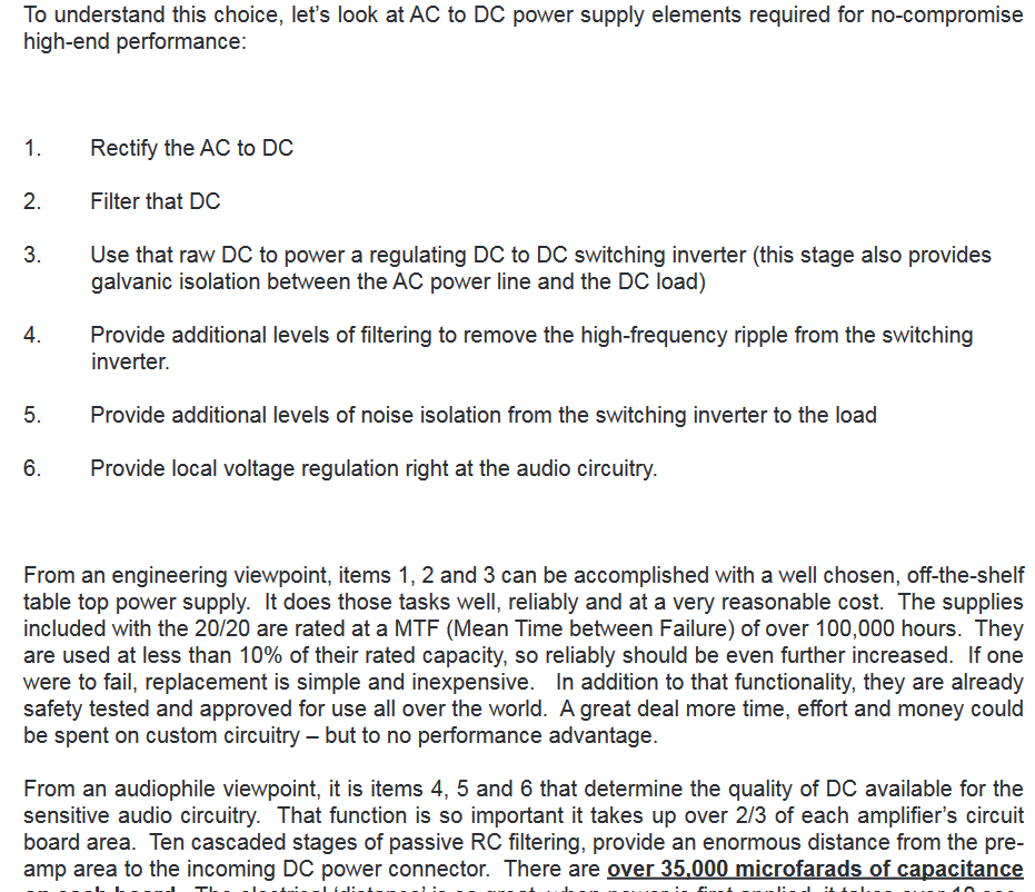

I offer, as a pleasant "thought experiment," the Sutherland 20/20 phono preamplifier: mfr's web page. This is an extreme example of minimalism; it's dual mono construction and each channel gets its very own DC power supply. These are a pair of wall-warts (!!) that perform AC to DC conversion.
Imagine opening up those wall-warts in an attempt to install Andrew Nehan's sound improver capacitors! Wow.
From the owner's manual:
541350d1459614039-simple-no-math-transformer-snubber-using-quasimodo-test-jig-from_the_owners_manual.png
