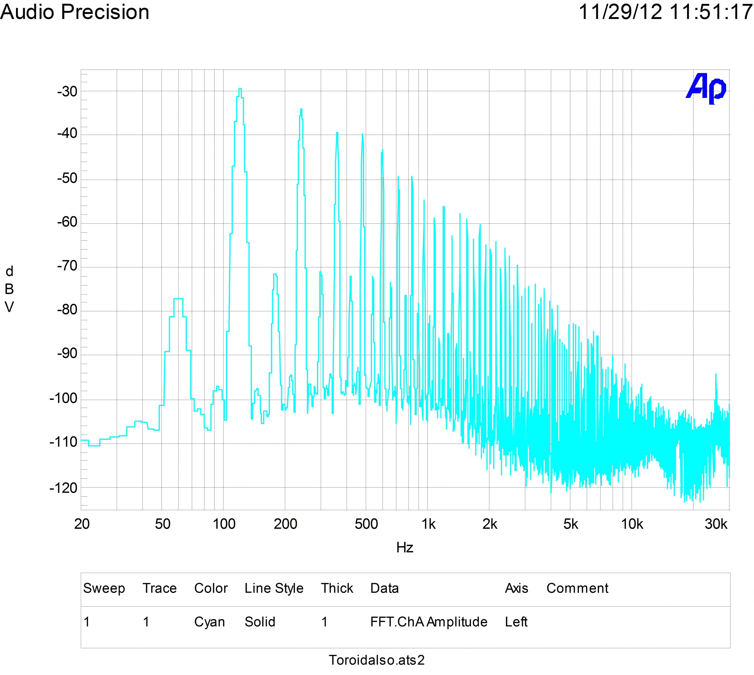

Attached is an FFT of the spectrum of a rectified and filtered signal. The main energy is at twice the line frequency.
The ringing frequency is not related to this. It is determined by the winding inductance and capacitance.
Some of the ringing is damped by any actual circuit load.
Testing with the windings not under test shorted will result in a worst case value.
