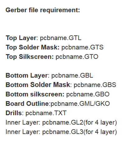

Could you please tell me what these extensions standing for, or the name of the PCB program you used to make your board?
.GBL
.GBO
.GBS
.GML
.GTL
.GTO
.GTS
.TEX
I guess .GBL is the bottom layer, and .GTL is the top layer, but I would least need the wheel file, the drill tool and the drill text file to.
I would have to check but I think it is rs-274x format with embedded apertures
I think the txt file is the excellon drill data.
Naming convention looks to be like the ones pcbway uses or very similar.
gerber bottom layer
gerber bottom outline(silkscreen)
gerber bottom soldermask
gerber milling layer ? or board outline
gerber top layer
gerber top outline(silkscreen)
gerber top soldermask
excellon drill, all plated holes
Hello miklos. Please notice that the Gerber files for Quasimodo v4 (Through Hole) are contained in a zip archive. The name of the zip archive is
  • Gerbers_qmodo_seeed_TH.zip
I gave it that name because the Gerber files were created to follow the naming convention at PCB manufacturer Seeed Studio. Here is a (link) to the page on Seeed's website where they state their requirements for filenames and file extensions on Gerber files. I've screen captured the relevant portion and attached it below.
The good news is that this same filename extension convention is used at many many PCB fabs in China. It's certainly used at all the ones I've purchased boards from. So when your Gerber files are correctly named for Seeed, they are also correctly named for other Chines fabs too. Be careful about OSHPark, which is not in China. OSHPark has a different set of required file extensions. See their website for details.
I urge you to read post #91 here in the Quasimodo thread, where a diyAudio member talks about sending these Gerber files to seeed for manufacturing. The boards he received worked fine, and he sold the extras to recover his costs. In fact I know of at least seven diyAudio members who have done this; they are named at the bottom of post #1 in this thread.

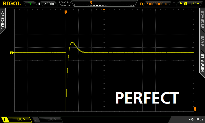

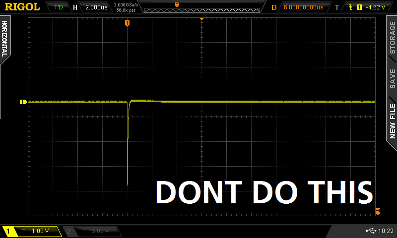

_
With a useful range of resistance [trimmer "Rx" on the Quasimodo jig] you see the damped ringing, or the jump plus one half wave.
I have not yet seen the jump without any half wave. That would be the equivalent to a Bessel Filter step.
For those who have successfully worked at least one hundred Laplace Transform problems, I recommend spending EUR 0.99 to read the Appendix of the Soft Recovery ringing article. It illuminates a countermeasure that makes flatline (or even upslope line) Quasimodo waveforms possible. An example is shown below. Figure 1 is the recommended-for-newbies Zeta=1 waveform. Figure 2 is the Experts Only waveform that seasoned EEs can get after reading Appendix A and doing a little algebra.
Figure 2 is for Experts Only.
