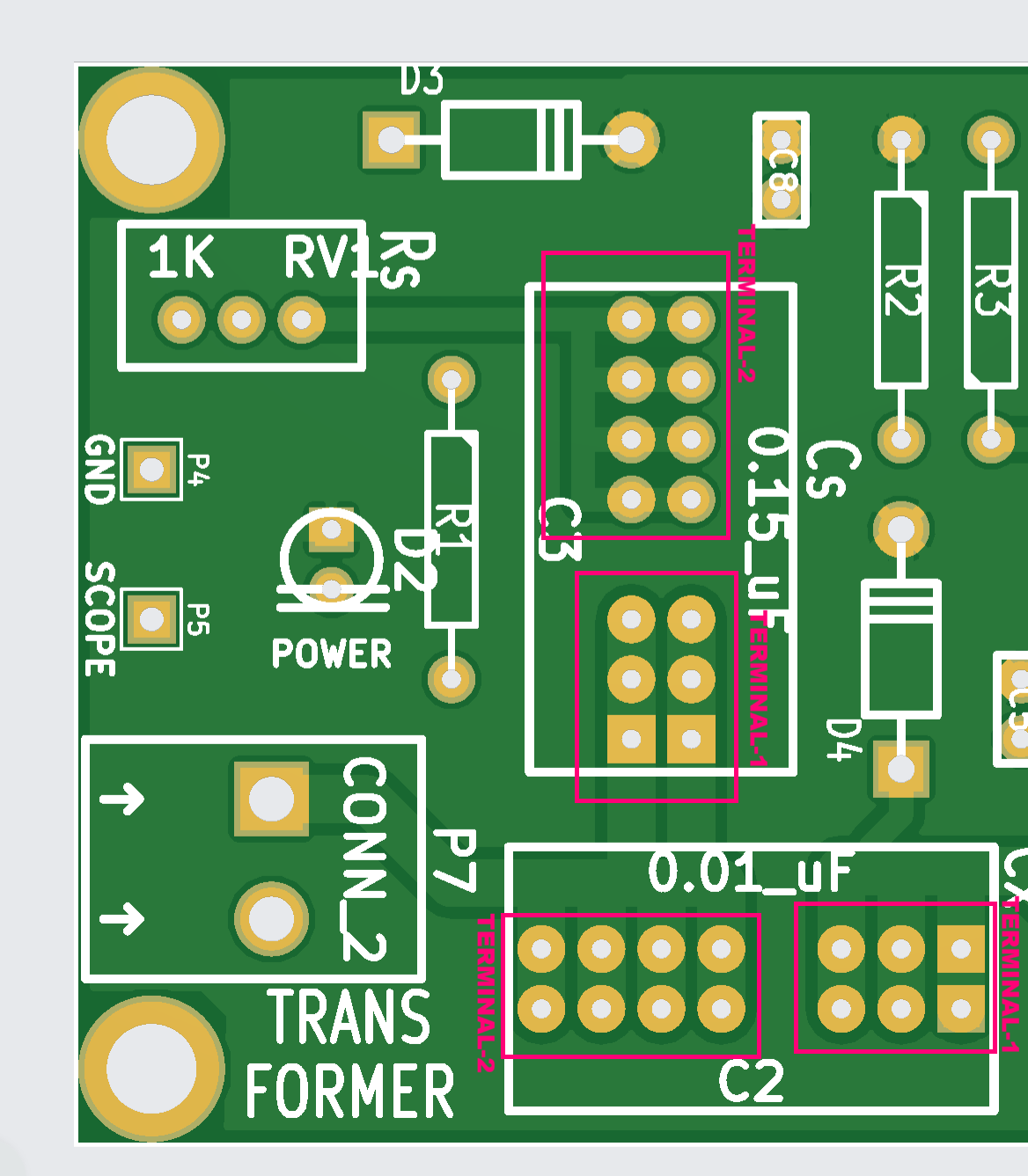

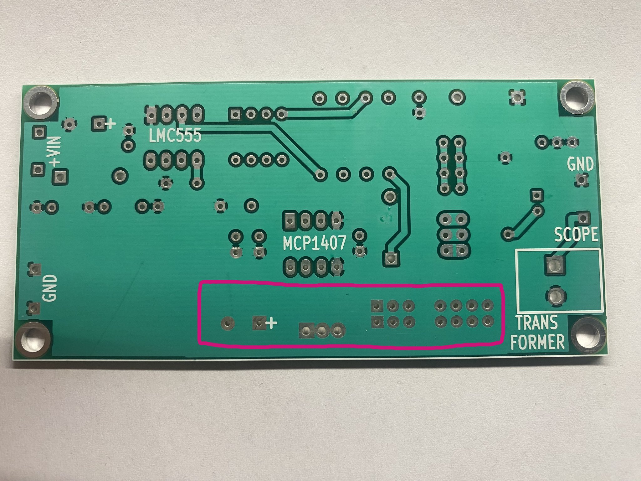

The sockets for C2 and C3 have many many pins, which allows you to plug in a huge variety of different capacitors, regardless of lead spacing. If your capacitor has very small lead spacing, plug it into the socket holes which are close together. If your capacitor's leads are spaced very far apart, plug it into the socket holes which are far apart. Here is a photo of a completed V4 Quasimodo with a very small capacitor C2 (gray box). It is plugged into the socket holes which are closest together. As you can see, the socket can accommodate a C2 with much longer body, if required.
To make this possible, all six socket pins for TERMINAL-1 are shorted together, as you observed. All eight socket pins for TERMINAL-2 are shorted together as well.

It's clean what you wrote. But the all pads of the selected area are shorted together through ground. I do understand that the error is at my side, and lots of successful implementations were done. But how can I explain it to the pcb supplier?The sockets for C2 and C3 have many many pins, which allows you to plug in a huge variety of different capacitors, regardless of lead spacing. If your capacitor has very small lead spacing, plug it into the socket holes which are close together. If your capacitor's leads are spaced very far apart, plug it into the socket holes which are far apart. Here is a photo of a completed V4 Quasimodo with a very small capacitor C2 (gray box). It is plugged into the socket holes which are closest together. As you can see, the socket can accommodate a C2 with much longer body, if required.

In my opinion, you probably did nothing wrong and the error was made by the PCB manufacturing house. As you mentioned, the Gerber files are known to be good and they have been successfully fabricated by hundreds of diyAudio members at PCB fabs around the world.
I have a few suggestions for things you can do.
1. Make sure you sent the file whose name is exactly qmodo_TH_Gerbers_for_seeed.zip to the PCB fab.
2. Check whether your PCB fab's website includes a "Gerber Viewer" page or tab or app. Use that to view the Gerber file which you sent them. Study the area of the bottom PCB layer where your error occurred, and check whether their software thinks those pins SHOULD be shorted. (the correct answer of course is "no they shouldn't"). If you see the pins NOT shorted, take a screen capture image of that area and complain to the fab that they built your boards with errors and you want an immediate refund.
3. Choose a different PCB fab and place a new order for boards there. Personally, I am fond of JLCPCB.com and I wrote this little tutorial about buying boards from them. Lots of diyAudio members around the world have used JLCPCB.com successfully. They are usually the lowest price supplier too.
4. Create a new thread in the swap meet forum of diyAudio saying: Wanted To Buy, 3 PCBoards of Quasimodo Thru-Hole V4 . Also post a message here on the Quasimodo thread saying the same thing.

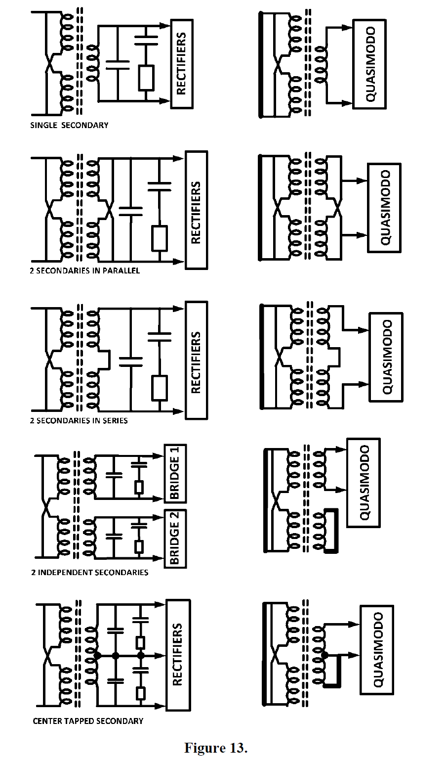

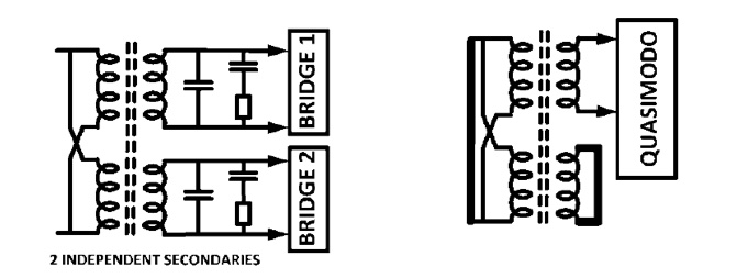

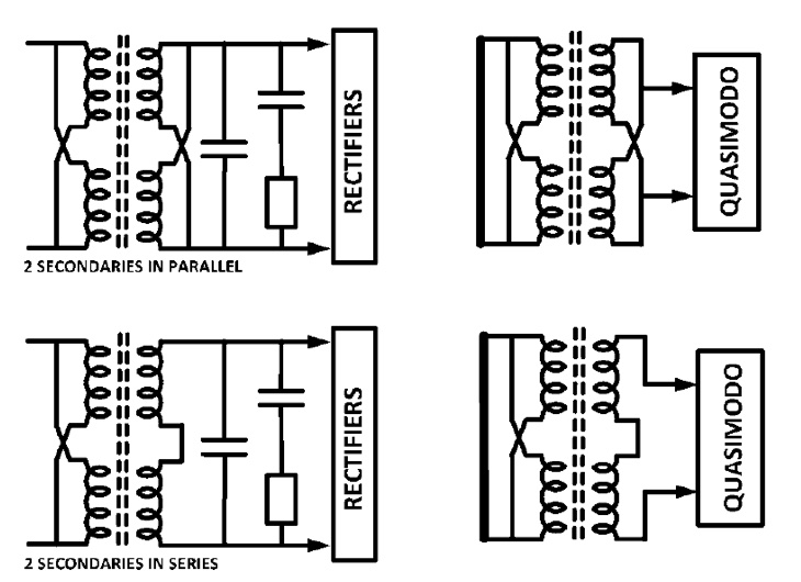

Complete newb here. I’m calculating R for the AnTek AS-1218 and am confused on why the shape is different when the coils are in parallel vs. a single coil? The results from the parallel connection is a bit deformed compared to a single coil. The single coil is textbook.
Please post two drawings, similar to Figure 13 of the Quasimodo Design Note, showing exactly what you mean by (a) "when the coils are in parallel"; and (b) "a single coil".
Be sure to copy the Fig 13 style; show how it will be connected in the final audio equipment on the left, and also show how it is connected during Quasimodo testing on the right. The thick black lines on the right hand side, are short-circuit connections that you make with alligator clips or wire nuts or blobs of solder, for Quasimodo testing.
_
_
“Please post two drawings, similar to Figure 13 of the Quasimodo Design Note, showing exactly what you mean by (a) "when the coils are in parallel"; and (b) "a single coil".
Be sure to copy the Fig 13 style; show how it will be connected in the final audio equipment on the left, and also show how it is connected during Quasimodo testing on the right. The thick black lines on the right hand side, are short-circuit connections that you make with alligator clips or wire nuts or blobs of solder, for Quasimodo testing.”

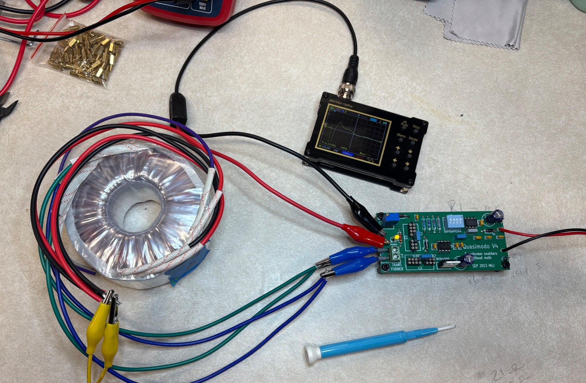

Thanks for replying. Pictured is the diagram I’ve referenced and a photo of my setup up in parallel.

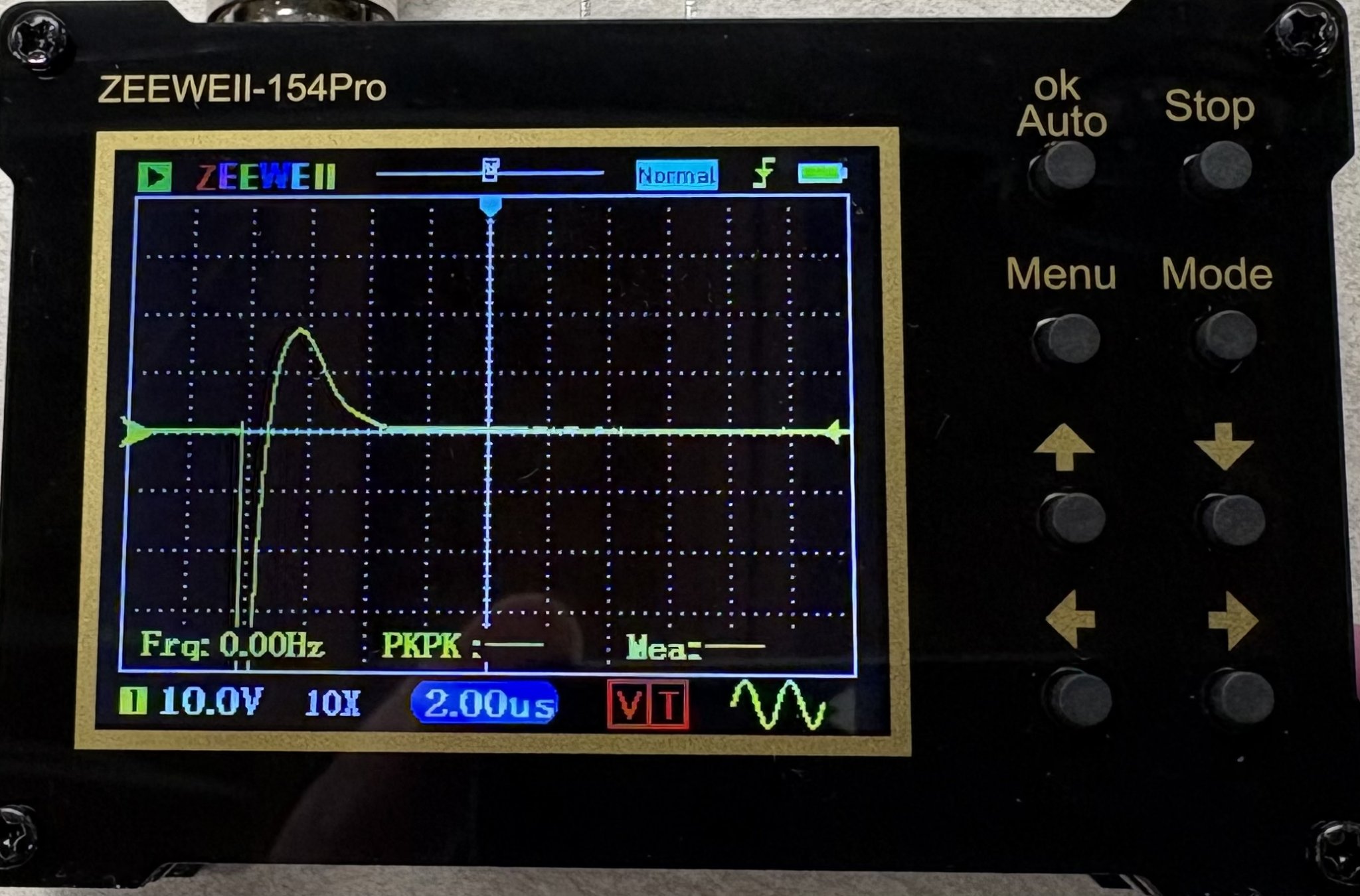

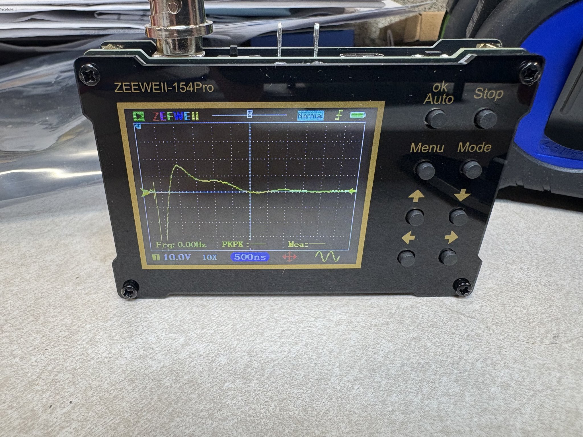

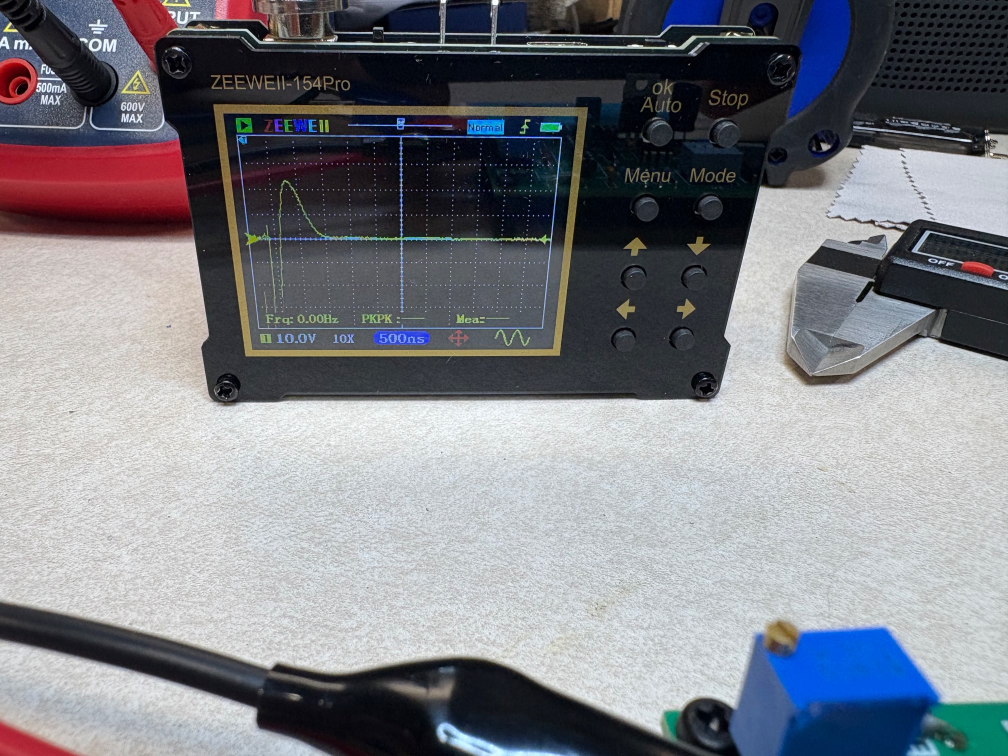

Finding Sadfaces posts have helped a bunch in trying to dampen my AS-1218 wired in parallel. Similar to Sadface, I ended up increasing Cx and Cs to 0.74uf and 0.045uf respectively. Rs is 14 ohms. I have some more capacitors of varying values showing up at the end of the week so I can try more combos.
A photo of the result with Cx = 0.15uf and Cs = 0.01uf with Rs = 22 ohms for reference.
