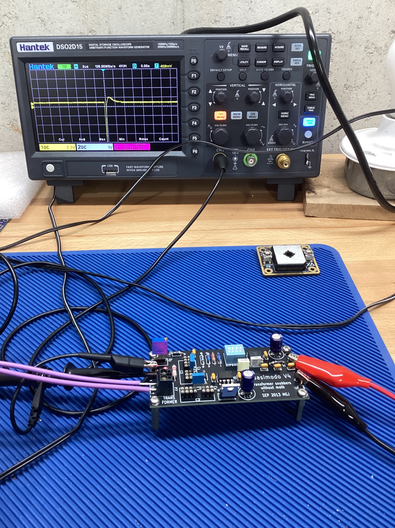

Simple, no-math transformer snubber using Quasimodo test-jig
I could be wrong but it seems a little bit over damped
the target curve should look similar to the red trace in the diagram in post #1
Is this more like it? How do you know when enough is enough? Resistance is 29.8 ohms.

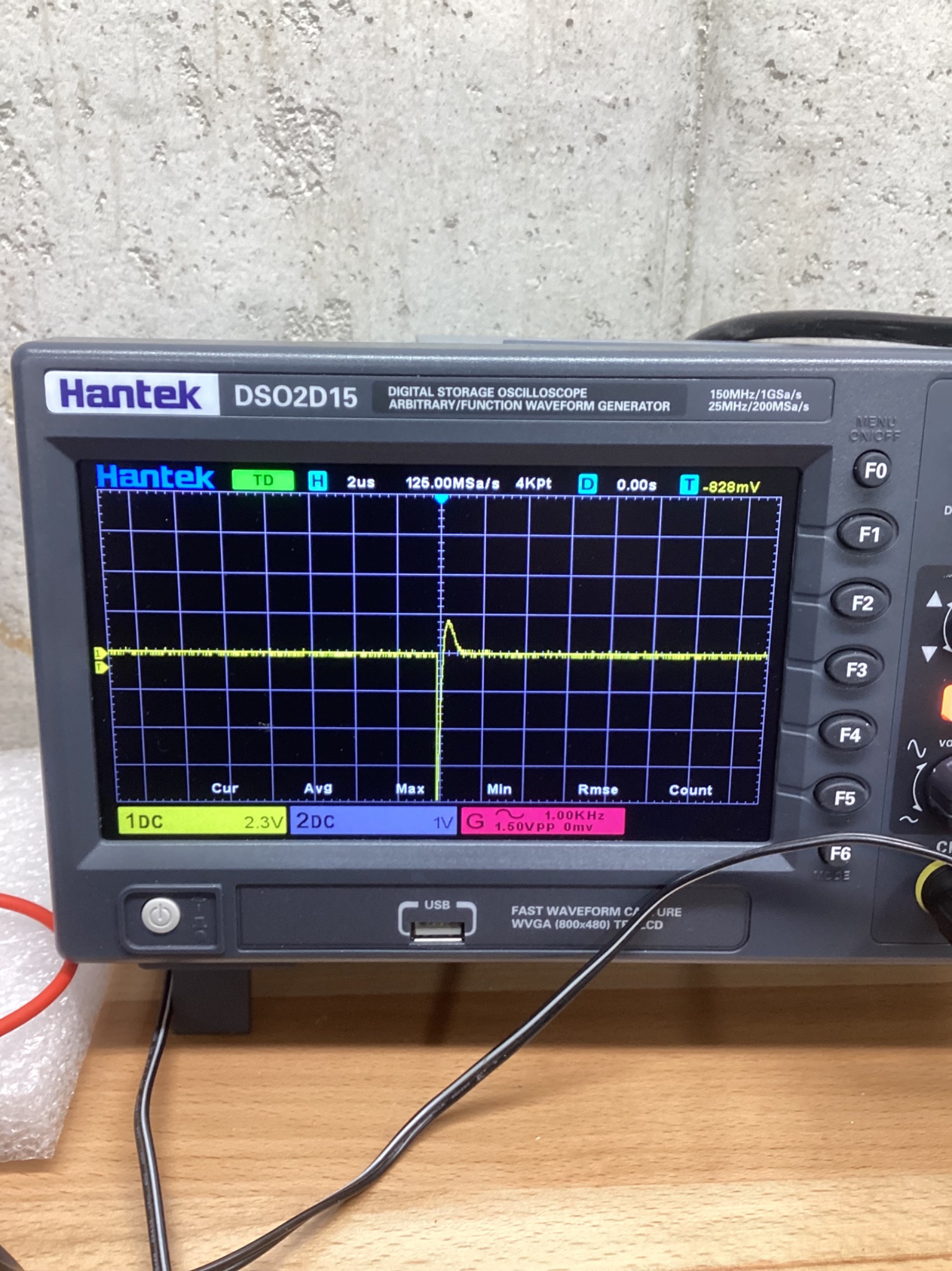

Hi folks, reading more about the use of the Quasimodo I got the impression that if your transformer has dual secondaries, then you should short not only the primary, but the secondary that is not currently under test. In doing that it reduced the resistance needed. So my current resistor snubber should be about 22 ohms.
Let me know if what I see on the scope meets expectations.
Thanks,
John

You are right. I've read Mark's white paper more than once, but shorting multiple secondaries other than the one under test in addition to the primary did not sink in to my understanding. I'm an implementor, not an engineer. When I read technical papers, my understanding of what I read is often limited by my lack of experience with the subject matter. Fortunately for me there are patient people like you and Mark that get me through.

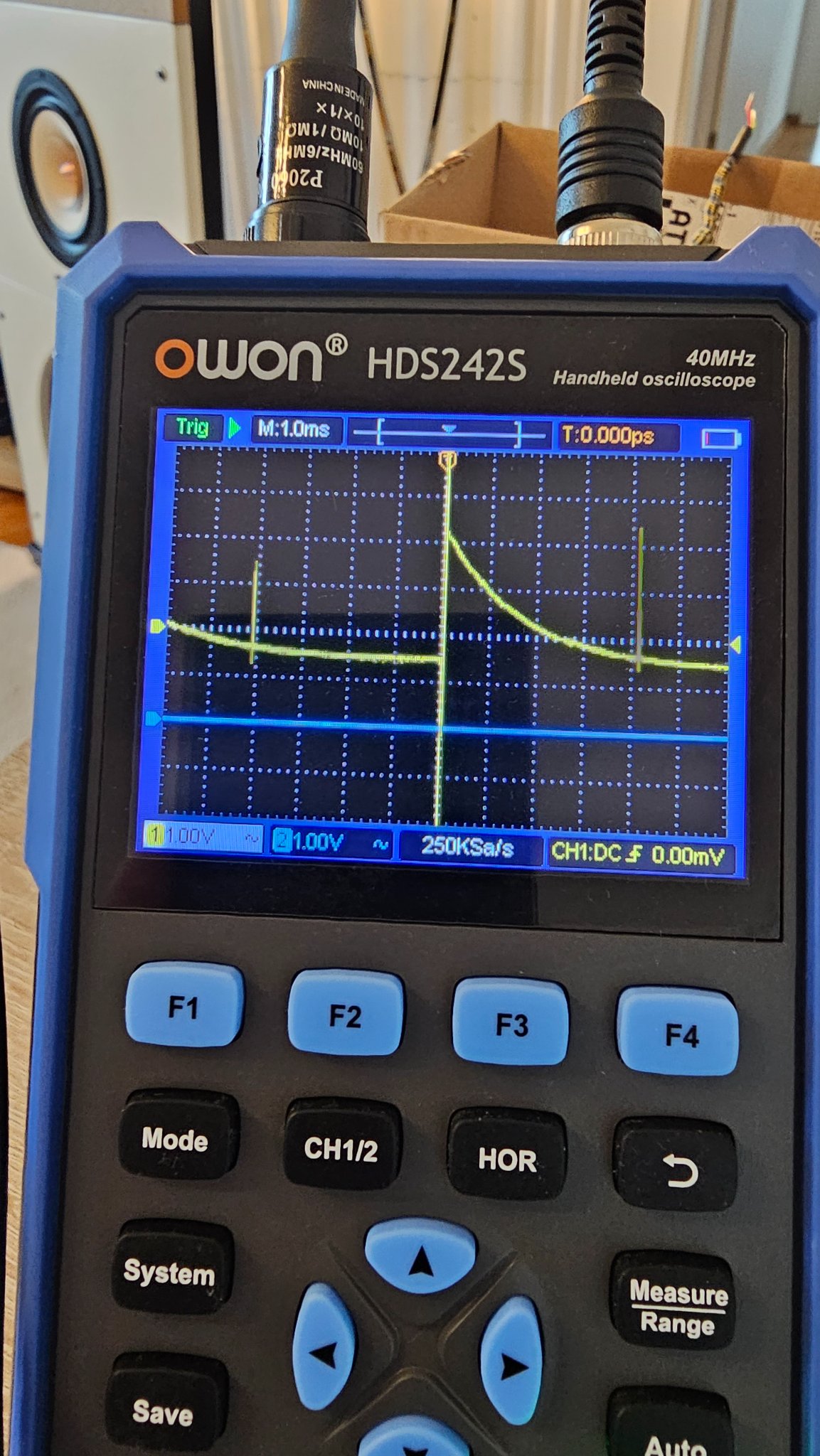

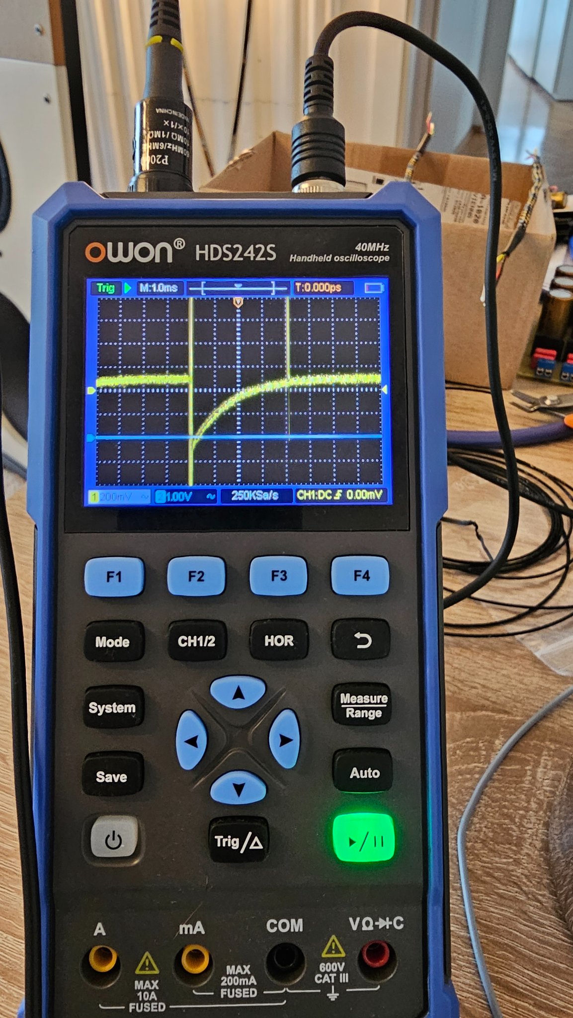

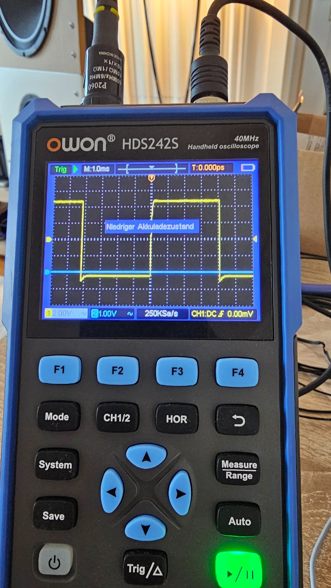

Hi, well...
I think something went wrong.
I get weird signals...
1. picture: signal on C2
2. picture: signal Quasi output without snubber pot
3. picture: signal Quasi output with snubber pot
I think it's not how it should look 😕
