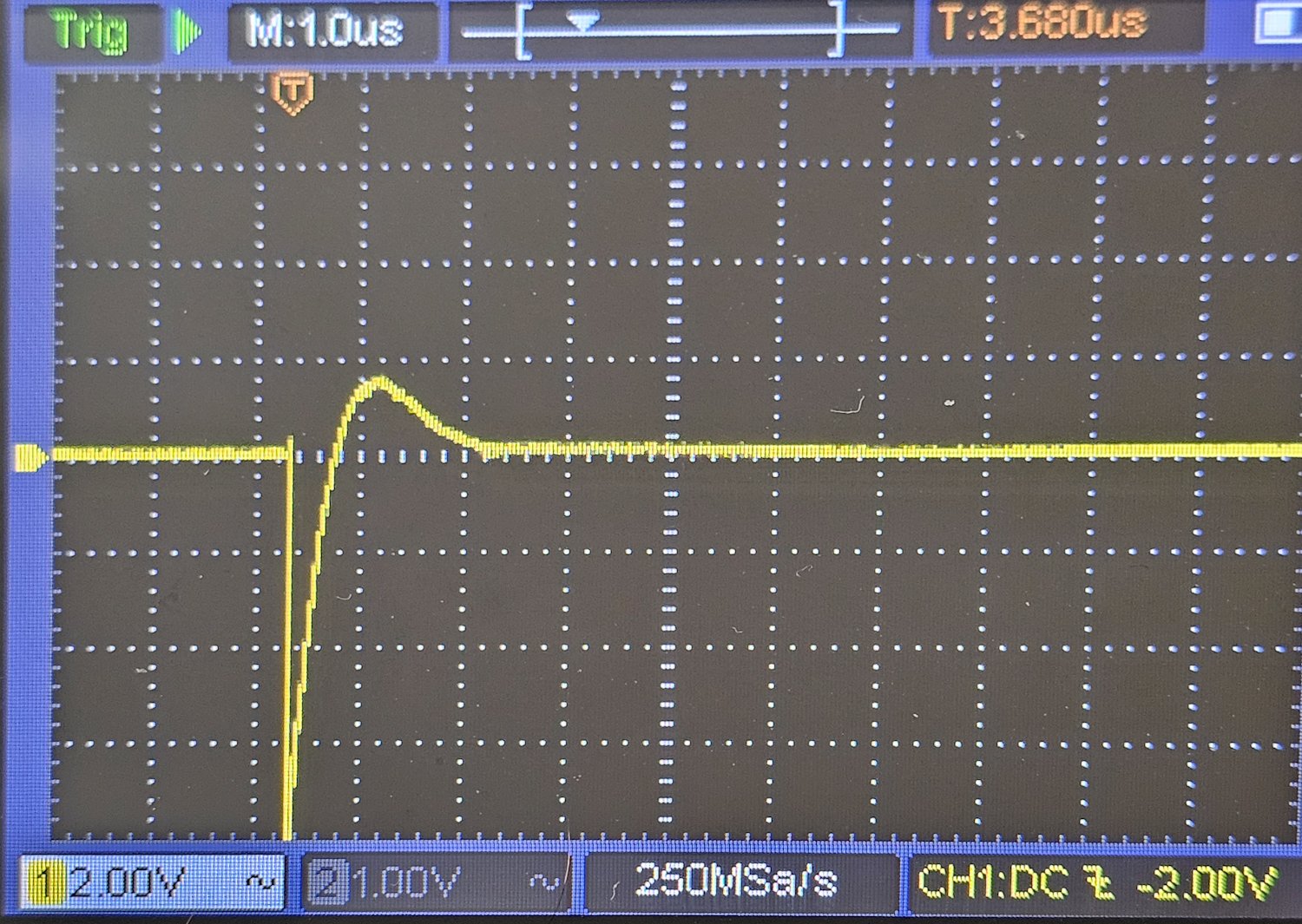

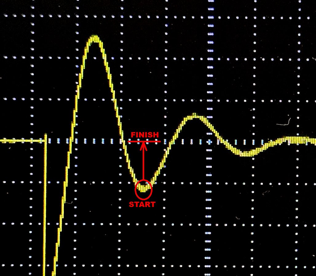

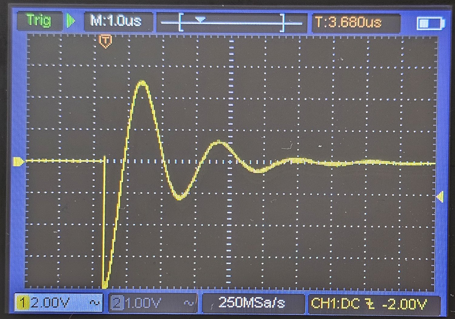

Okay, I set up everything again, after reading every write up from @Mark Johnson and now it really works without issues - lession learned: RTFM! And with this correct setup I get 33,1 ohms for the Toroidy TTSA0020 with shorted 230 VAC primary and 2x15 VAC secondaries, one of them shorted (caps 150 nF/10 nF).
Setup is: trigger set to - 2 volts (the minimum possible value) and falling edge, T 1 us.
Could someone please tell if it is correct, based on the graphs? Many thanks in advance.

John, I have only 1 probe, so followed Mark's recommendation for this case.
With one probe, you should make proper settings and I think you could use my settings. Probe to the Quasimodo scope pin, trigger of the scope at -4 volts (my limit is -2 volts but it works too) and falling edge, time 1 us, channel voltage range 2 volts, sensor and scope sensitivity must be the same.
Remove the trim pot, turn the Quasi on and you should get a ringing sinusoid thingie. Play with the voltage until the graph is similar to mine, but let the time at 1-2 us. Put in the trim pot without changing the settings (you can see, my settings are identical before and after) and turn it until you get just one bump. I set my trim pot to about 15 ohms before putting it in.

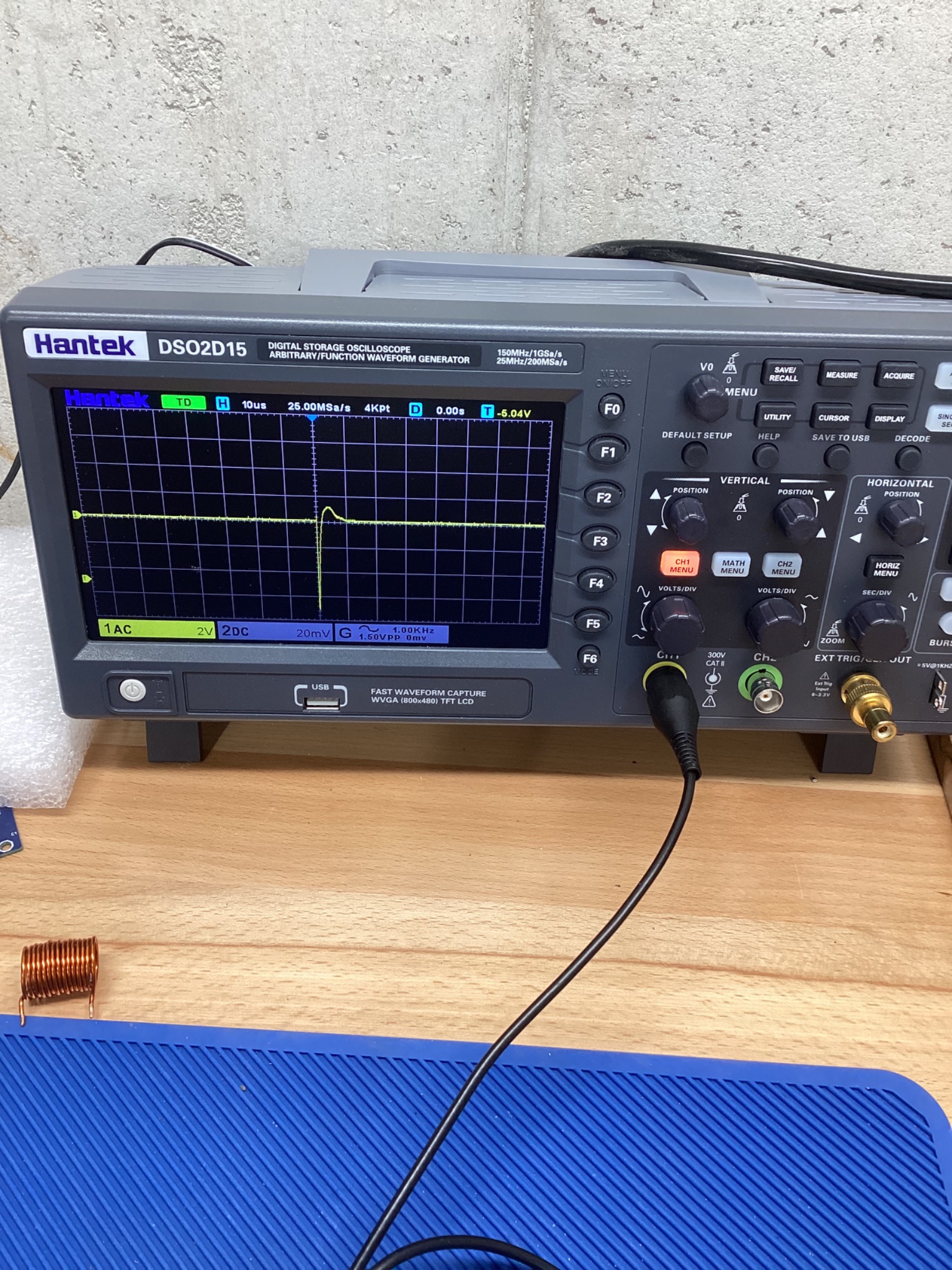

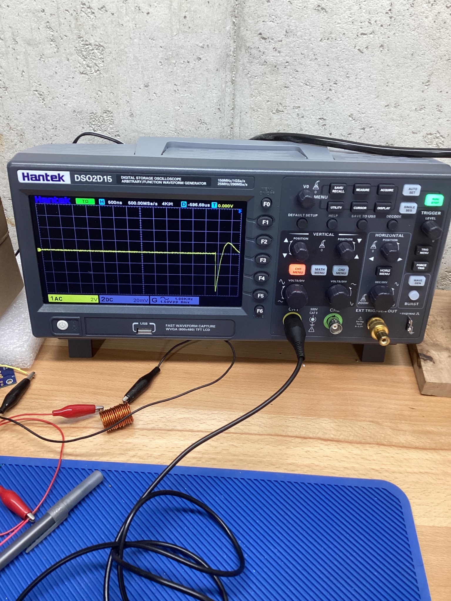

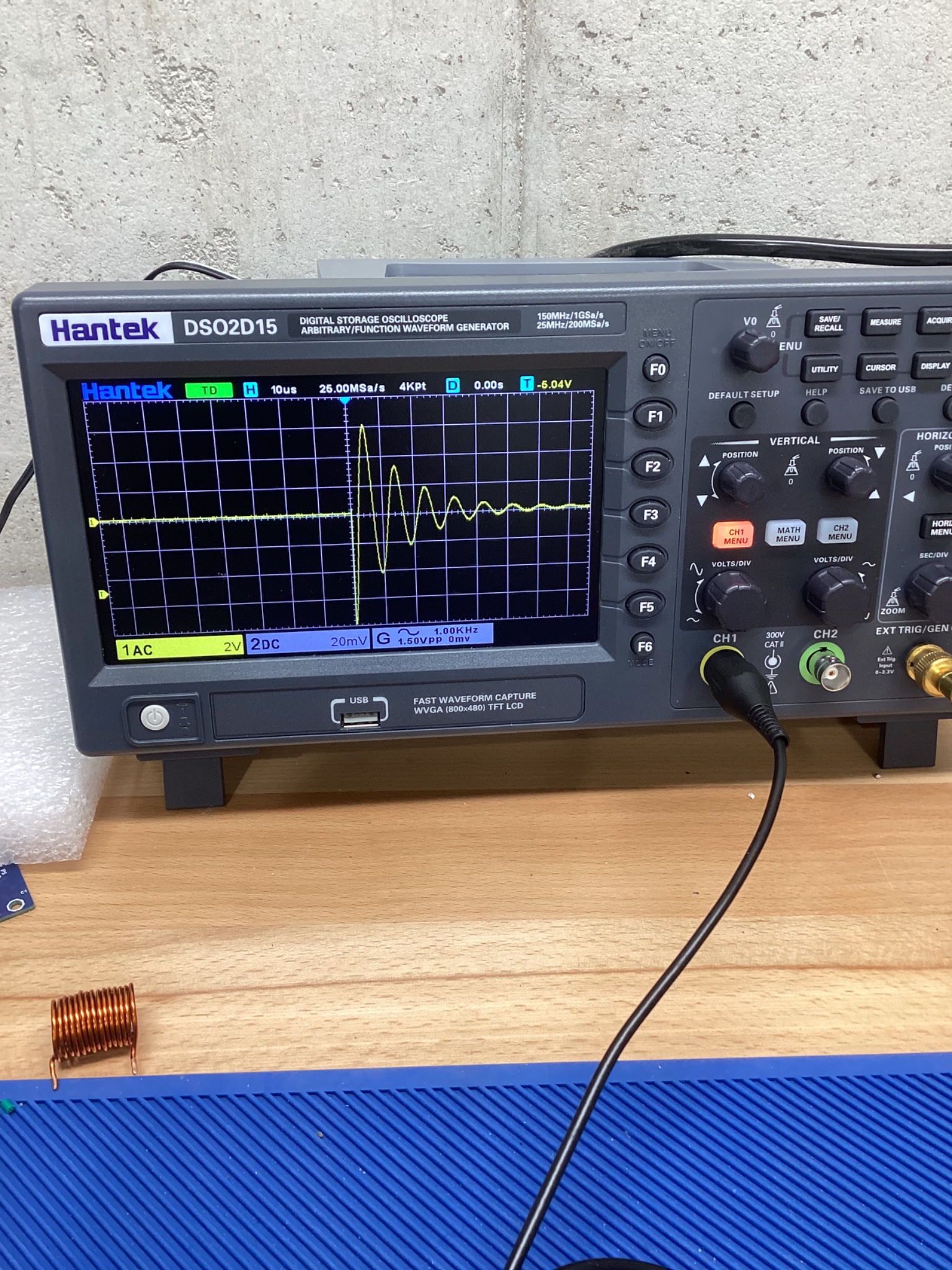

Ok, after twirling the controls on my Hantek DSO2D15 I get what I think are reasonable wave forms. I have a pair of Antek-0218 transformers that I intend to use in a balanced Zen Mod Preamp yet to be built. These are 25 VA transformers with dual 18 V secondaries. I am getting a Rs reading of about 24 ohms on one of the transformers and 88 ohms on the second transformer. This seems to me to be too big of a difference.
I am using one probe and triggering on the falling edge. Does it make sense that the two transformers could measure that differently? The pictures below show one transformer with R5 trimmer out of the circuit and then in circuit. Both secondaries on both transformers measure close to each other, but the difference between the two transformers is making me wonder.....

Jim, the transformers are fine. The problem is me. Both of the Antek secondaries are green and blue. On one of the transformers I mixed the green wire of one secondary winding with the blue wire of the other secondary. Those wires are discontinuous. The second I ohmed out the windings at your suggestion I realized what I had done. Both windings of both transformers require an Rs of approximately 38 ohms.
