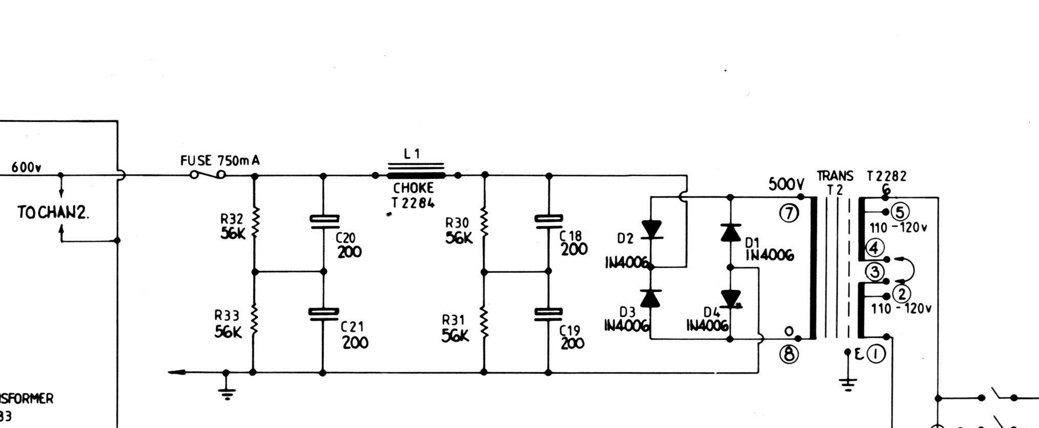

This time I would like to snub the large valve amp's HT transformer. According to the circuit diagram the transformer has a single 500V secondary, with a smoothed B+ over 600V.
Perhaps worthwhile posting a link to the schematic, as that description could be interpreted in a few ways. The working voltage of any snubber cap depends a lot on the secondary winding configuration. As @Bluesystem pointed out, the working current through such a cap increases with capacitance, and deep in a capacitor datasheet you may see rms current limits for a capacitor that could be of concern when some safety margin is included.
Post #1358 of this thread shows the vector calculus ("complex variables") math that allows you to calculate the power dissipation in the snubber resistor, as a function of AC mains frequency, secondary voltage, snubbing resistance value, and series-capacitor value (150 nF in this case).
The expression for RMS current through the capacitor, as a function of those same four variables [mains frequency, secondary voltage, snubbing resistance, and capacitor value] turns out to be a lot simpler. I invite readers to derive it for themselves; it's three lines of algebra on complex variables. When you do, check whether you feel I got the right answer:
For fmains = 60 C.P.S. ; and Vsecondary = 500Vrms ; and Csnub = 150 nF; and Rsnub ranging from 1.0 ohm to 10 Kohms . . . . the AC current thru the capacitor ranges from 24mA RMS when Rsnub is big, to 28 mA RMS when Rsnub is small.​
And it goes without saying: If you want to know the AC current thru the capacitor for another set of assumptions (fmains ; Vsecondary ; Csnub ; Rsnub min to max) -- just plug your expression for current into a spreadsheet and schmeer Rsnub from small to big in steps of 10^(1/12) which is an excellent approximation of the EIA Standard "E12" series of values.
Reactions: chiily
This is the schematic of the PSU. That amp is a Radford TT 100, hybrid SS/valve.
First, the size of a a 600V AC 150nF capacitor is significant. For example the low cost 150nF 600V AC Kemit pat number R76QN31505050J is about 1" long and 3/4" wide. This is pretty big when you need two for a center tapped transformer setup.
Second, a high value snubber capacitor will draw more current at very high voltages and so snubber resistor dissipation will rise. The reactance of a 150nF capacitor at 60Hz is 1/(150e-9 * 2 * 3.14 * 60) = 17.68k
This was the section of @Bluesystems post that drew my interest, dragging forward those electronic lecture from many, many years ago 🙂
Popping in some UK figures for a 150nF cap at 50Hz is 1/(1.5e-7*2*Pi*50) = 21.2k
Like @Bluesystems that would generate a significant constant draw from the secondary side of the HT transformer, and the cap/resistor being about to cope with powers of 12W, do able for a resistor but for a capacitor (my electronic lecture memory has now petered out to a rough path!)
Like @Bluesystems a reduction in the Cs seems appropriate with a 2.2nF for Cs raises the reactance to 1.5M.
Apolgoies if I'm just retracing @Bluesystems post. I've not yet read the whole thread.

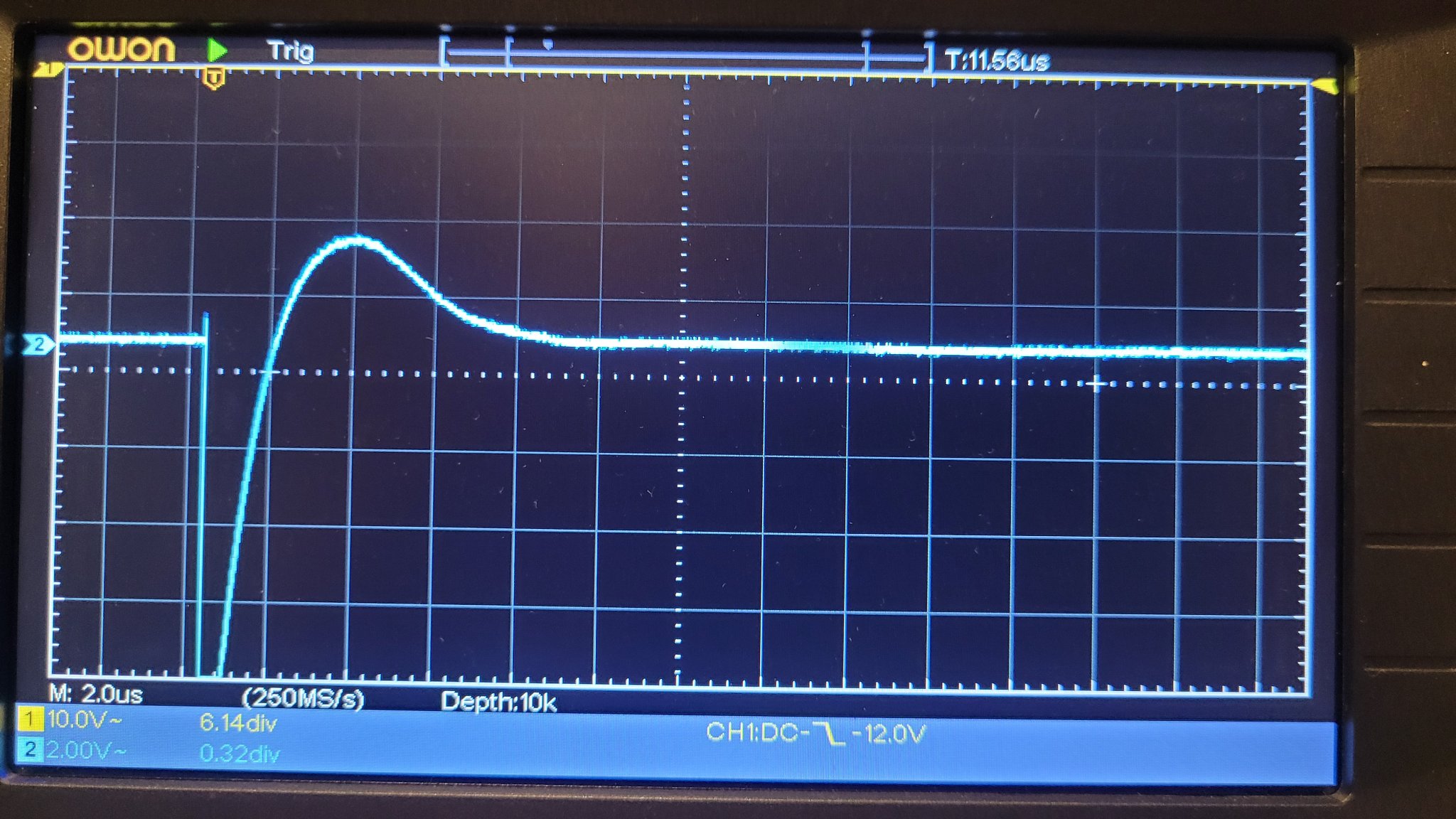

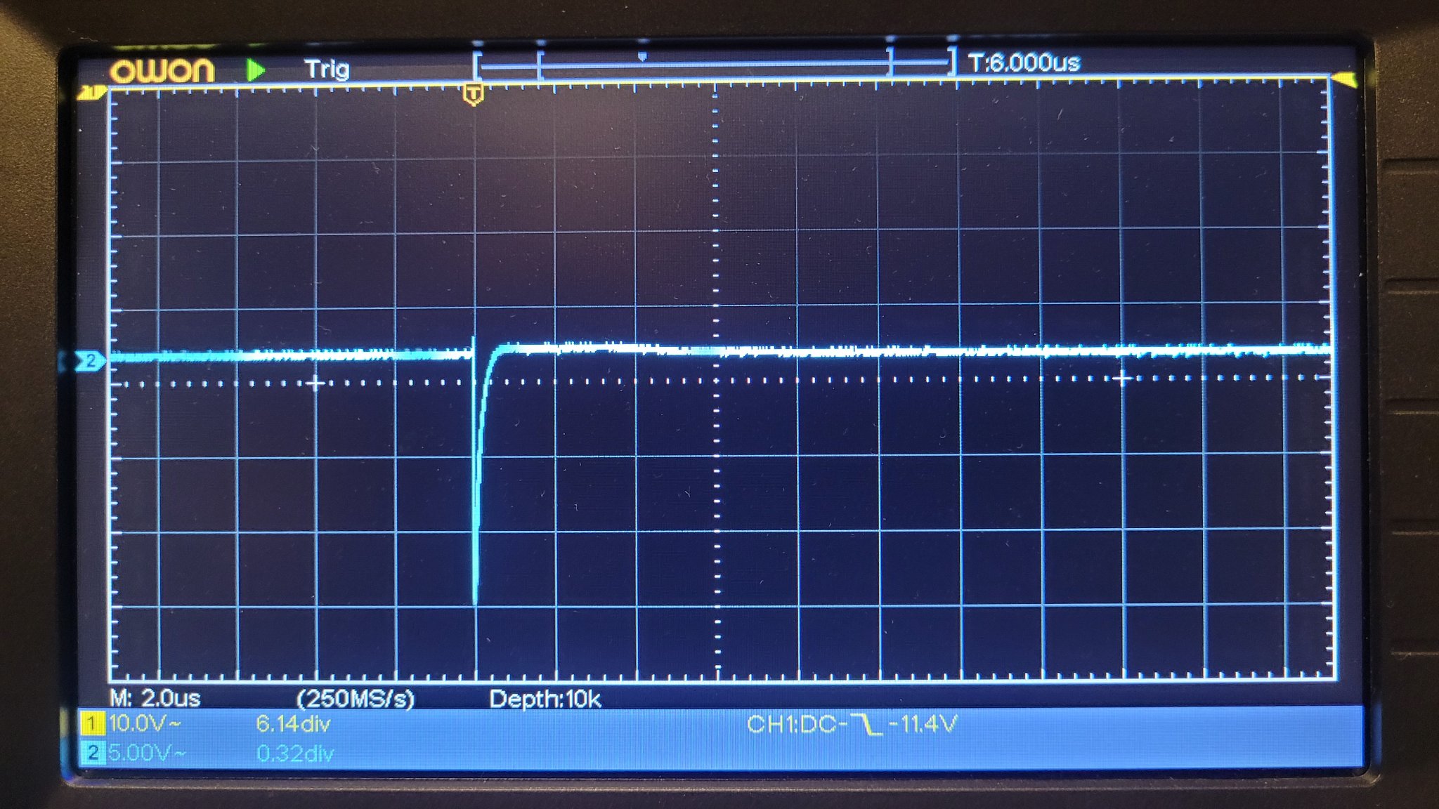

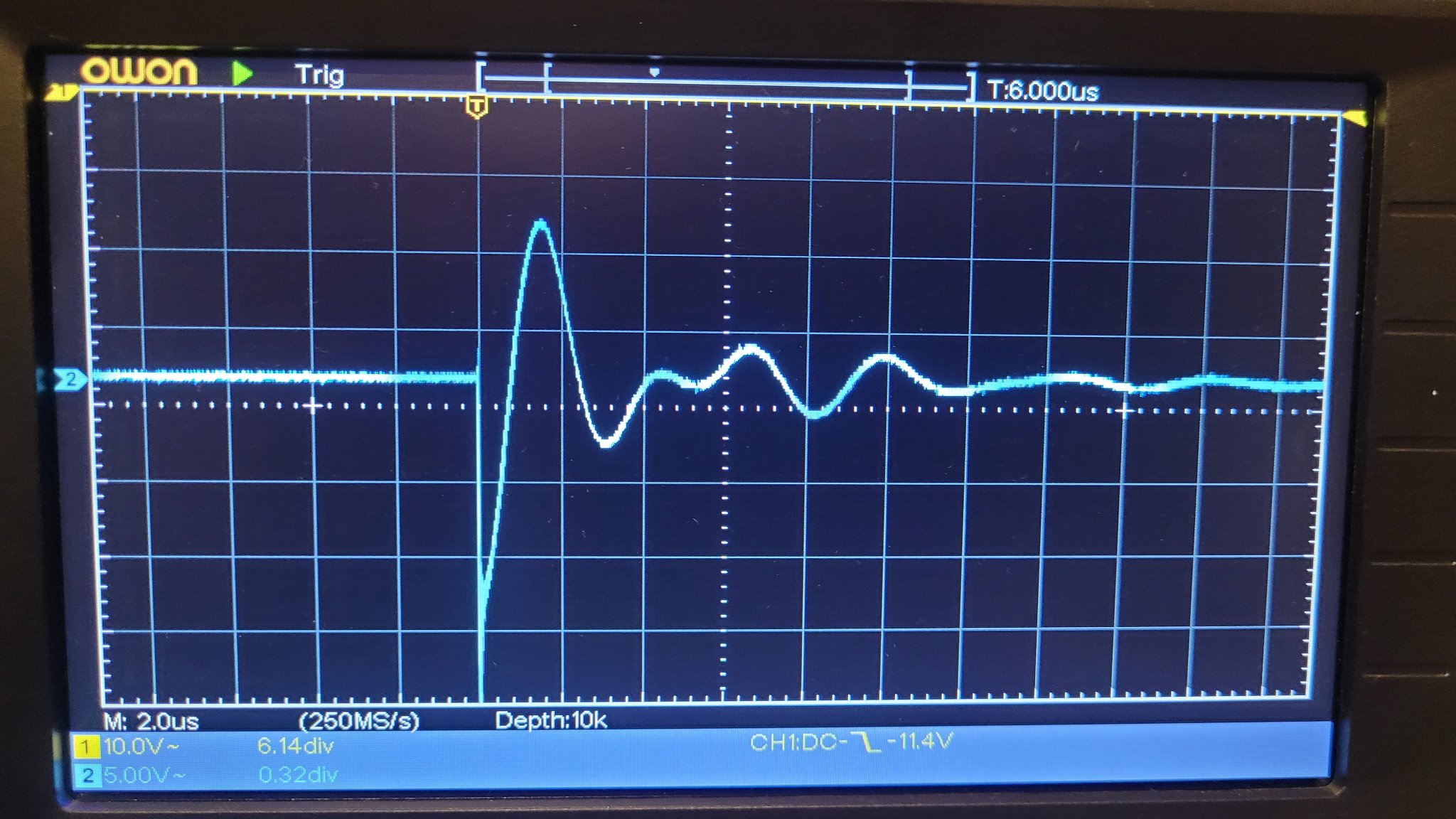

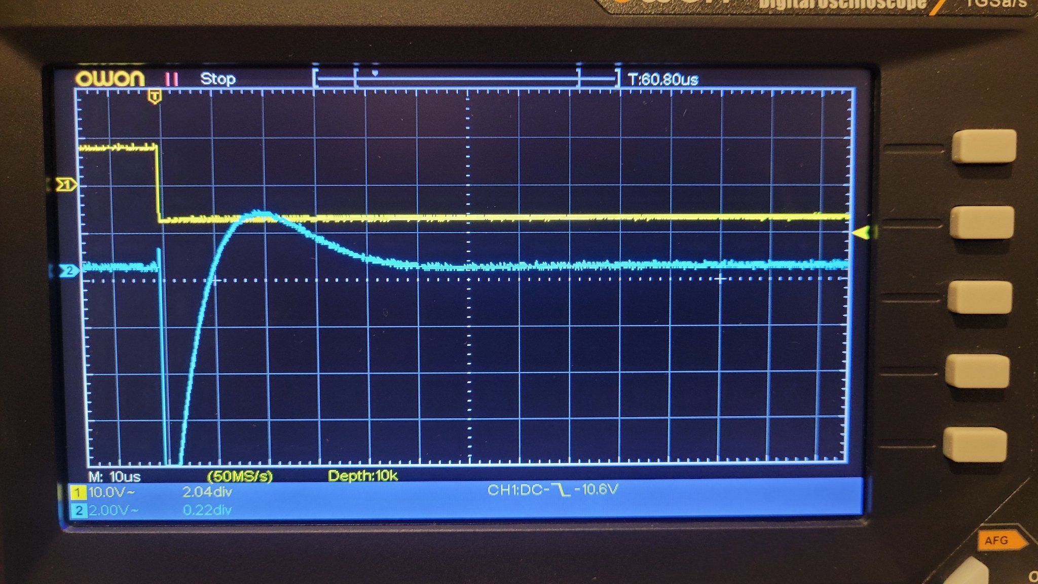

G'day Guys,
I have manged to build myself a Quasimodo without any magic smoke escaping.
I am attempting to get my head around where exactly zeta = 1 actually is.
I am testing a pair of custom wound power transformers for a tube preamp project.
230Vac primaries.
230Vac @60mA B+
12.6Vac @ 2A H+
Lets see if I have this right.

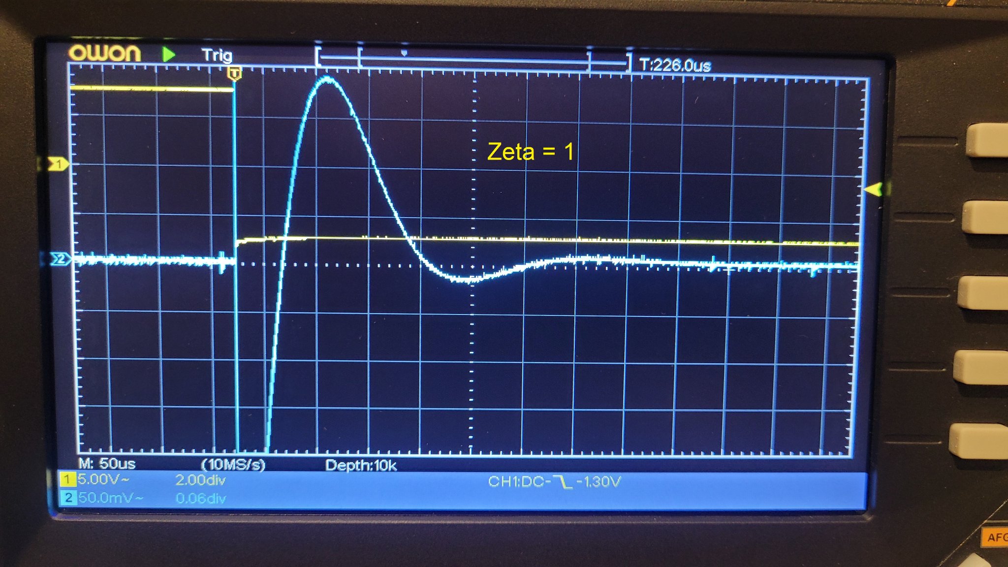

All measurments taken with Cx10nF Cs150nF

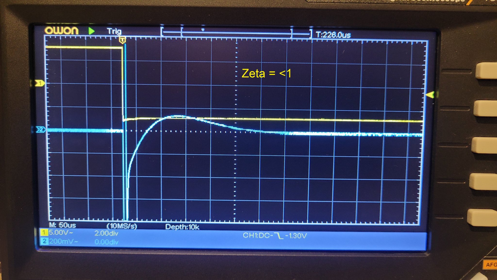

First up the B+ for transformer
Transformer 1 Rs = 167R
A little bit under-damped due to the almost vertical peak after the trough but not too far off as it settles quickly thereafter.

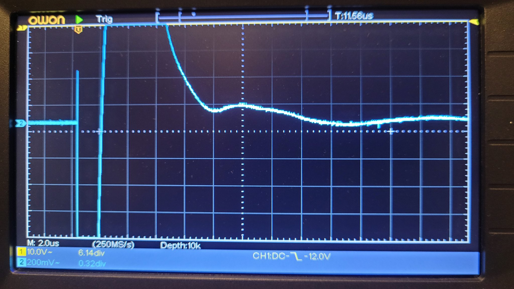

Transformer 1 Rs = 117R
I think this is the point of Zeta = 1 as the ring settles almost immediately.
Transformer 1 Rs= 83R
I think here we are over damped as the ringing is getting worse again.
Transformer 1 Rs= 54R
I think here we are at badly over damped.
Did I pass the first test?

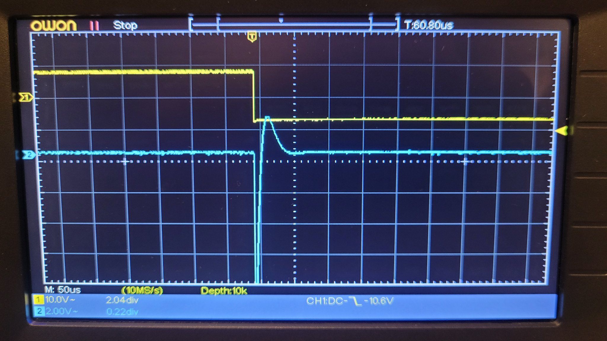

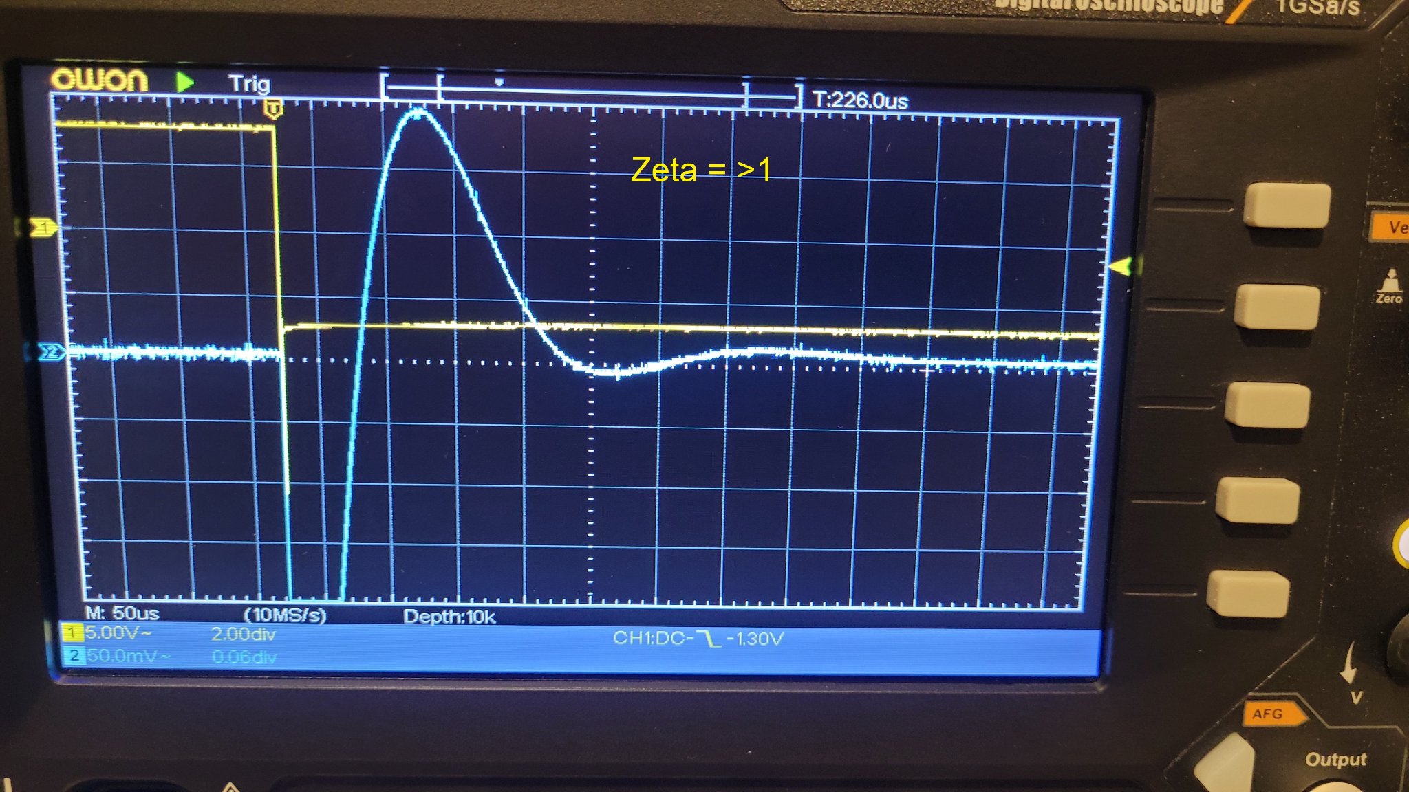

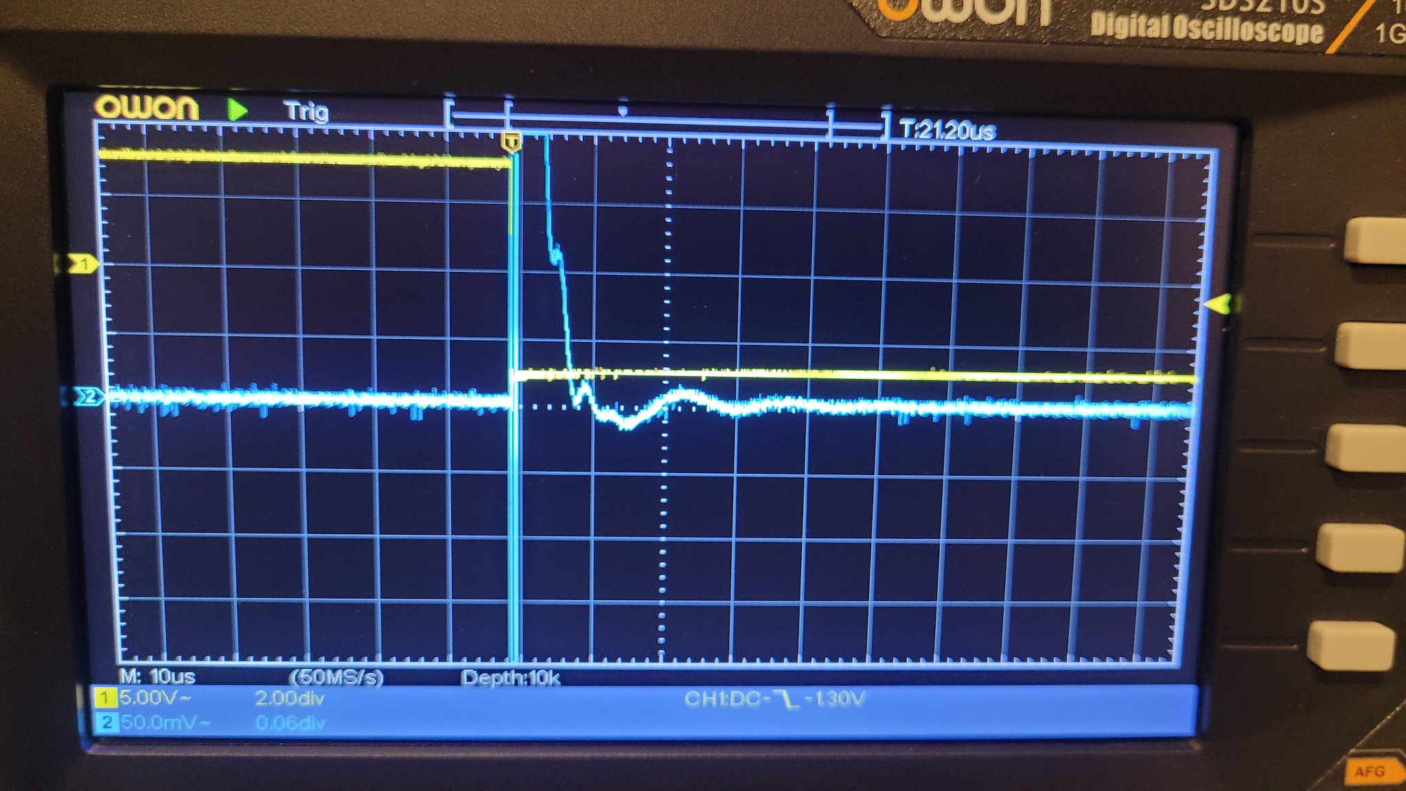

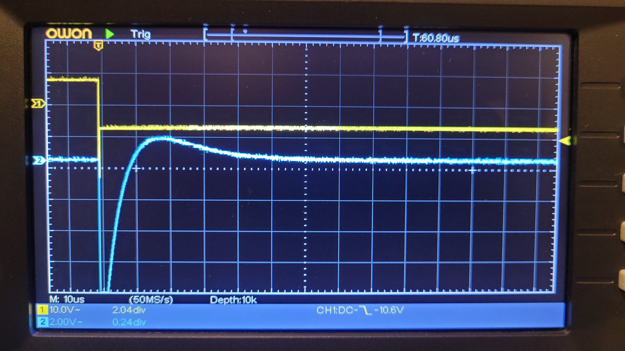

Ok, I have re-read the textbook and researched and hopefully understood the nature of the lumpity.
Here we ago again.
Cx = 0.010uF, Cs = 0.15uF. Rs = 883R. Almost damped. Zeta = 0.4 I think
Rs= 654R. 2nd lumpity bumpity juuuuust dissapearing.
Rs = 553R. 2nd lumpity bumpity gone.
Rs = 465R. Zeta greater than 1
I think I now have my homework correct.
I would think that any 2-3w resistor around the 600R mark would be appropriate.
Did I pass this time?
I myself would choose either 654R by itself, or else a value halfway between 654 and 553, namely 604. Or any EIA standard value within 10-15% of that, which happens to be cheap and easily available from my preferred suppliers.
Please do not forget that the full and complete scientific term is lumpity-bumpity . The oscilloscope wiggles poke up and they also poke down.

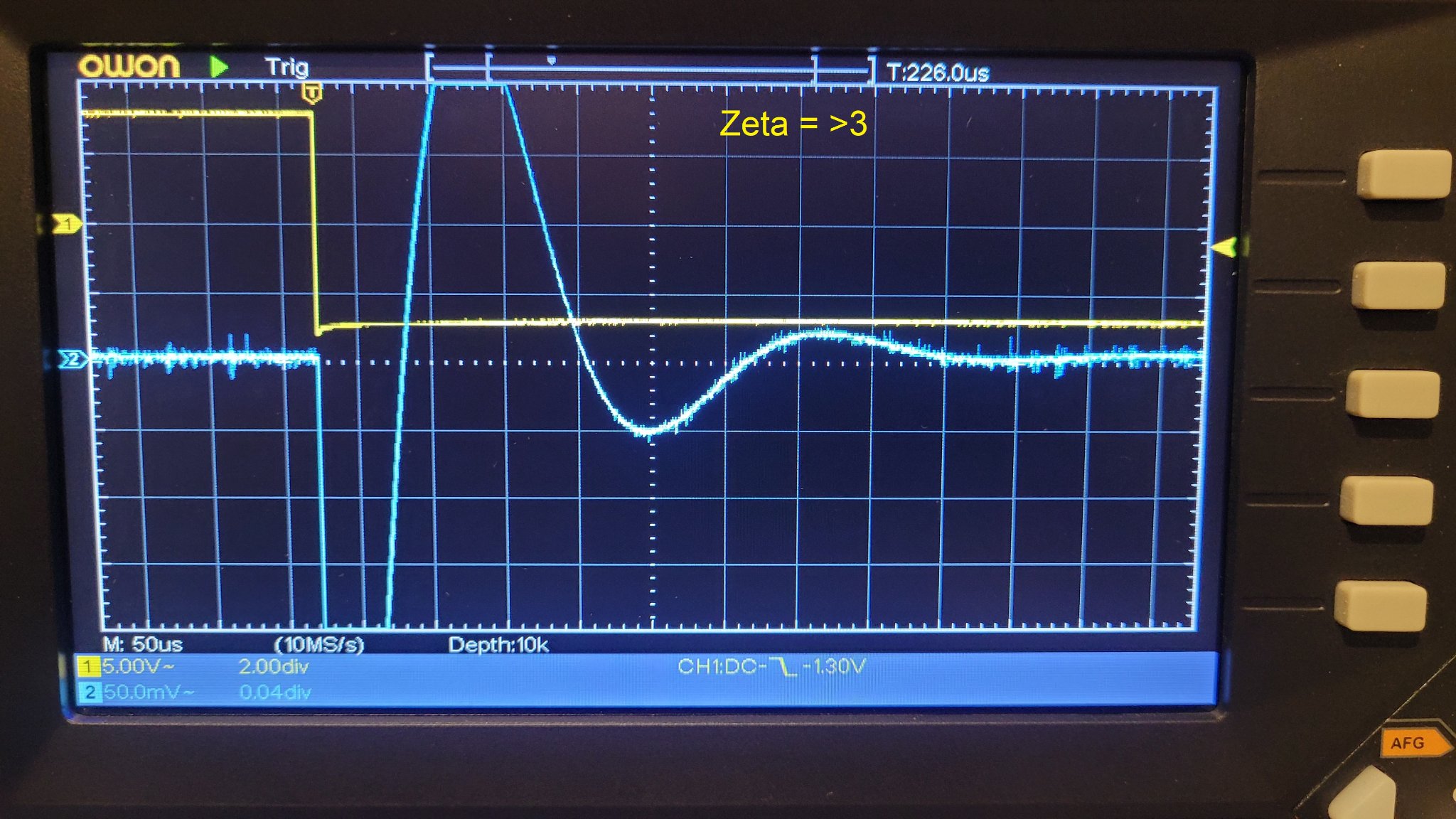

Right.

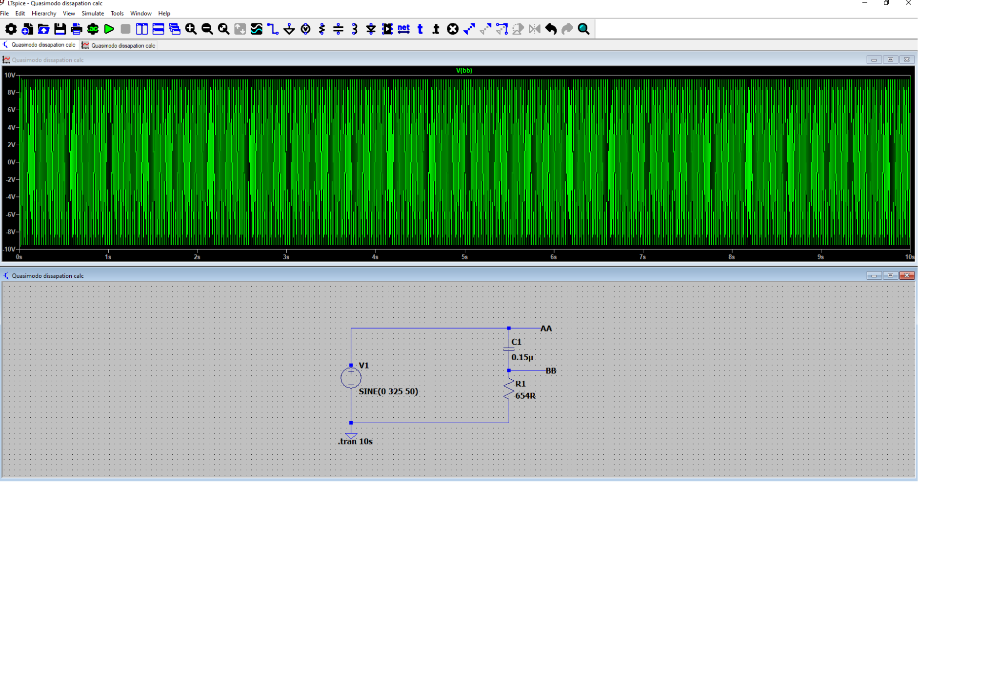

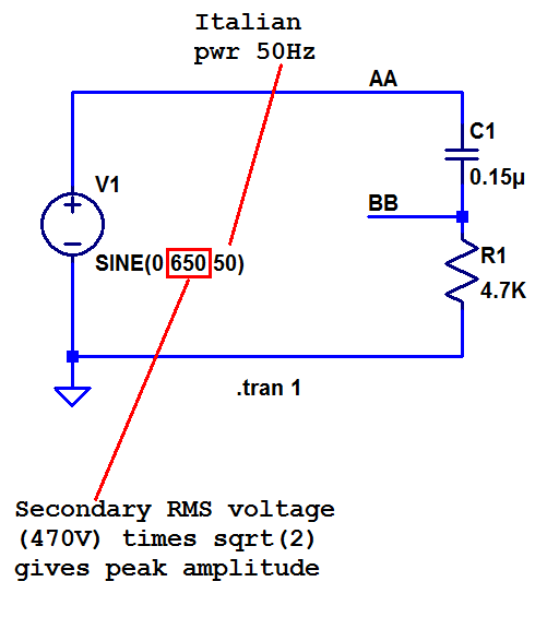

Now the next homework assignment. Dissipation of Rs.
I have followed the example given here:
And made this:
The secondary is 230v. NZ mains is 50Hz.
Measuring point BB
Assuming I have the above right:
20Vpp = 7.07Vrms (according to an internet calculator)
I = E/R
= 7.07/654R
= 0.0108A
P = E x I
= 7.07V x 0.0108A
= 0.076W
Near enough to correct?

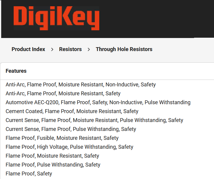

Yes everything in #2577 is applied correctly and a correct answer has resulted. Congratulations! My own personal preference is to specify resistor wattages at least 3X greater than the anticipated worst-case dissipation in the real equipment. Hey that's just me. So I'd feel good about a 250mW flameproof resistor in that position, and I'd feel even better about a 500mW flameproof resistor. Why flameproof? Because if the gear happens not to be plugged into a surge protector, and a 5000V mains surge comes along, that may apply a super high voltage pulse across the snubbing resistor and we don't want it to set the amplifier on fire. Flameproof resistors are easy to find -- see below -- and easy to buy. Spend an extra twelve pennies on an insurance policy; it's cheap peace of mind.
Reactions: mlloyd1 and Monk55
Flameproof it is. I will aim at the vishay PR02 series. 2w, flameproof and not too expensive.

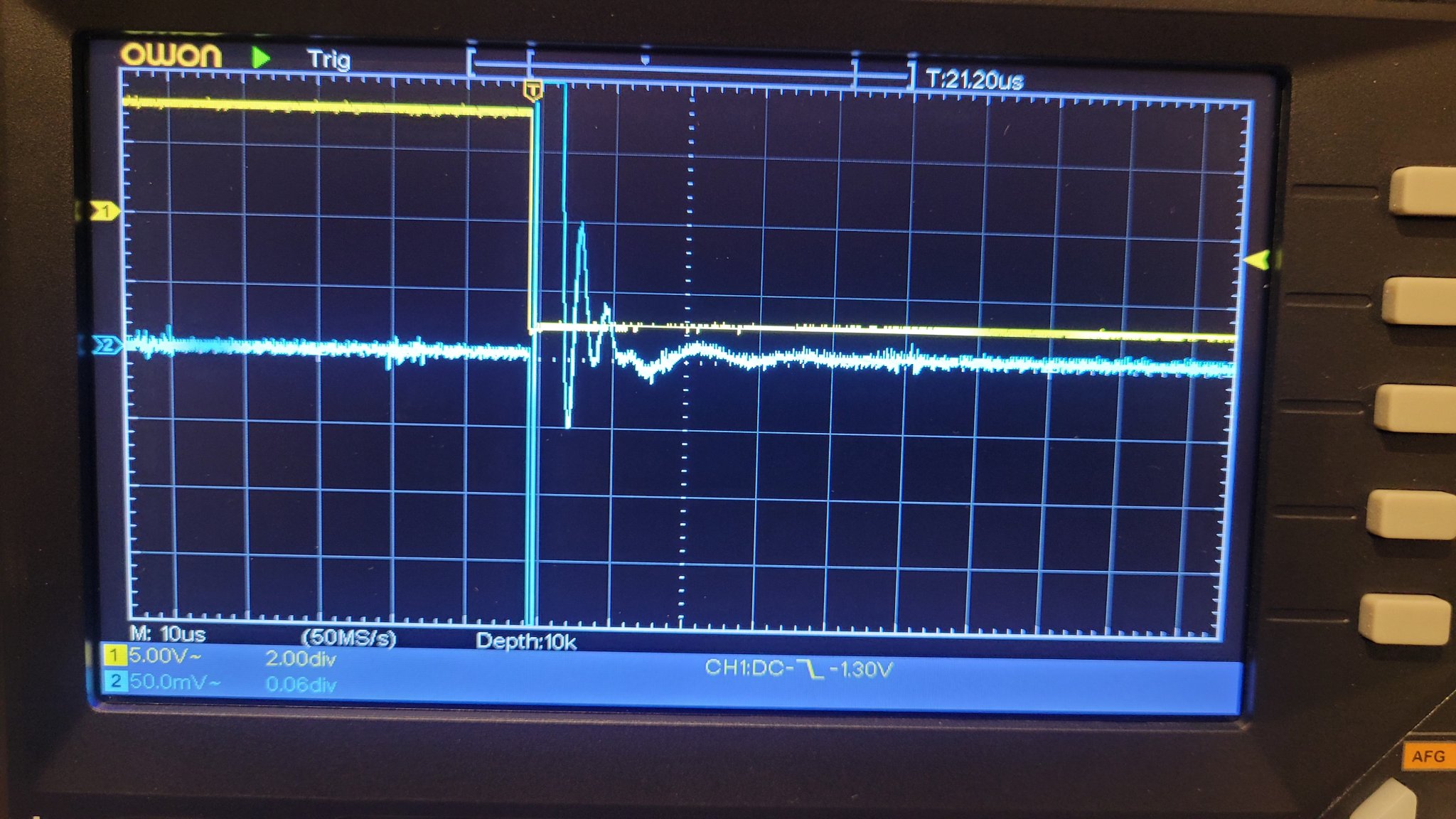

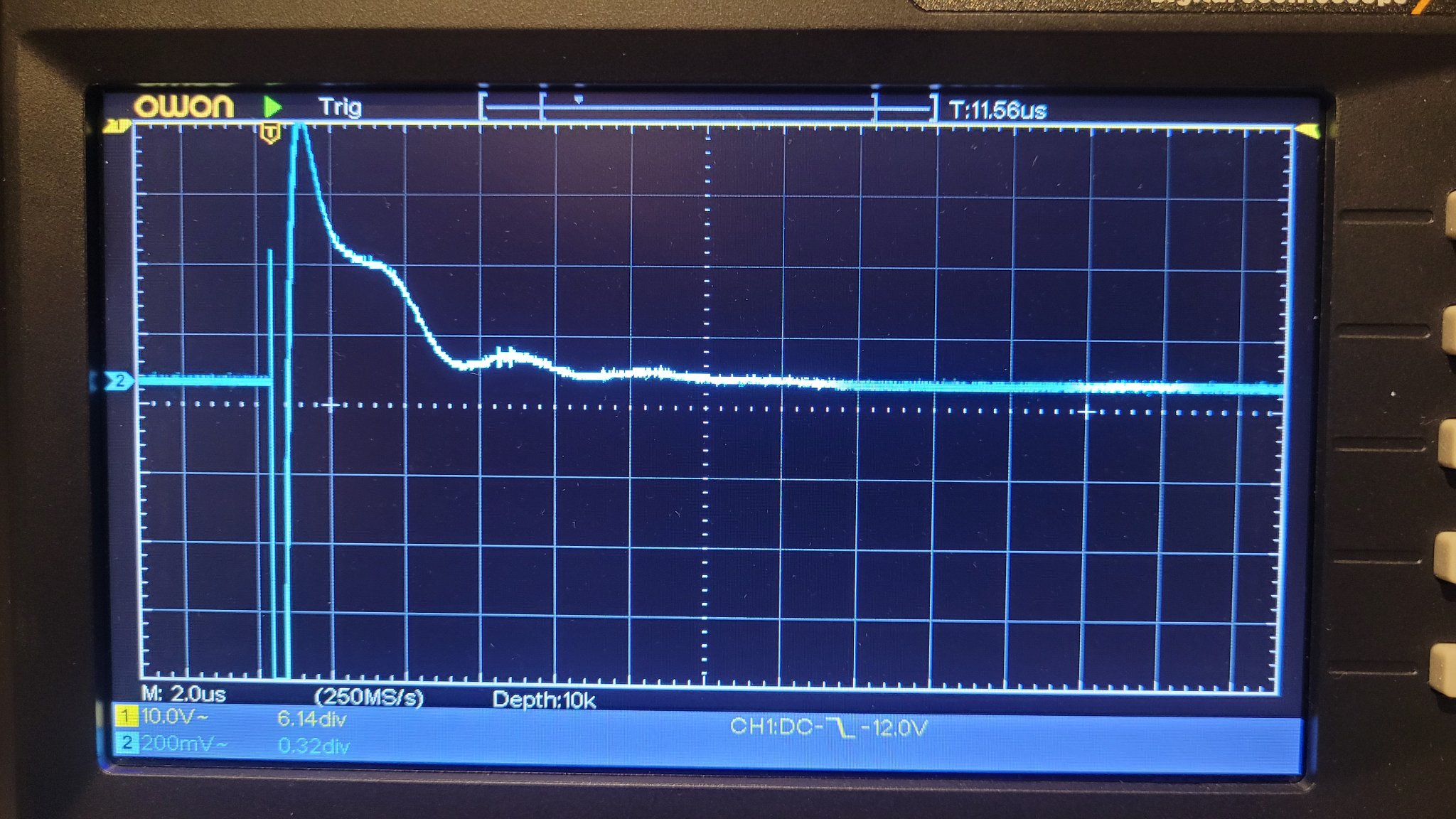

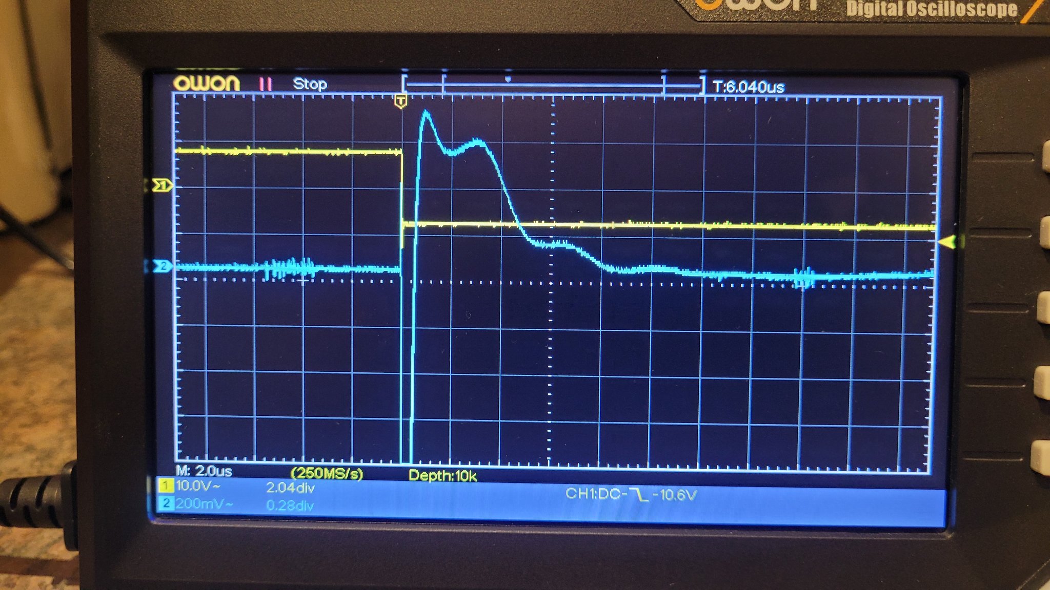

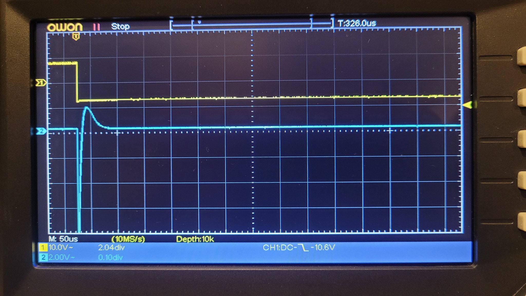

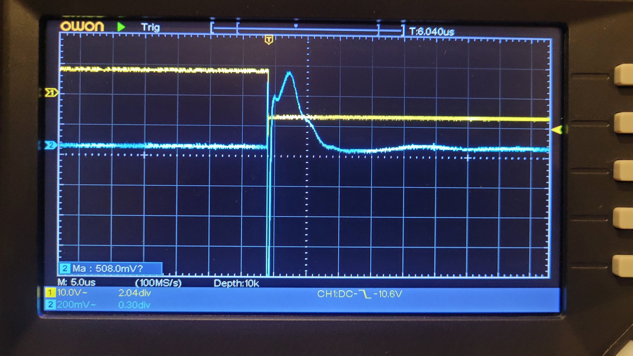

Now for the next challenge. The heater secondary.
This one has stumped me a bit. The secondary seems to require a very low resistance but the magnitude of the oscillation is low when un-damped.
With the same Cx = 0.01uF, Cs = 0.15uF, I get these traces:

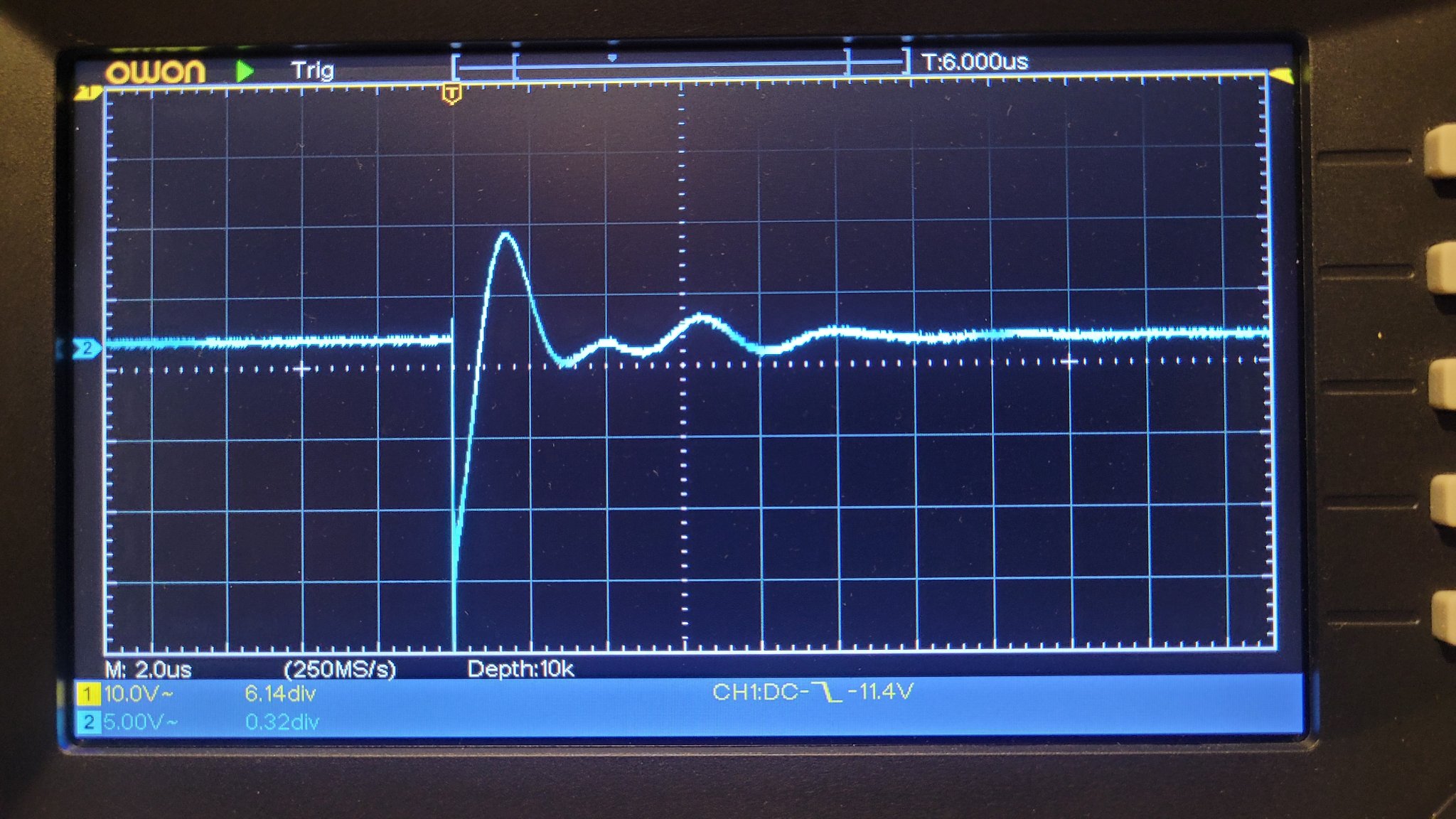

Rs = 20R
Rs = 16.6R
These are the best looking traces that I can get.

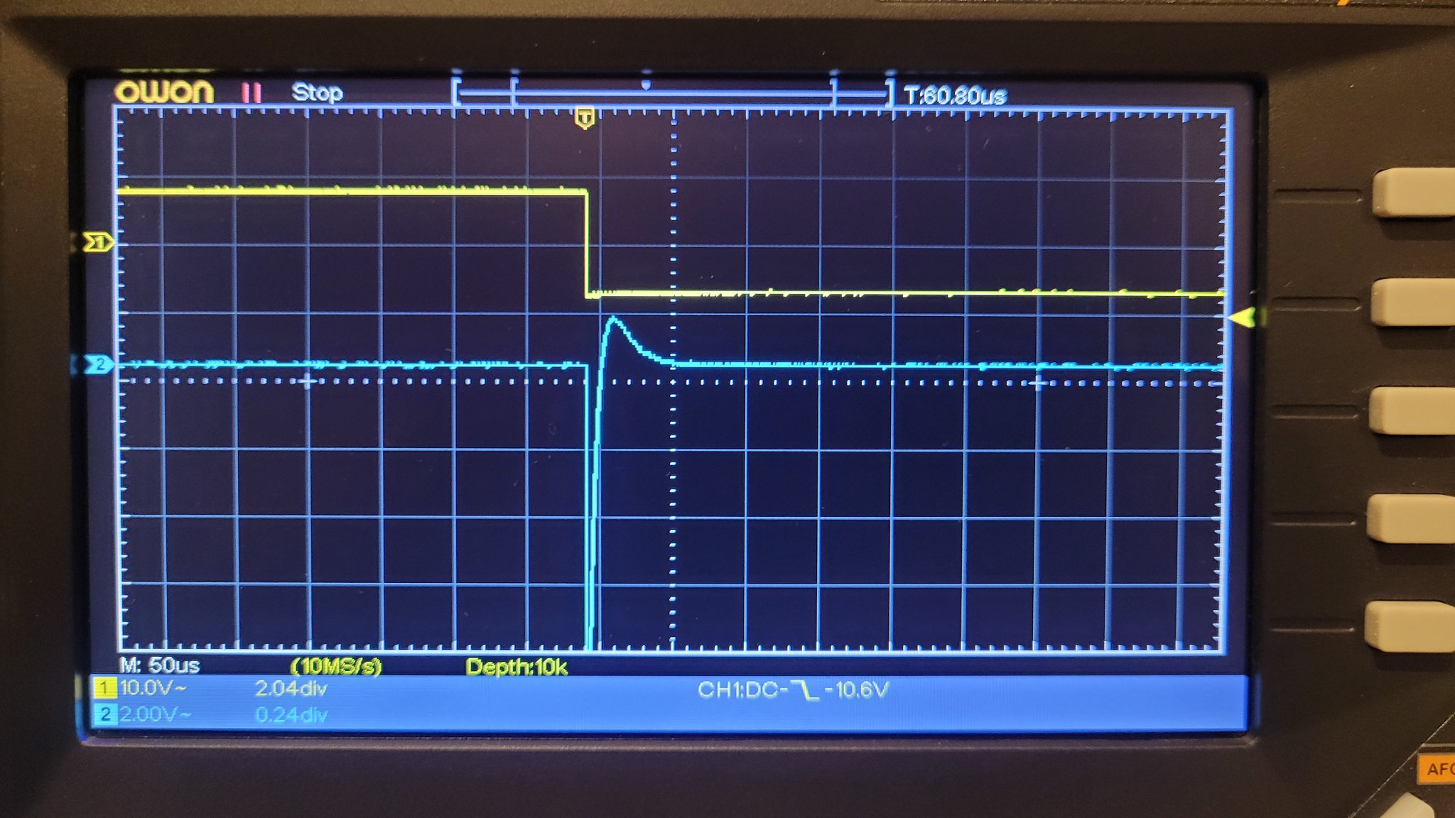

Rs=22R
Rs= 39R
Less than 16R I get oscillation returning.
Higher than 20R and I get excess lumpity-bumpity.
16R-20R seems like a strangely low sweet spot.
But also neither the 20R nor the 16.6R looks quite right.
Should I be increasing the value of Cx/Cs?

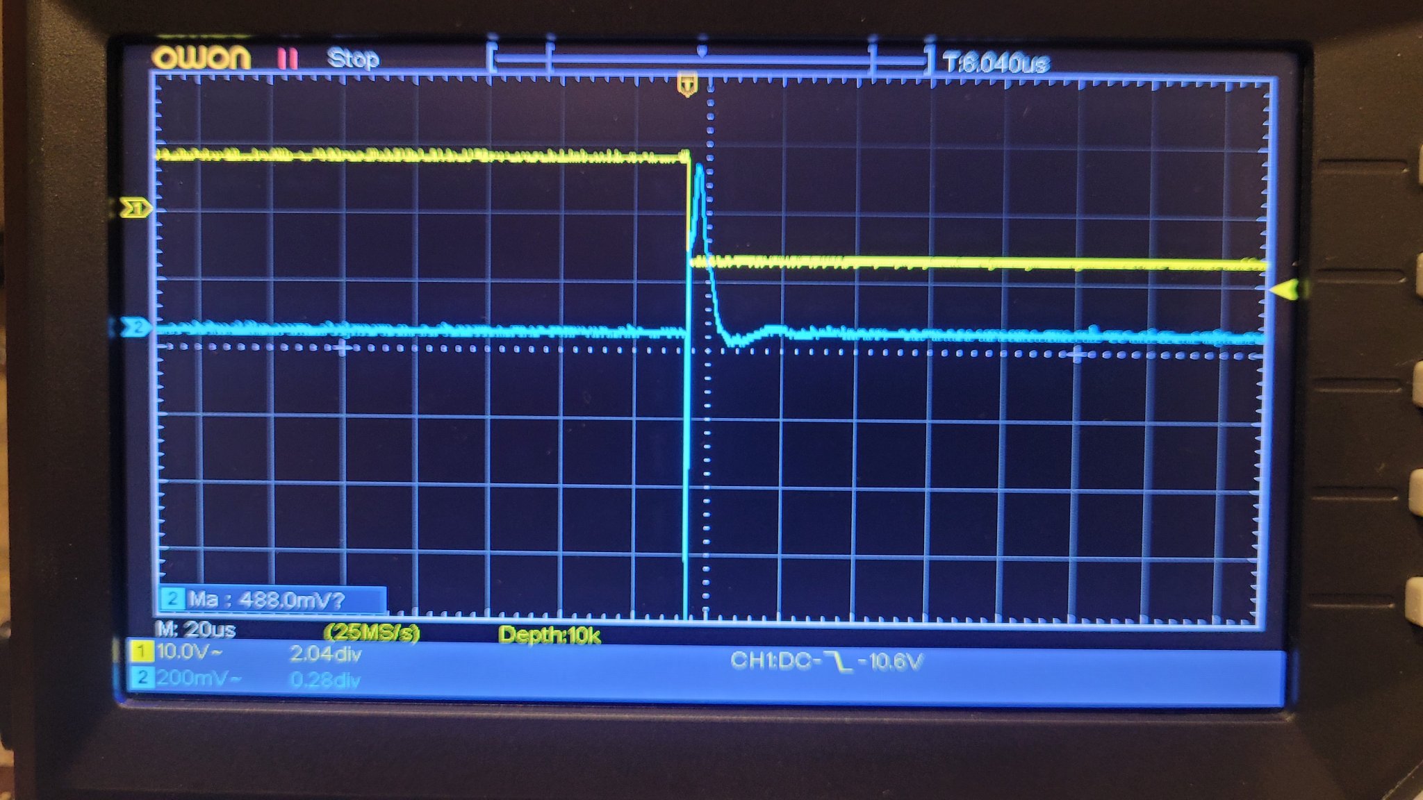

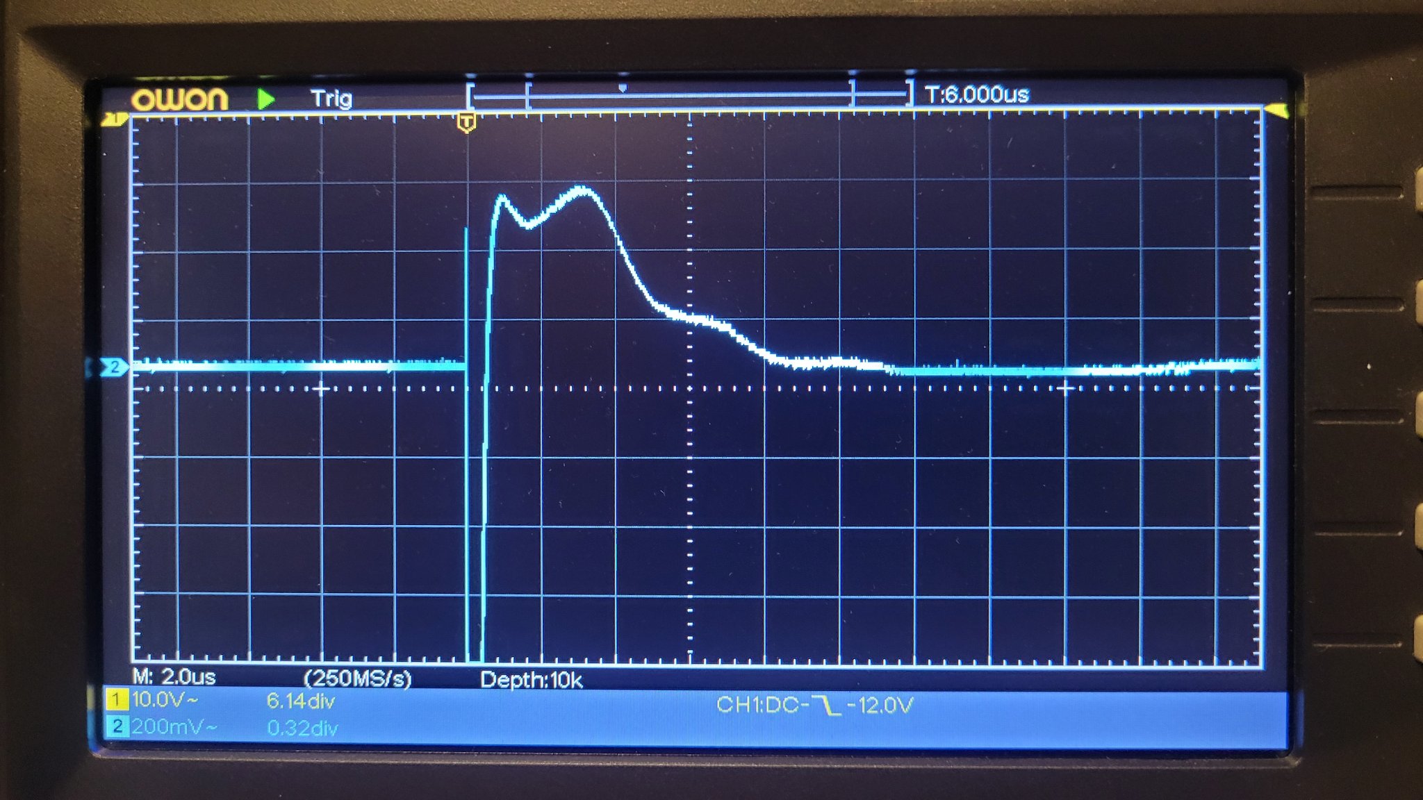

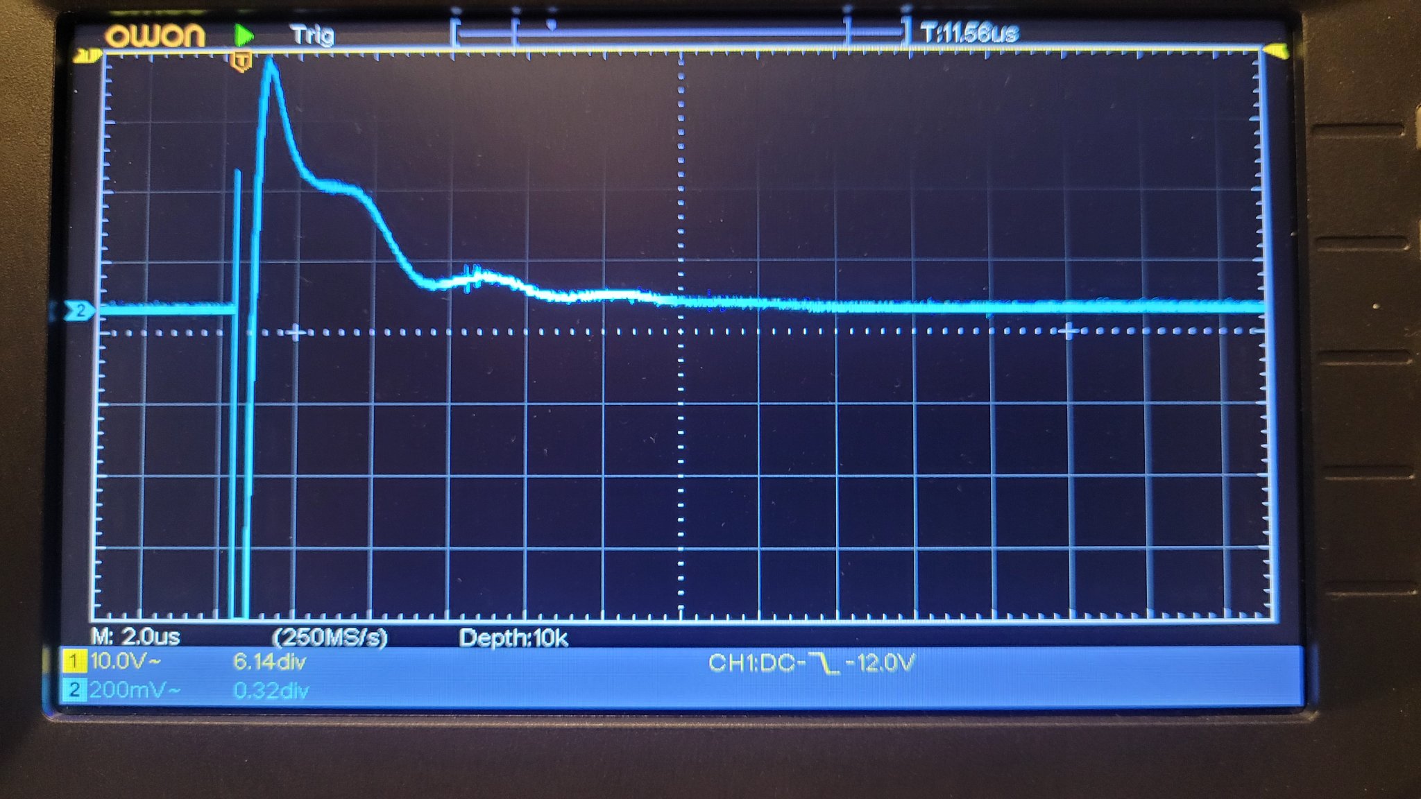

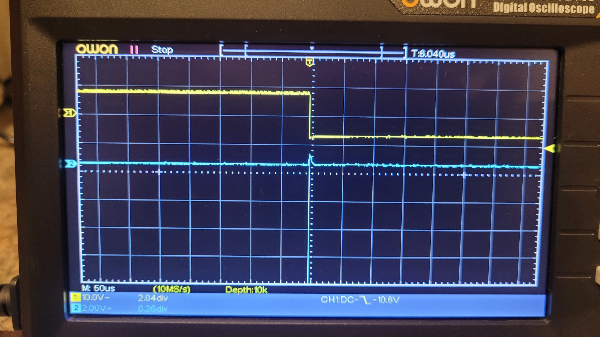

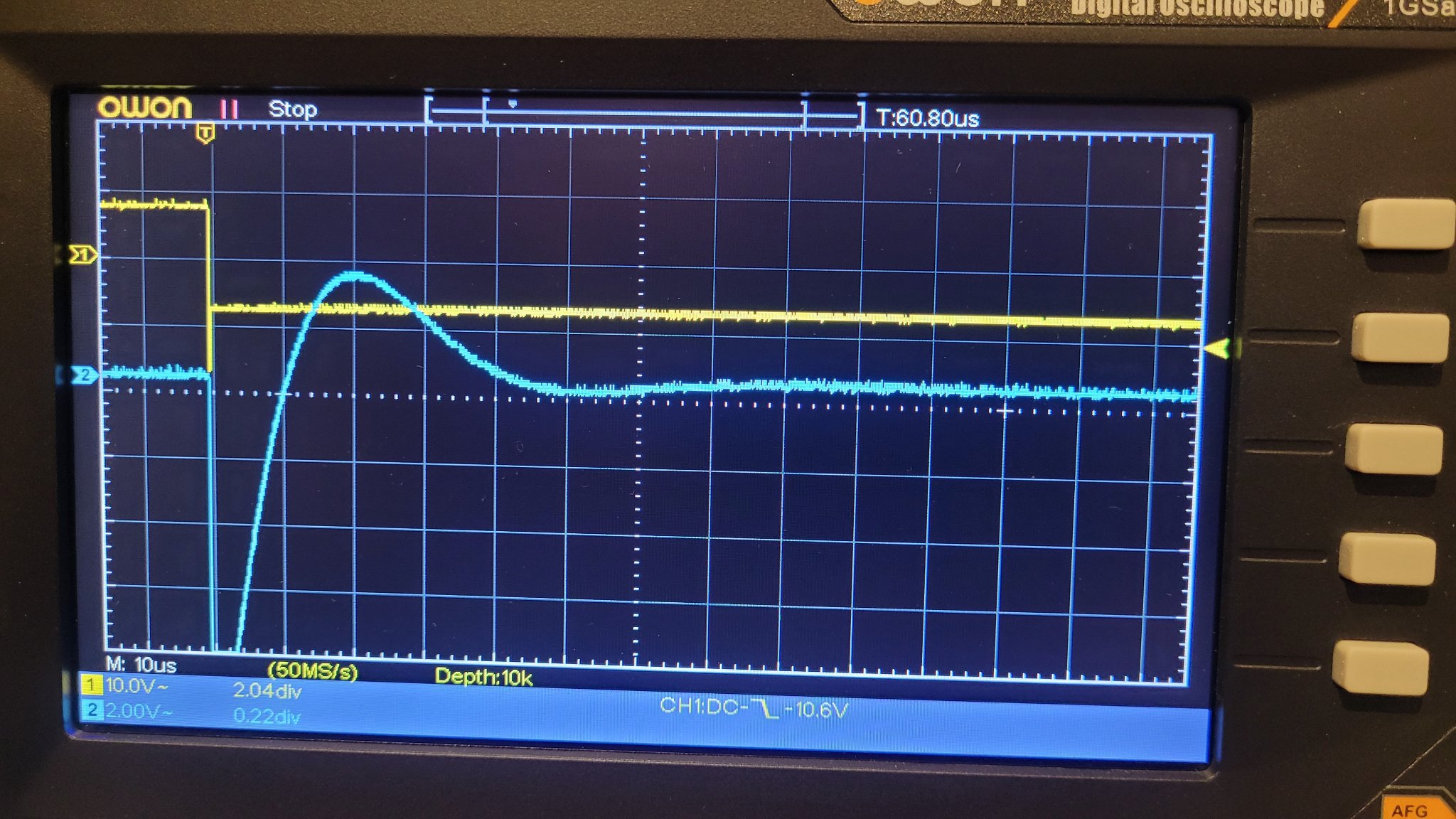

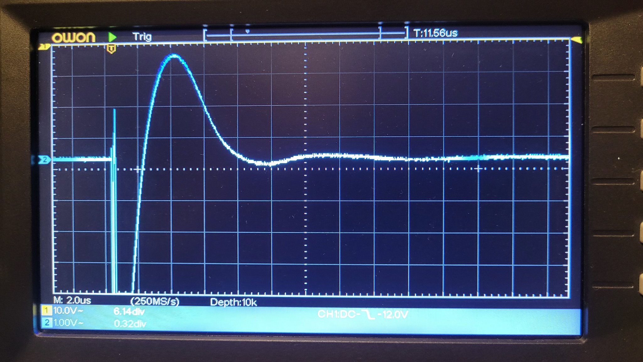

Well, another round of testing on the heater secondary.
Cx: 10nF, Cs: 150nF, Rs: infinity.

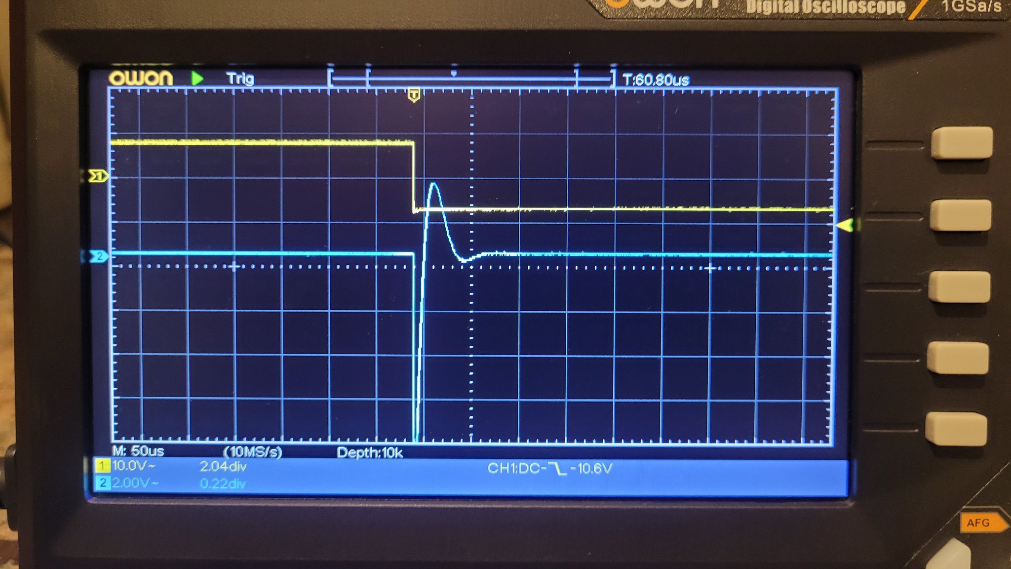

Rs= 228R, starting to dampen
Rs = 18.1R
Looks ok a 5V/div but less nice zoomed in.
Rs= 17.4R
Maybe better but still very wiggly.

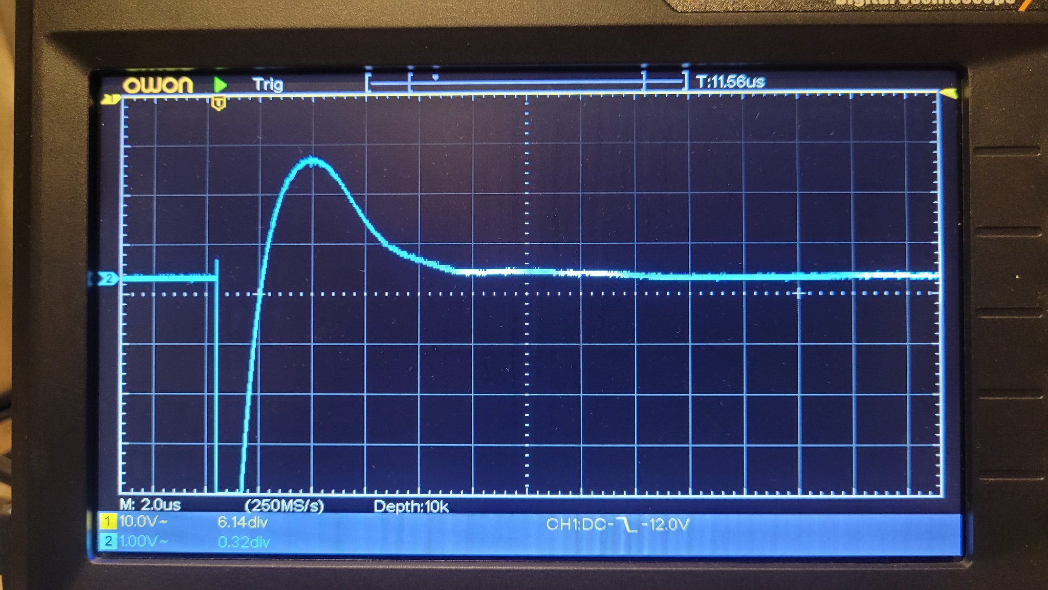

At this point, I started trying to increase capacitance.
Cx: 10nF, Cs: 560nF. Rs: 17.4R

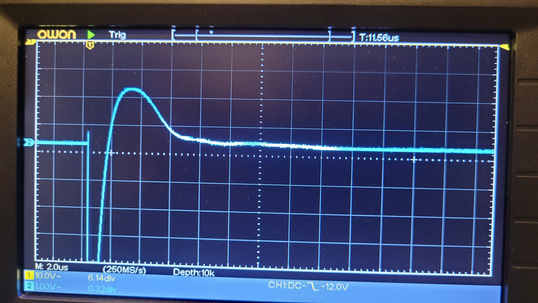

Cx: 10nF, Cs: 1uF. Rs: 17.4R
Starting to look better.
Cx: 47nF, Cs: 1uF. Rs: 17.4R
Cx: 47nF, Cs: 1uF. Rs: 20.9R

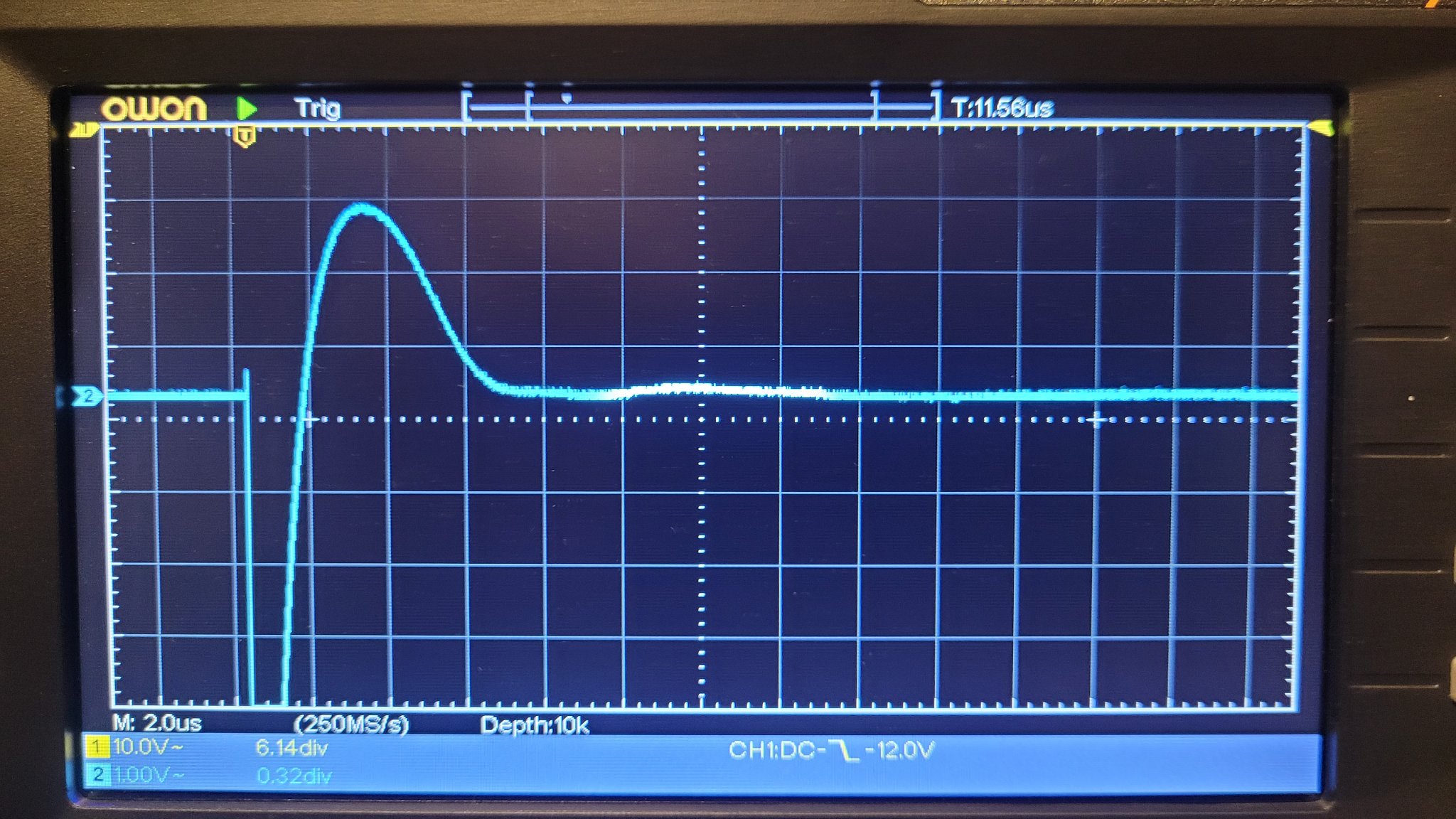

Cx: 68nF, Cs: 1uF. Rs: 20.9R
Cx: 68nF, Cs: 1uF. Rs: 17.7R
Still a touch wiggly but I think this is good enough.
My working theory is that the heater secondary has high interwinding capacitance requiring much higher Cx to swamp it. Thus requiring much higher Cs.
Am I far off the mark here?
