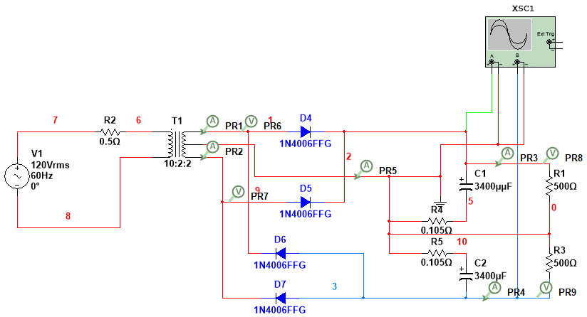

Simple, no-math transformer snubber using Quasimodo test-jig

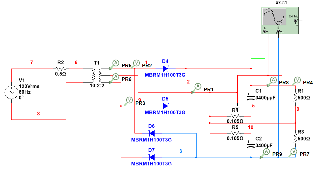

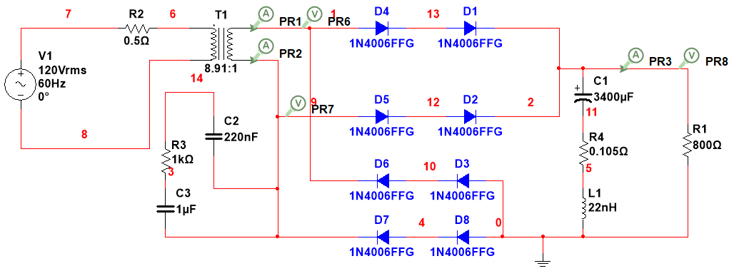

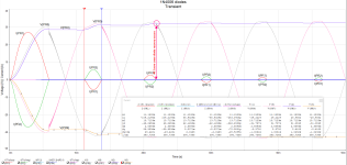

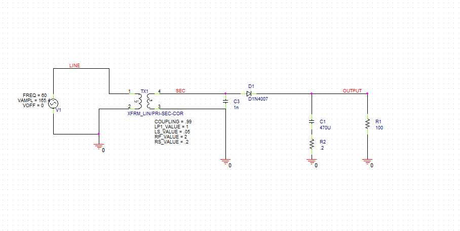

I decided to start with a couple of simulations. The first is a center-tapped full bridge with 1N4006 diodes using a spice model from ON Semi. The second uses 100V Schottky diodes in place of the 1N4006. The load is symmetrical (R1 and R3 have the same value), so no DC flows in the transformer. This is not a real-life application for audio, as the load will never be symmetrical.
The transformer is a mythical unit based on a Multicomp pro torroid. It has a primary leakage L of 1mH and a leakage of 100uH for each secondary. DCR is 3 ohms primary and 0.14 ohms for each secondary. The turns ratio is shown on the schematics as 10 to 2, giving us an output voltage of about 30VDC with 120VAC input. The simulation is set to have a "perfect core," so no core losses are assumed.

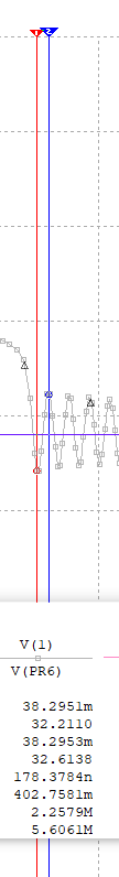

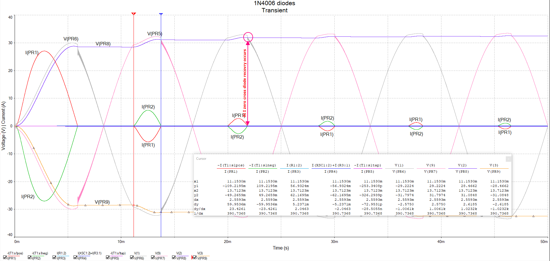

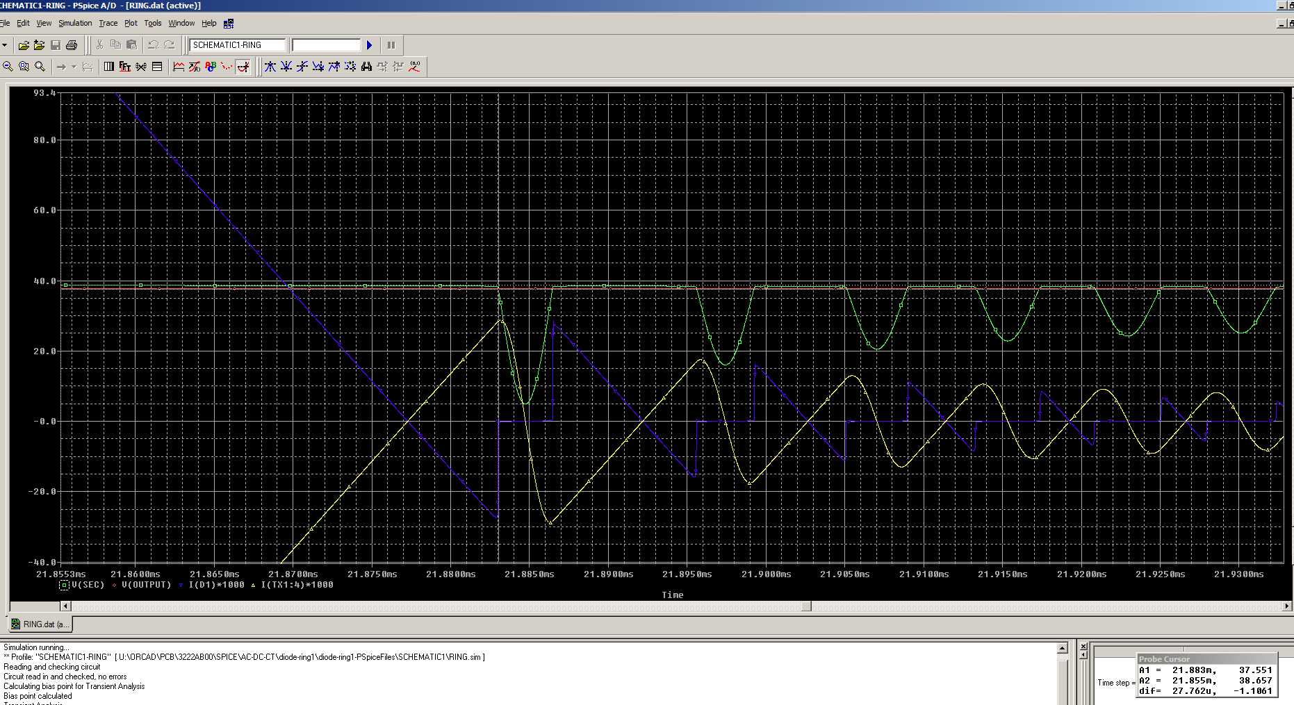

In the 1N4006 Big Pic, we see the start from zero volts on the input. The respective probe points are listed at the bottom. Note that the diode reverse recovery happens at zero current crossings and that this "abrupt" turn off "rings the bell."
In the next attachment, one can see the ringing enlarged and the data points that the simulator uses to calculate the various parameters.
Tomorrow, I will post the results of the Shottky simulation.
Then, I will post comparative results a day after that.
I will also build the circuit and measure the actuals to compare to the simulation.
With no reverse recovery, I would like to see if the Schottky is better than the conventional diode.
Throwing darts at this is encouraged...

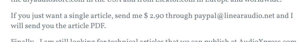

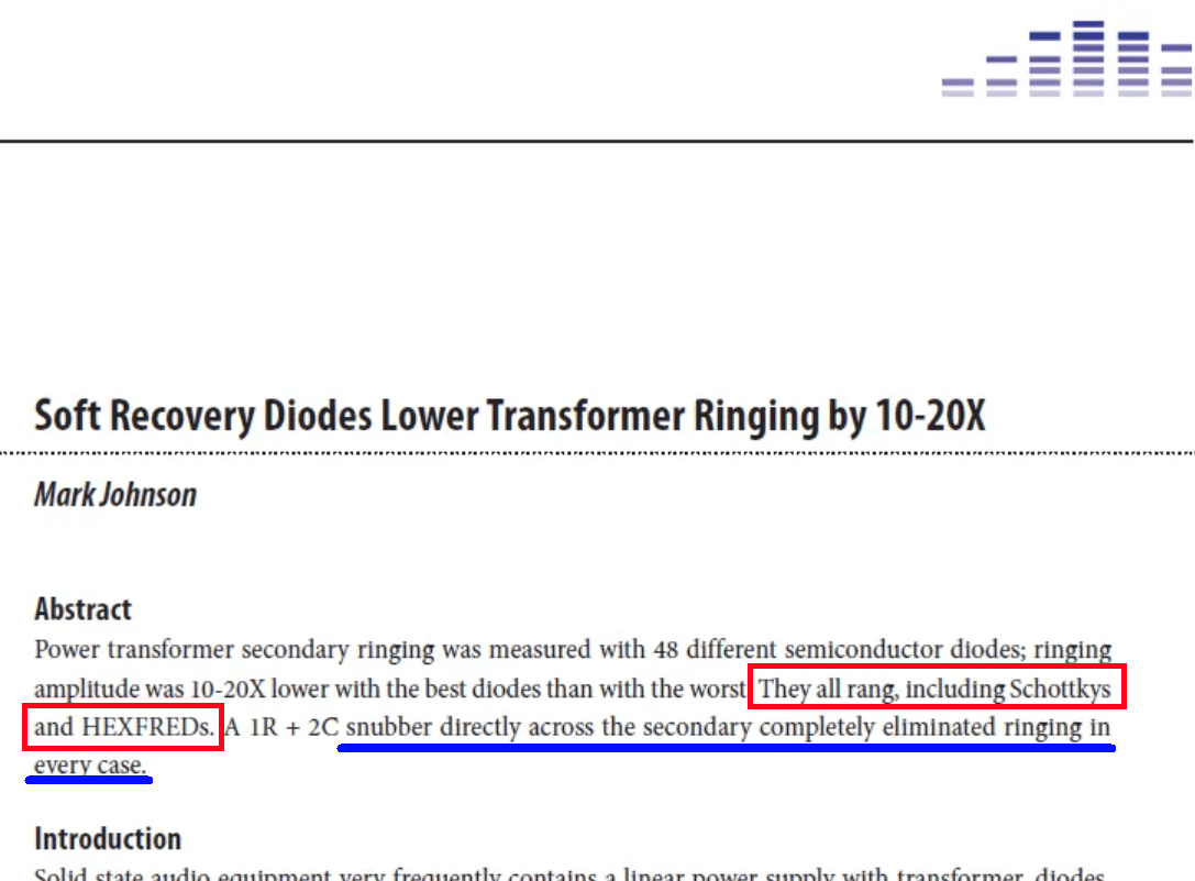

The Linear Audio website's page for the Soft Recovery paper (link) includes a little thumbnail at bottom left, labeled PDF Preview. When I right-click on that thumbnail (Firefox browser, Windows 11), I get a menu that includes "Open Image in New Tab". When I select Open Image in New Tab, I get a full size and easily readable image of page 1 of the Soft Recovery article, as published in the magazine. I've screen-captured that image straight off my browser+monitor; the top portion appears as attachment 1 below. Take careful notice of the red passage and also of the blue passage. The Abstract of the article includes the main conclusions . . . . . and boom-shakka-lakka-lakka-boom, there they are. Including your favorite word "Schottky".
There are several ways to legally obtain this article and support the wonderful efforts of Linear Audio (Jan Didden a/k/a @jan.didden ). One is to purchase the complete Linear Audio Library from the diyAudio Store (link 2). Another is to purchase a hardcopy of Linear Audio Volume 10, from Amazon (link 3). A third way to obtain this article is to send USD 2.90 by PayPal to the publisher, as mentioned right on the home page of Linear audio. I've copied it as attachment 2 below.

If your interest is in the diode recovery operation/comparison, then perhaps some other sim circuit additions may be reasonable like a mains input impedance; secondary half-winding shunt capacitance; and loop inductance related to each first filter capacitance.
The resistor, R2, represents the mains Z. I should have mentioned that. Thanks for pointing it out. As for the L of C1 and C2, it would be in the region of 22nH from 2MHz to 10MHz. This is a measured result of the electrolytic I'm using in the build (If there is interest, I can post the data). It did make quite a difference! In the first sim with 1N4006 the delta V of the ring was 403mV at 2.8MHz. With the addition of the parasitic L in the electrolytics the ring was almost double at 934mV at a frequency of 3.47MHz.
Very good input.

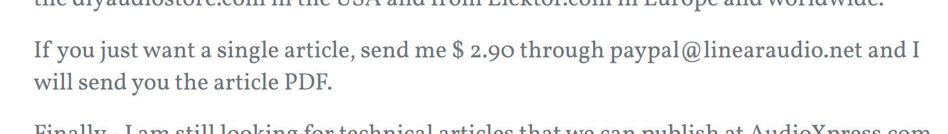

_
I ordered the USB stick.. thanks.

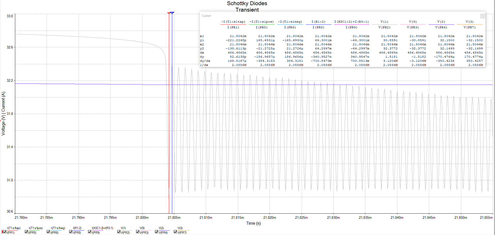

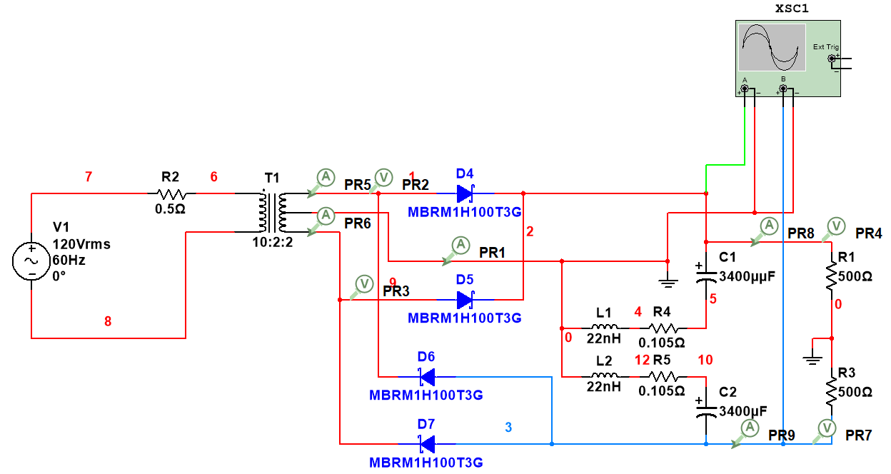

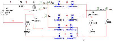

Now for the Schottky. It is worse in ring magnitude than the 1N4006. The value of the parasitic L in the electrolytics does not change the results significantly over the range of 10nH to 220nH.
1N4006 (conventional Diode) No snubberRing Magnitude 0.934VRing Freq 3.47MHz
MBRM1H100T3G (Schottky diode) No snubberRing Magnitude 1.52VRing Freq 1.0MHz
  • Enlarged dioe turn off as viewed by the transformer with Schottky and added L.png

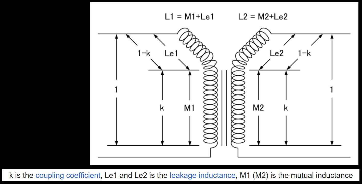

I'm afraid you aren't simulating the important aspects of diode induced ringing in a linear power supply with mains transformer, diodes, and filter capacitors. As member @trobbins tried to caution you in post #2,523.
Do another read-through of the Quasimodo design note (.pdf file) attached to post #1 of this thread, and carefully consider its very title: ... words ... words ... transformer snubber ... words ... words ... The problem is the transformer. The solution is to snub the transformer. That's what Quasimodo helps you do: figure out how to snub the transformer, without doing any math.
---> The problem is the transformer <--- and the easiest way to make the problem appear in circuit simulation, is to include the "leakage inductances" in the transformer model. These are inductances in the primary circuit and inductances in the secondary circuit, which are not flux-linked.
The easiest way to include leakage inductances is to tell the simulator that the transformer is non-ideal; its coefficient of magnetic coupling "K" between primary and secondary is non-ideal; its "K" is below 1.00. Yes indeed, real-world and real-life transformers are non-ideal and their winding-to-winding coupling is less than 1.00 .
After reducing K, simply include a little self-capacitance, say 200 picofarads across each secondary, and 100 picofarads across each primary*. That's all you need to do to start seeing oscillatory ringing in simulation.
Even using plain, ordinary, as-shipped-with-the-simulator, silicon diode models, Schottky diode models, and Silicon carbide diode models, you'll see plenty of oscillatory ringing. In fact it will ring in simulation, with ideal perfect filter capacitors (ESR=0 ; ESL=0). Because it's not the capacitors that are ringing. It's the transformer that is ringing. Its leakage inductance and self capacitance form a resonant circuit which rings like the dickens. The transformer is what rings. The transformer resonant circuit is the bell which rings. The diodes are merely the stimulus, the whack with a hammer, that induces the bell to ring.
Way back in the early 1970s, the great-grandfather of all simulators, Berkeley SPICE 2G6, let users create mutually coupled inductors (such as transformers) using the coupling coefficient K. See attachments 1, 2, 3 below. LTSPICE uses this same approach with the same syntax. I am not familiar with your simulator or its schematic notation in post #2,527 but I don't think I see "K=1" anywhere. Maybe it's a default? In any case, figure out how to have your simulator create partly-but-not-completely flux linked mutual inductors having K<1.
*see Appendix C and Figure 17 of the Quasimodo Design Note if you view these round numbers with suspicion.

As I explicitly stated in my previous post, the model in the simulation includes leakage inductance and each winding's DCR.
Please note that there is ringing in the simulation.
Your statement:
"It's the transformer that is ringing. Its leakage inductance and self capacitance form a resonant circuit which rings like the dickens. The transformer is what rings. The transformer resonant circuit is the bell which rings. The diodes are merely the stimulus, the whack with a hammer, that induces the bell to ring."
I'm trying to understand why the magnitude of the bell being hit is not an issue. The different diode technologies result in different reverse recovery characteristics and have different capacitances for the same bias conditions. The harder or softer the bell is hit should make a difference.
Perhaps another way to look at the 'bell being hit' is to view it as the secondary winding current. That current can be a short portion of the mains cycle, and high in peak magnitude when it is non-zero and a diode is conducting. The 'hit' is when the diode approaches and stops conducting - the winding current has reached its maximum, then falls towards zero, with a final dI/dt level which abruptly becomes dI/dt=0 as the diode turns off. That final non-zero dI/dt as the diode starts to turn off causes the winding leakage inductance's energy to splatter wherever it can. You are wanting to simulate that energy splatter event, which includes how the diode operates through the event, and how some of that energy rings through the diode as it is turning off. That energy also transfers to the secondary winding's capacitance as a voltage transient, and to other windings through transformer coupling.

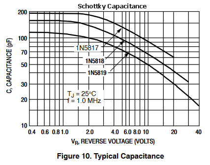

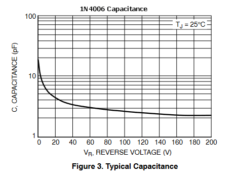

The diode capacitance rings with the leakage inductance. My simulations include leakage inductance and DCR. As the leakage L increases, the energy in that inductance increases.
So far, I have two transformers and toroids with very low secondary leakage. The range is 34uH to 37uH. I have used this value in simulation and got little to nothing regarding ringing with 1N4006 diodes in a bridge configuration.
If I increase the leakage in my simulation to 1mH I get ringing. If I add another diode in series (as shown in the schematic below) and keep the leakage as 1mH the ringing decreases.
The reason is the diode capacitance. I did not understand the issue of the diode reverse recovery causing the ringing. The Schottky should have decreased the ring as it has no reverse recovery. It did not in my initial simulations.
My question then was why? It must not be diode reverse recovery.
Adding the second diode in series would decrease the dual diode's assembly capacitance. Schottky have a lot more capacitance at the same current rating, so this would create more ringing at a different frequency, as the simulation shows. (See figures attached)
This means that a transformer with a split winding construction would be more problematic as it would have greater leakage L.
I will get a split bobbin transformer to add to the mix.
Please ask if anyone wants to see the initial simulations, and I will post.

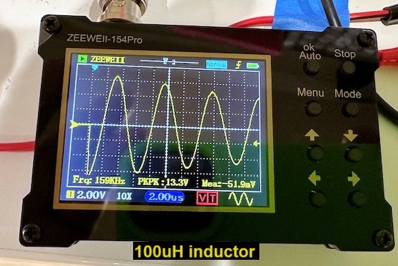

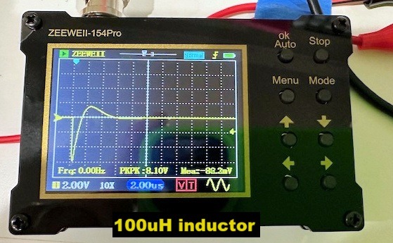

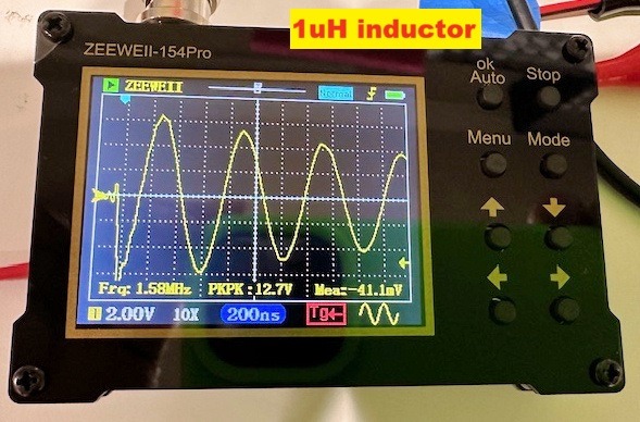

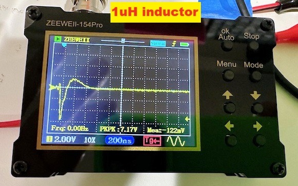

I bought one of those eighteen dollar oscilloscope kits on eBay, the "DSO138", and tried it out with Quasimodo and some transformers and some inductors. I found it to be a cute little electronic stunt and enjoyable hobby plaything, but not actually useful in combination with Quasimodo.
The thing simply isn't fast enough to digitize and display waveforms from real transformers with real snubbers. Although the claimed bandwidth is 200 kHz and the claimed sample rate is 1 Msps, I couldn't get it to trigger on nonperiodic signals even at much slower settings. It certainly won't display the ringing of a low-leakage-inductance toroidal transformer like the Antek AS-2222, which is used in many chip amps.
I bought another cheap oscilloscope, the ZEEWEII-154Pro (emphasis on Pro), for about USD 40 on eBay. It's about the size of a business card. Claimed bandwidth is 18 MHz and what's really great is: it is battery powered (USB-C rechargable). It's not connected to the sketchy "ground" of a charger or wall wart.
I tried it on two fixed inductors this morning. I know, they're not quite the same as transformer secondaries, but they're quicker and easier to test when you haven't yet had your morning cup of coffee. They were deliberately chosen to be difficult-for-Quasimodo-and-scope, thanks to abnormally low inductance: 0.1 millihenries and 0.001 millihenries (100uH and 1uH respectively). Take a look at the scope's calculated ringing frequencies: they're HIGH. Which means the scope bandwidth is high and the scope triggering is good. Much much better than the previous device with 0.2 MHz bandwidth.
Those wishing to practice EE calculations can use the displayed ringing frequencies, and the known inductances, to calculate a value of Cx that must have been installed in my Quasimodo. If and when you do, you will discover that Science Works.
If you have an extra forty dollars lying around, and want to make Quasimodo tests, this would be a nice addition to your toolkit. BONUS: you can do the tests in the remote wilderness, 100 miles from the nearest AC mains outlet, if you wish. Just run the Quasimodo PCB from a 9V battery, and run this scope from its internal battery. Cowabunga.
