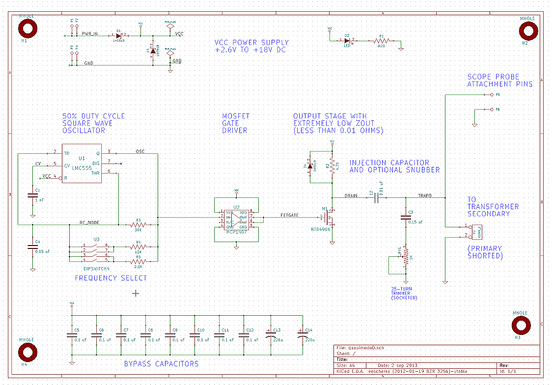

  1. C1 - I think I picked the right part but could someone else verify it? I was a little unsure on what is needed there
  2. RV1 - the trim pot, I think I selected the right one?
  3. C2 / RV1 - The parts in the bom are unavailable so I went hunting for something similar
My biggest area of concern is the last 3 - the sockets. I don't know how they are used and what selection criteria to use to replace given the original is not available.

3 - C2 - If I'm looking correctly, you've provided the part number for a 10pF ceramic cap, K100J15C0GF53L2. I use film caps with about 1,000 times more capacitance in that position. One example is, B32529C3103J. One more confirmation than mine is always a good thing.
The sockets are for installing / removing the Cs (C3), Cx (C2), and Rs (RV1). You can (if you choose) install Cs and Cx permanently on the board. As one example, I trust those values, and I don't see any use cases where I would change them. I use the same parts I use in-circuit for my PSU builds. That's not necessary, but it makes me feel warm and fuzzy. You'll likely be removing Rs and checking it for each measurement, so a socket is nice.
tl;dr - you can use pretty much any standard pitch socket there. I'm reasonably sure, I bought a bunch of the "breakaway" type sockets from Amazon.

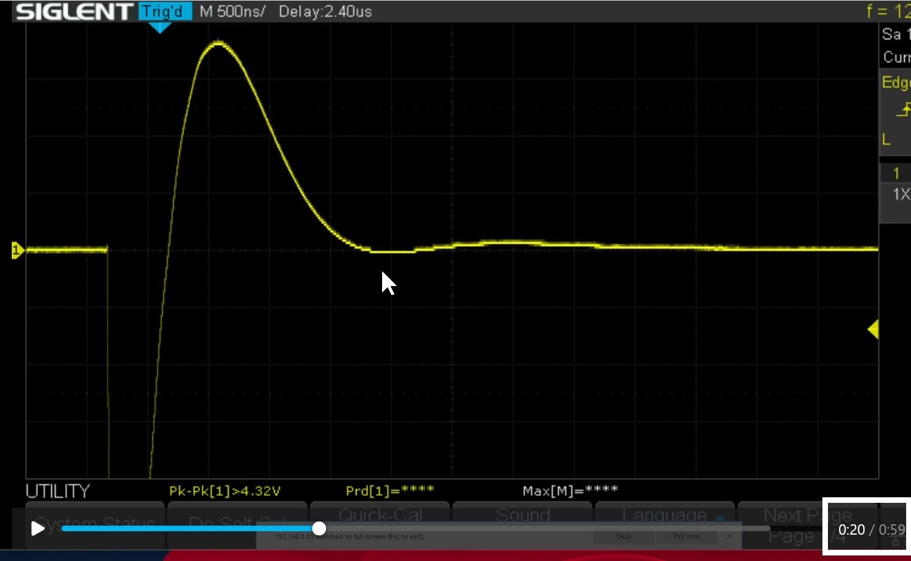

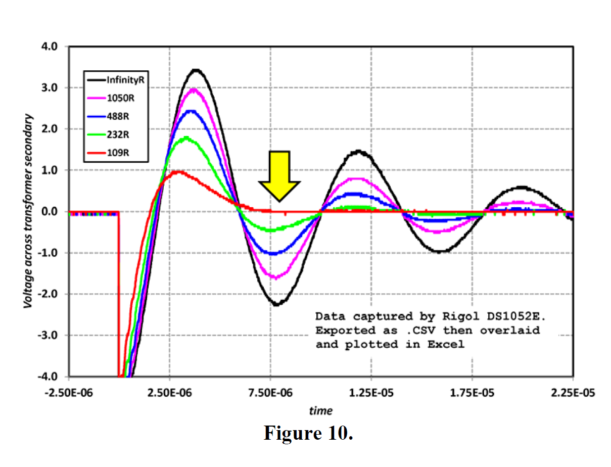

Can someone watch please the video and tell me at what second is the ultimate resistor value? I realise that towards the end of the video the transformer is over-damped but there's a big range at which the first "dip" is flat and I'm not sure when I should stop.
  • Untitled.mp4
    2.8 MB
Anywhere between 0:18 and 0:22 is perfection; 0:20 is rhodium plated perfection

Would it possible to explain to me what should I be looking for when adjusting the resistance? It's not very clear to me why anywhere between 0:18 and 0:22 is perfection.
Am I trying to get the red arrow as flat as possible or the green one? In either case, why anything after the 22 sec is not good?
I've read many posts on this thread as well as the .pdf but it's still a bit unclear to me...
Thank you. The truth is that I have read all these posts together with many more. In a number of posts you recommend to stop as soon as the trough gets flat.
I must be stupid but I fail to see how 18-22sec is the correct resistor value. To me it looks that the trough (2nd lumpity/bumpity?) starts to get flat on the 25sec or thereabouts...

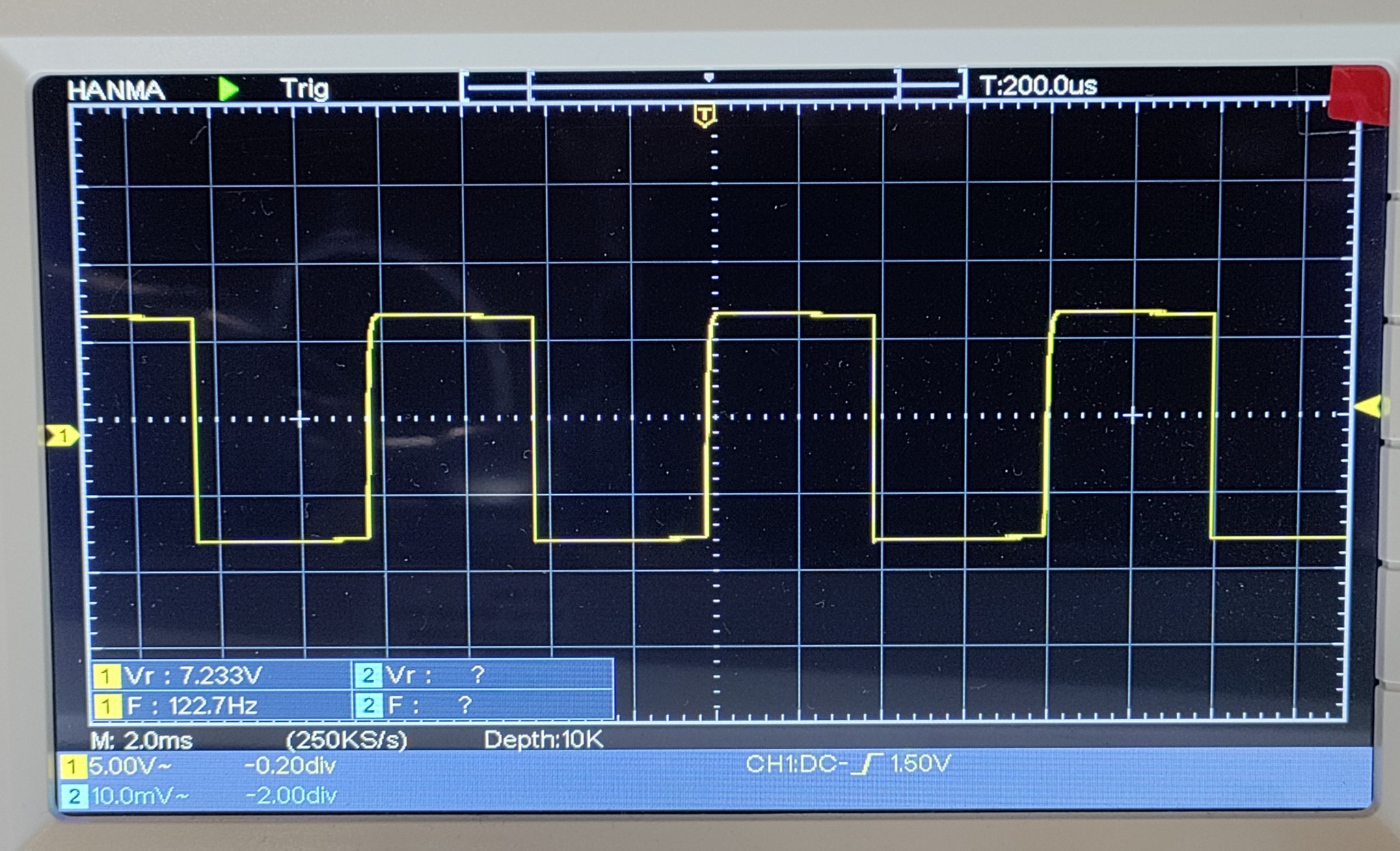

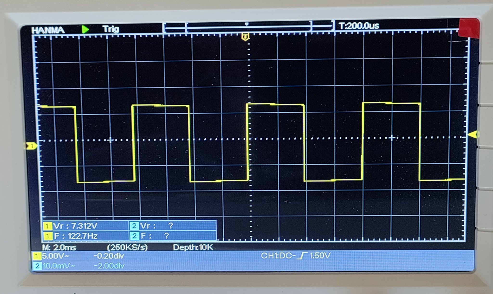

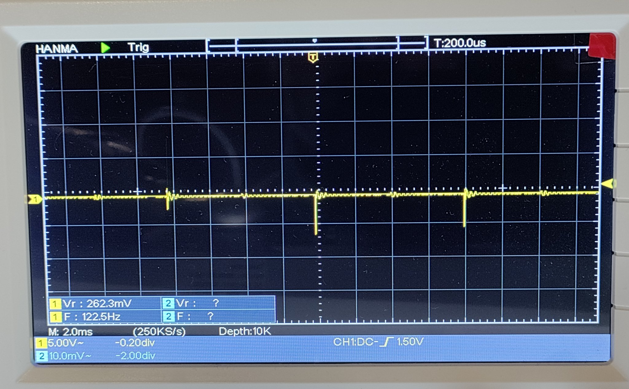

I have memory of using my test-jig before without problems. I am not sure what I am doing wrong this time.
Powered by +15V I get the clean triggering signal from CH1 and the same appears to CH2 (no transformer connected yet) as log as RV1 is out of the circuit. If RV1 is in place (no matter the value), CH2 drops into milli-volts amplitude and difficult to see on the scope.
If I connect the transformer secondary, I can see the ringing, but too noisy to do anything with it. Did I break my Quasimodo, or did I just fail my homework? 😳
People who weren't in the room with you when those tests were run, have no idea where "CH1" and "CH2" were connected. We don't understand your post.
I recommend
Test 1: remove RV1 from its socket, disconnect and remove everything from the transformer secondary Euroblox connector. Probe the signal network named OSC, adjust the horizontal sweep rate so there are two or three complete waveform periods, and take a photograph of the oscilloscope trace (single channel, single trace). Probe the signal network named FETGATE and take another photograph (single channel, single trace). Probe the signal network named DRAIN and take a third photograph (single channel, single trace).
Test 2: remove RV1 from its socket, connect an inductor whose inductance is known (printed on the inductor body) to the transformer secondary Euroblox connector. Probe the signal network named DRAIN and take a photograph of the oscilloscope trace. Probe the signal network named TRAFO and take another photograph.
Test 3: leave the known inductor connected to the transformer secondary Euroblox connector. Plug the variable resistor RV1 into its socket. Take three photographs of the oscilloscope trace, when (i) the trimmer knob is rotated 100% clockwise; (ii) the trimmer knob is rotated 100% anti-clockwise; (iii) the trimmer knob is at the halfway point.
Test 4: with the known inductor and RV1 installed, slowly dial the trimmer knob until the oscillatory ringing matches the red trace in Figure 10 of the Quasimodo Design Note (.pdf attached to post #1 of this thread). Probe the signal network named TRAFO and take a photograph of the oscilloscope trace (single channel, single trace).
If you perform all four tests, and if Test 4 is a complete success -- you are able to make your Quasimodo board and your known inductor give an output which matches the red trace in Figure 10 -- then your Quasimodo board is working correctly. Any problems you may experience with other loads, are not problems with your Quasimodo board.

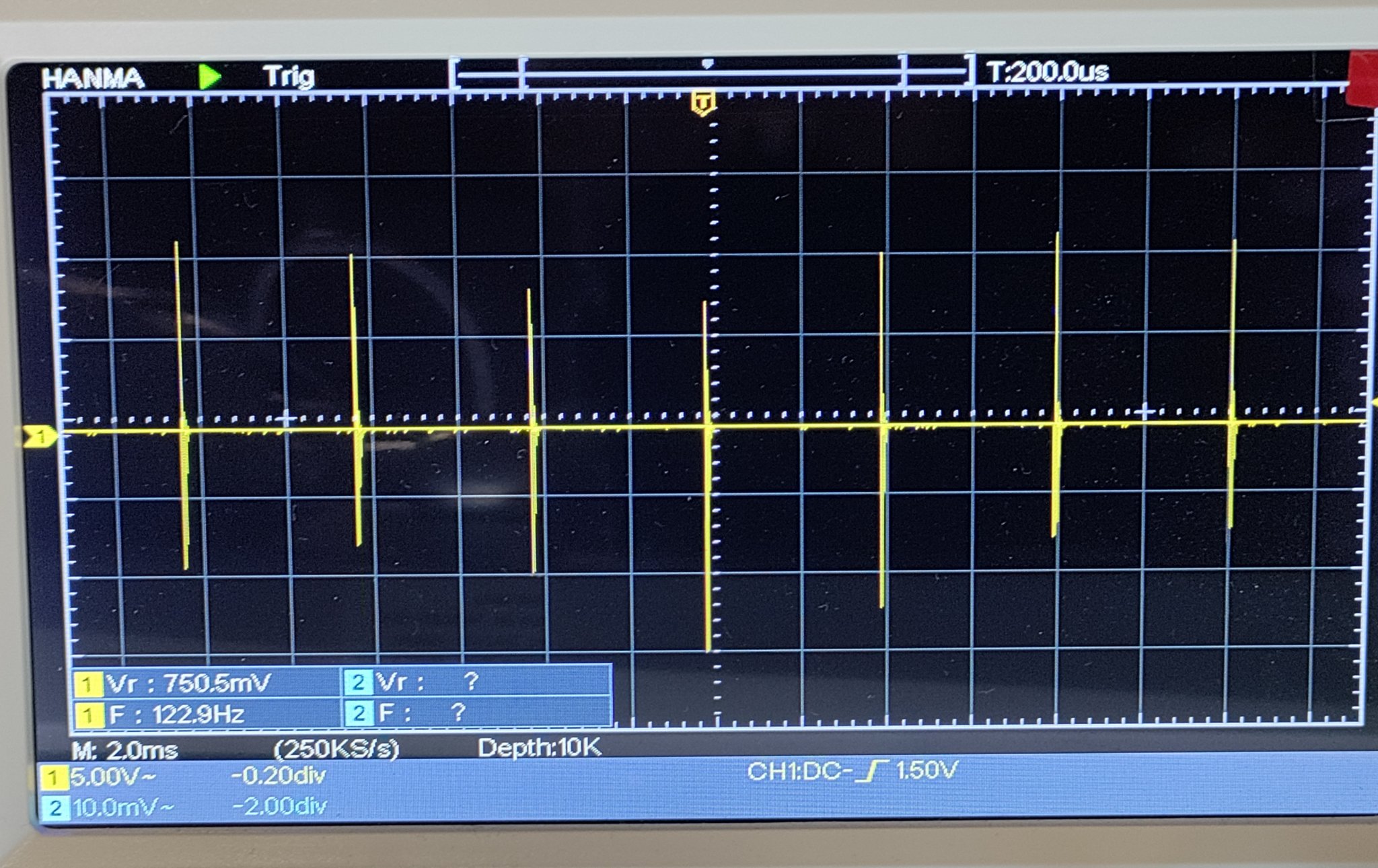

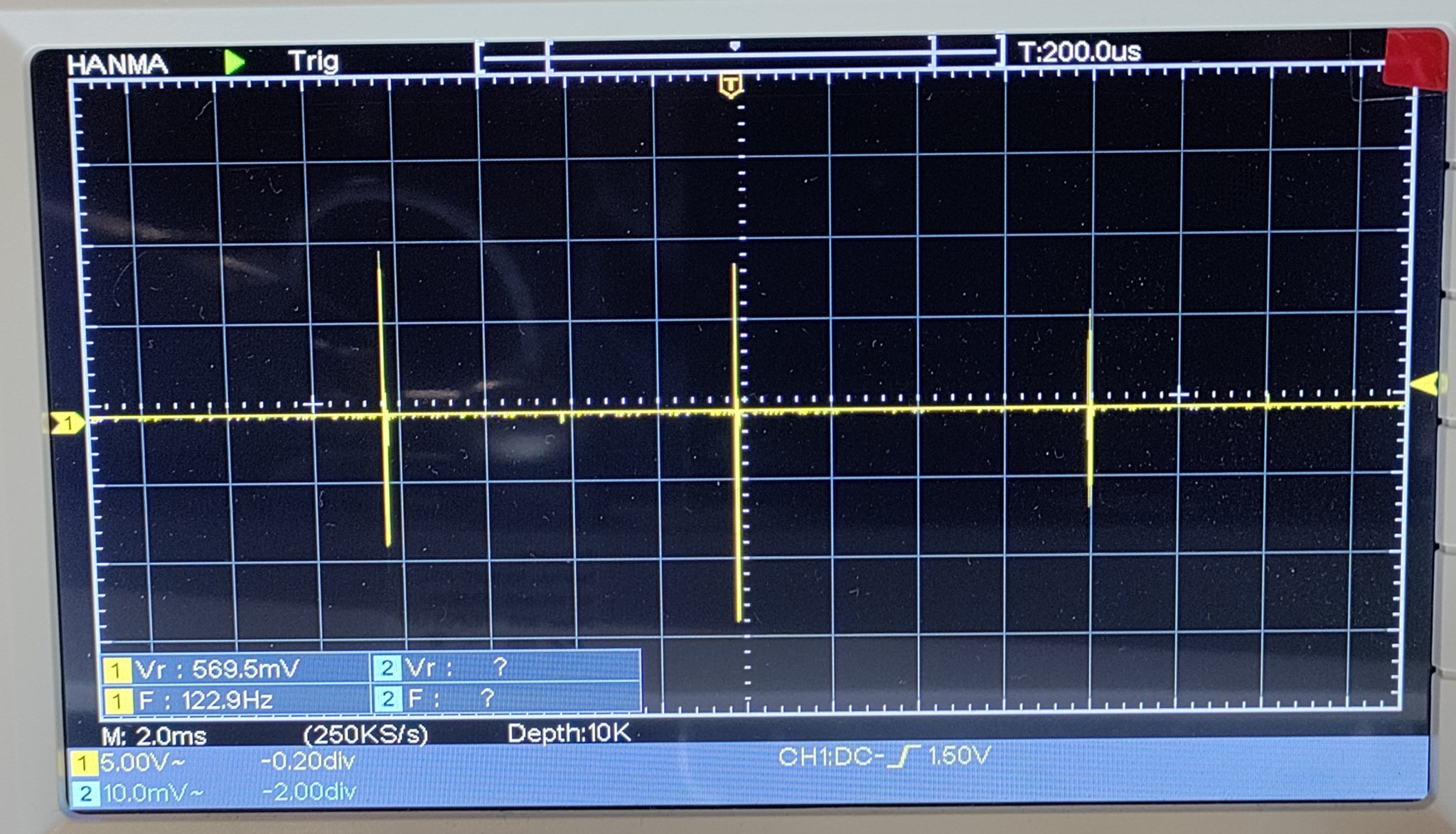

OSC
FETGATE
DRAIN

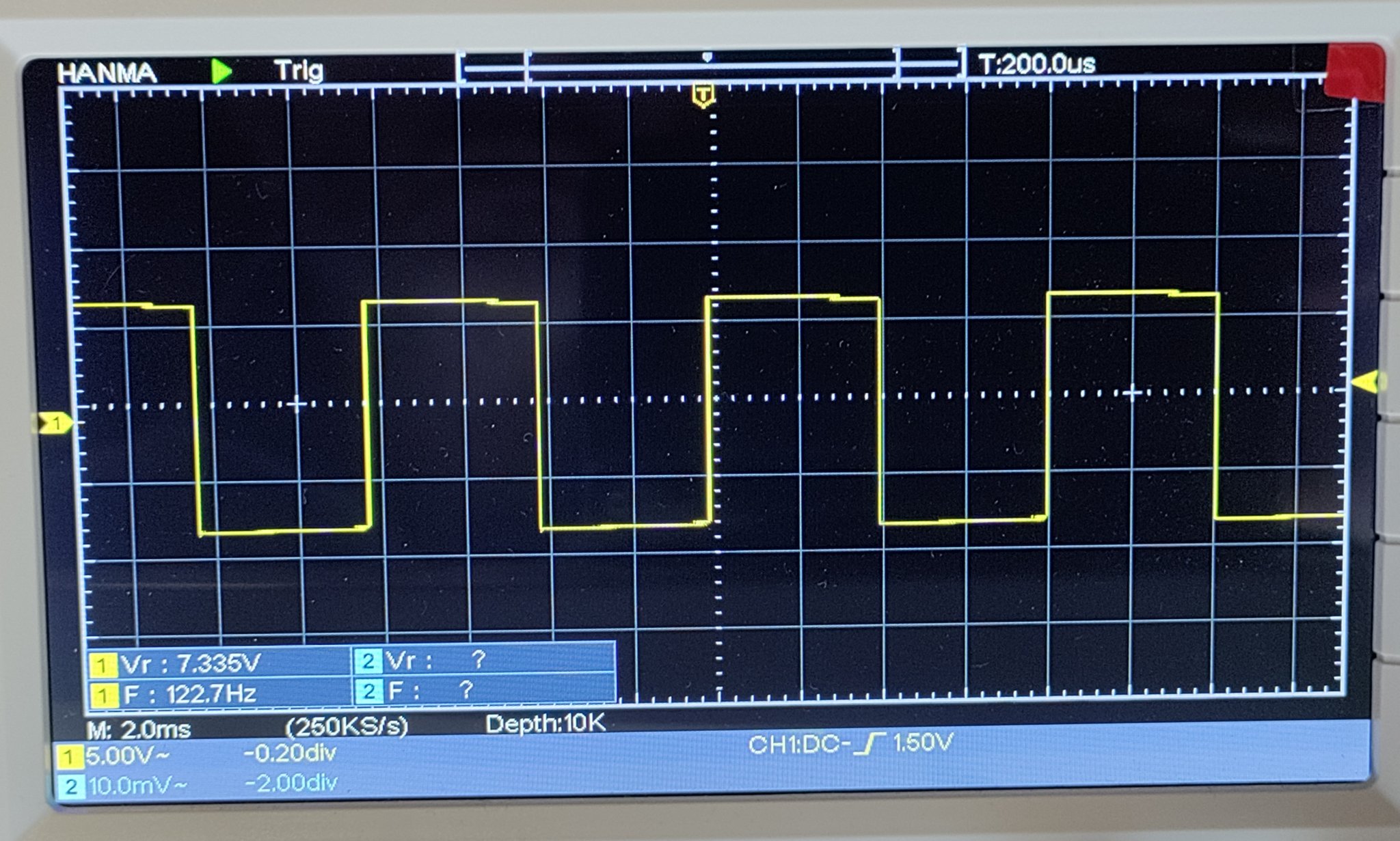

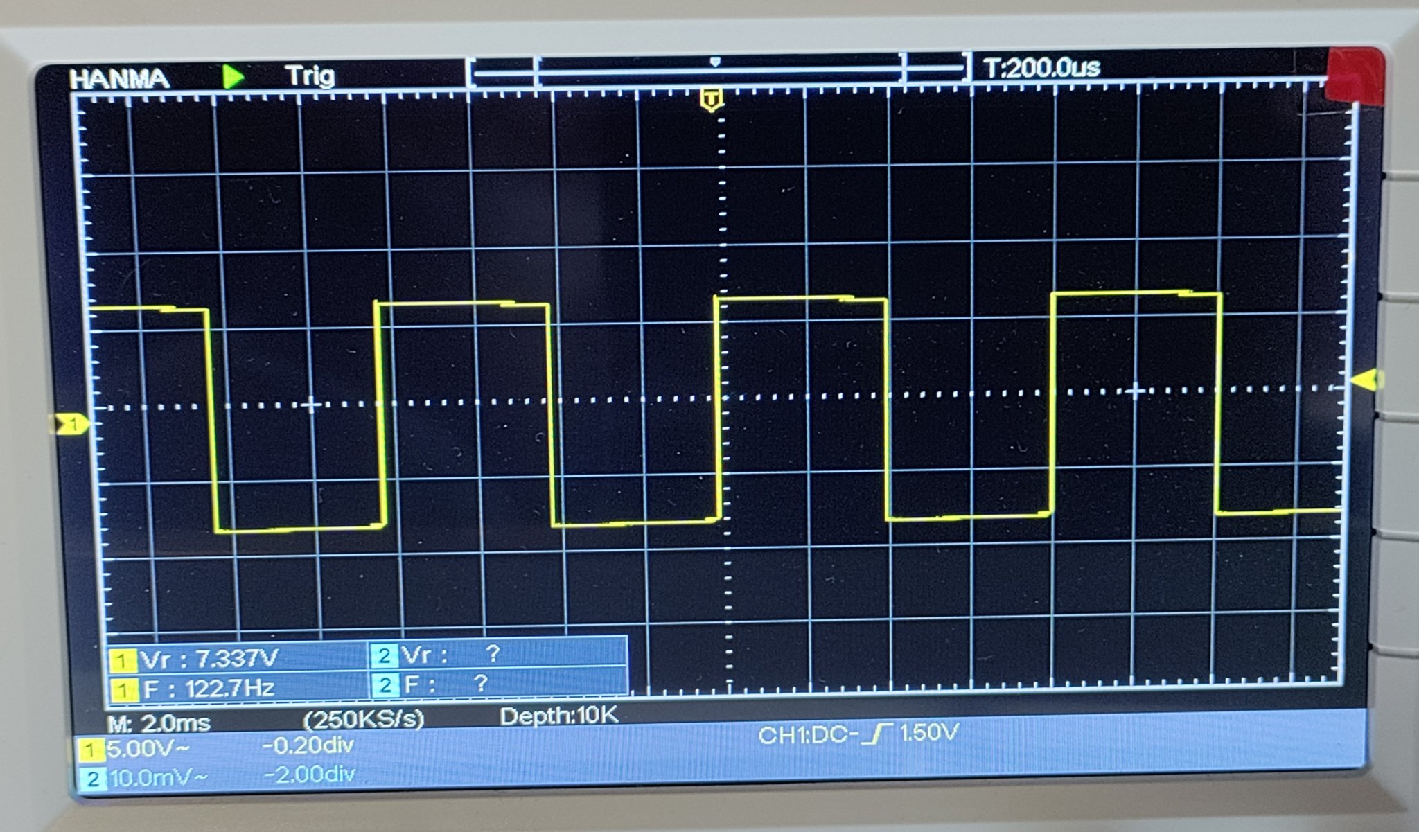

DRAIN
TRAFO with 0.4 mH inductor
TRAFO with 0.1 mH inductor
TRAFO with transformer secondary - Same test I was describing in my previous post, this time without RV1.
Is Test 2 considered a success?
Yes, if you display signal network TRAFO and trigger the scope on its falling edge, then speed up the horizontal sweep rate to 20 microseconds per division: I think you'll see a pretty good copy of the black trace in post #2,598 (which is Figure 10 of the Quasimodo Design Note, attached to post #1 of this thread).
If you do get a pretty good copy of the black trace, I'd say that equals success on this test.
