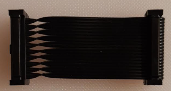

I am constantly haunted by errors with the numbering of the Amanero connector.
For DSC 2.6.2 you have to make the following cable:

Oops! Looks like you are using 45/49MHz clocks. Those should work fine as external clock sources for I2SoverUSB, but not directly as external clocks for Amanero. Amanero could be made to work too, but its a bit more complicated to do it with those since the clocks would have to be run though a divider.
