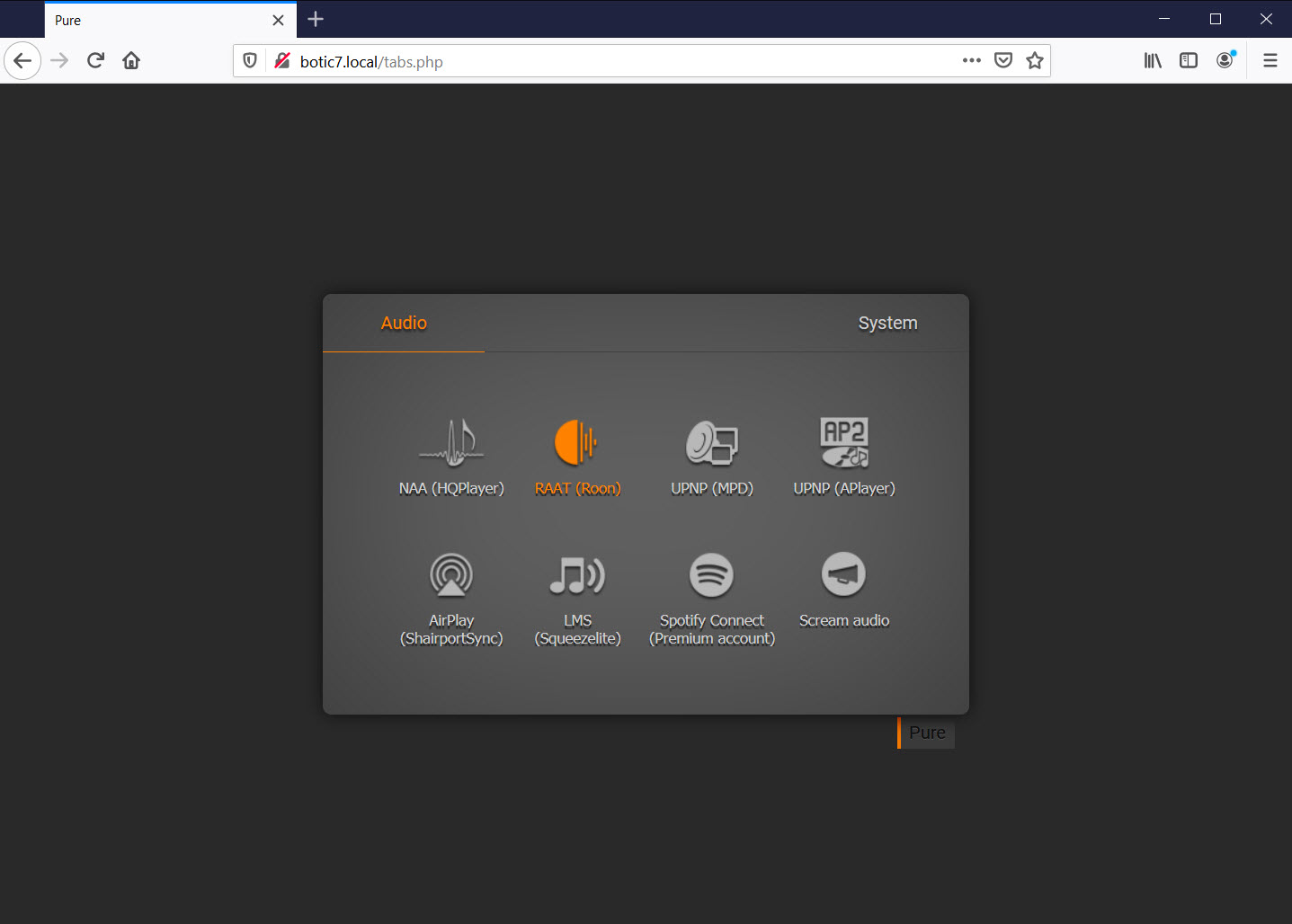

While waiting PCB boards for this project, the firmware has evolved quite a lot. You can get acquainted with the beta versions: Botic7 — Yandex.Disk
Description and changelog in Russian. But for the release, I will prepare documentation in English.
Temporarily support for this firmware on the Russian forum:

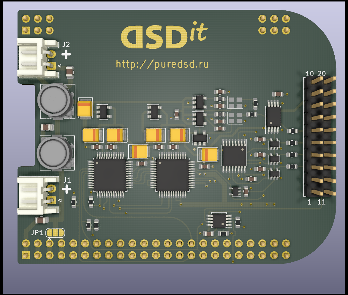

P.S. The schema posted at the beginning of this thread has errors. I will publish a complete set of documents for fabrication soon.

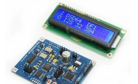

I had no plans to make hardware indication. Everything can be displayed via the firmware web interface. I was recently helped with the webdesign of the "Pure" firmware. In the future, I will expand it.

I haven't finished setting up the AK4137 registers yet.
I found the empty pcb are very large. The original diagram is also buggy. If you re-layout, please add Crystek Clock parallel with NDK Clock.

This project has been completed. Sound quality is quite high.

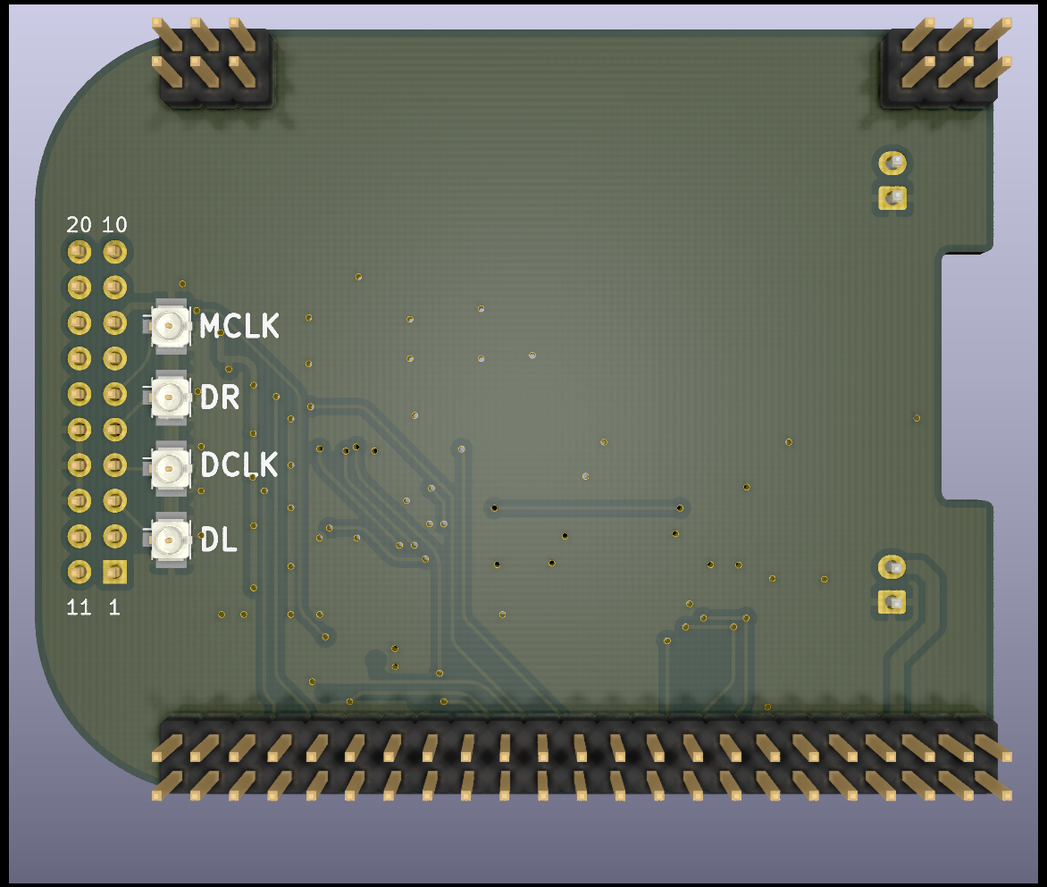

I offer two options:
Complete set of documentation for self production.
DSD`it — Yandex.Disk
- For DSC 2.6.2 + U.FL output.
- For DSC 2.5.2
The firmware Pure is compatible with BeagleBone Black, BeagleBone Green, and AntMiner.
- For DSC 2.5.2

- For DSC 2.5.2
- Digital Line Level
- Simple DSD SRC for BeagleBone
