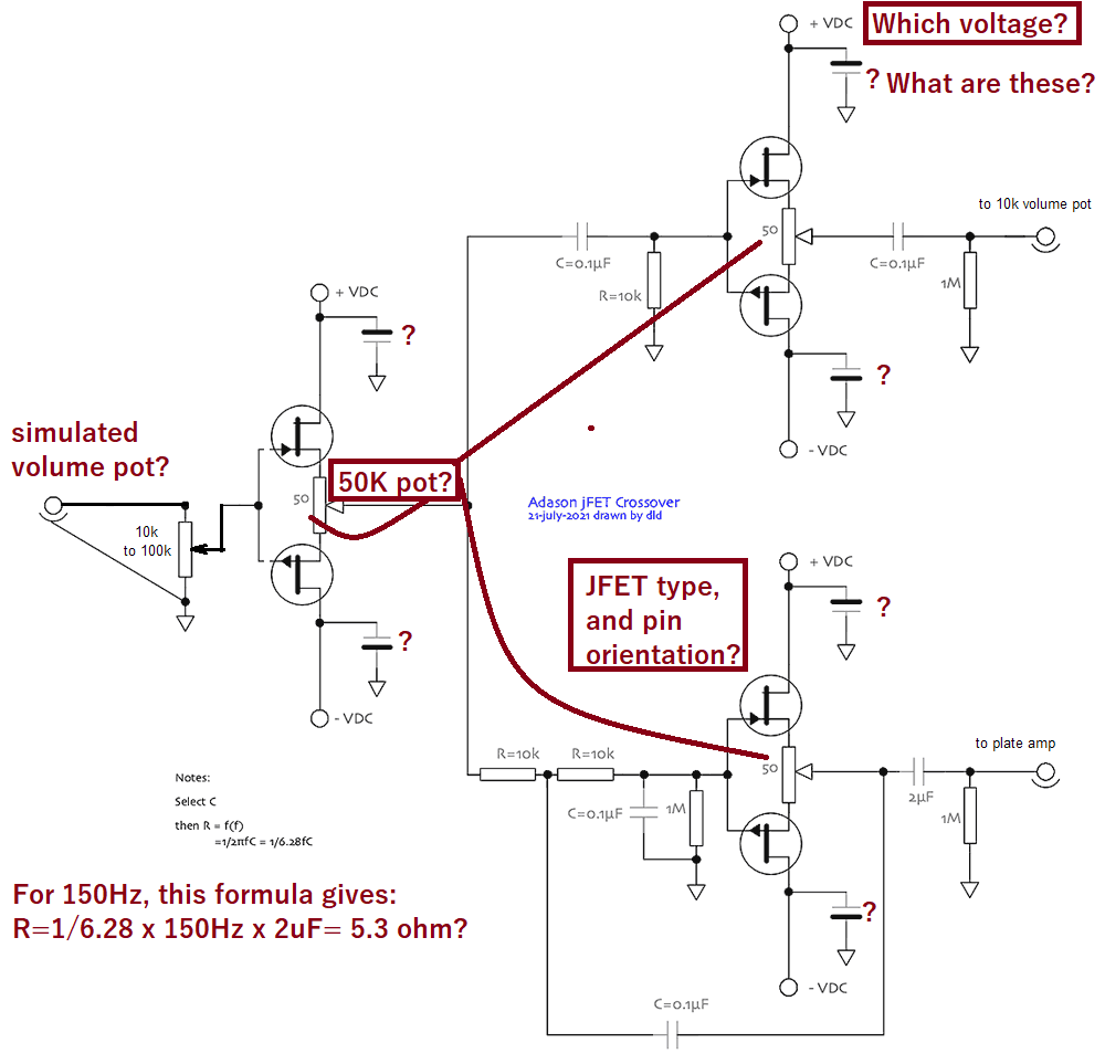

I sugest you read the thread, it has info about jfets many times.
The stuff you marked ? Is capacitor, generic, use common sense.
Calculations are well explained on dave's pages.
https://www.t-linespeakers.org/tech/filters/passiveHLxo.html
Voltage i use is stabilized +/_15 volts, but i used anything from +/_12 to +/_18 and it worked. I would not go higher, as jfets have limits.
Jfets so can be LSK170 and Lsj74? In any position?I sugest you read the thread, it has info about jfets many times.
Yeah, I figured they must be capacitors, but why is not their value written in the schematic? Can the have any value?

Works better in the morning.And your calculation is wrong.
if C is chosen to be 0.1uf (based on what?)
R1=1/2πfC = 1/(2 x π x 150 Hz x 0.0000001uF)= 10Kohm.

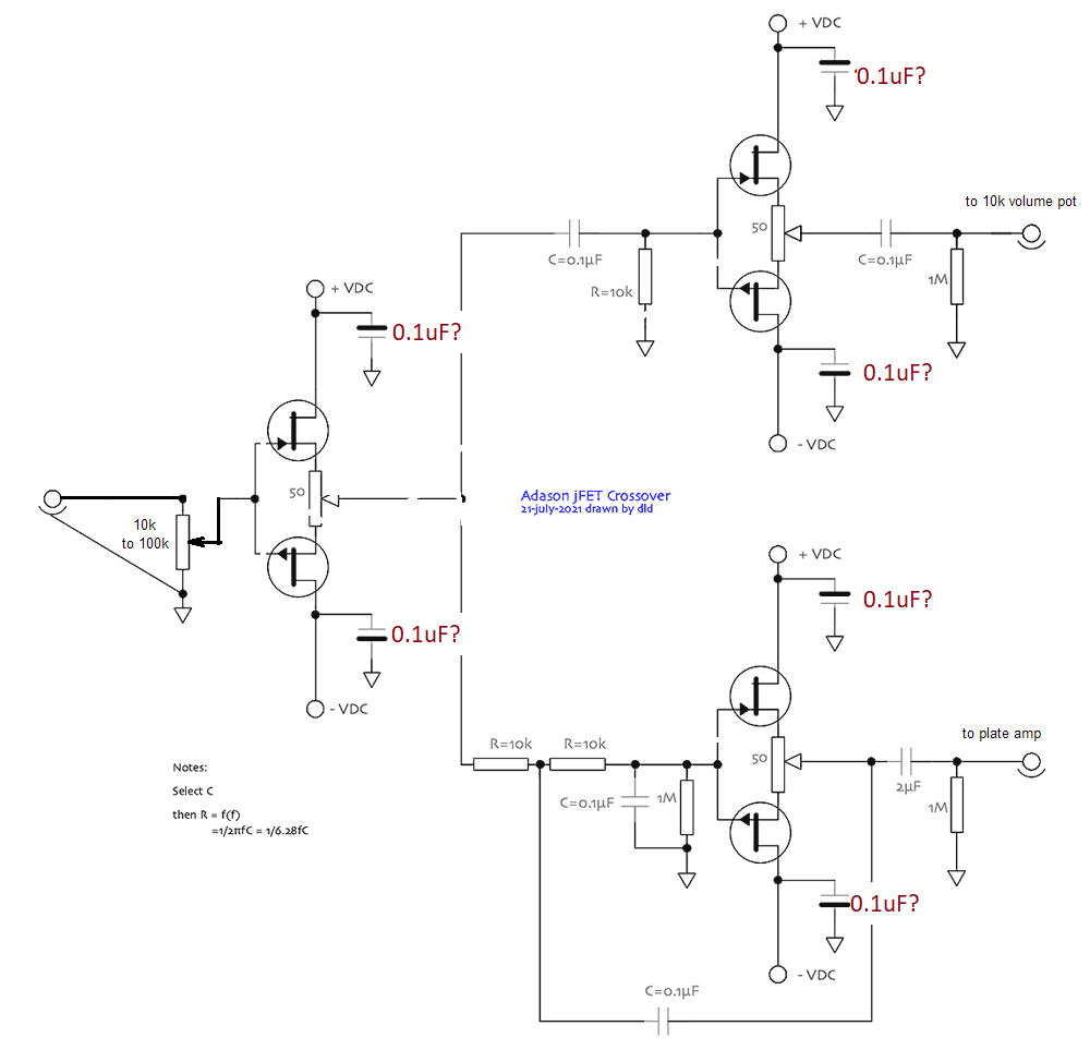

1. I am going to assume that the mystery generic caps can be 0.1uF as well. 🙂
2. About Jfet matching, is it only each pairs or all six or even all twelve Jfets that needs close matching?
3. Nelson swears by bi-polar cap on input and output. Any need for such protection here? I see some caps there already.
1. Feel free to chage it. And recalculate for new resistor. Its not generic, just optimal for given frequency.
2. Just pairs is enough.
3. We select bipolar only if level is big enough to justify bipolar. I built many B1 buffers and his crossovers, and Mr. Nelson always uses mp cap when possible. I do not use input cap, because all my signal sources are well behaved and do not have dc.
Outputs are already cap coupled. No worries there. If it makes you feel better, use bipolar for low pass. I often do.
