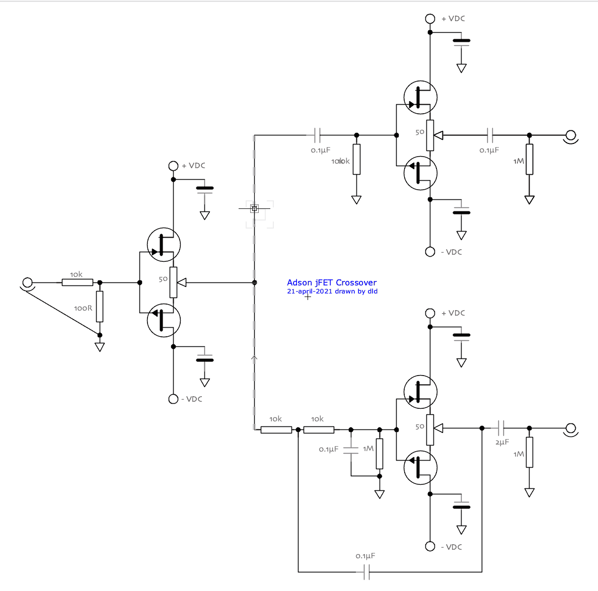

Can we use any of the readily available (say from Mouser) JFETs with this, at least for experimenting?
yes, I have made few versions with J113 for n channel and with J176 or J175 for p channel
distortion is slightly higher, but not bad
but I would recommend Linear Systems from diyaudio store, you will get the same performance as with toshiba

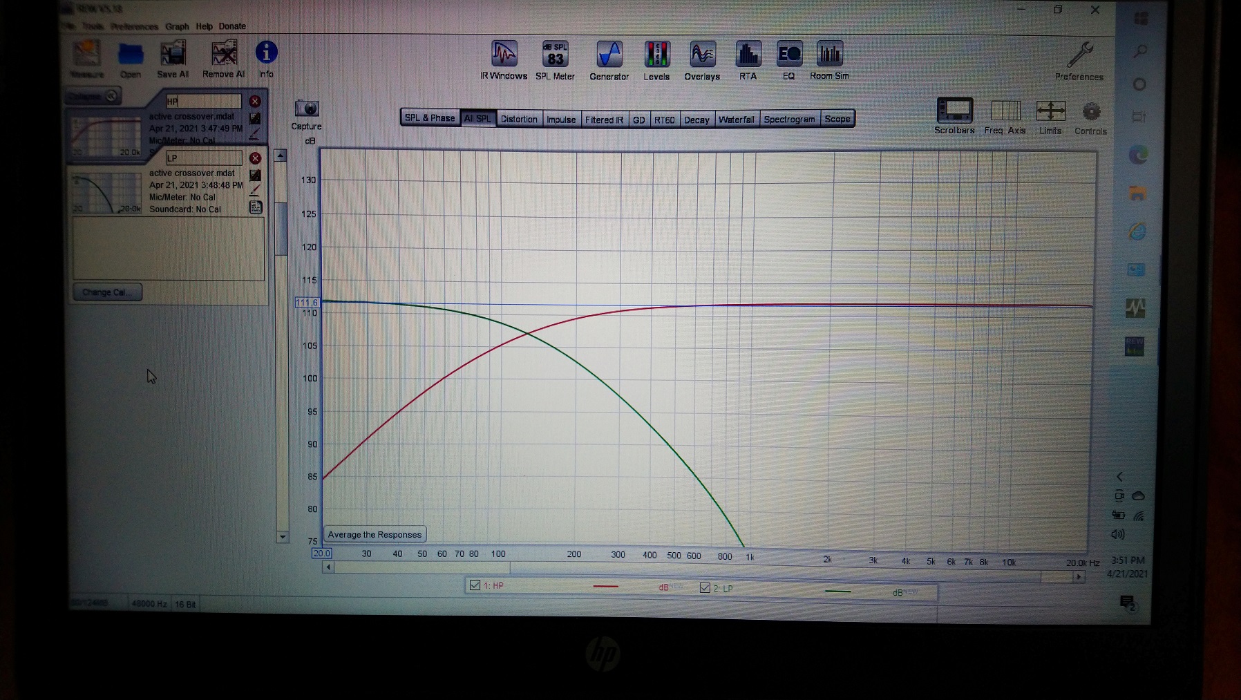

Nice work, Adason. Do you have any XO style measurements where we can see curve for woofer and tweeter overlaid with combined response?
Can’t send you PM’s btw, as your account is not accepting incoming PM’s - please send me your email.
Curve for woofer is hard to get with RightMark audio software I am using, because it requires 1kHz tone to do its stuff. Otherwise it reports missing it and stops. But I can measure it with other means, REW should do it.
\I wand as simple as possible because I want utmost transparency
Then you might have to design the speakers to live within the envelope of what a PLLXO can do.

been there, done that
problem with passive: it can not drive anything properly
and sounds flat boring
passive buffered is much better
and if you noticed, that's what I am doing here for upper path

this is what I got in REW
Nice! Textbook perfect. Looks like a simulation. 🙂

I figured this needs a better drawing, please check for mistakes in translation.
dave
- simple active crossover
