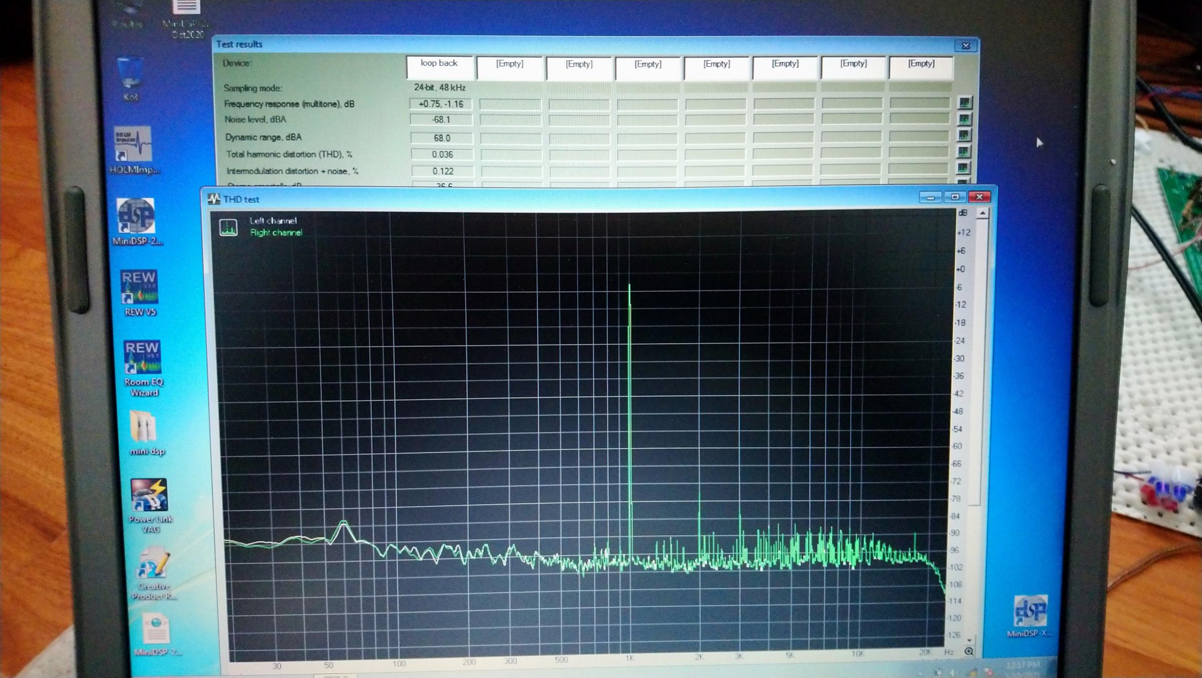

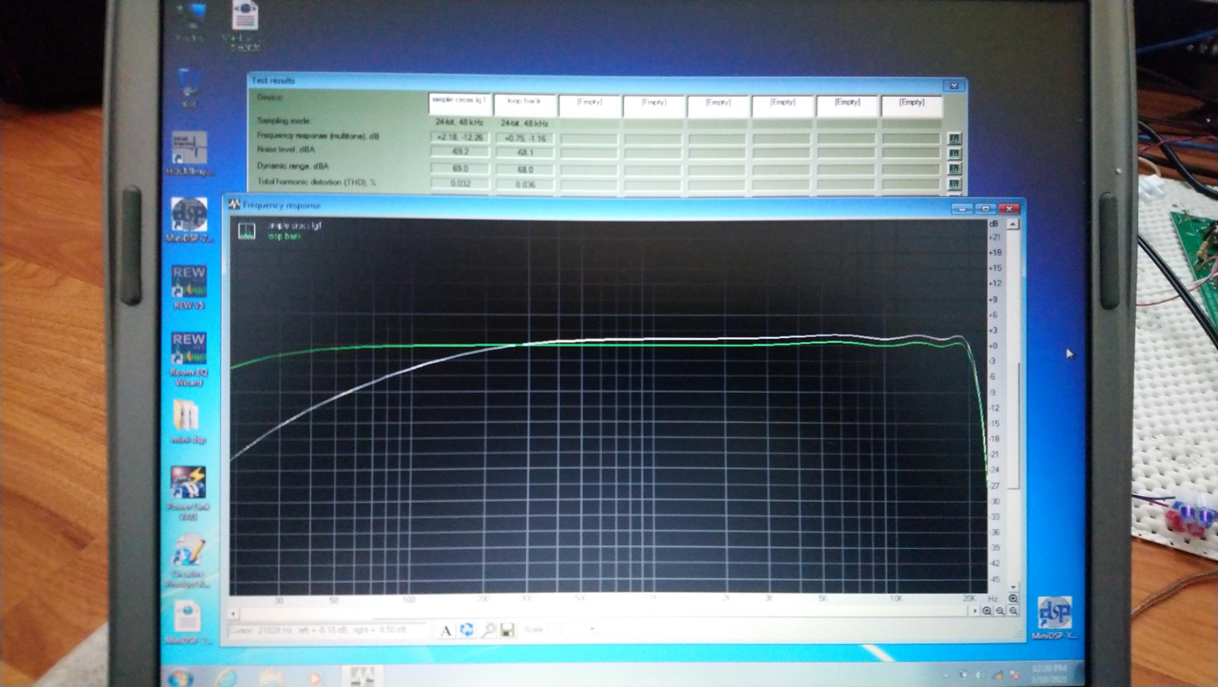

before I post data from focusrite, let me just post previous with dell laptop, no soundcard

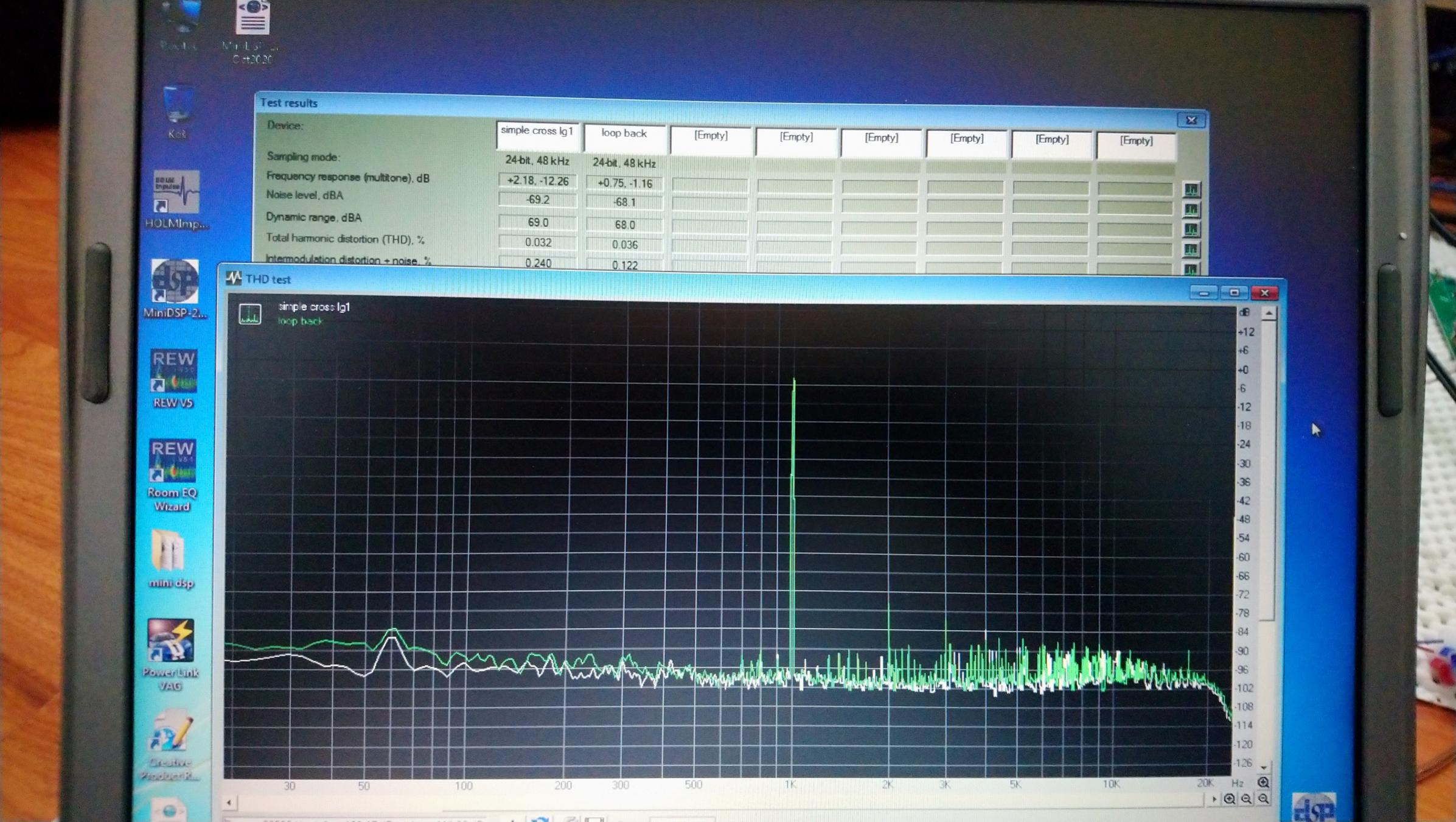

first is loop spectrum, second is simple active crossover spectrum, then comparison, not much difference, and fr response comparison as last

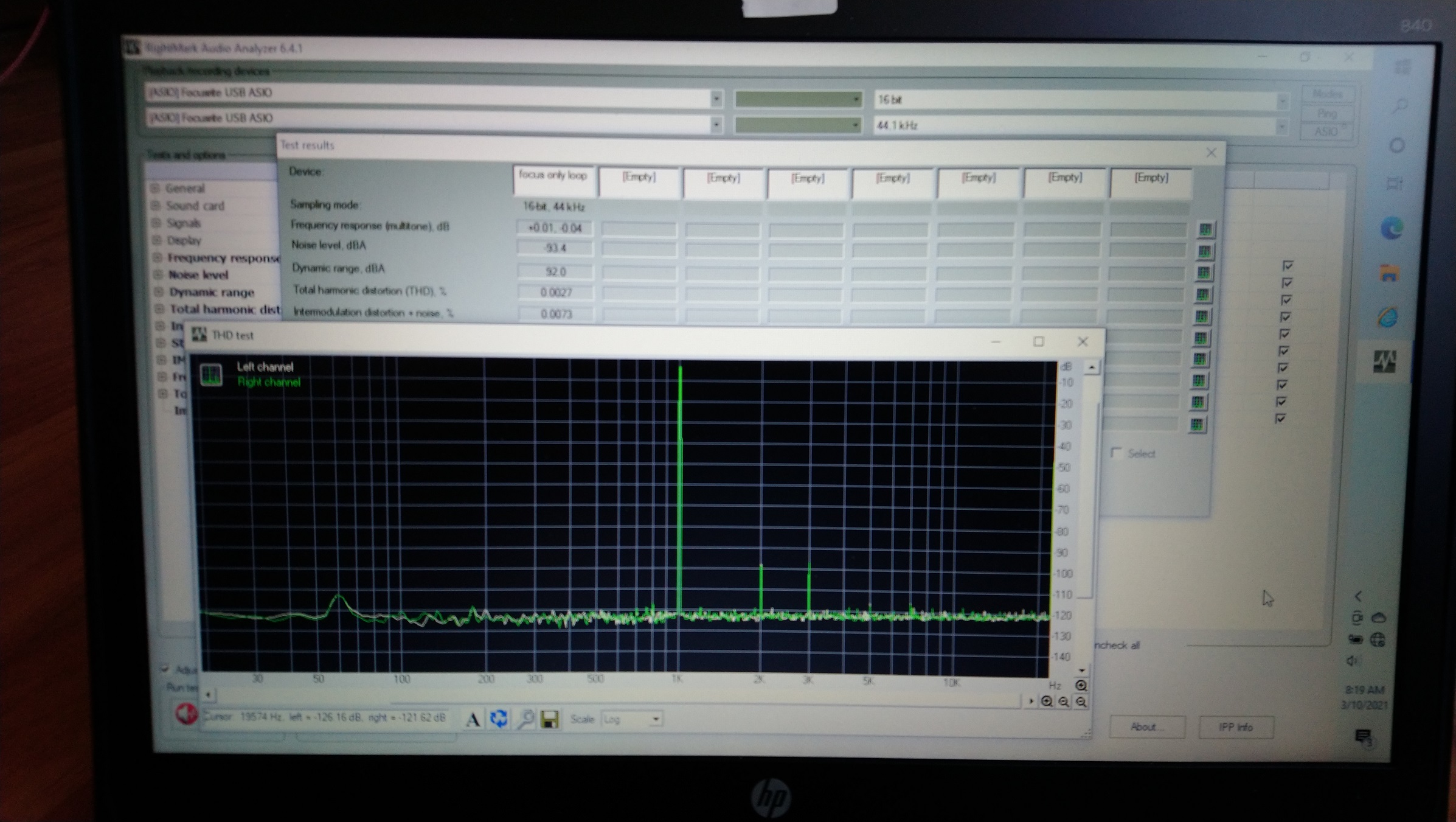

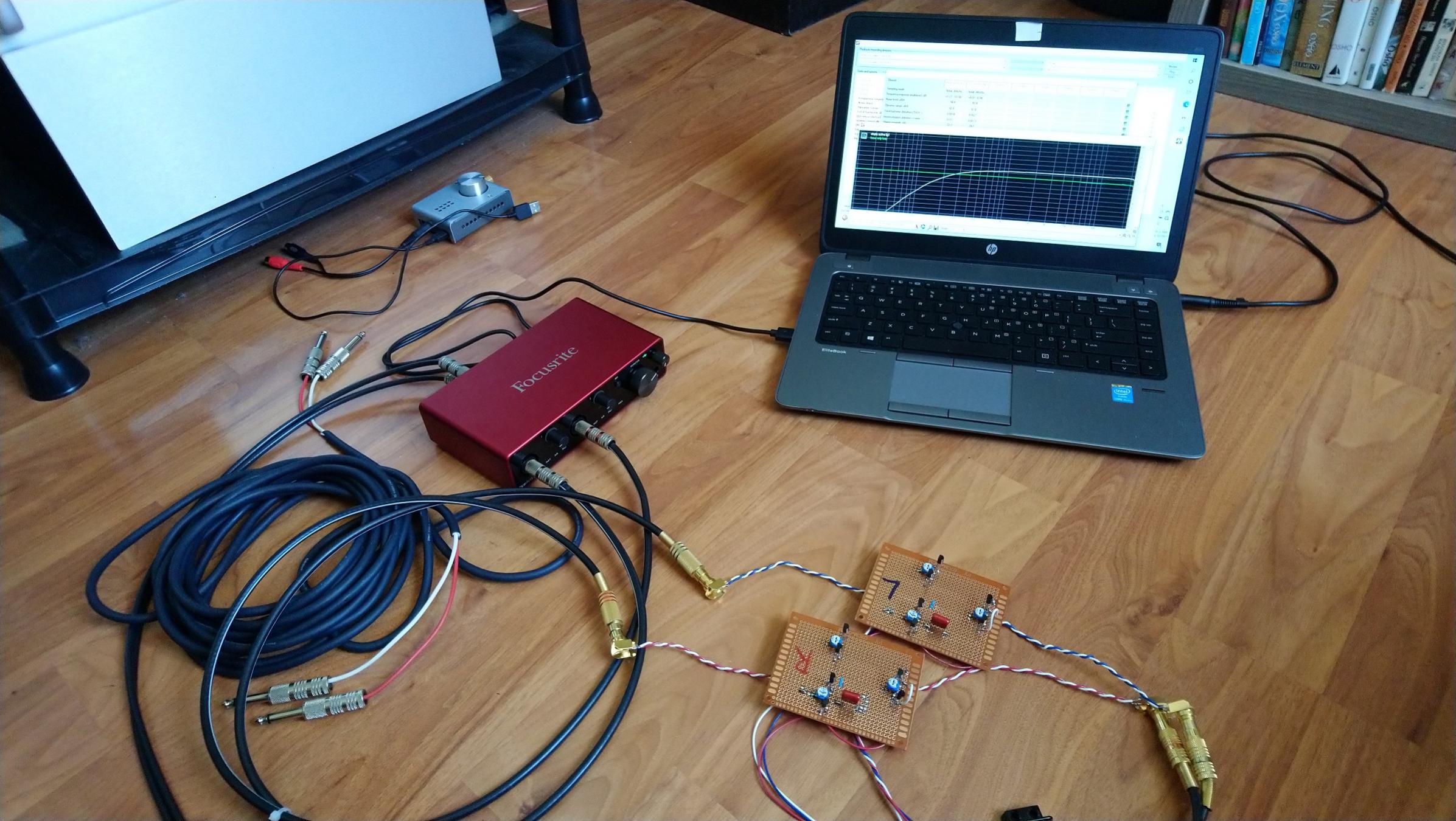

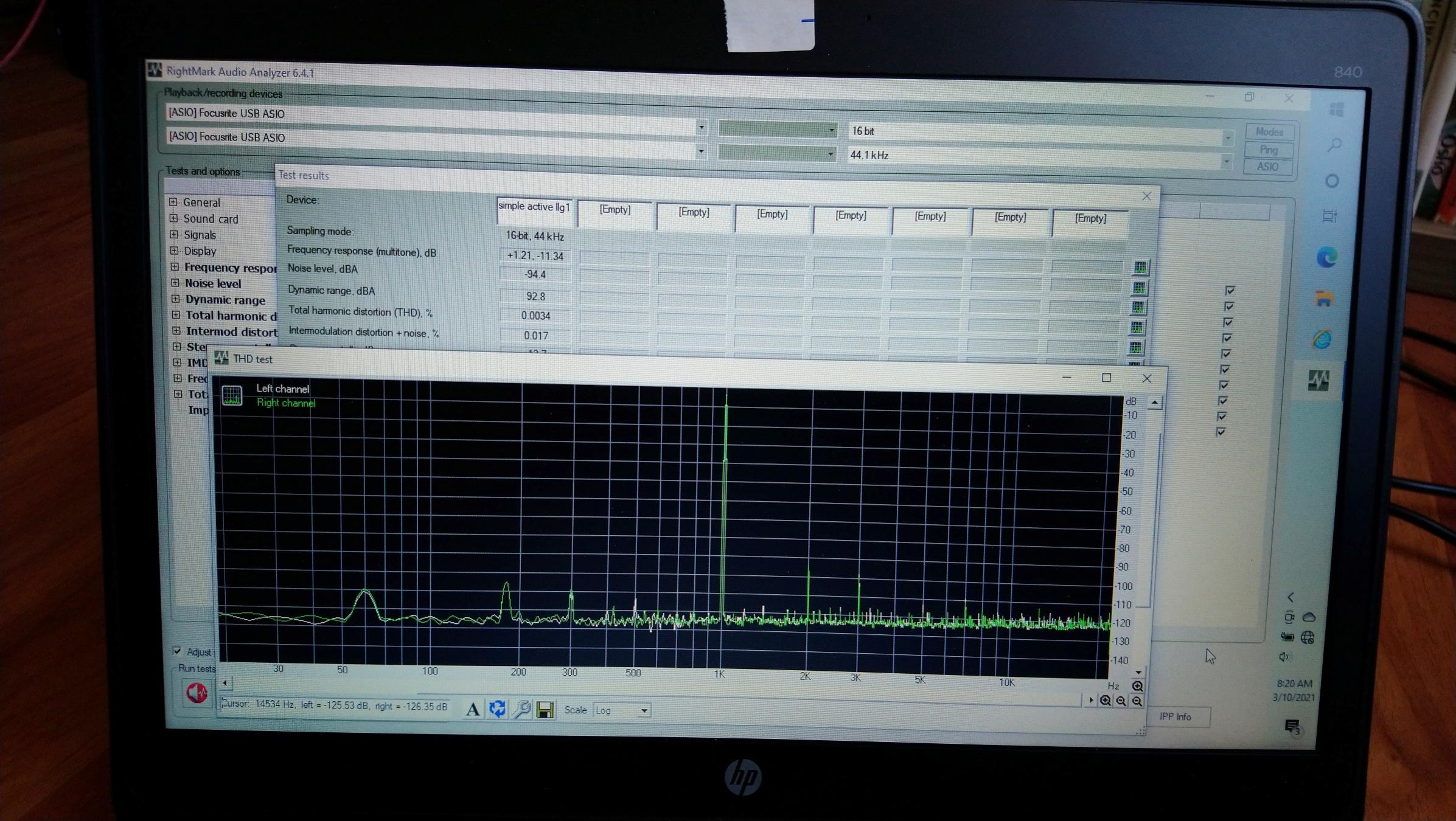

here are some results with focusrite, I need to make some custom cables, I had to scavenge from behringer ultracurve, and for loop I only have very long cable
it took me a while to set all right, and still I need to learn all the settings
anyway, here is what I got
first is just set up, second pic is fr spectrum for the loop only, pretty clean, distortion ~0.0027%

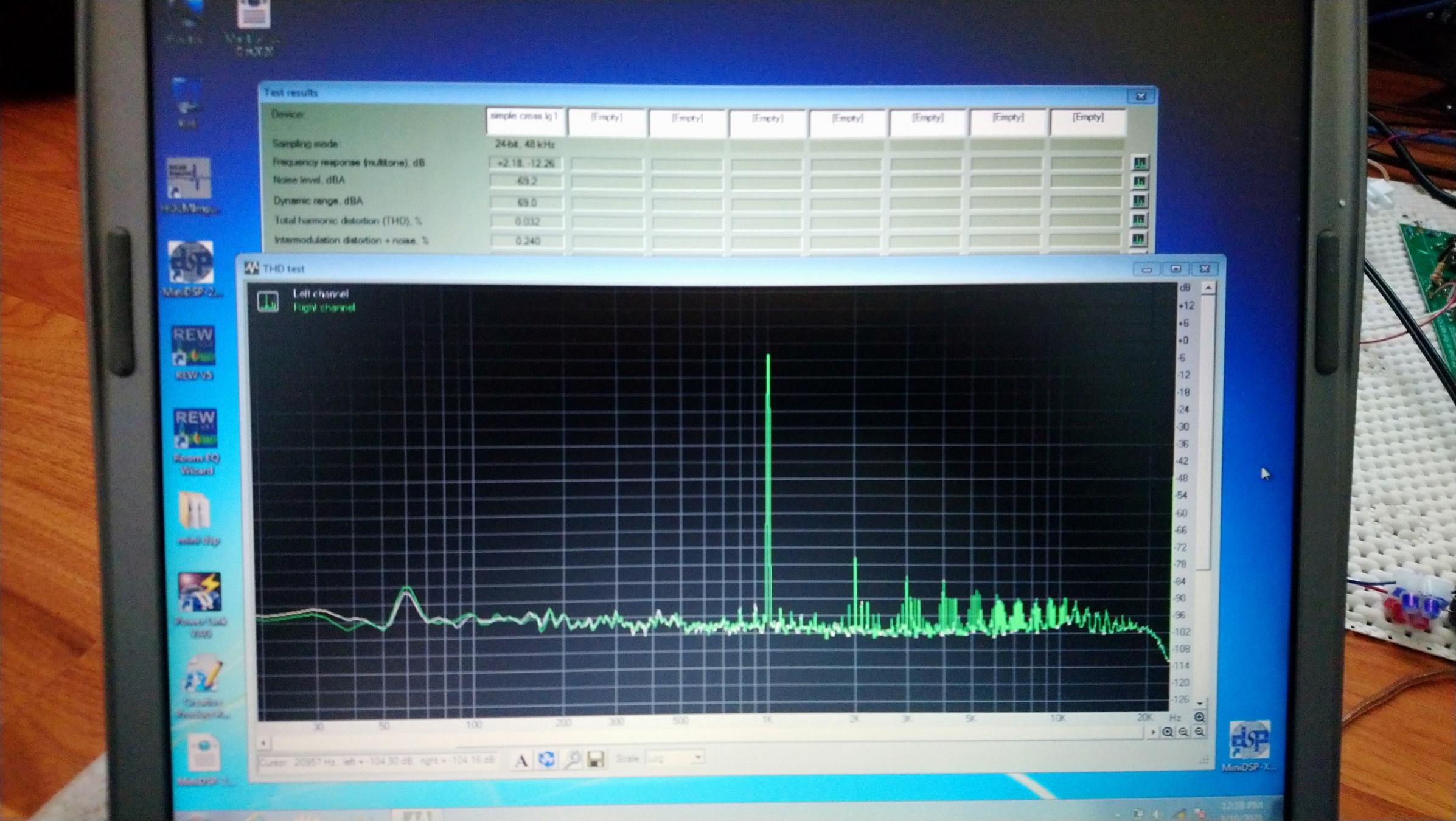

next is simple active crossover, similar spectrum, distortion ~0.0034%
there you have it, I can measure the distortion now 🙂

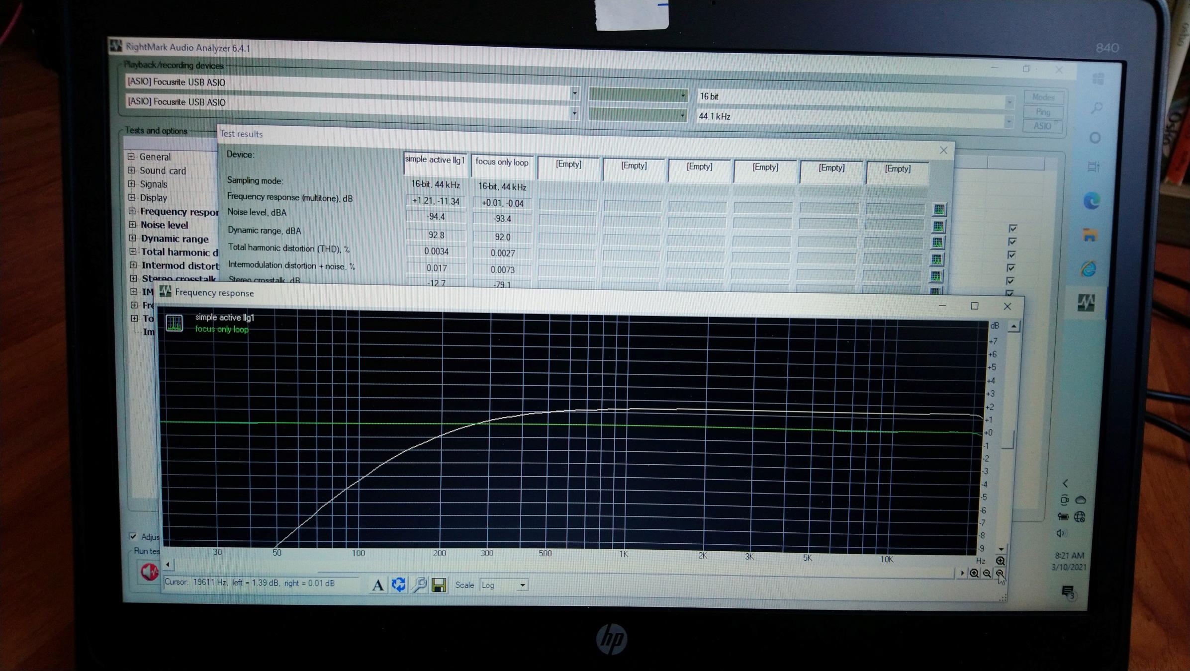

last pic is fr response comparison
Now that's what I call proper screenshots! I like it.
Good work and congrats you're happy now with that filter.
Would be good to do some tests with Arta, and reduce the level to at least -6db do some playing with loopback to find the sweet spot of the focusrite. Output and input levels need to be adjusted for optimum distortion and noise floor. I suspect your input level is too high based on noise floor being around -120db in the loopback. Should be able to get close to -140db I would think.

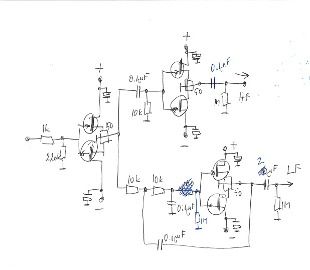

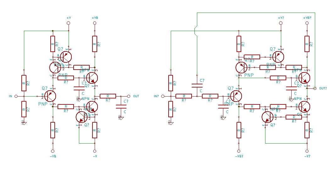

I do not have much update, except I finished the lower path section and tested it all together. Works great. When I plugged all in, I had two amplifiers after the crossover quite high in volume settings, and since I did not have volume before the active crossover, when I pressed 'play' on my cd player, it was louder than I expected. So I know now that is was unbelievably clean at level way above my normal listening volume. I am quite happy with the results. I will finish and box few of these for testing in big system.
Few observations: when I was experimenting, that 50 ohm trimmer may not be completely able to make total zero on the output, its range is limited, depending on the p and n channel jfet match. In some cased I had millivolt or so output at max position, so reluctantly I decided to add one more cap on the output. It does not hurt, and makes the slope little steeper for open baffle.
When I was experimenting with CRC upper path before the second buffer, I noted weird behavior sometimes, when I touched something, n channel jfet started to be fully open and I got 14.9 volts on the output. When I placed 1M ohm resistor from gates to ground, this never happened. So similarly, I placed the 1M on the low path too.
This is what I have now.
edit: one more thing, I used 2uF on the LF output, that's what I had, I will measure fr response later
