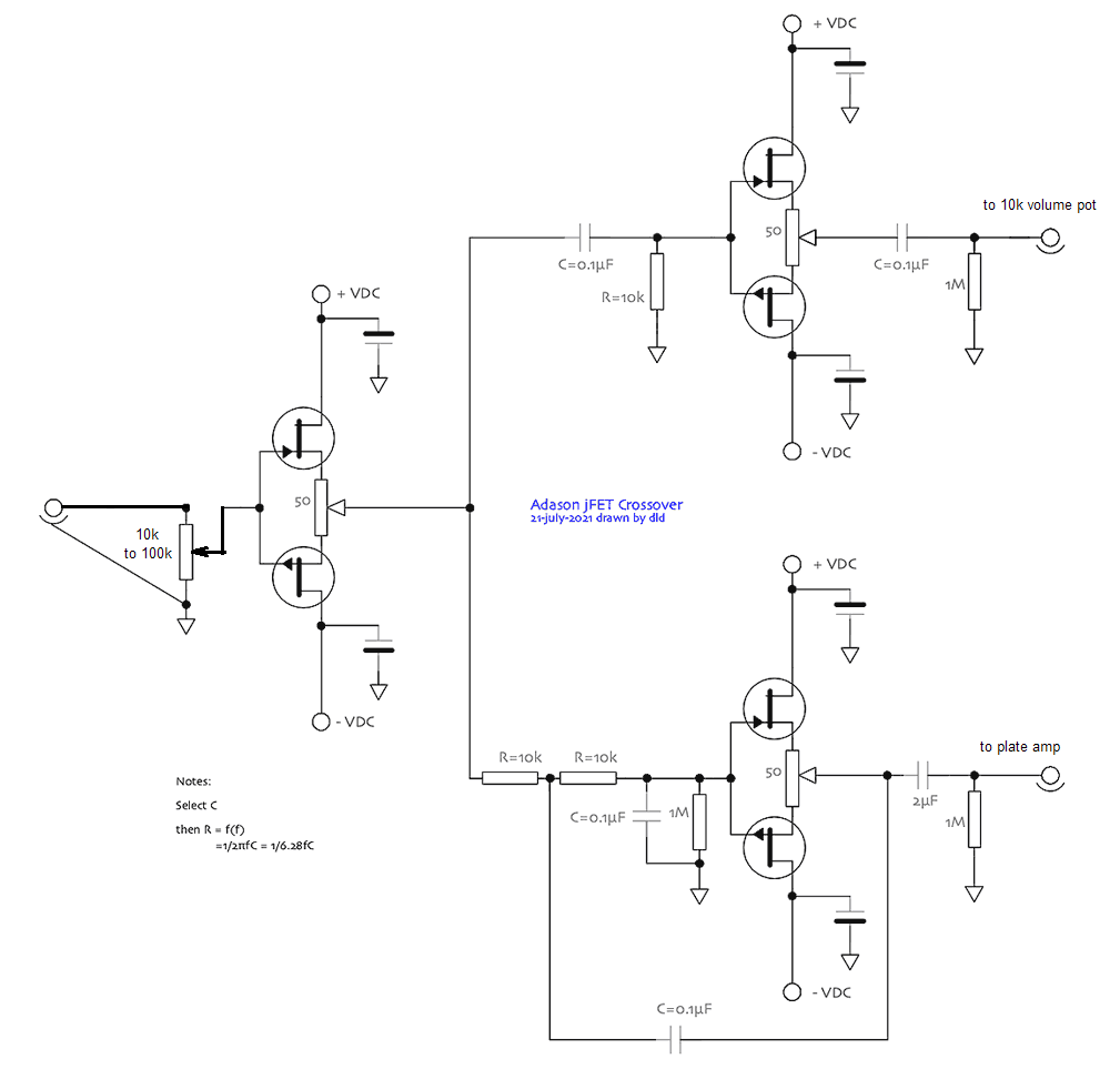

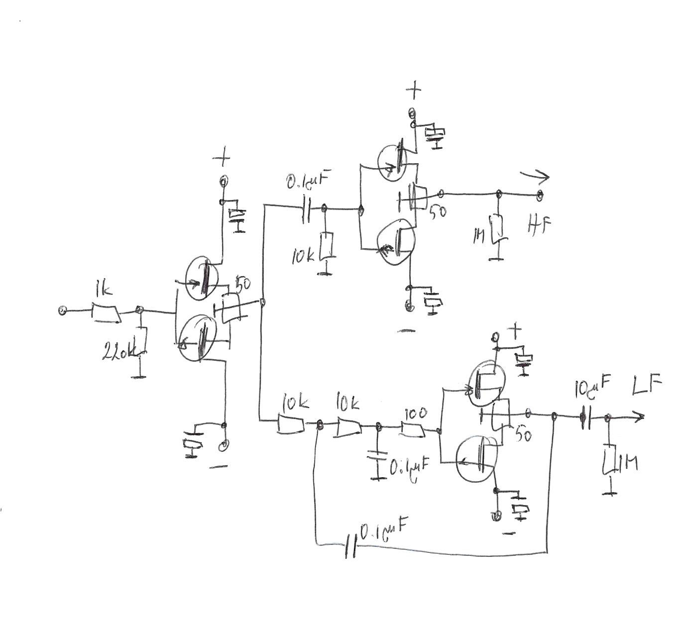

simple active crossover

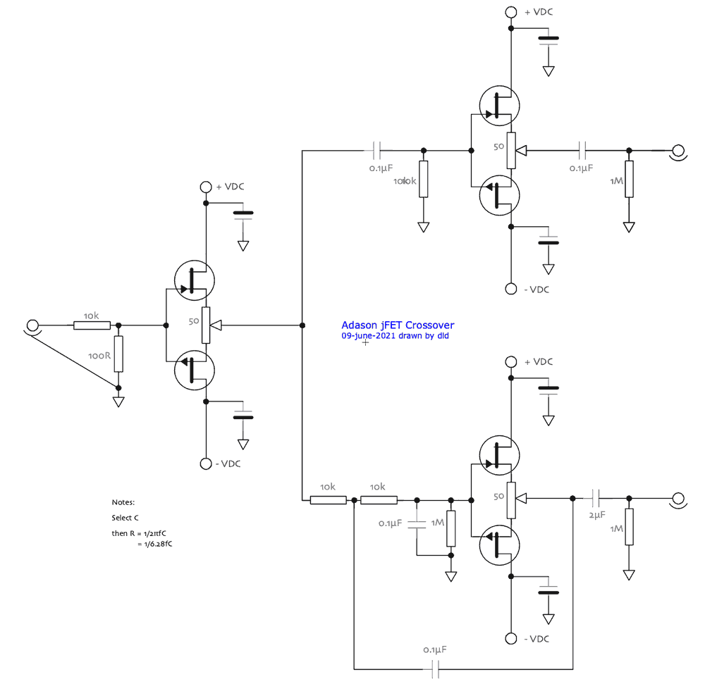

Wow, that's beautiful, thanks!

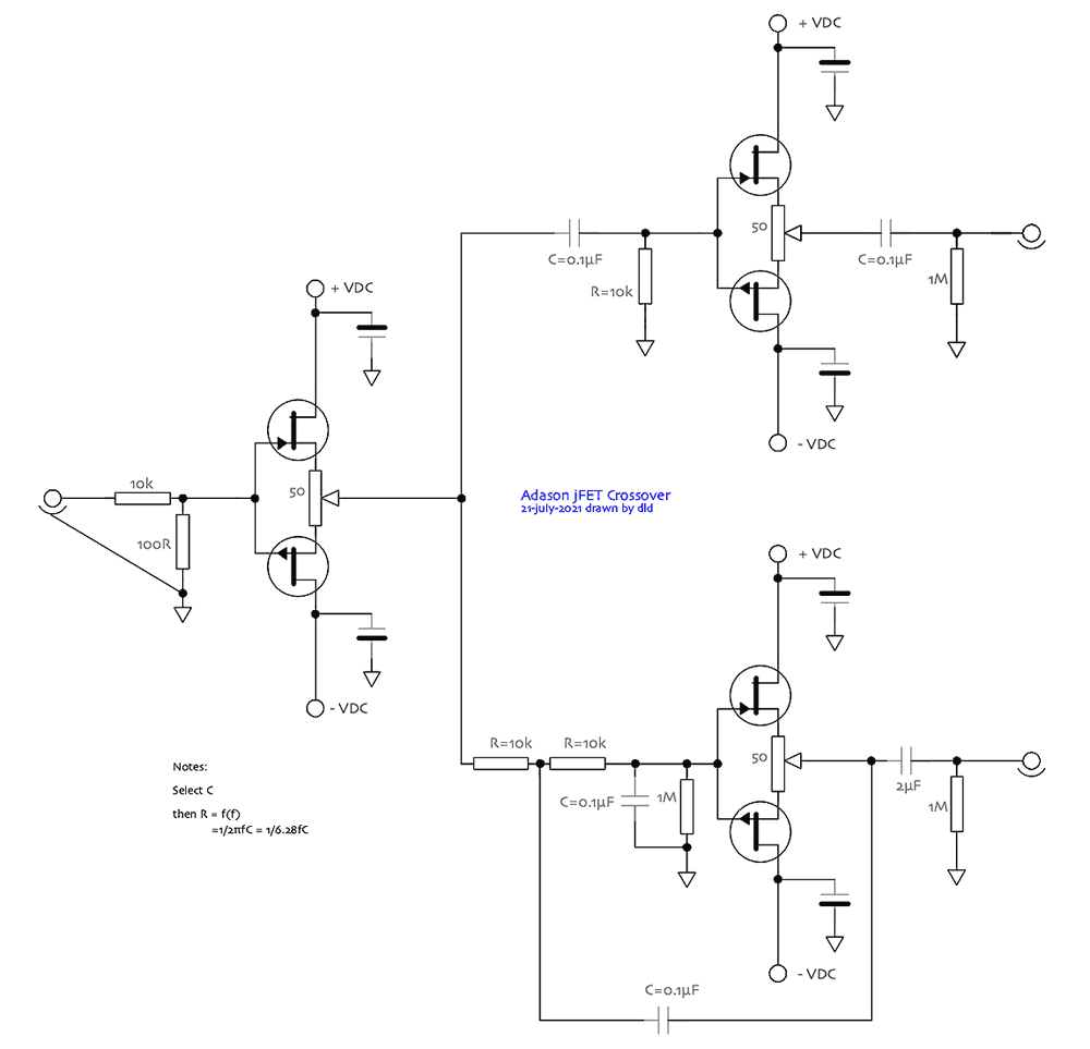

Made some edits.

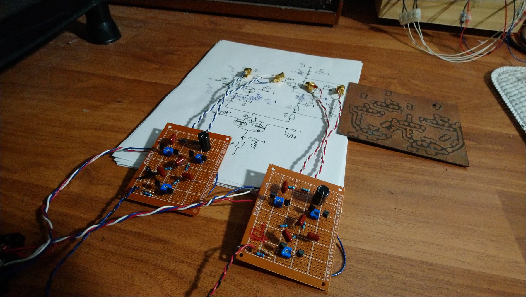

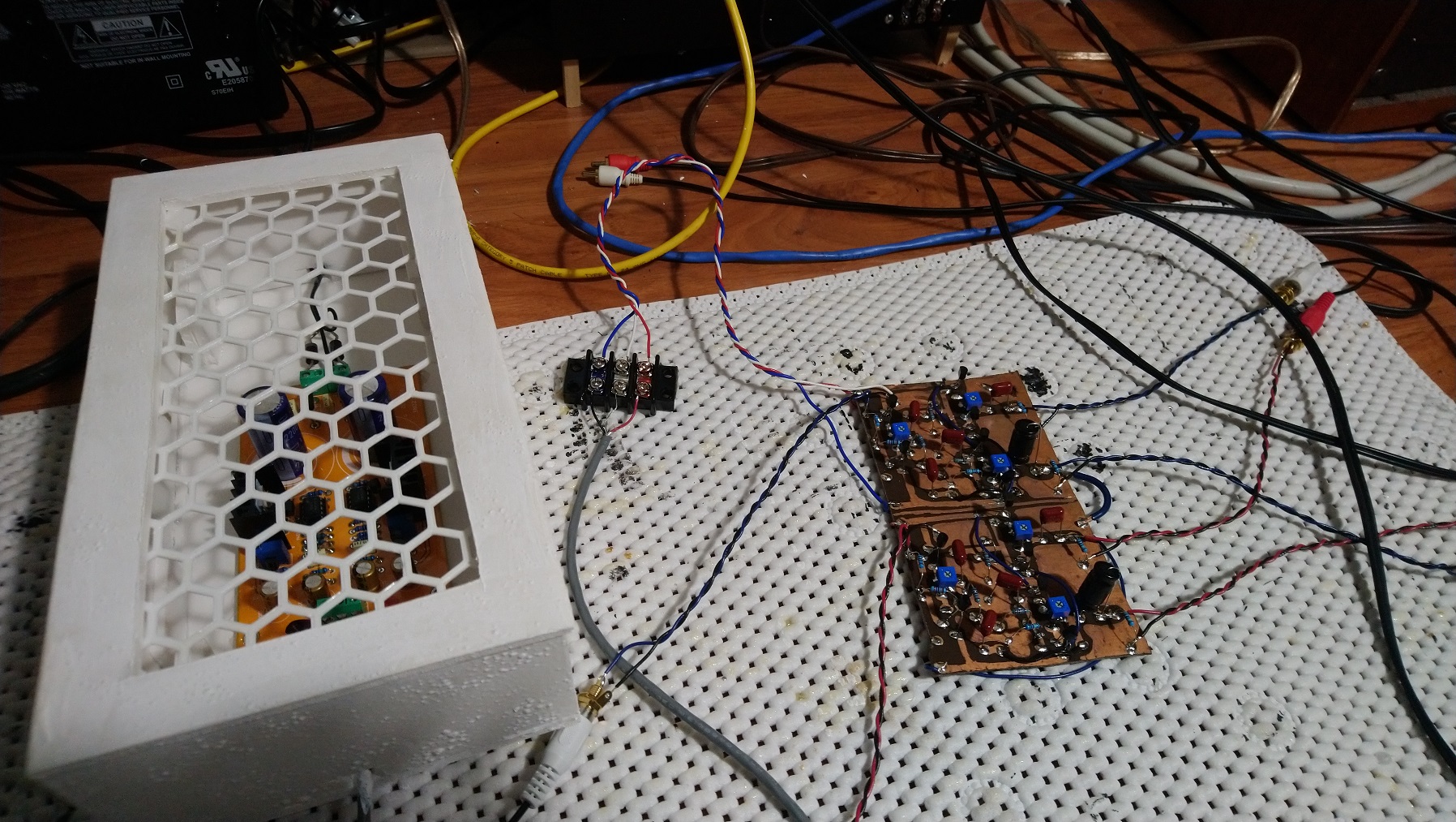

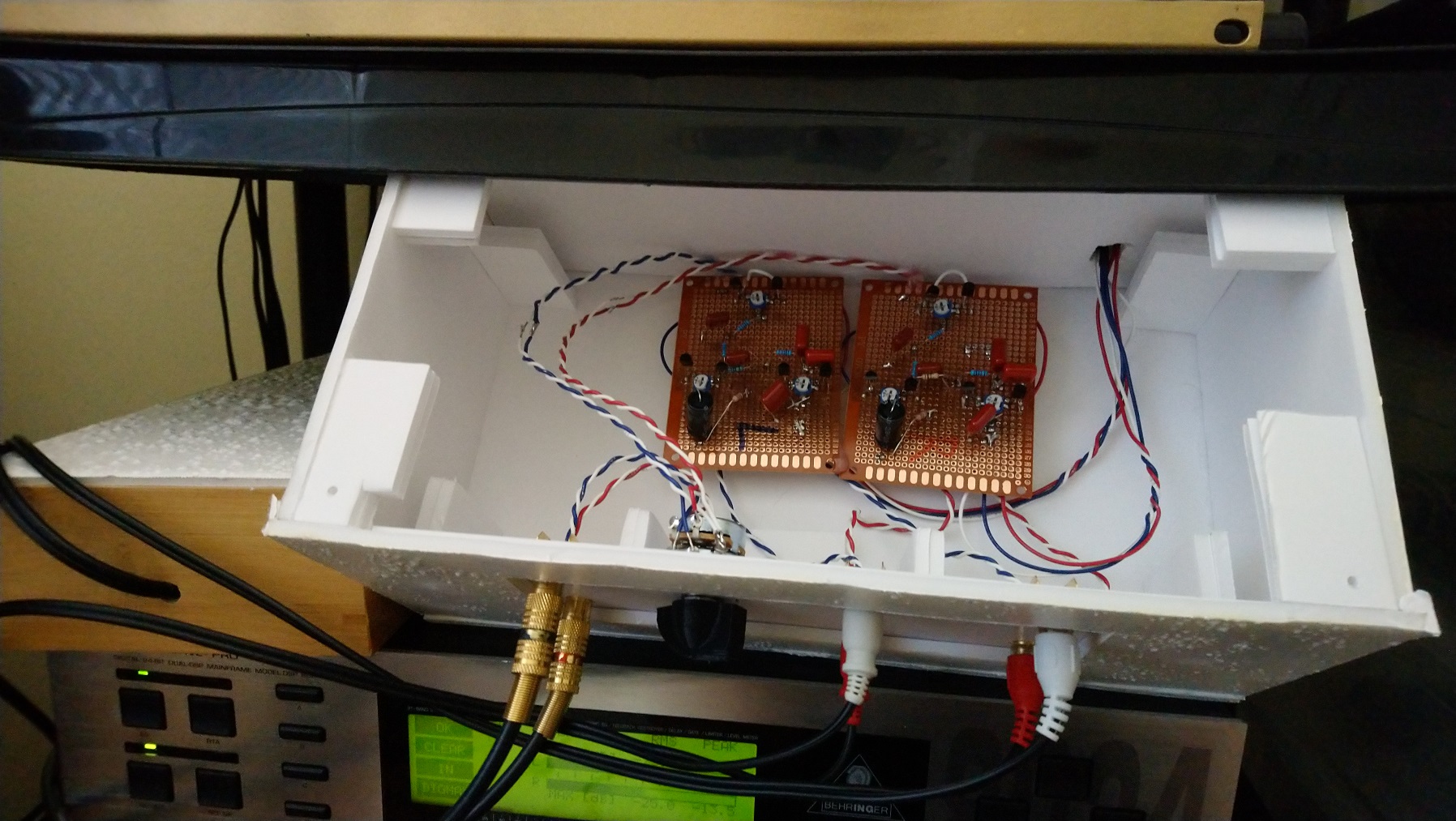

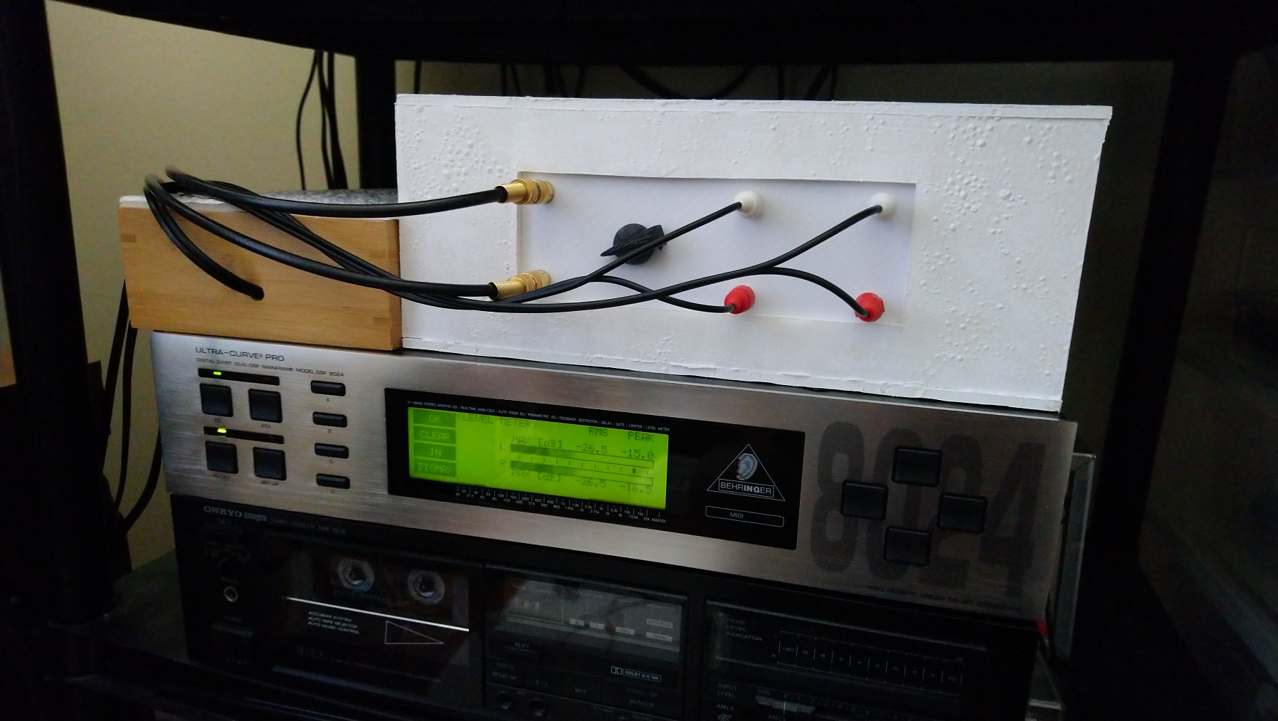

I wanted to try PLLXO, but chickened out after reading about its disadvantages and now I am building the 6-24 active crossover, in an attempt to get rid of the typical minidsp sound (yuck!) and reach the ultimate in ethereal clarity, etc.
Any chance these will be available for the common uneducated DIY user soon? I am having trouble understanding what goes where in the schematic. We almost have the same crossover point. Right now I am at 200Hz, I just need to modify the midbass horn a little to get down to 150Hz. 🙂
