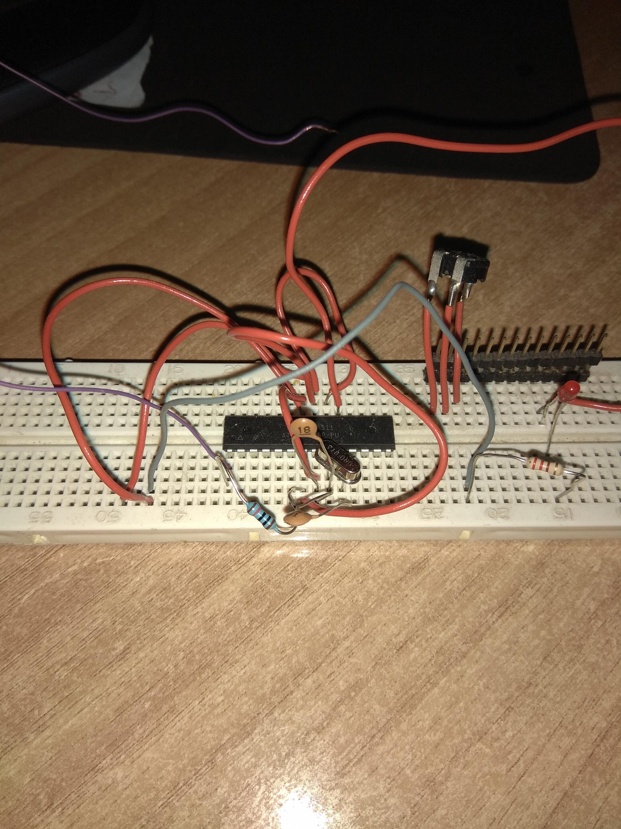

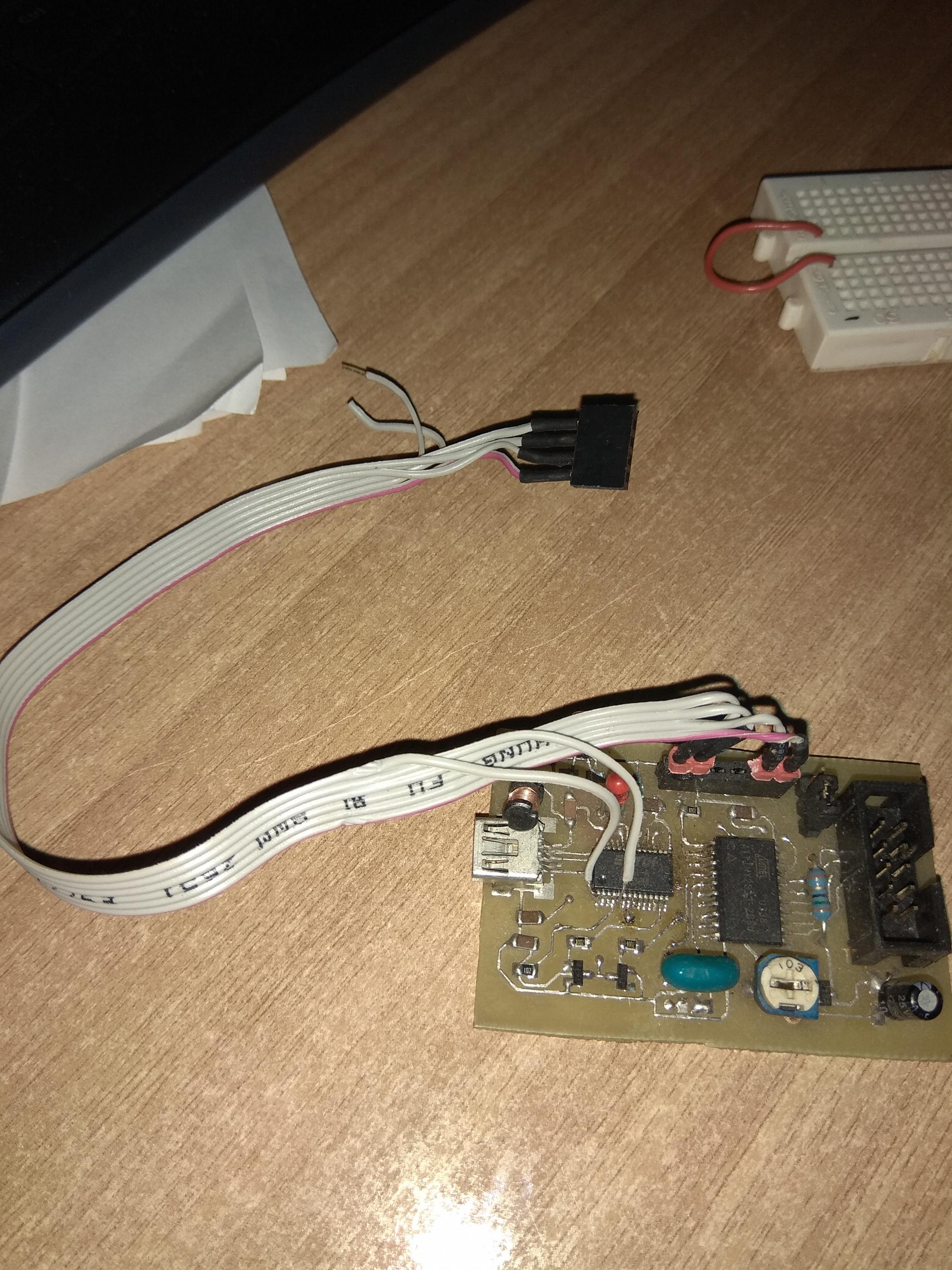

I used an arduino nano to burn the bootloader .
Now i see a blinking led connected to pin 19 of atmega328.
I think this say that bootloader is present.
I will use this diy FTDI to load the sketch.

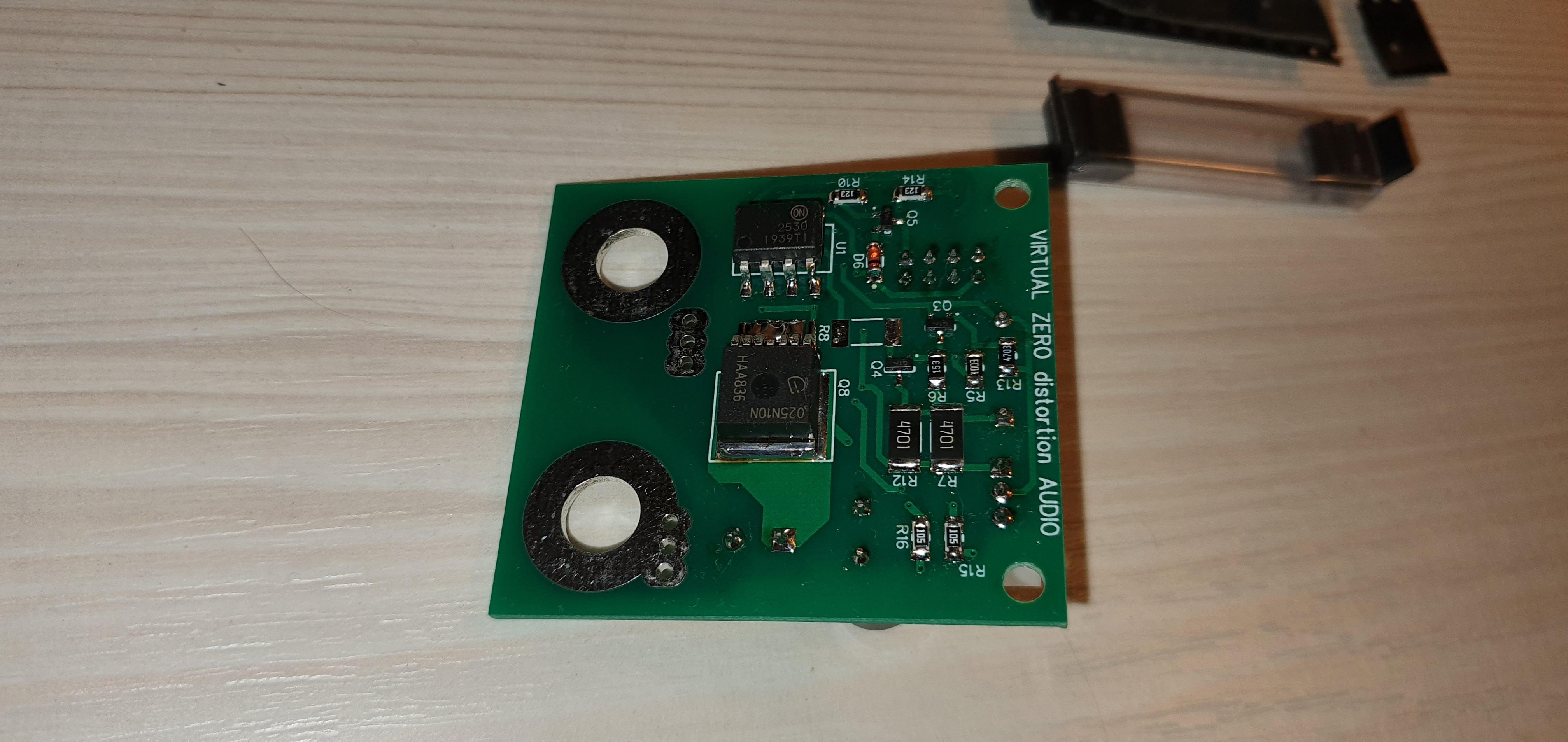

Hi, just a question, I have started populating the protection boards, R8 is a 2512 SMD part but the only other found in thr bag is written 2201 (2k2) but the BOM says 1k2, is the value supplied correct or the value mentioned in the build guide wrong? I will do a small check on the rest of the parts for any other mismatch if any and write back for any advice.

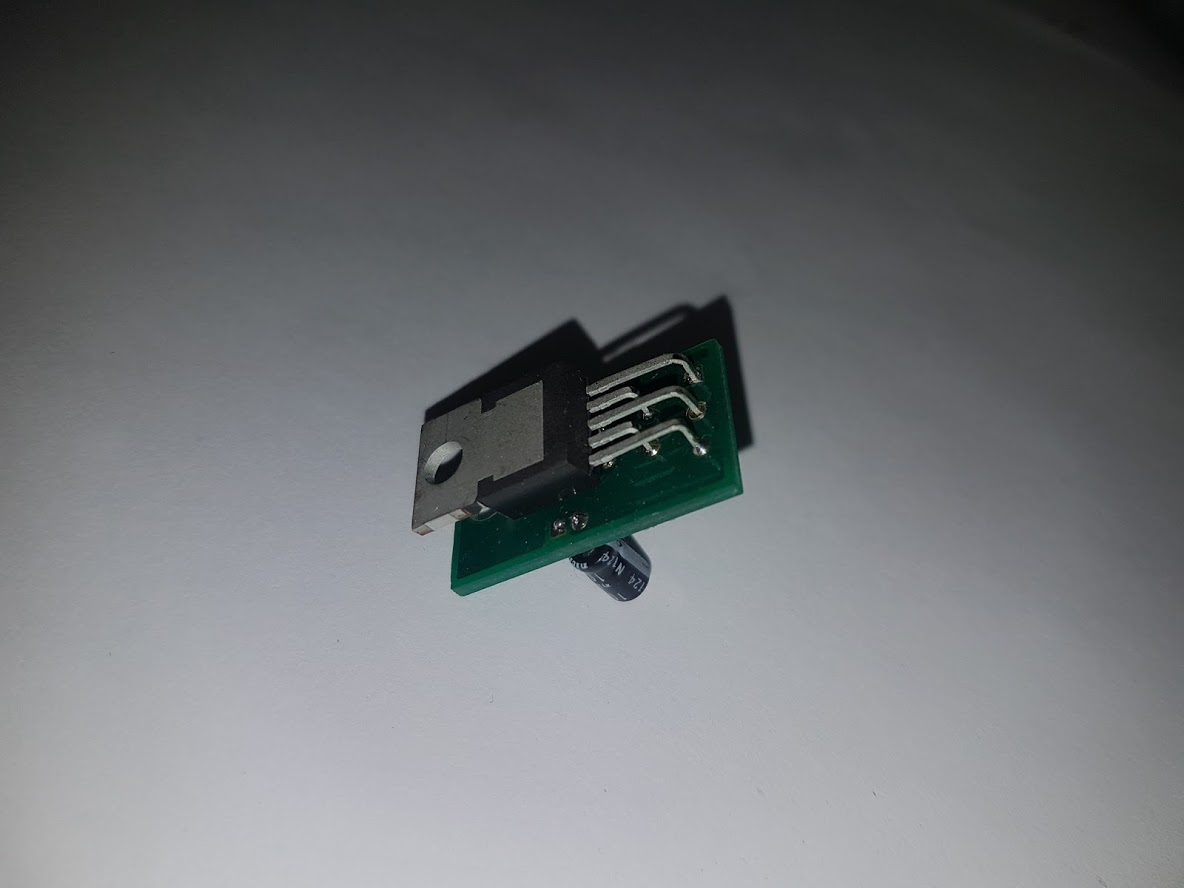

Thanks. The small sensor pcb and thesensor IC should be sokderded with the pins alternated? Could you post a photo just to make sure I will put the boards ok.

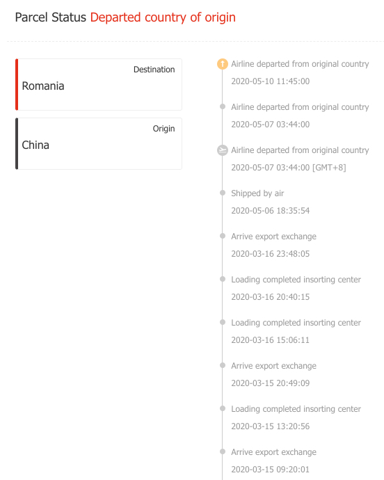

Hi, just got my notice from the post office that I have a package of about half of kg, probably the parts kit, is it any way to check for the binding posts?
Thanks,
Florin
Hi Florin,
I have contacted the logistics - they say deliveries are heavily delayed due to the coronavirus issues and overall aviation freeze.
Attached is what the tracking system is showing (tracking number is RE029679788CN).
Sorry for such a long time waiting - in the worst case we will re-sent the product or offer a refund. Although I'm still hoping you get the parcel soon.

It sounds like I may have sent the wrong resistor for R8. It should be 1.2K. I hope my inventory isn't messed up, otherwise there will be a few others with the same problem. Are all the other parts correct?
I'll need to do some digging to find a picture of an assembled temperature sensor. The sensor mounts under the board and the pins are to be bent up 90 degrees. The pins are bent at two different lengths, like in the 3D image except they are bent forward instead of back.

Ho, I managed to make a full inventory today on the kit sent, I will e-mail you the contents received, I did manage to put together allmost both the speaker boards without R8 unfortunatelly, like I have said some resistors I will manage to get here, so it wont be such a hassle. I will send the list to you tommorow, can I program the controller later? If I start putting the other parts on the board and write the sketch later, would that be an issue? I am asking because one of the parts missing is the crystal Y2. I will try and find it on TME.eu , its a 16Mhz from Murata, I will try and locate it with the name from the guide, hopefully they have it, if not can I use any 16Mhz crystal? Any key specs to look for ?

I remember putting the resonator in the kits but it's pretty easy to loose, I may have dropped it before sealing up the bag. You can usually install the bootloader without the resonator installed. The Atmega328 has a built in 12MHz crystal (if I remember correctly) that operates until the bootloader is installed. If not it can be done any time.
Here's the resonator I normally use, but there are others that will fit. CSTNE16M0V530000R0 Murata Electronics | Mouser Canada I don't see anything on TME's sit that looks suitable though.
