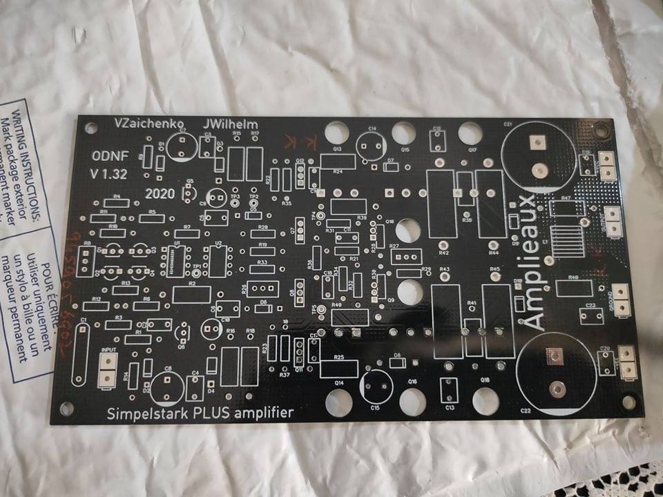

- Group Buys
- Simpelstark+ ODNF amplifier boards GB
