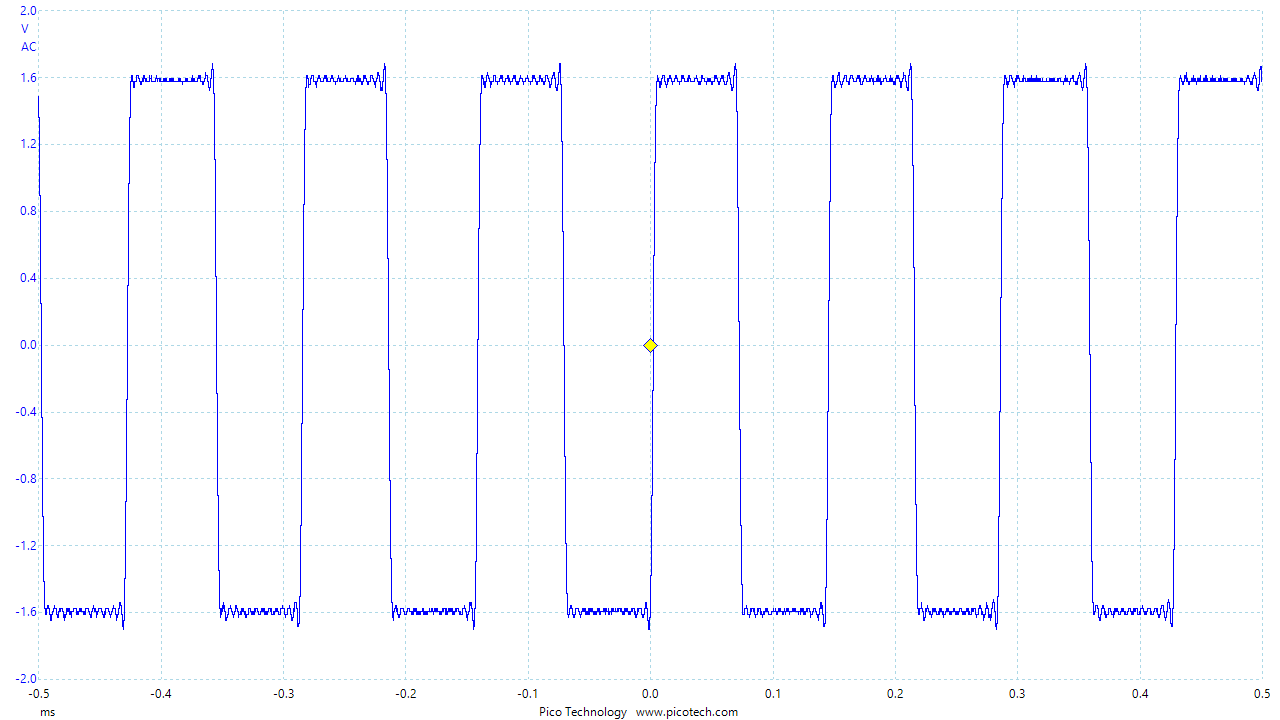

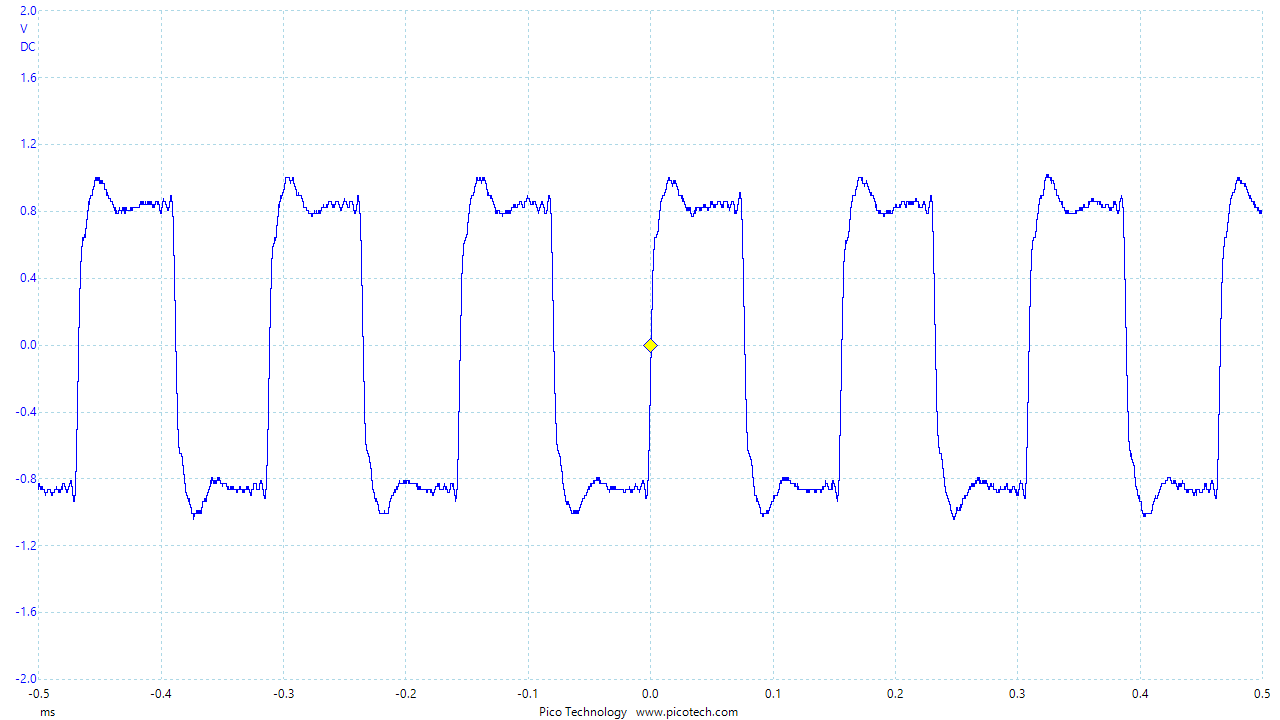

Here's some plots from picoscope: one is the 7k square wave from dac board. another is the same wave after output board.

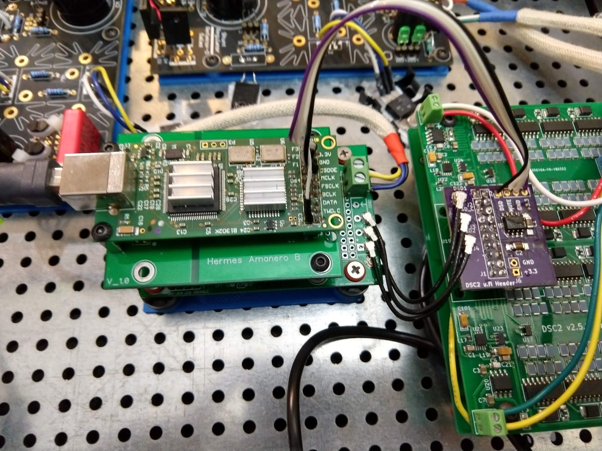

@ppy: hats off to you! That was it.
Perhaps I'lll look into replacing the inverters. Especially if it would work with the rest of the DACs I have.
The good news: I realized that BBB Botic driver has the option to invert the phase. So I connected my BBB->Hermes->Cronus -> BCK.DSDL/DSDR ->DSC2.6 and pin 10 to pin7 to provide DSDEN. Same noise as before.
Then I changed
Code:
/sys/module/snd_soc_botic/parameters/dai_format
contents from the default 16385 to 17409.
Boom! Perfect sound. There are of course pops from the DSD start as the mute is not operational, but I'll deal with this later - for now I'm quite happy.
Thank you Pavel for your help and continuing support!
Can you post some pictures of your Beaglebone, Hermes, Cronus and DSC2 setup? I plan to do the same thing and I want to make sure that I have everything hooked up correctly.
