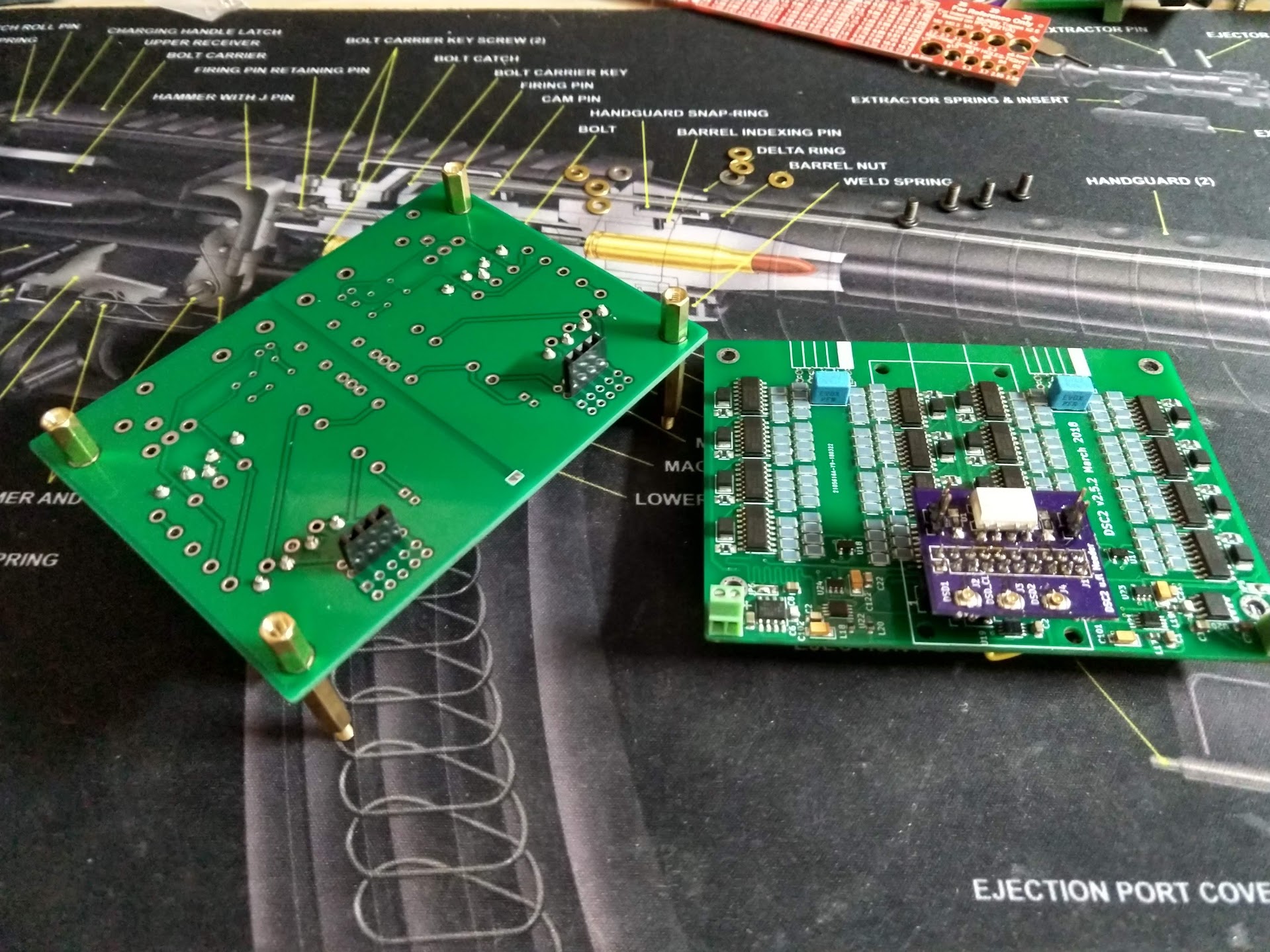

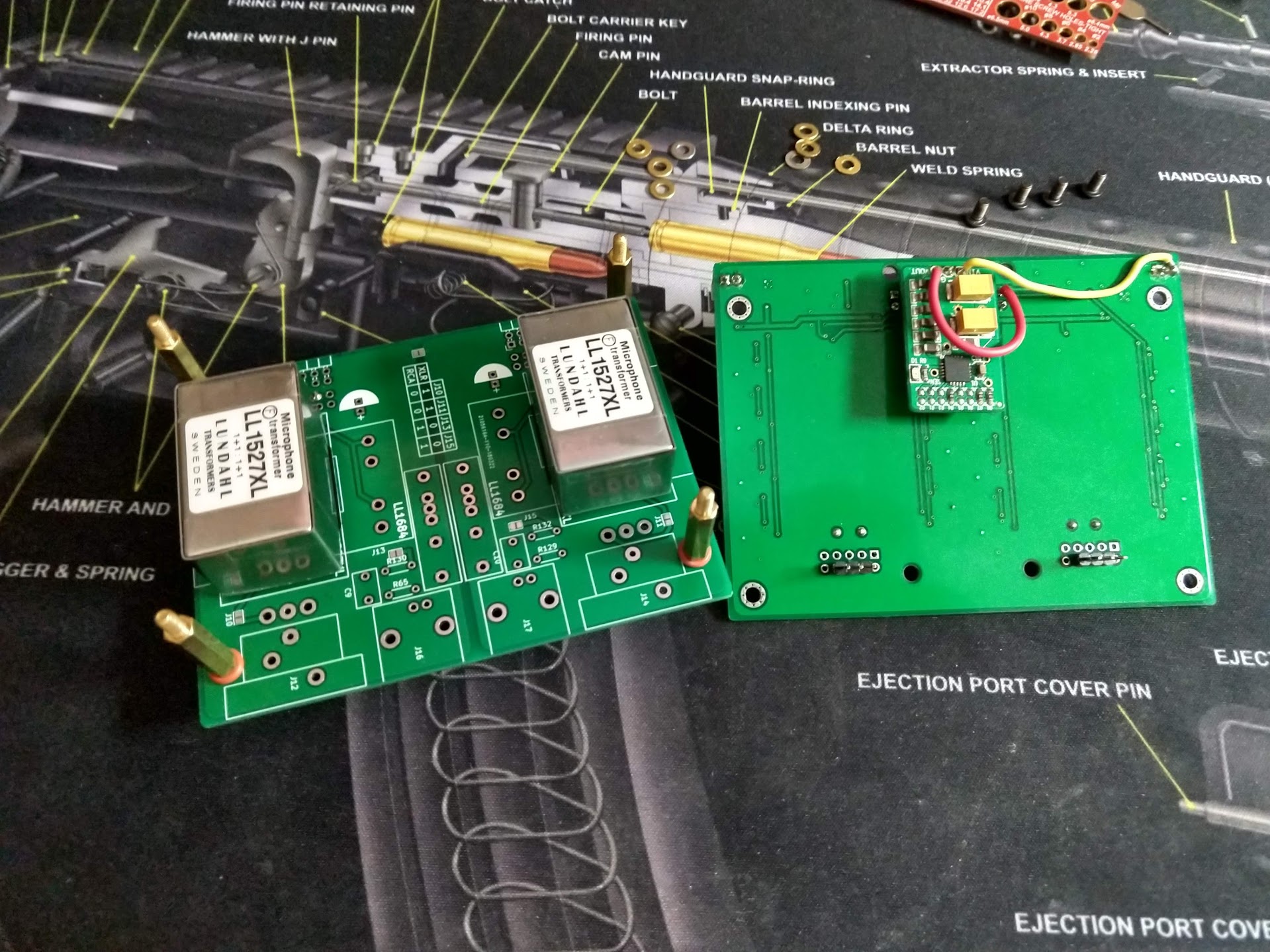

Got mine "running" at least according to the scope.
Some modifications here:
5v to 3.3v regulator on the DSC2 board.
Mount the 3pin headers so I can stack the board and detach DAC board and output board.
Using Cronus to reclock inputs from Amanero. They are connected via u.fl cables through a header I made.
Mute pin is taken directly from Amanero but isolated by a TLP222A.
DSDON is not connected.
To-do:
Manage heat from Reflector-D. the 1.5Ohm resistor is getting to hot to run long.
Finish output board.

How are you going to cope with the cooling? Big radiator?To-do:
I've tried active cooling with one 12cm Noctua fan and got stable 38 - 40 C (3 Reflector D, 2Ohm, 2Ohm, 1Ohm). But there were small chasis vibrations that I did not like.
There are two Reflector-Ds in the picture. One is supplying cronus with 1.5Ohm resistor. Another is supplying both channel of DSC with 1Ohm.How are you going to cope with the cooling? Big radiator?
Right now I'm measuring 1.9v across the 1.5Ohm resistor. That's about 2.5W I need to get rid of. Not a big deal, I can connect it to the base plate like what I did for the 1Ohm one.
For the 1Ohm one, transistors are getting too hot too. So they are mounted on the base plate. For the 1.5Ohm one it's not that bad. They will stay with on board heatsink.
u.fl adapters...
Hi, are your u.fl adapters for Cronus, etc, available from Oshpark? I would be interested.
I'd say it's more for DSC.Hi, are your u.fl adapters for Cronus, etc, available from Oshpark? I would be interested.
It exposes D1,D2 and CLK. Use TLP222A to isolate DSD_ON and MUTE.
I did some tweaks after the first version. I will publish and share the new one later on here and via oshpark.
Yes,
Understood, and thanks!
