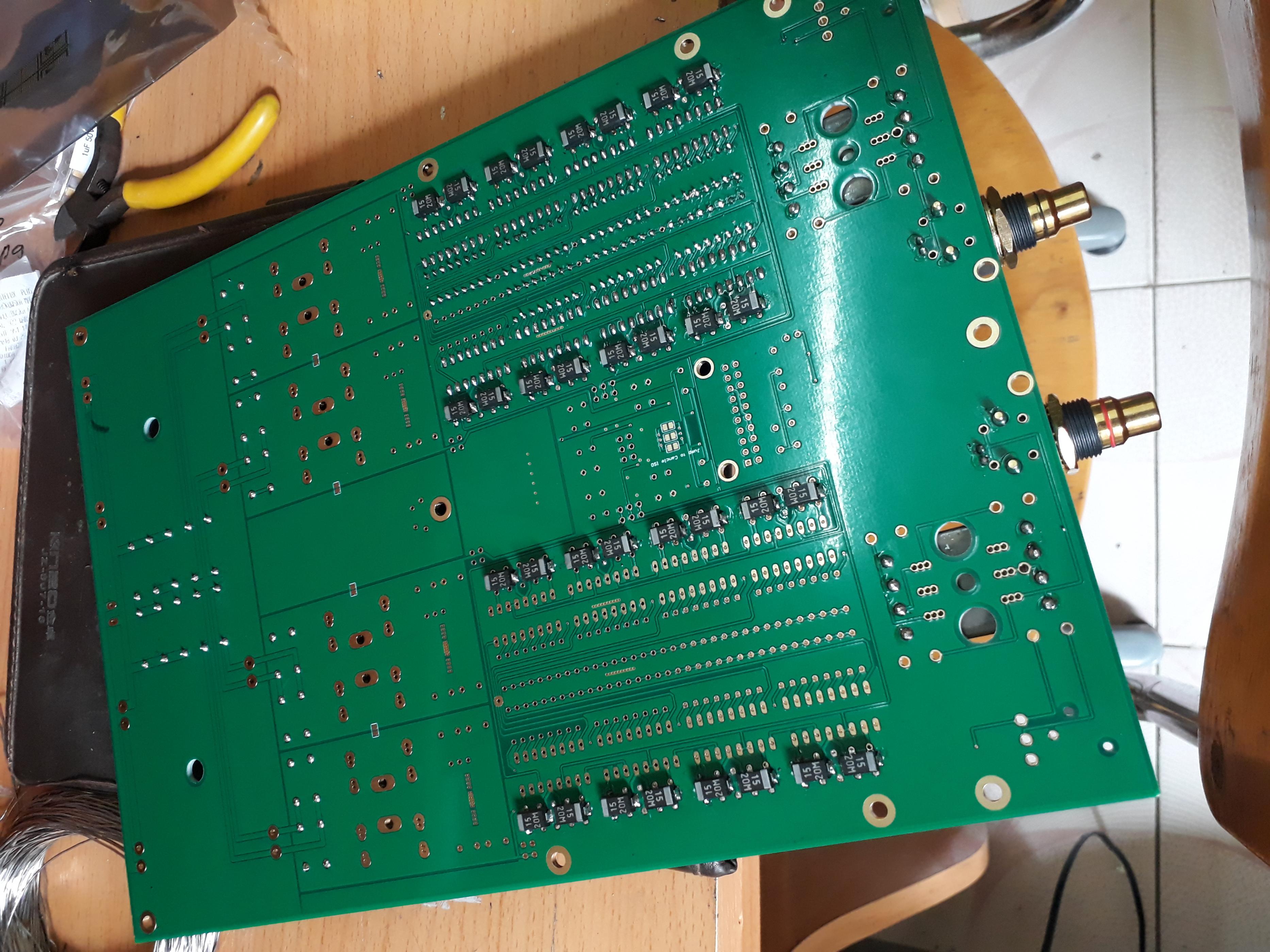

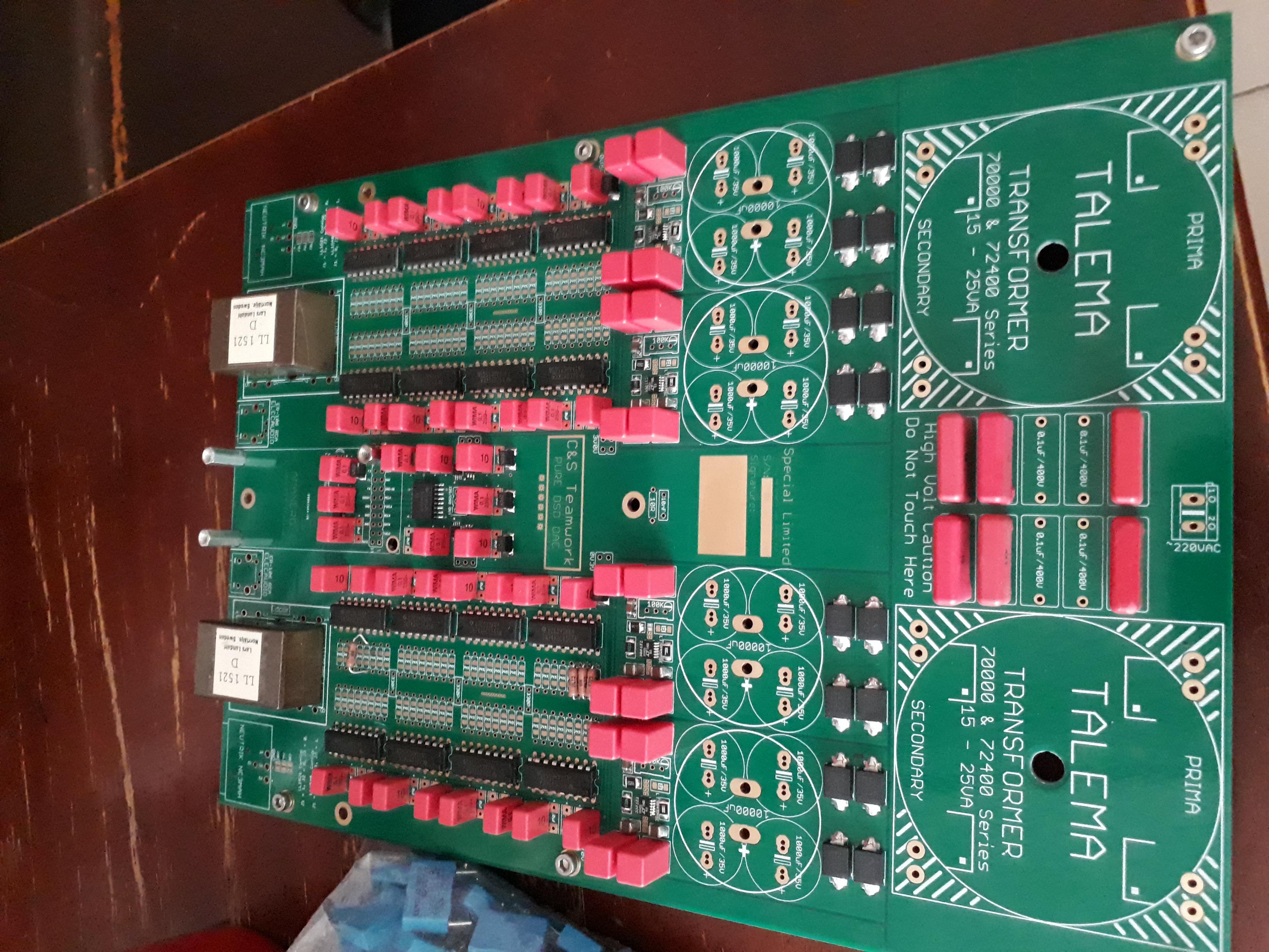

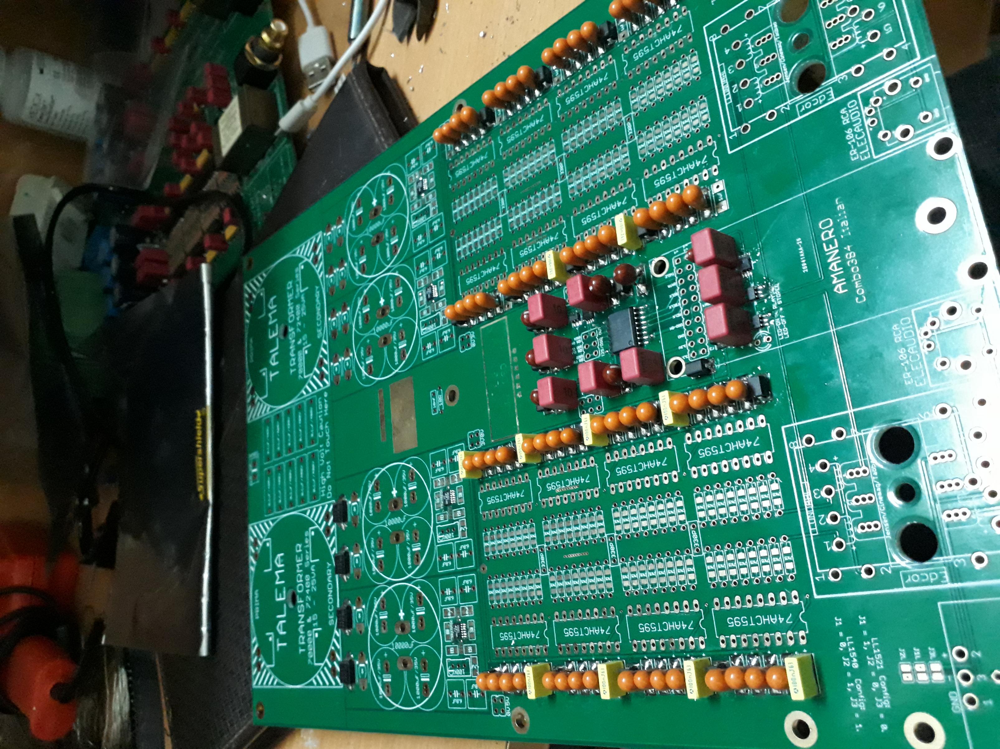

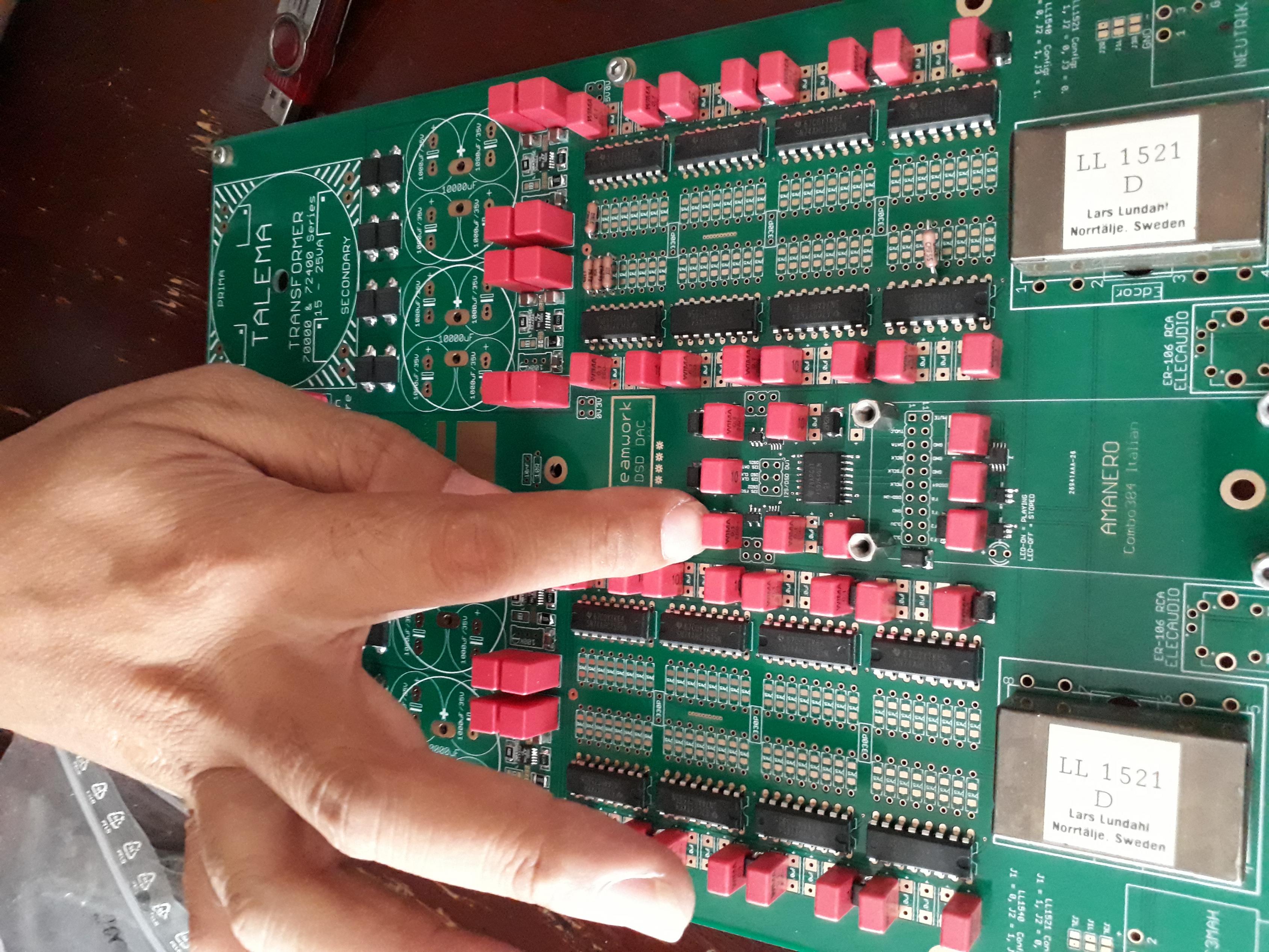

Thank for Jussi Laako and PPY so much.
I have finished building this project based on V2.62 - No hum, no pop, no buzz, no gas, no noisy...anywhere.
It sounds amazing to the surprise by space, sound depth, sound fast and very analog... I never heard before, it's hard to describe.
