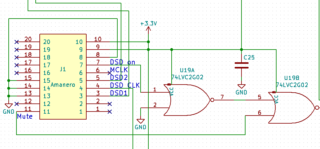

No, this one here near the intput.
hi 2wice,
I am making a question too....😀 (not answering)
btw about C25 cap, I believe value will be around 0.1-0.22uf
For DSC 2.5.2, do I still have on board 3.3v if I use external 5V psu?
Yes, you need +5V (Left and Right channel, internal or external) and 3.3V (external) to power triggers.
A little information update about DSC 2.5.2/2.6.2 voltage power supply.
DSC 2.5.2 needs 2 supply voltages: 5V and 3.3V
5V are required for powering 74AHCT595 and are connected via external power connectors/internal LDO (Read user guide).
3.3V are used to power the service logic and are come in through the pins of the Amanero connector (i.e., powered by Amanero LDO).
