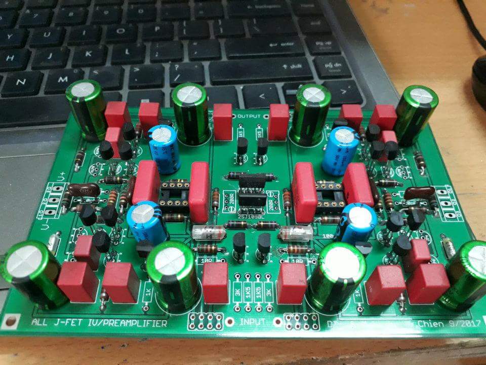

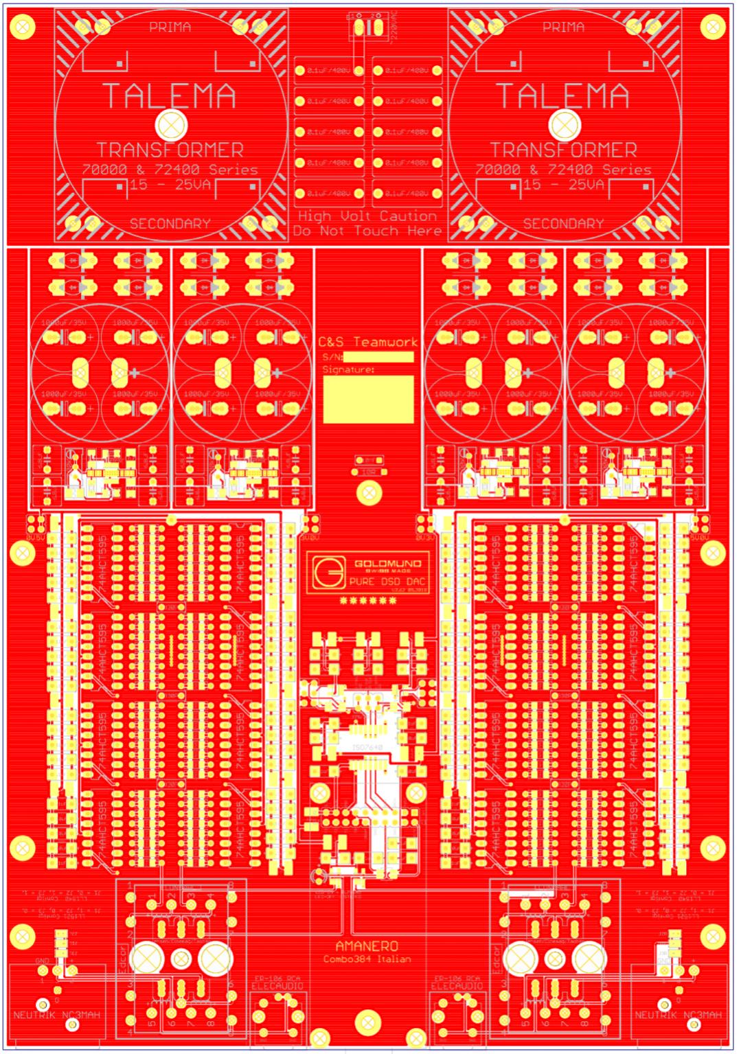

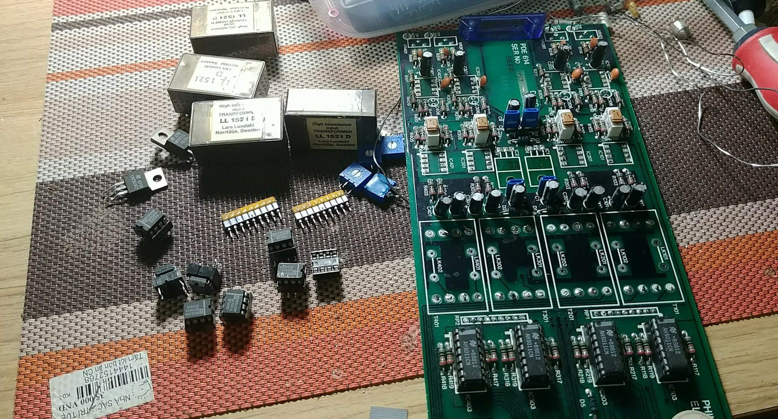

I'm building this project with all in one.
PSU using the Talema with LT3045 LDO for 4 PS Different.
Amanero isolated by ISO7640.
R FIR can use the Dip or Melf MMA0204.
OPT can use Lundahl, Edcor, Permalloy taobao or Jensen and Cinemag.
Layout match for double two floor to trie by dual jump 2.54mm.
I hope I will received received good result.
Top Viewer:
1. TOP (Gerber View).pdf - Google Drive
Bottom View:
2. BOT (Gerber View).pdf - Google Drive

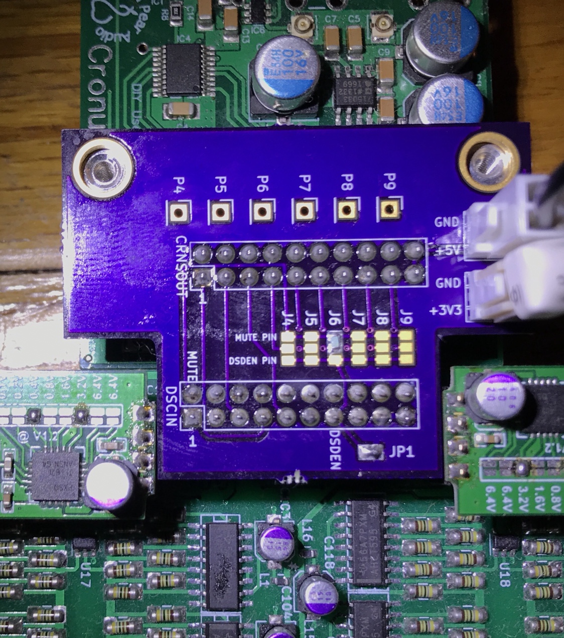

It actually doesn’t matter which of the R1-7 are soldered: you can use the jumpers on the PCB to route the mute signal to pin 11 (J4-9).
I also accounted routing the DSDEN (pin 7), but I think it’s obsolete - I simply wound up using the JP1 to +3V3.
I was think something like this sits on DSC2:
u.fl for dsd1 dsd2 dsd_clk
a relay for the dsd_on

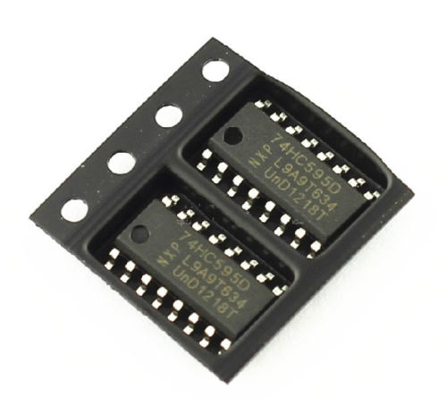

[QUOTE = wengtech; 5453011] hello,
anyone tried with NXP 74HC595D ??
what is the different with 74AHCT595D? : confused:
thanks. [/ QUOTE]
For NXP ICs 74AHCT595D [/ B] vs 74HC595D the main differences are:
1. Maximum frequency SHCP / STCP: 170MHz [/ B] vs 50MHz
2. HIGH-level input voltage: 2V [/ B] vs ~3V (74HC595D is less stable with a 3.3V Input logic level signal)
3. Different power consumption
Sincerely, Alexey Galkin.
