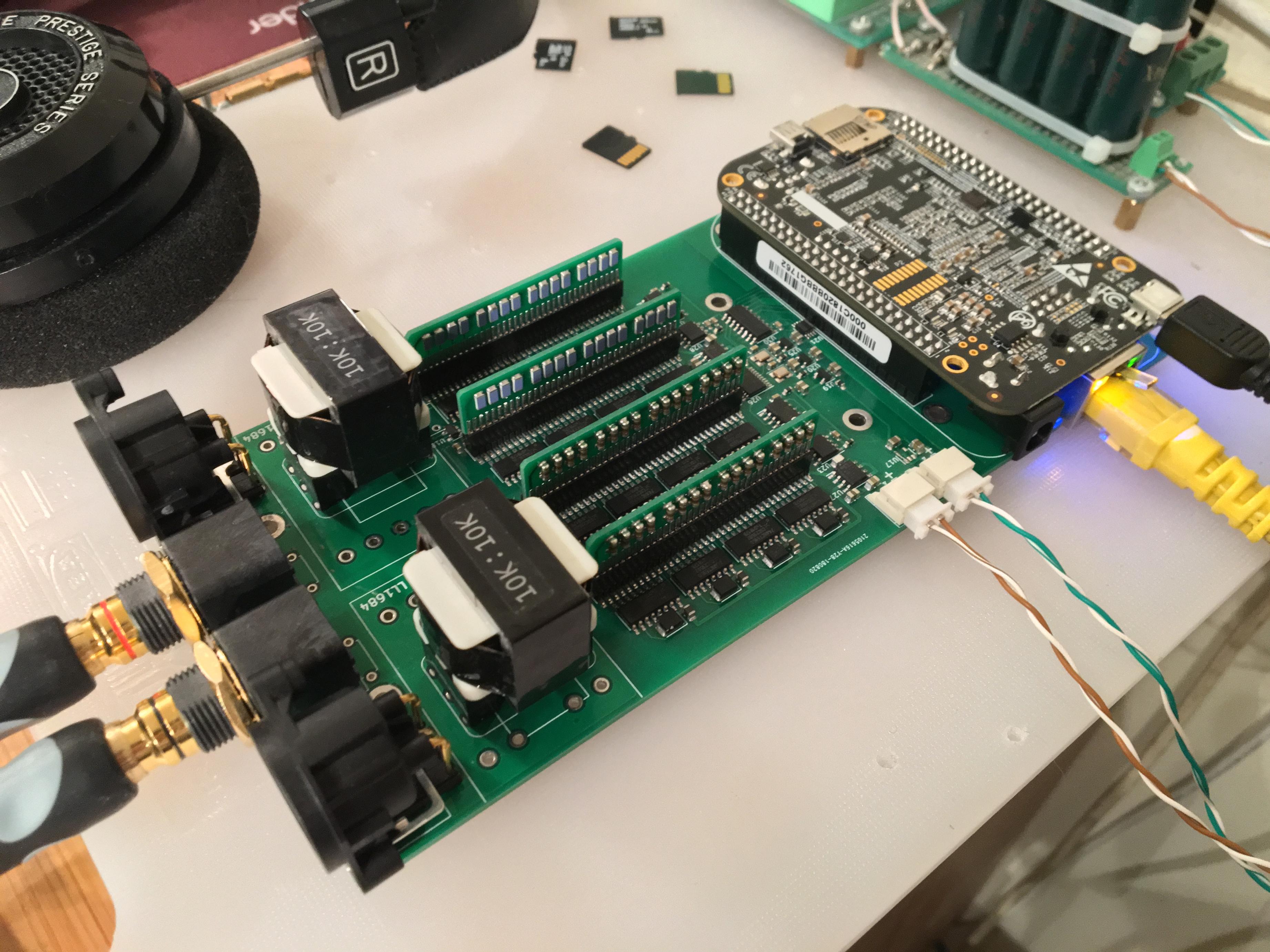

Made the first test copy BBB&Amanero+isolator+reclocker+DSC2.
Now I choose resistors and optimize the firmware for the BBB.
I do not have DSC2 v2.5.2 or v2.6.2. 🙂
I can only rely on my memory. It sounds better.
With the BBB there are absolutely no problems with DSD512. The stability of Amanero on DSD512 is low.
The sound is highly dependent on the BBB firmware. So now I’m spending most of my time on optimizing Linux for BBB.
The firmware will work with RoonBrige and NAA HQPlayer.

The maximum sound quality of this DAC is revealed when using the Signalyst HQPlayer.
v2.5.2 it is possible to install three types of transformers:
  1. Chinese R3 10k:10k
  2. Lundahl LL1684
  3. Lundahl LL1527XL
v2.6.2 it is possible to install only two types of transformers:
  2. Lundahl LL1527XL

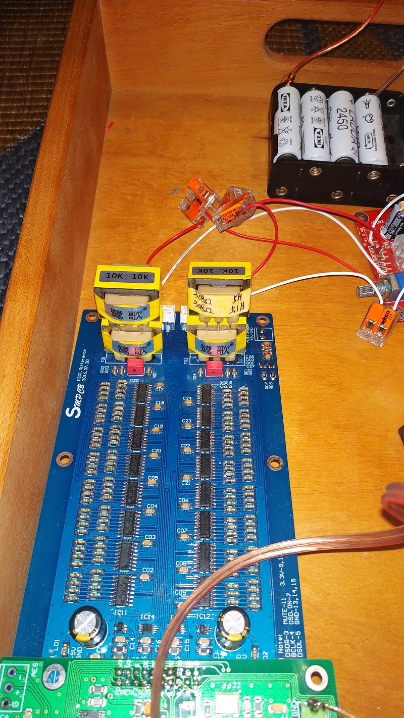

Hi Pavel,
May I ask you a favor.
I bought a set of transformers of the kind you suggested and was listed on Andrea's site.
The problem that I have is that I bought a second cheap pair from the same vendor and all came in the same box. I have no idea which ones are the more expensive Permalloy ones.
Could you point out on my attached picture if the ones
with the silver laminate core or the darker ones is the
right pair.
This would really help me.
Thank you in advance,
Klaus
Thanks Pavel
I want to encourage all those who have the differential version of this dac to
try the cheap TPA3116 boards from China as those chips have differential inputs.
Most vendors only use them single ended but my board from Yuanjing
has the second input from the differential pair tied to ground via a ceramic cap.
As you can see on my previous picture I simply removed the ceramic caps and attached wires to the vacant pads.
This combination just makes the most analog sound I have heard from digital.
My previous combination of Xmos/AK 4490 is not even close.
The details, spacial presentation, and the organic sound is fantastic.
Klaus
