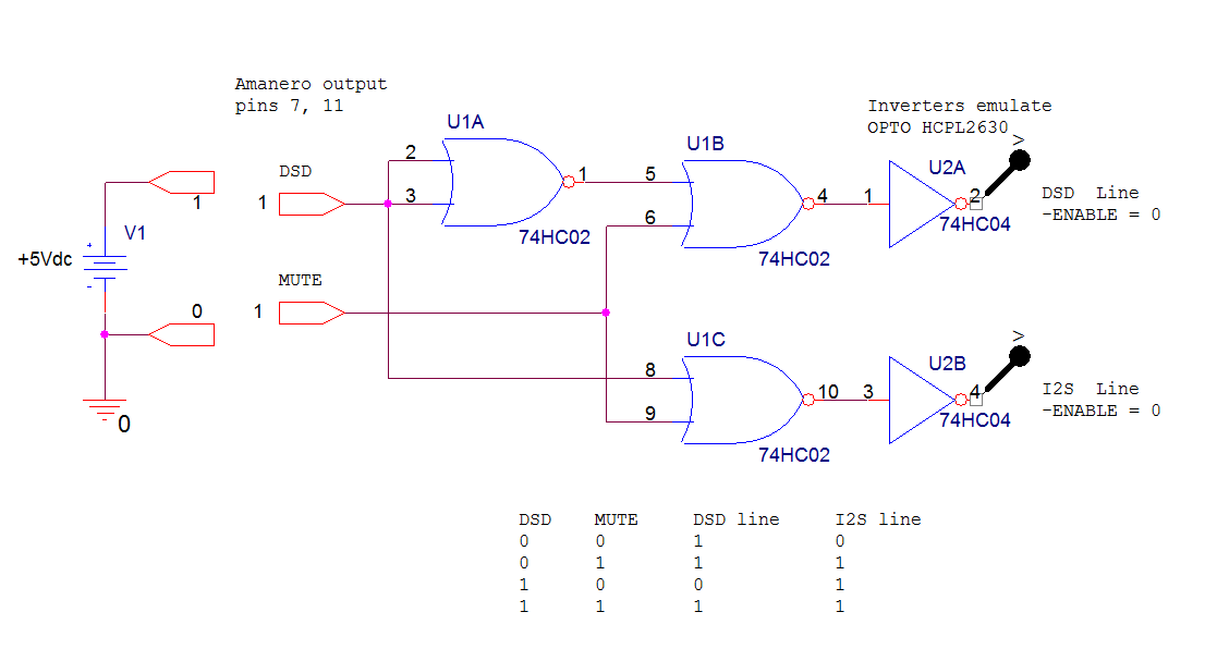

Hi
I have discrete I2S and DSD dac. Interface is Amanero. I had some issues with Mute control. I tried different circuits but the "clicks" when changing states somehow was present...
I made this mute circuit to control I2S and DSD brenches by disable chips. Enable is negative low 0, disable is hi 1. Since digital interface is isolated from the diskrete circuits, this mute circuit use optoisolator which inverts the input state. This signals can additionally tie together + and - outputs...
Next I have to add mute signal to manage relay switch to analog end - to connecting and disconnecting DSD or I2S from interstage transformer and buffer stage, because they are common for booth dacs.
Do you re-clock after the opt isolators? They introduce substantial jitter and the signal should be re-clocked after them.
This time I not recklocked after ISO. Because the master clocks are 22.xxx and 24.xxx MHz. And they are not high enough to recklock below 192KHz of Sampling rate. BCK (and DATA) becomes high as MCK and I think clocking could not be done. MCK should be at least 2x higher than BCK (and DATA) at given SR to be reclocked.
Other issue is that if You want true ISO and RECKLOCK after isolation barrier, You have to isolate MCK signal as well... To be clock in Flip-Flop cascade...
I just want in this experiment to try to use differential transmitter and diff. receiver after ISO. And acheive inverted -DATA for ballanced DAC operation. Simply by inverting + and - diff transmition line...
And its working very good up to max SRs 35x and 38x KHz booth I2S and DSD 🙂

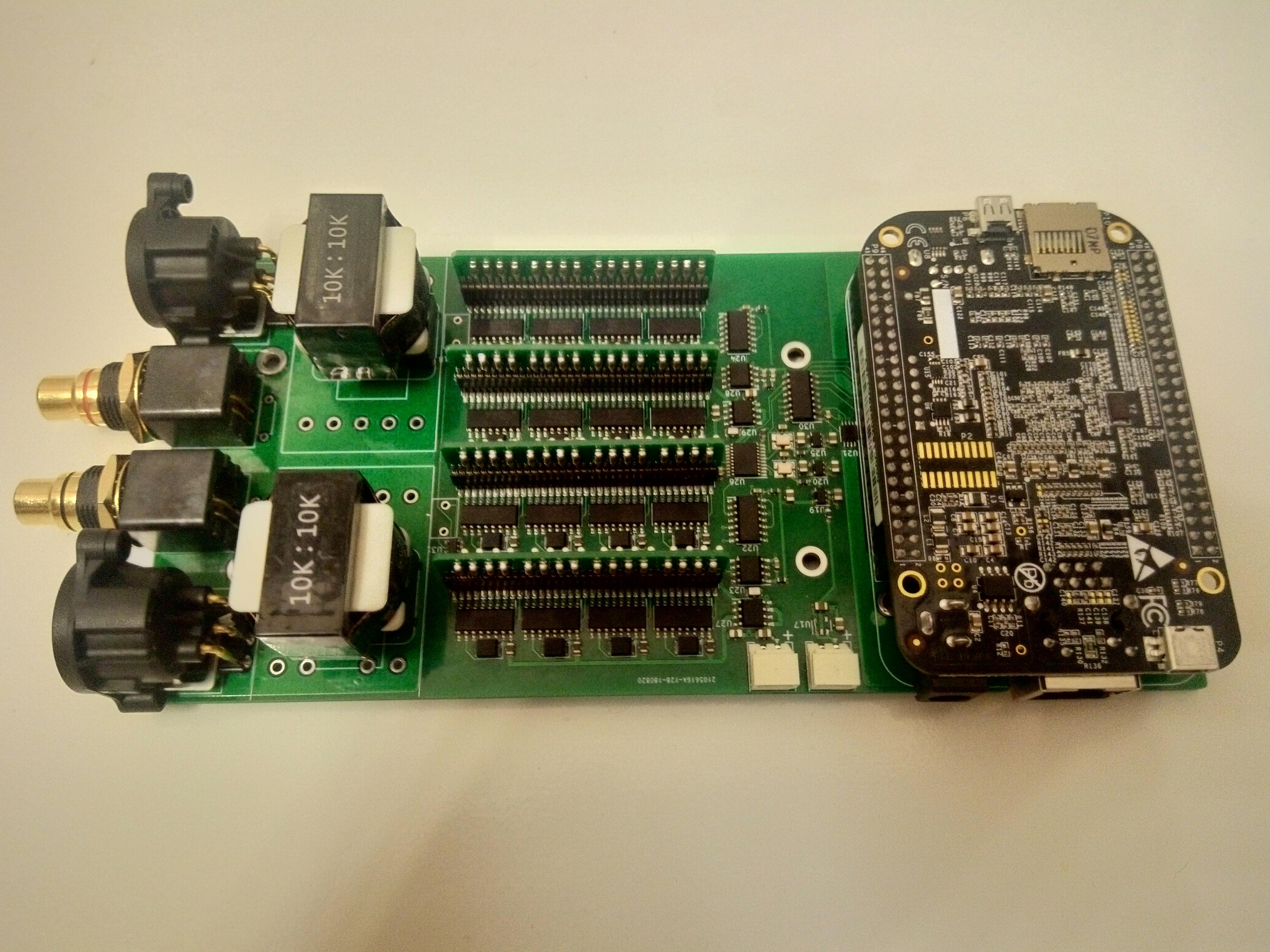

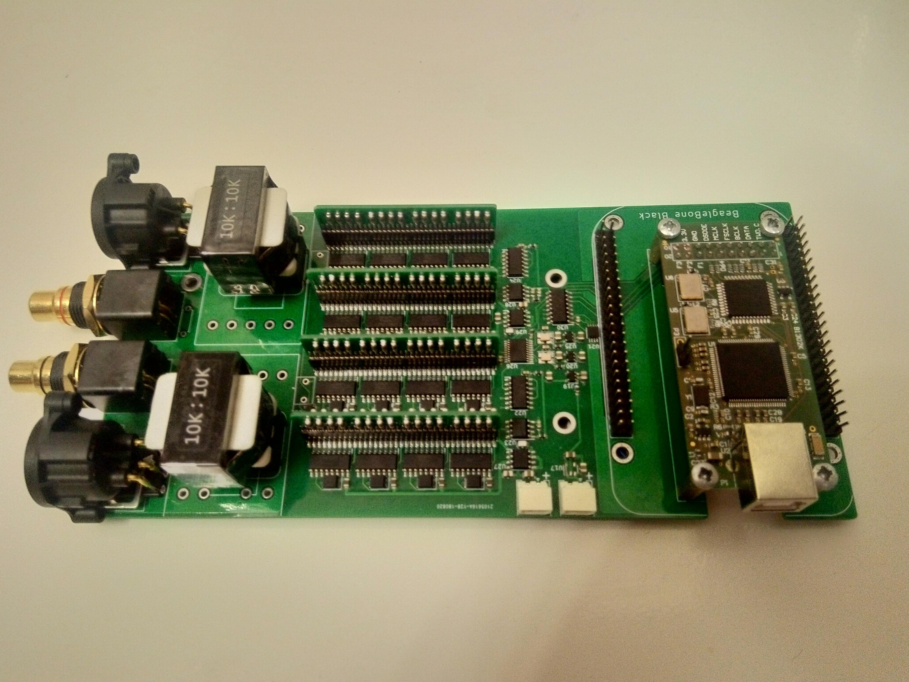

I am sure that when using an isolator, a recloker is required. Here is my diagram of the latter version. Gerbers need to fix minor bugs. Therefore, I will post them in a few days.
BBB or Amanero work in slave mode and get MCLK from high-quality NDK 45/49Mhz generators.

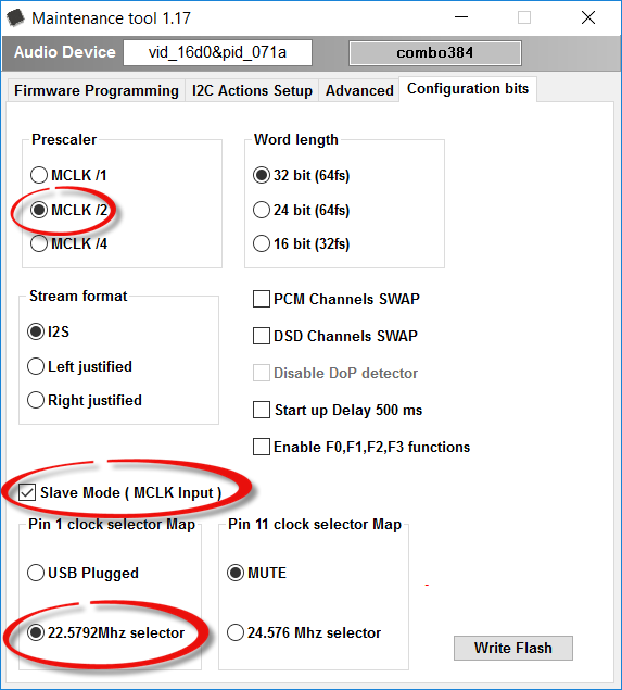

I think that in amaneros slave mode some pins are loosing functions when becomes inputs for the exernal MCKs? And as I am remember one is Mute?
Pin 6 in Amanero schematic are MCLK output. But in Your schematic, this is MCLK input from NDK Reclocked.
Any error at here or no? sorry for my ignorance.
