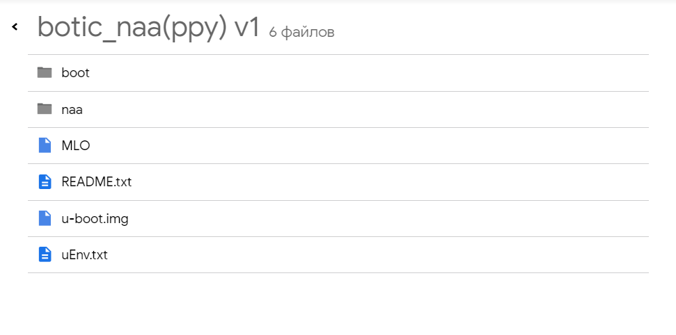

If you mean botic_naa(ppy) v1.zip , it seems you had unziped archive on not empty uSD. After unzip you should have the same files and directory structure as inside botic_naa(ppy) v1.zip (see picture below). Just delete all and unzip again to root of uSD.
Pls add "snd_soc_davinci_mcasp.mute_pins=4" in uEnv.txt (if not added). MUTE pin should be the same as is "snd_soc_davinci_mcasp.amanero_mute_pins=4" (4 - my settings). So you will have 2 *mute_pins options.

Two errors:
1. Files from the archive are written to an empty SD FAT format.
2. The partition on the SD disk must be active. This is the easiest way to make a free utility MiniTool Partition Wisard or the diskpart command How to Set Active Partition on Windows - Info | Remo Software

I should have said that the directory listng I included was the last of several attempts; exploring 7Zip options resulted in the extra files appearing in the extract? I always unxipped to an empty, newly partitioned uSD card and tried booting several times from a card with a directory listing the same as the one Vit included?
I have been setting the partition as active using the Windows Admin toolset (I use Win10 Pro on my laptop)?
I will try again but use a different unzip tool.

I repeated what I did yesterday, except for using a different unzip tool, and it now seems to have booted from the uSD card - weird?
I say 'seems to' because although when I booted from the uSD card the LEDs started flashing I can't see the BBB in my routers DHCP table so I have to review the network settings I entered.
Rebooting from eMMC to the previous image everything looks as it was and I can connect remotely using putty.
Here's the network config that I have entered - anything obviously wrong?
