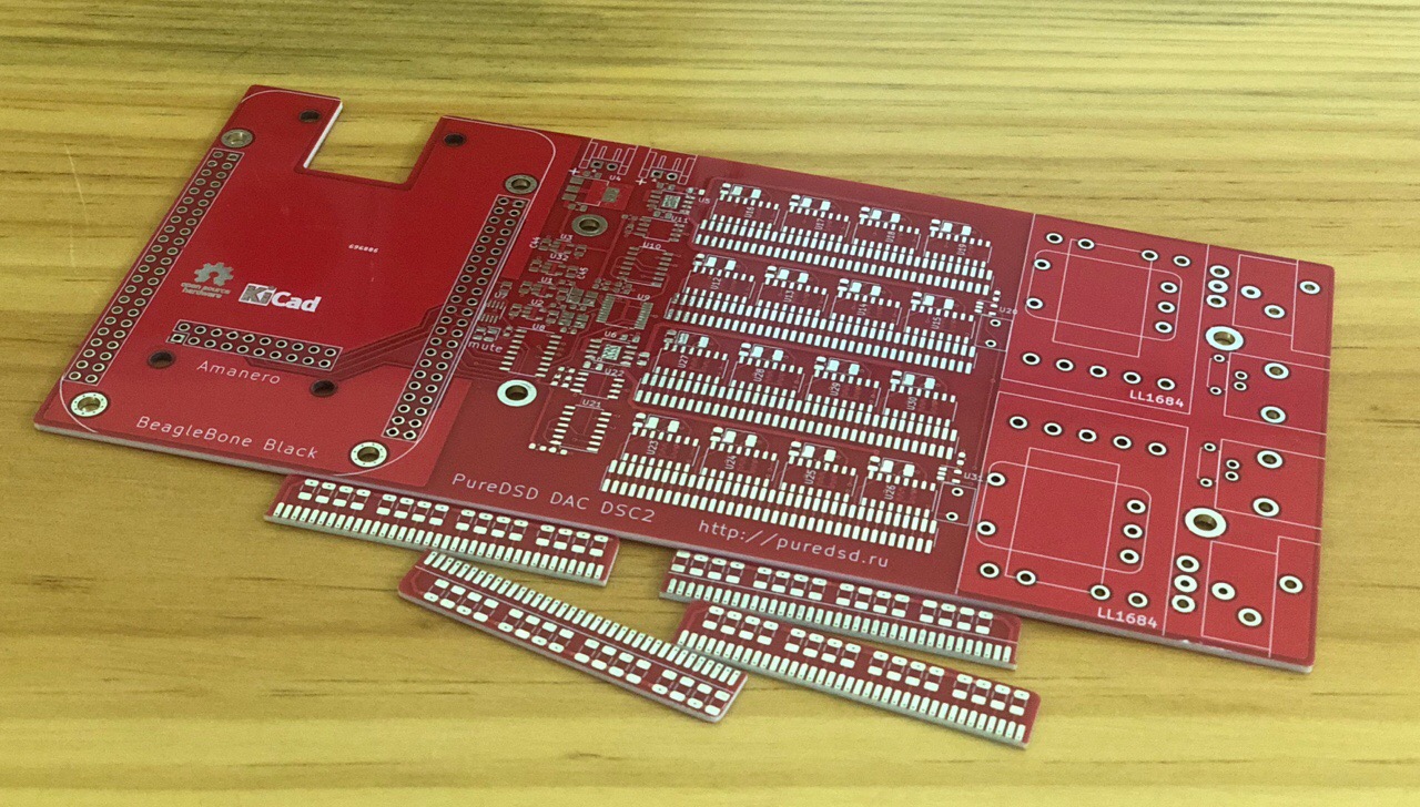

Thanks to Pavel’s gerber, I’ve got some blank boards made according to his suggestion. Some spare sets left, if anyone interested. 🙂 If there’s enough interest, I could provide the Philips AHCT595.

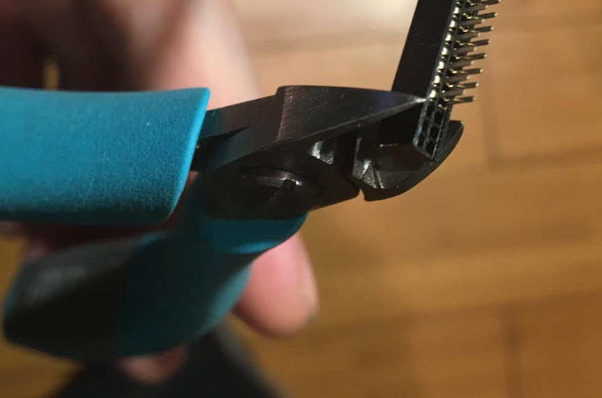

Where to get the 2x37 connector (1.27mm) 20021311-00074T1LF. Nobody seems to have this connector in stock. Any Ideas??
I used 2х40 20021311-00040T4LF Amphenol FCI | Connectors, Interconnects | DigiKey
And manually deleted 3 positions of contacts.
