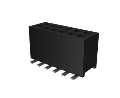

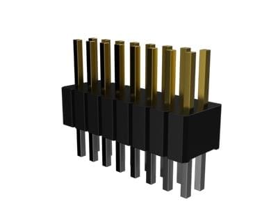

How about using female socket on board instead?
https://www.mouser.ca/ProductDetail/Amphenol-FCI/20021321-00040T4LF?qs=oJs1R%2bxK6kS0Kqp4eFHiPw==
https://www.mouser.ca/ProductDetail...EpiMZZMs%2bGHln7q6pmwodwKqstCem1cj%2bpZIHsHI=
0050375023 Molex, LLC | Connectors, Interconnects | DigiKey
and 08-70-1039 Molex, LLC | Connectors, Interconnects | DigiKey
I used 2х40 20021311-00040T4LF Amphenol FCI | Connectors, Interconnects | DigiKey
And manually deleted 3 positions of contacts.
Yes, you can and this option. But then you have to make PCB resistors 0.8mm thickness.How about using female socket on board instead?
These all appear to be 40 position, not 80 position (2x40). I had a hard time finding the right ones in stock at Mouser or Digikey, so I ended up ordering 2x50 connectors for my build from eBay. SMD male and T/H female: 1x40P/50P 2x40P/50P Male Female SMD Pin Header Connector 1.27mm Golden Breakable | eBay.
