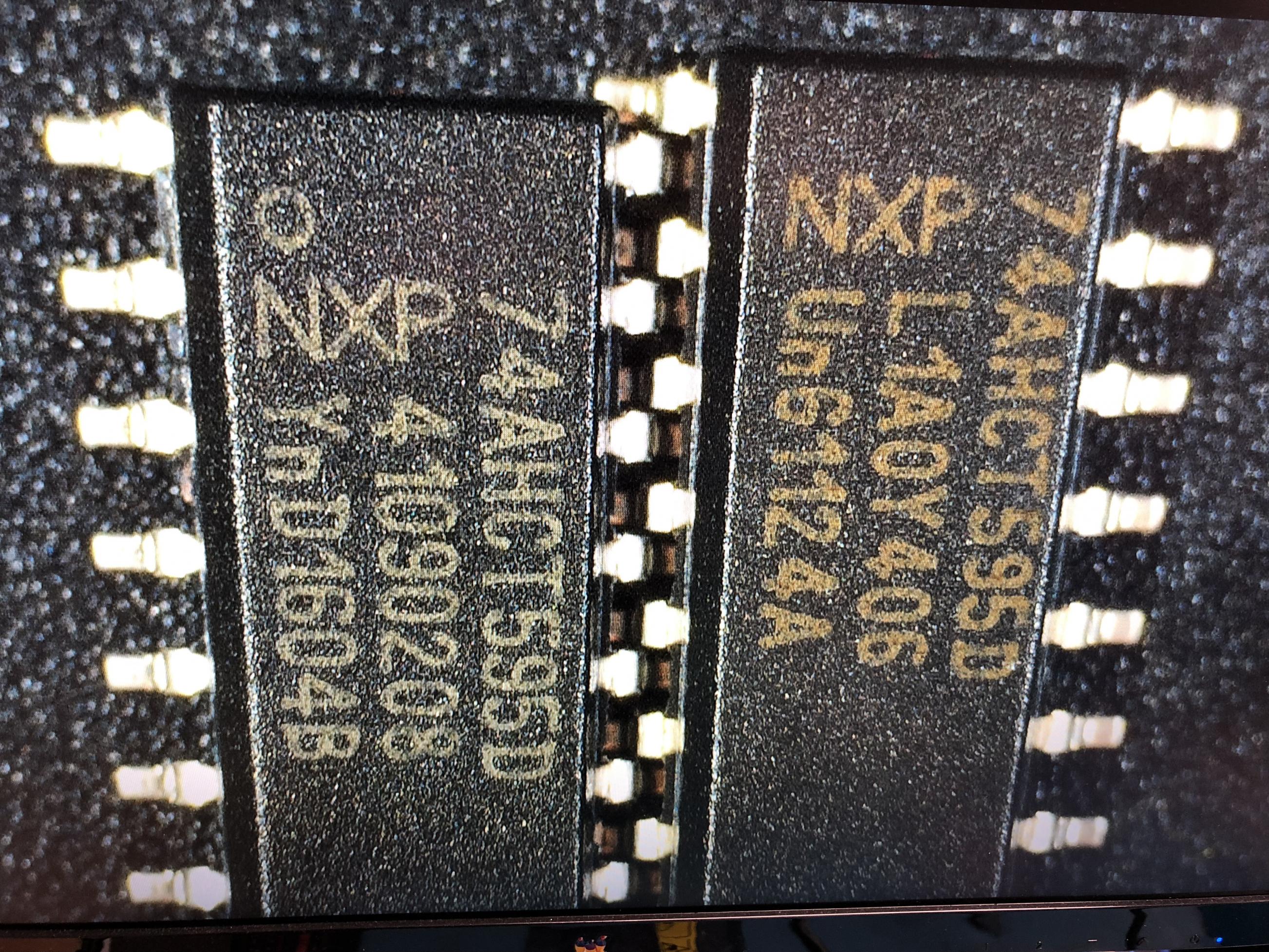

NXP vs Nexperia 74acht595d
In an effort to get pre-Nexperia 74acht595d, I ordered some from TaoBao with a listing picture showing Philips old stock. I also ordered new stock of Nexperia from DigiKey to compare. I received my order from China today, they are labeled with NXP, but I am unsure if they are pre-Nexperia or not. The markings are definitely different between the two.
I’ve attached a picture of them side-by-side. The Chinese one on the right, the new stock from DigiKey on the left. Does anyone know what the markings mean or know what the pre-Nexperia chips look like?
Regardless, I think this is the last bit of the BOM I need and am looking forward to starting construction!
