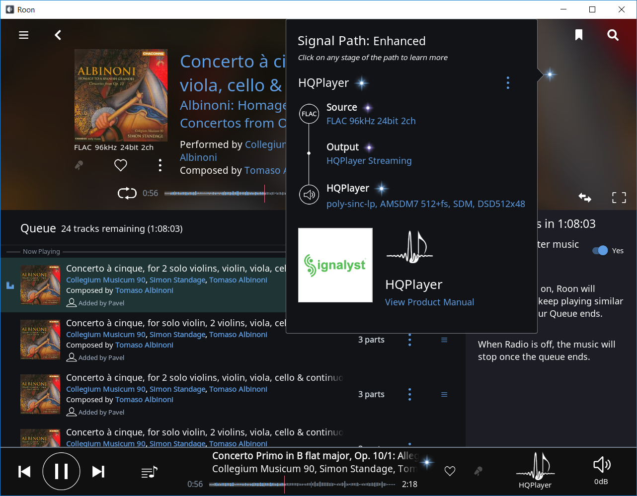

I think that the DSD512 will also surprise you. Here are my favorite HQPlayer settings: poly-sinc-lp, AMSDM7 512+fs, DSD512

I think that the DSD512 will also surprise you....

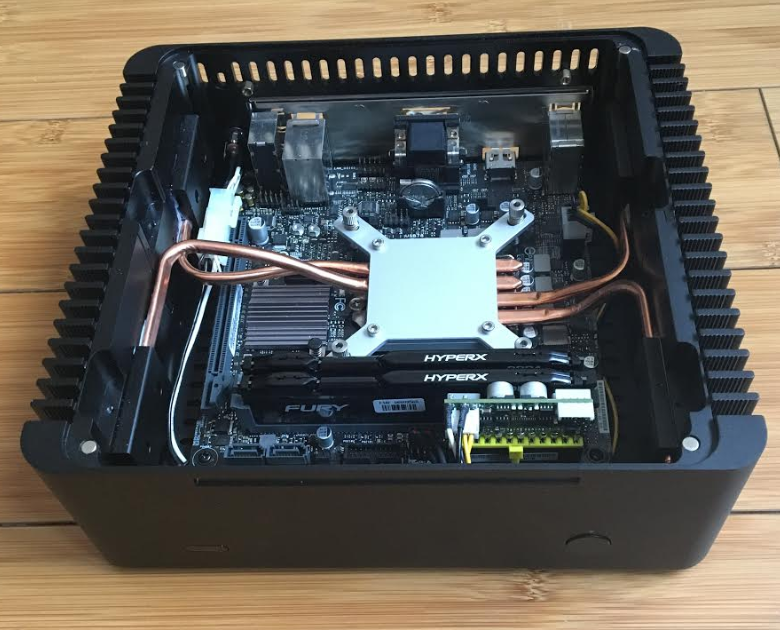

What your PC hardware: CPU, Ram....and OS?
This configuration works stably with all heavy HQP filters in the DSD256. DSD512 some heavy filters do not work.
Fanless case Ultra low profile silent HTPC chassis.
This case is hot enough but in the normal range. Total computer consumption when playing 56W.
CPU Intel I7-8700T (HT disable from BIOS)
MB Asus H310I-Plus. I do not recommend using modern chipsets. HQP performance is not improving, but consumption increases significantly. I was forced to abandon the top MB - Asus ROG STRIX Z370-I
OS Linux Debian Stretch on SSD M2
picoPSU-160-XT
Mean Well GST160A12-R7B

Forgive my ignorance and questions.
1. Your PC installed HQ-Player. It's using same as Master Music Player? How do this Master Player transfer/send the music data has read and decoded to the PC Slave (BBB Network Adapter/User Client) via LAN/Ethernet.
2. What the Software, Linux OS has your installed on BBB?
HQPlayer Embeded and RoonServer are installed on this PC.
The music library is located on a separate home NAS.
DSC2 new ver http://puredsd.ru simply connected via Ethernet.
