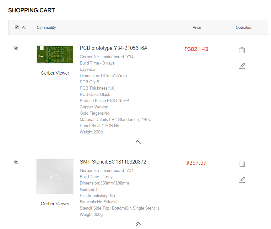

- are the Gerbers / layout finalized and ready for production or do you expect any changes or improvements?
Yes, published on https://puredsd.ru gerbers final. There are minor cosmetic differences from the real prototype: restored one forgotten line, added another LDO to increase temperature stability. Yesterday I ordered the production of PCBs (for personal use) of these gerbers.
gtose said:
- could you make the Gerber for the paste layer available for creating a stencil for SMT assembly?
For the production of stencil have all the necessary layers. Here is an example of my order:
