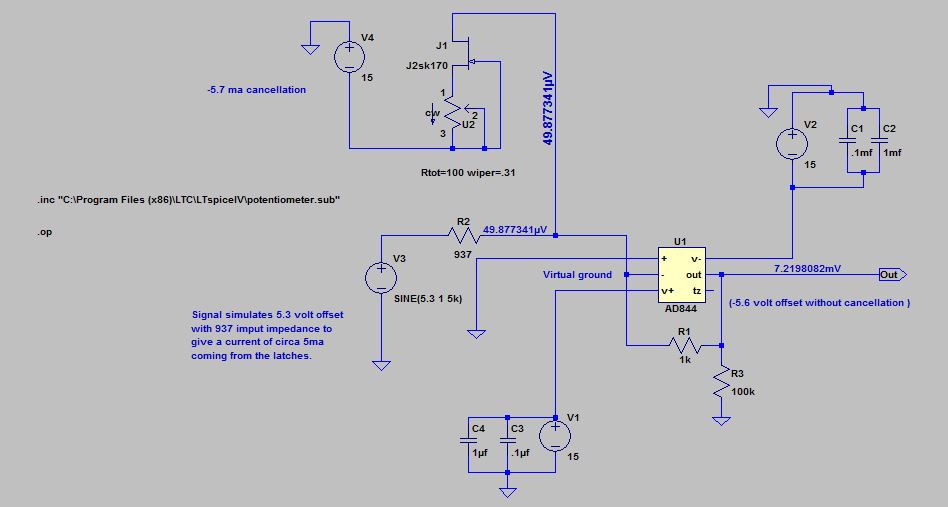

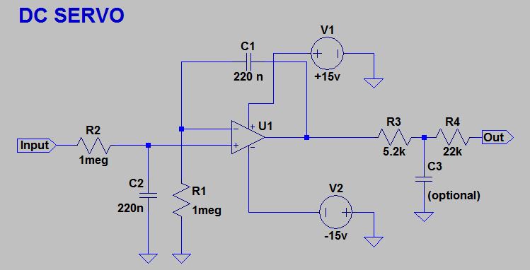

Hello all.
This is for those of you who are interested in removing the 2.2 Uf coupling cap between the AD844 and the following stages in the original DSC1 and killing the voltage offset.
1. I used a Jfet, trimmer pot and cap tied to the negative rail of the AD844 (I use +and- 15 Volt rails.) This method was suggested in the excellent EUVL thread below.
http://www.diyaudio.com/forums/digital-source/195483-zen-cen-sen-evolution-minimalistic-iv-converter.html
Look at page 17 Post 170 for an explanation.
This got rid of most of the offset but drifted from -150 mv or so to hover around +20 mv after about half an hour. I use the Lsk 170s because I had them. You could use the Lsk 147 or experiment with other low noise jets.
There was still too much offset, so I used DC servos between pin 2 of the LME49720s and the output end of R805/R815. See circuit below. The OP amps I used were Lf411 because I had quite a few of them and tested a few for lowest inherent offset. You could use other more modern OP Amps . See the servo link.
If you want to read all about DC servos, check this out.
http://www.diyaudio.com/forums/chip-amps/107246-dc-servo-question-5.html
The changes have worked out very well, with offset within 1 or 2 millivolts.

Just to cap off, I should say that I use Jung super regulators for all stages except the 3.3 volts that runs the output relays. USB is powered from another Jung 5volt regulator inside the chassis over a modified USB cable.The Amanero uses an isolator chip as suggested in their website.
I use a Mac Mini running Windows 7 with Bootcamp. The Mac Mini has an outboard linear supply. I use the Signalyst player for critical listening and JRiver for ease of use.
In other words, I am happy with the sound and grateful for Jussi's great DAC.
I hope this is useful to some of you.
