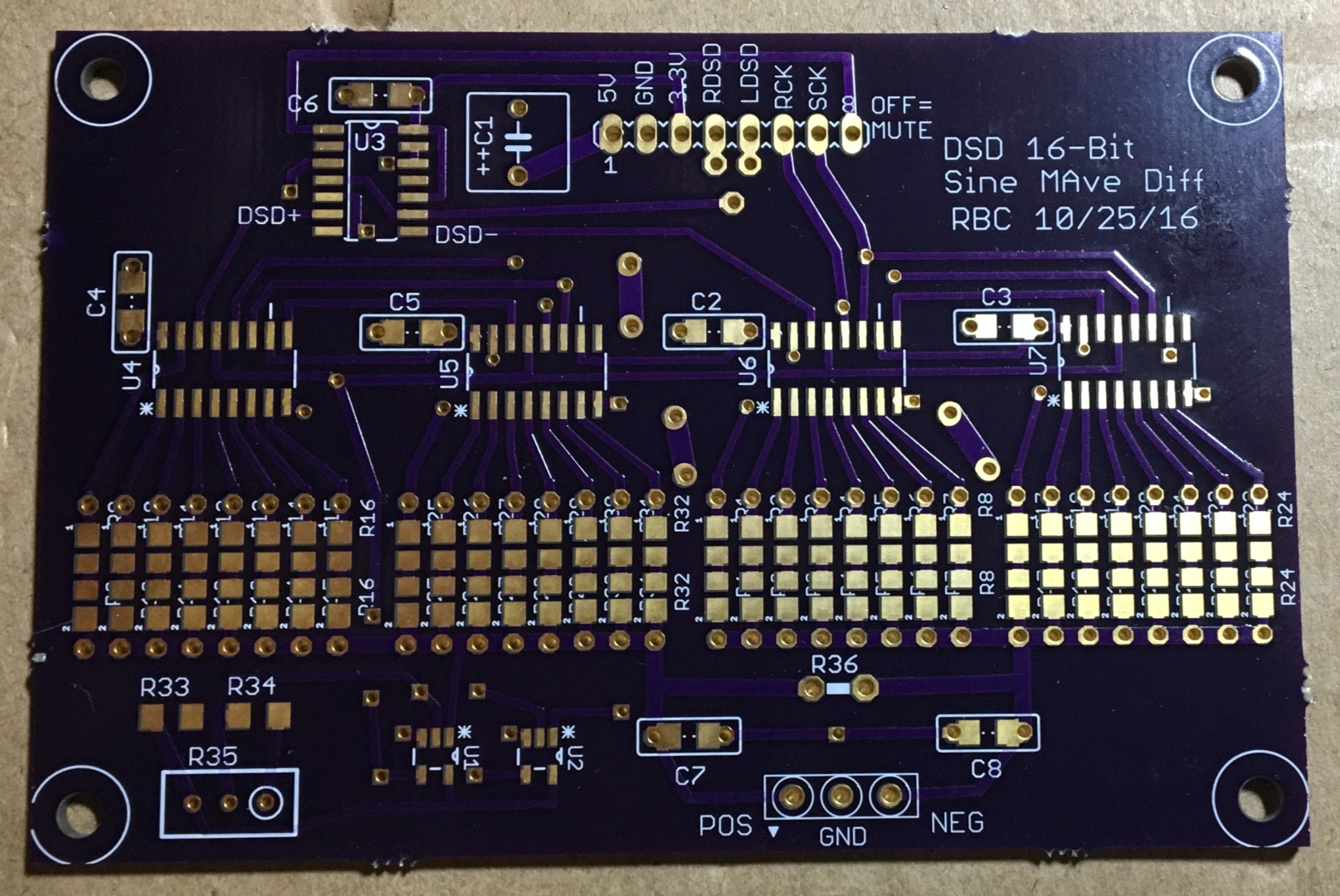

I have been quietly designing and making PCB's to try a 16-bit sine weighted average differential circuit with my Amanero. I should have all the parts by Monday and be able to get a first listen by the middle of next week. I also bought a solder paste stencil and reflow oven to make things easier. See attached pictures.
The largest changes from the Chinese DSC1 differential design are:
1. Muting is done with analog switches to a 2.5V reference. An NE555 circuit provides an adjustable time delay before re-enabling the outputs. Also, the 74AHCT595 bit shift IC's are put into High-Z mode during muting.
2. Two 2012 SMD resistors in series provide a 0.1% accurate sine weighted profile.
3. The bit shift and buffer output clock signals are delayed to make sure that they arrive at the bit shift IC's after the DSD data bits arrive.
4. I use one board for Amanero interface, muting, and clock delay and two stacked boards for the 16-Bit Sine weighting of differential signals to my Cinemag output transformers.
I continue to employ the brilliant idea of using an XOR chip to create the DSD+ and DSD- bit streams. I bought Potato Semi IC's for this. No tiny chips here.
The Japanese resistor profile appears to resemble a normal distribution curve or an exponential decay. If Sine wave weighting doesn't sound right I can always try a different profile.

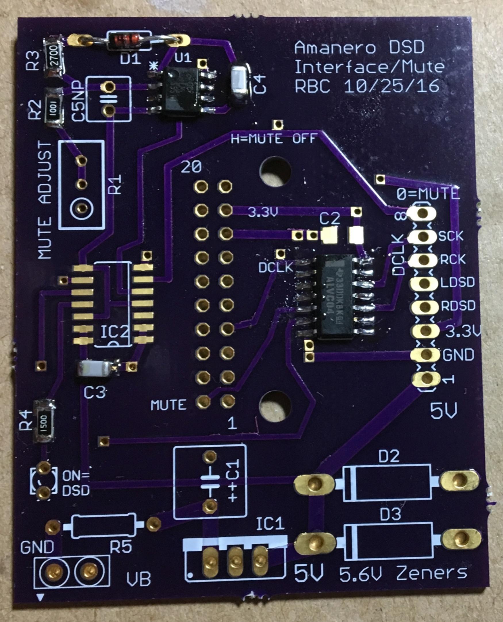

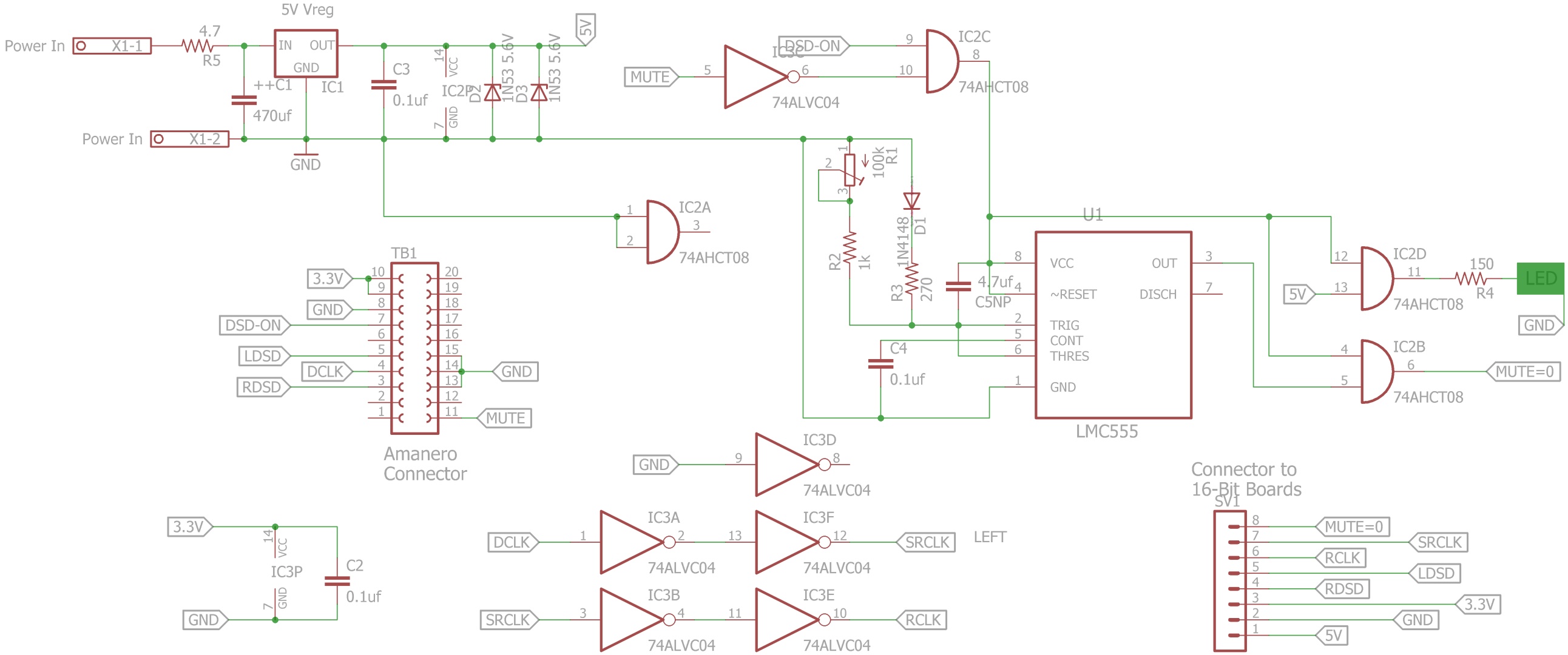

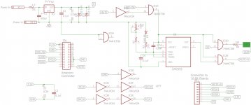

Amanero Interface/Mute circuit
Could you please post a schematic of the Interface/Mute circuit?
See schematic and PCB pictures below. This unit works, however a bad batch of 74ahct595 chips has kept me from having a completely functioning 16-bit DSD unit at this time.
The 5.6V Zeners are optional. They protect all 5V components from a catastrophic failure in my DIY 5V Vreg.

Carlsor
Thank you very much for the schematics of your project.
I have been trying to match it with the solder mask of the dac end from your post 391 above to see how the XOR chip from Potato Semi is hooked up. My aging eyes and brains are not up to the task!
So, could you please post the circuit diagram for the 16bit pcb ?

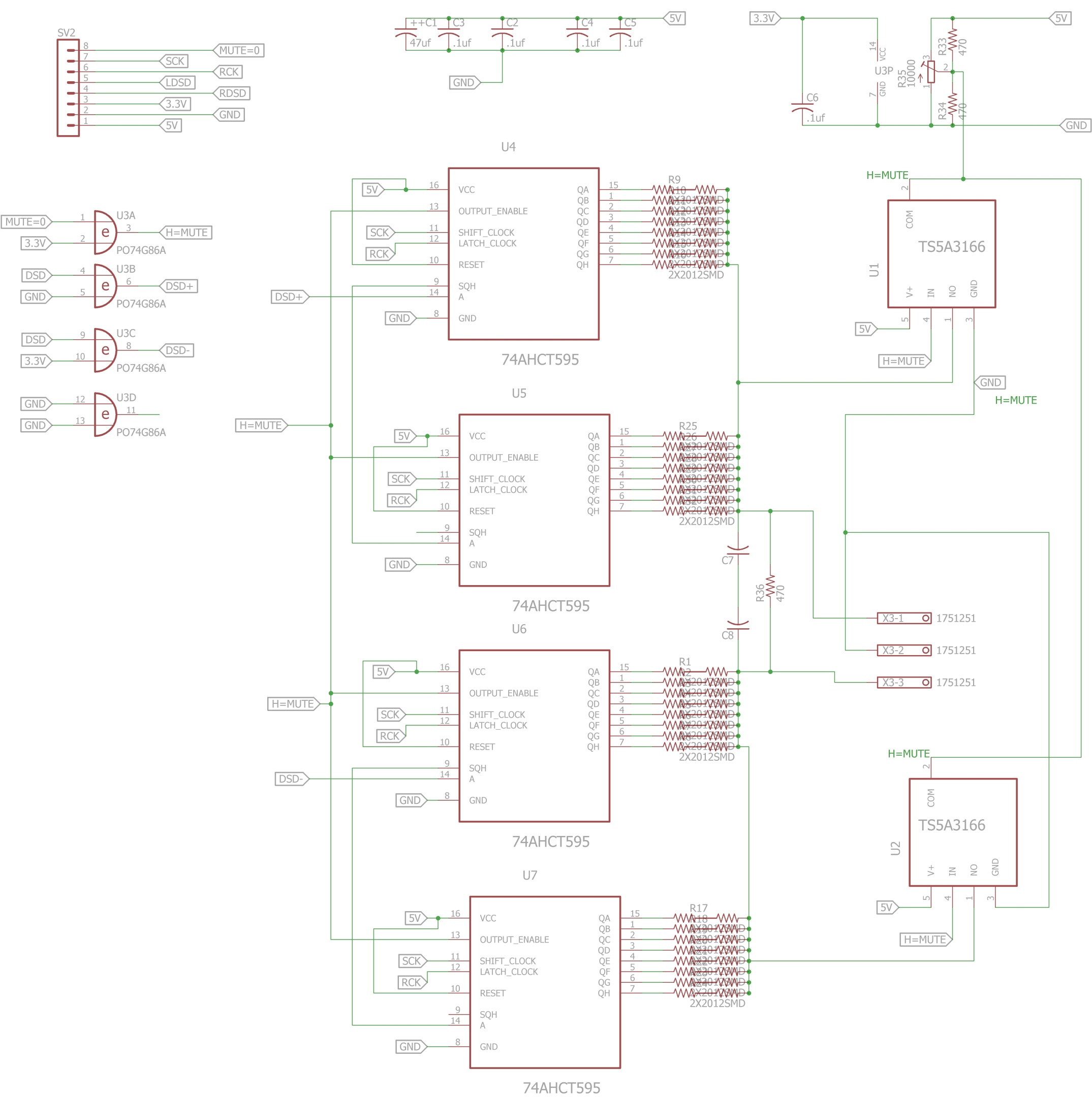

16bit pcb schematic
See attached Schematic for existing PCB. The next version will need a TS5A3167 NC analog switch to put the outputs to Mute when there is no 3.3V power coming from the Amanero. After testing there may be other changes.
Yes, V3 is a PO74G86A which is low noise and fast enough to get signals to the bit shift ICs ahead of the clock signals. It is the larger SOIC package which is easier to solder, but only comes with 4 XOR gates. I use the 3rd gate to invert the MUTE signal which closes the TS5A3166 NO analog switches to 2.5V reference and puts the 74AHCT595 chips in high-Z output mode.
I have 40 more 74AHCT595 chips arriving this Thursday from a different manufacturer. I keep destroying the ones from TI with heat. I had no problem hand soldering the 16 TI 74AHCT595 chips that came with the Chinese Diff DSC1 kit, but the bunch I got from Mouser seem much more heat sensitive.
I didn't want to spend too much time getting into the details of this circuit until I had a great sounding prototype.
