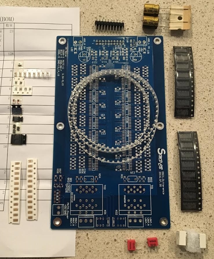

Diff DSC1 Kit
Attached is a picture of the Differential DSC1 kit parts. Seems to include everything except the output transformer and Amanero. Unbelievable for less than $50usd including shipping.
No semiconductors after the bit shift IC's - only film caps and resistors. Front end has logic chips and maybe some voltage changing IC's.
Only paper work is the BOM without IC function explanations. No Schematic.
PCB is tinned so maybe I only have to heat the IC pins on the pads without adding a glob of solder of my own. Some IC pins smaller than SOIC. Circuit trace not visible on bottom.
I still will buy 0.1% Susumu RG 3216 resistors for the shift registers, otherwise I will use provided parts.

Diff DSC1 Kit Started
I started soldering the parts on the DSC1 board today since I am retired. The kit is mostly SMD components. Two of the parts are tiny 8-pin IC chips which have much smaller pin spacing than the SOIC. Furthermore, these are called a "C86" which I could not find at Mouser or anywhere on the internet. Too bad such small obscure parts were used in this design. I could identify all the other parts which I could get from Mouser if I lost or damaged one.
I had to use solder for each SMD pad connection because the tinned PCB did not have enough solder on the pads. I also used flux on the pads to get better solder flow. Only persons with extensive SMD soldering experience should attempt to build this kit.
I initially only installed four 74AHCT595 bit shift chips with 2 output resistors on each making it a 2-bit differential DSD filter. I want to make sure a DSD signal makes it all the way through the DSC1 before I go to the trouble of installing all the provided parts or purchasing better resistors and caps. If the C86 chips don't work, then this project is kaput.
