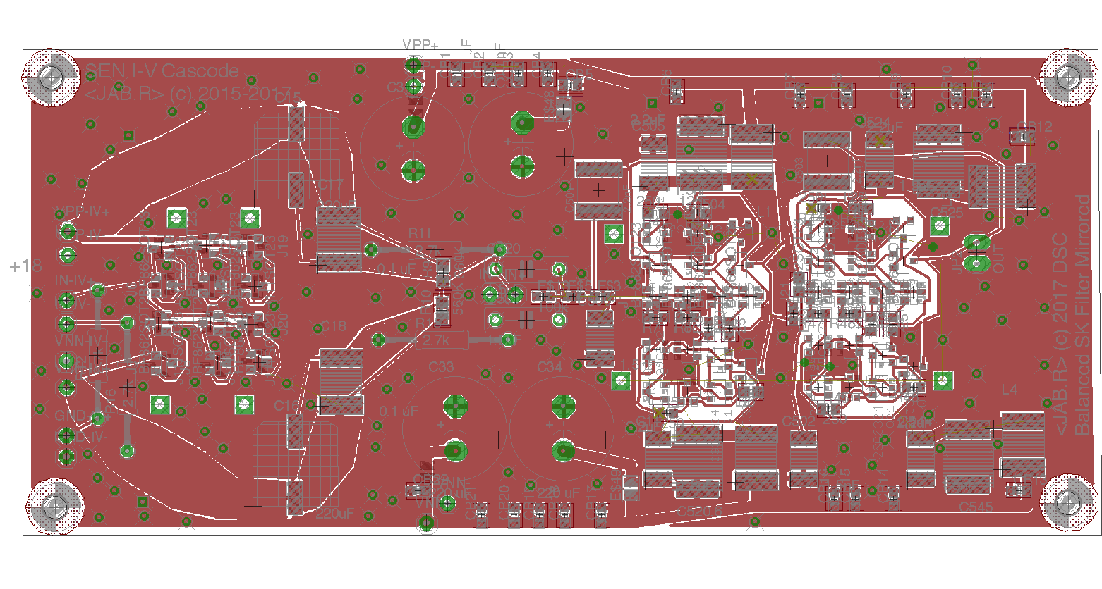

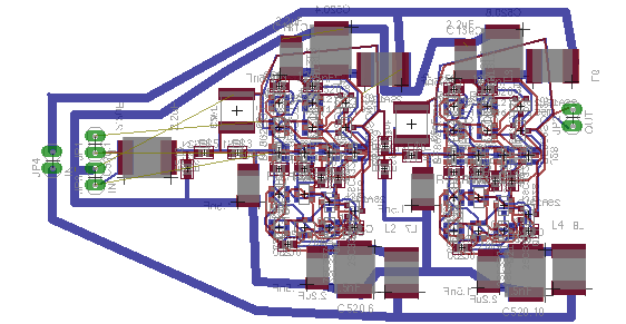

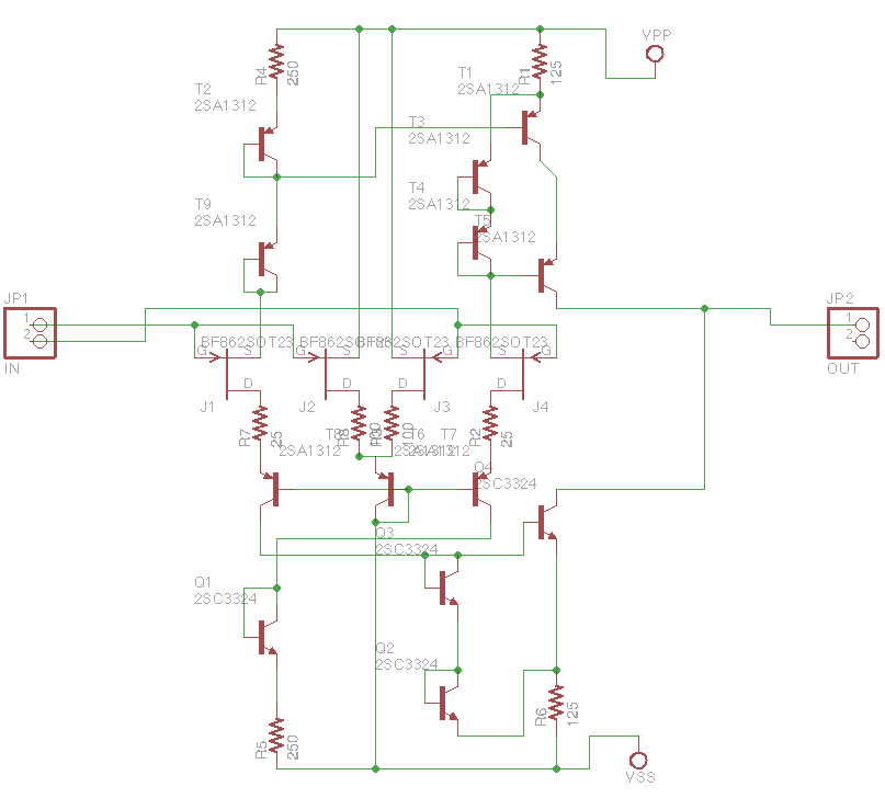

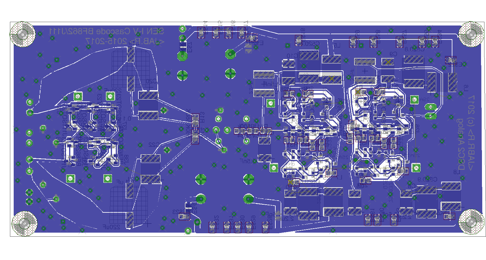

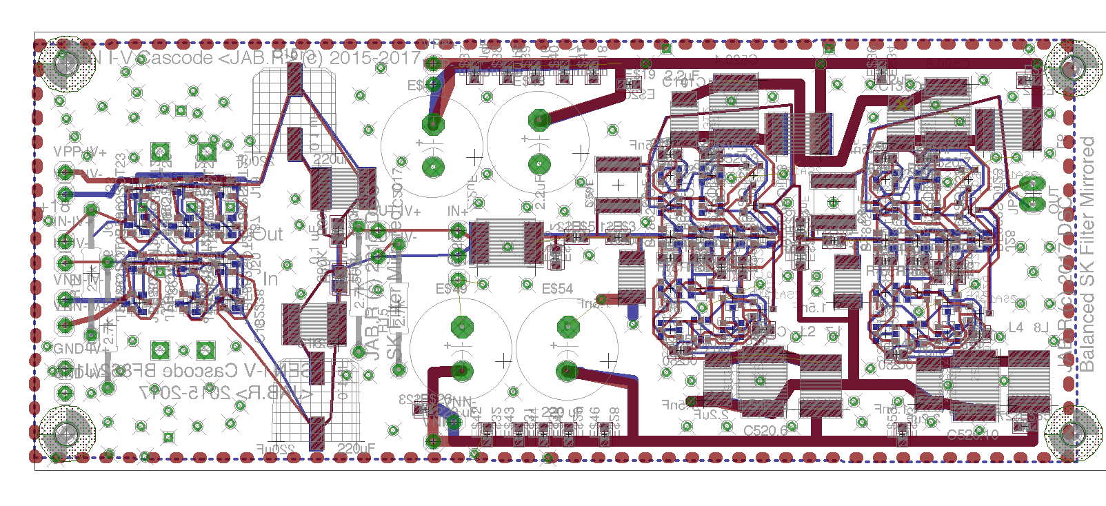

Balanced DSC Discrete SK filters
I've previously posted the Balanced digital section of the DSCx DAC with the clock optimized board. For the analog section there is an advantage to mirror. Here is a mirrored SK filter section using Wurcer's discrete JFET op amp cascoded with BJT devices. The low noise BF862 jFet is used. The advantage is that these devices are current production, inexpensive and low noise.
A two layered SMD board is used with +/- on either side of the board.
View attachment Wurcer Disc OPA.pdf
View attachment SK mirror.pdf
Not the final board but this is a Balanced, Discrete, Mirrored analog section. Probably can take out the coupling capacitor between the I-V section on the left and the SK filter on the right.
This looks very interesting! Any plans to build it?
Still finalizing the layout, but certainly.
Very neat! Looking forward to see how it works out, and definitely interested in trying them out.
