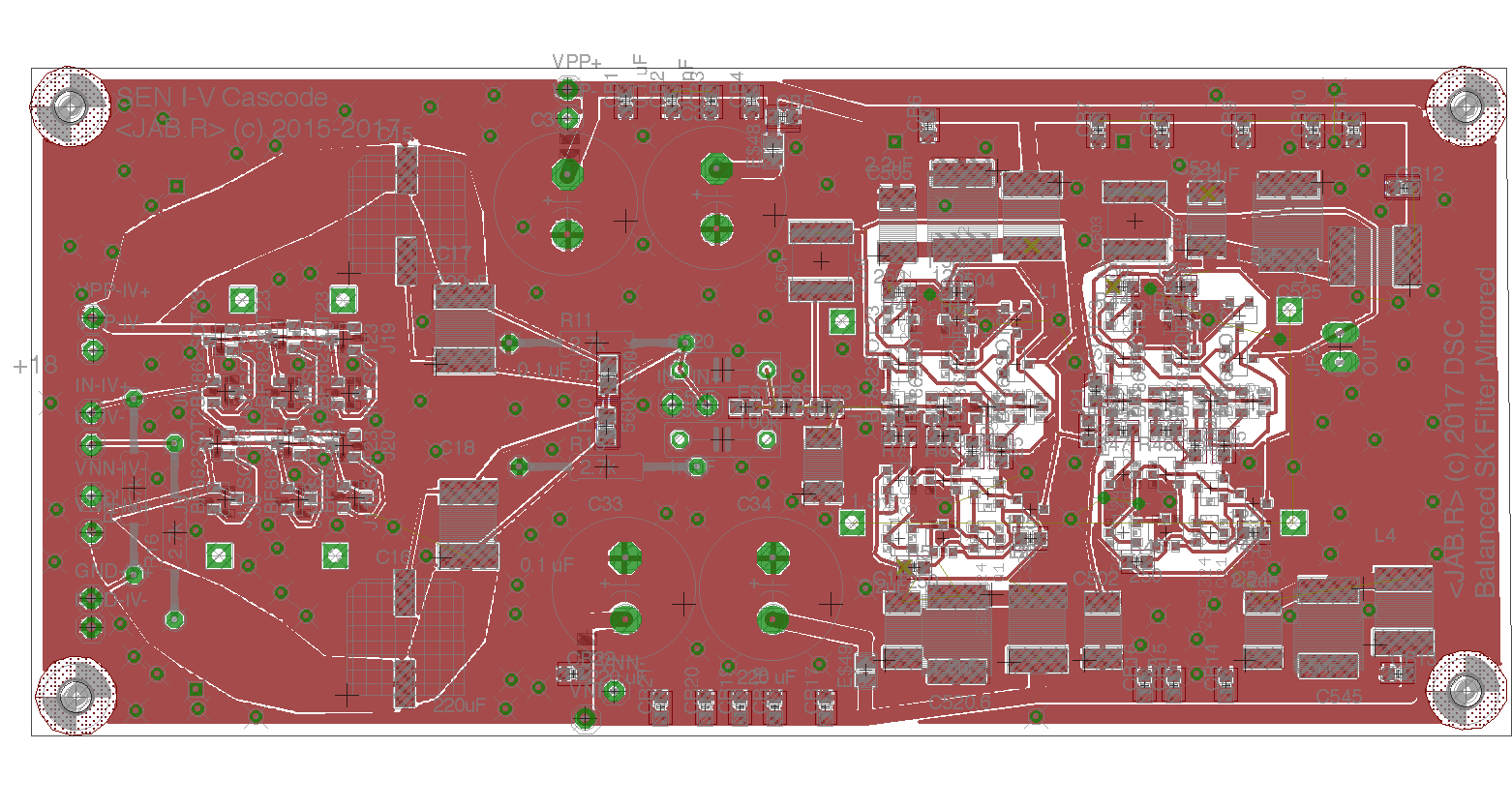

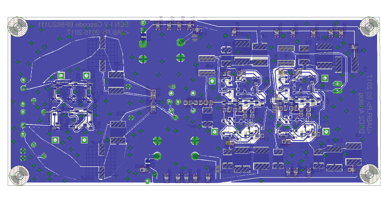

The balanced, mirrored, discrete cascoded JFet analog board:
OSHPark link to order boards (need 1/channel):
https://oshpark.com/shared_projects/TjK3dURD
This is the analog board which goes with the Balanced, Clock optimized DSC board -- I've posted this on this thread and also to OSH park.
Power, yes, each SEN I-V uses a floating 18V supply and the filter section prob +/-12-18V (doesn't require floating)
In the power supply section, I posted a floating supply circuit which I'm building for this but a couple of 9v batteries are fine for the IV section.
Since the design is fully cascoded and discrete the exact voltage requirements aren't entirely strict.

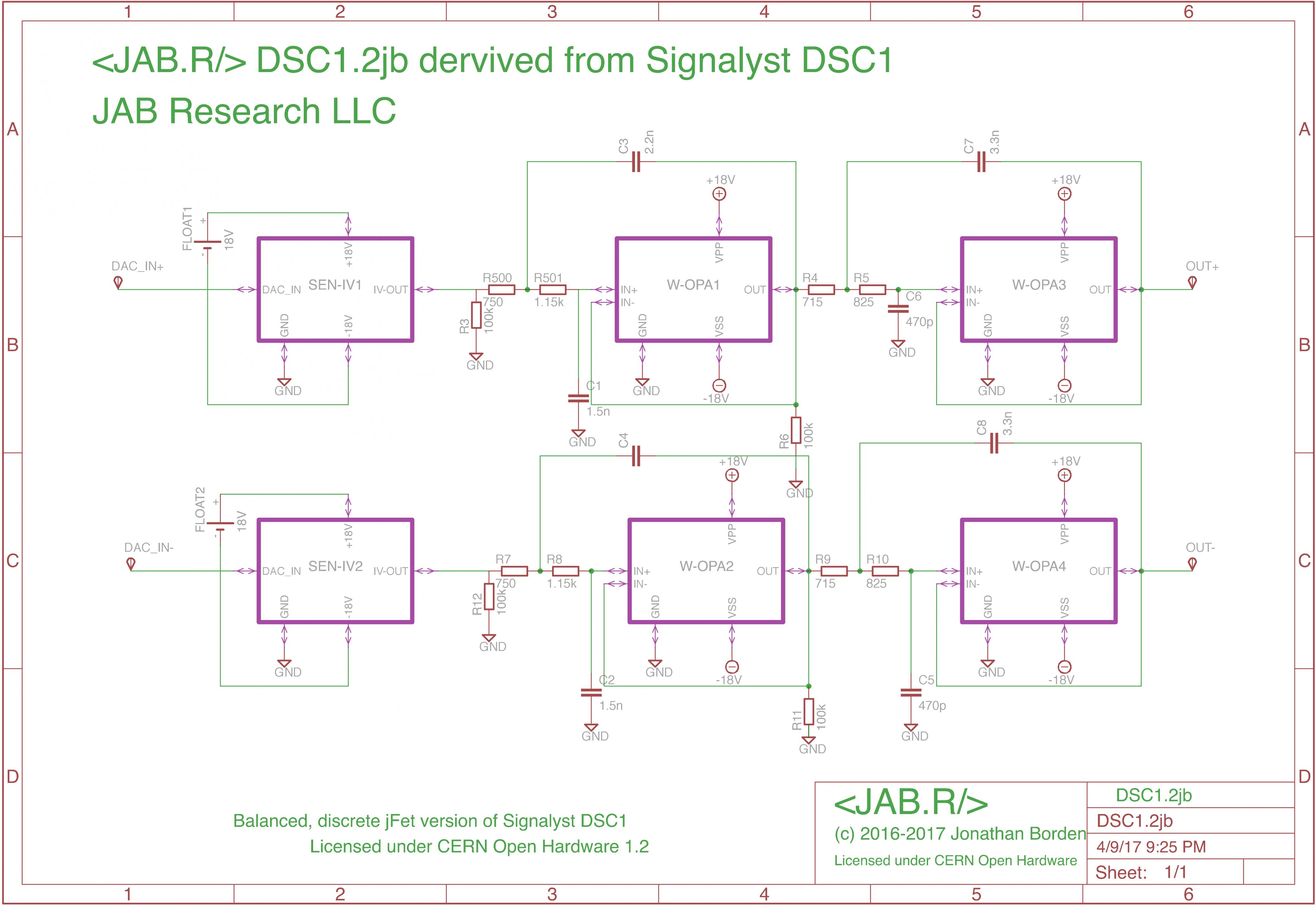

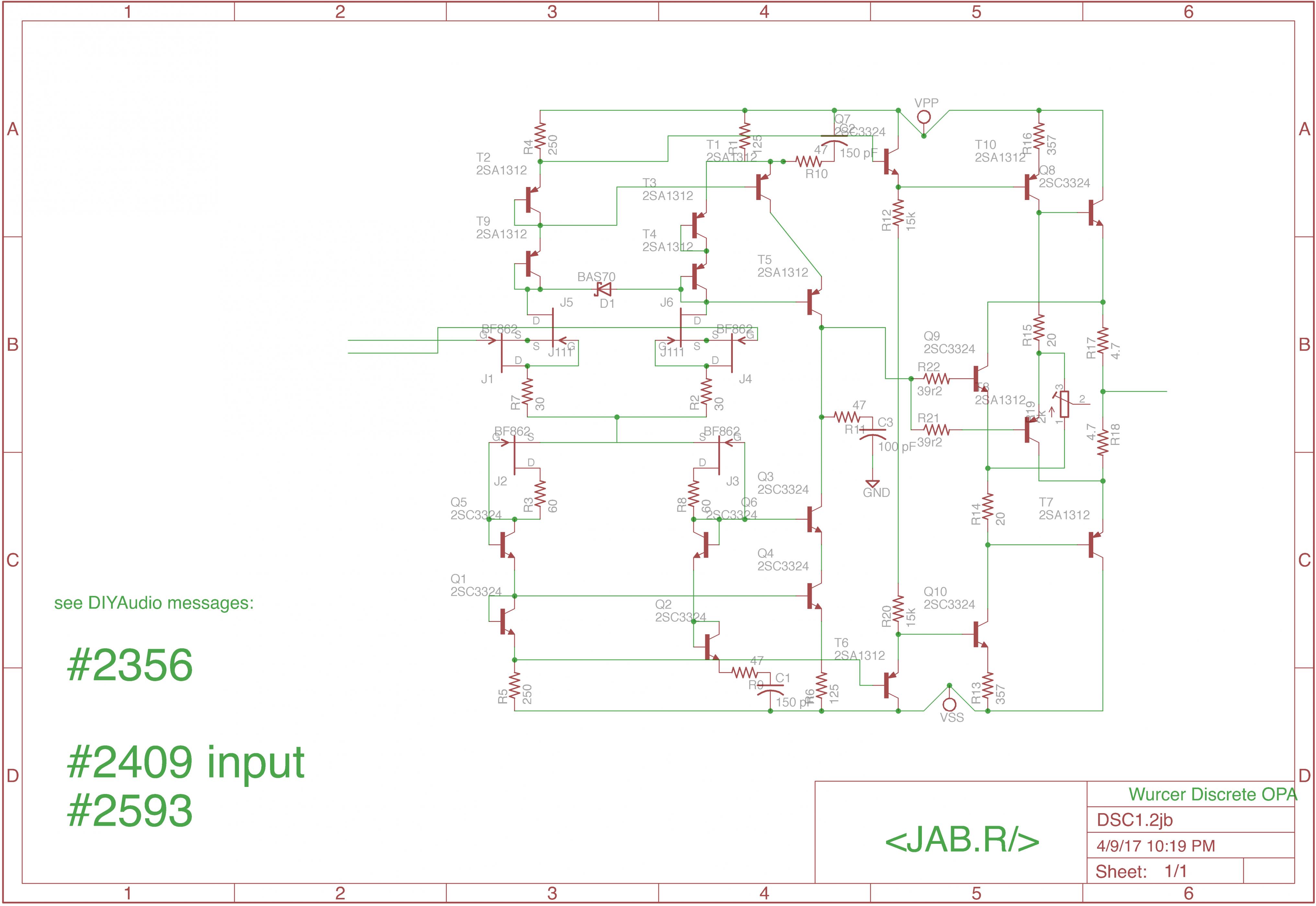

Hello @jborden
do you have the schematics?
Yes, certainly however due to the way I've done this, the part numbers on the board I've supplied do not match the schematic.
The overall schematic -- I'm calling this version DSC1.2jb to avoid confusion with DSC2 that Jussi Laako plans to release at some point in the future:

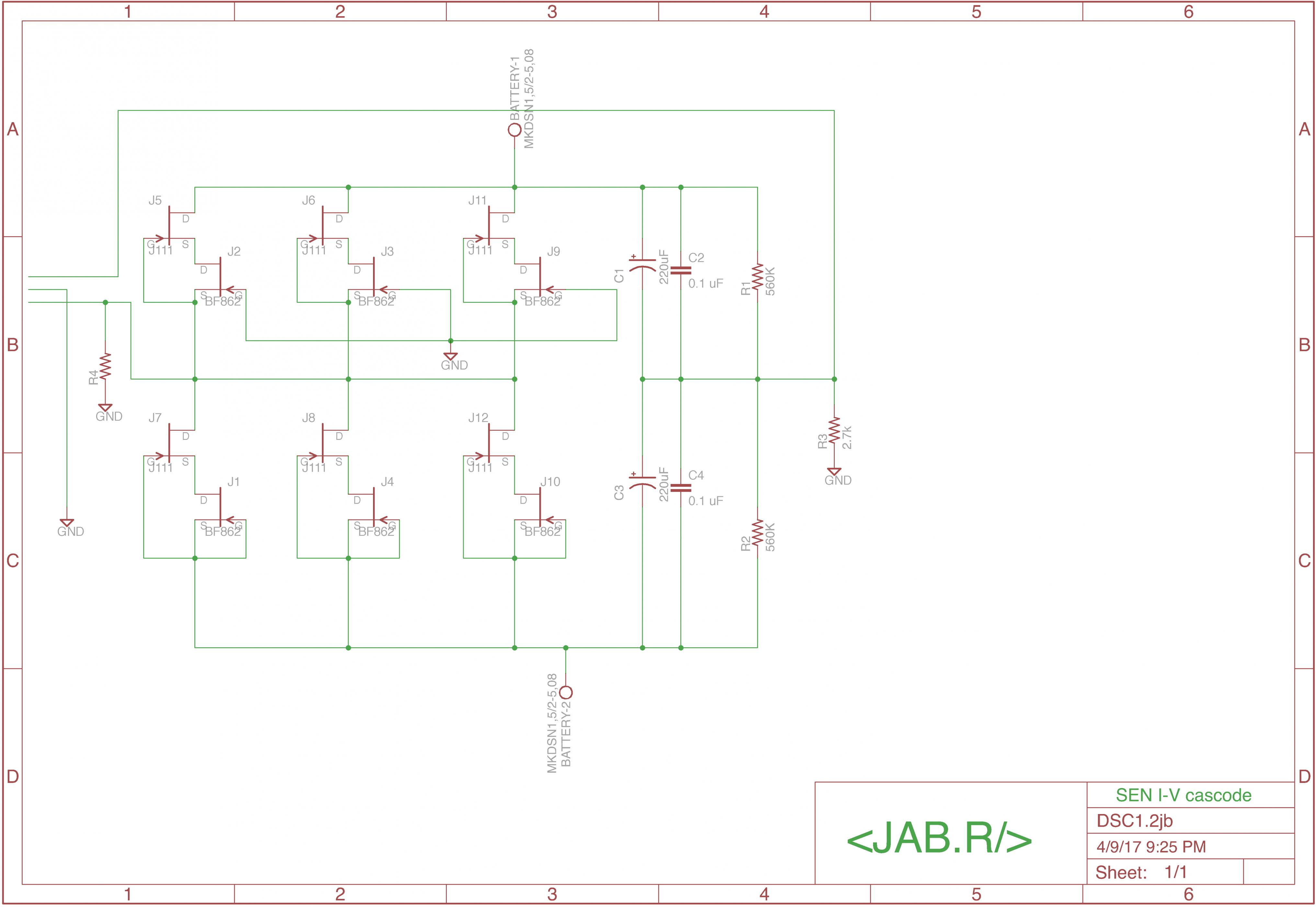

http://www.diyaudio.com/forums/digi...inimalistic-iv-converter-188.html#post4961030:
http://www.diyaudio.com/forums/anal...screte-opamp-open-design-236.html#post3279329:

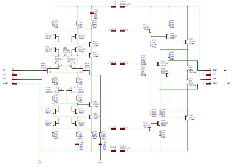

My goal was to "jFet" the DSC1. It actually measures great and I think a terrific basic design. So balance and mirror and discrete but stays true to the DSC1. Trying to give that jfet "sound"
In this version, the op amps have their own output section ... alternatively could build a simpler jfet op amp and then add an output section.
I'm using 2 9V batteries in series for testing purposes ... very easy.
I divided the circuit into a digital and analog section. That does allow folks to mix and match if desired. There are designs other than the DSC1 which don't include a FIR as well as modifications to the FIR. I haven't seen a good enough analysis about why that is preferable. I understand the FIR in the DSC1 and am using.
I am using one "exotic" resistor for the I-V Riv because that's a critical part.
In other cases I've selected SMD parts that I have. In many cases they can be substituted within reason. Likewise the OP amps have a wider supply range (being discrete and cascoded)

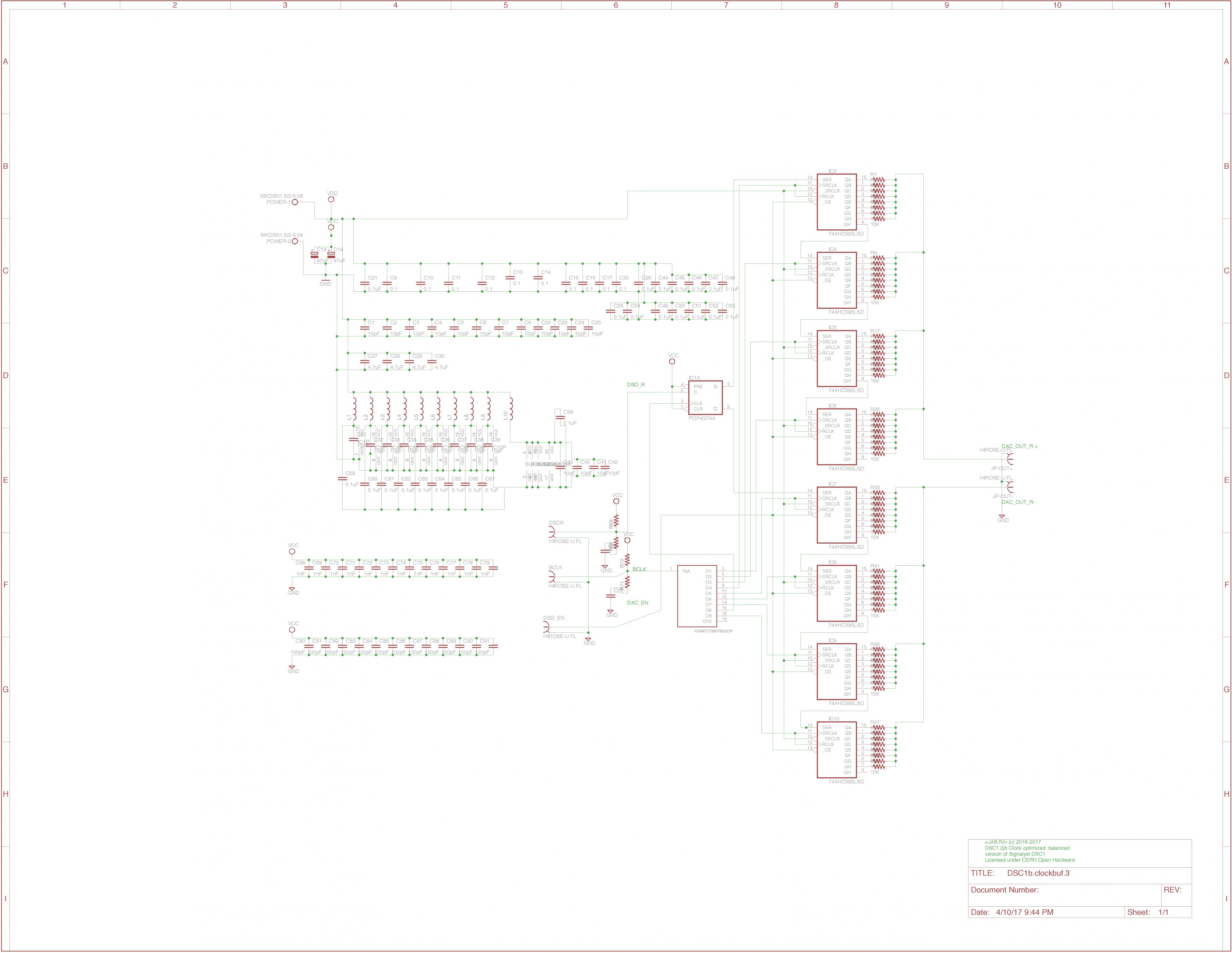

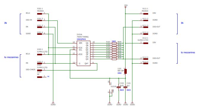

There is an error in my original schematic for the digital side (that doesn't affect the board layout) -- I mentioned that I'm using CMOS V3.3 and the potato semi clock buffer & d-flop : those are PO74G74A (d-flop) and PO49FCT3807B (clock buffer) as well as the AHC series (not AHCT) shift registers i.e. 74AHC595 -- these are the CMOS version
I will post a corrected version later
DSC 1.2jb Digital Section Schematic
The corrected schematic (doesn't change the posted board except for the changing the labels on the ICs: TTL->CMOS versions).
The 74AHC595 parts are rated for minimum 80 Mhz (typical 120Mhz) at CMOS levels, so we should be good for DSD1024 and possibly DSD2048. That should be fine four our purposed -- I am hoping to do 16 channels of DSD1024 if I can optimize the Ethernet -> DSD with my FPGA. Not that this is needed, nonetheless...

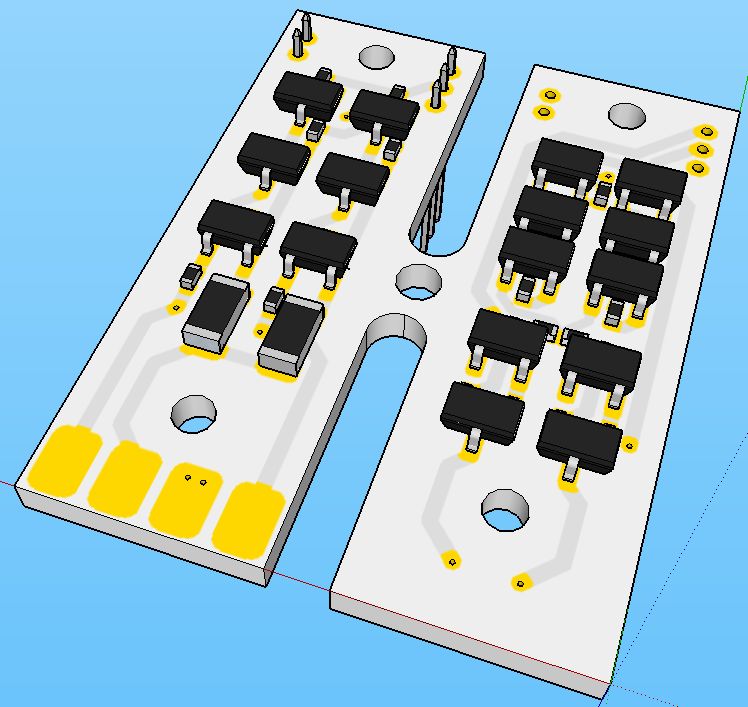

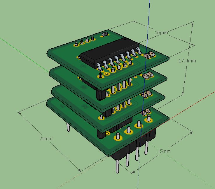

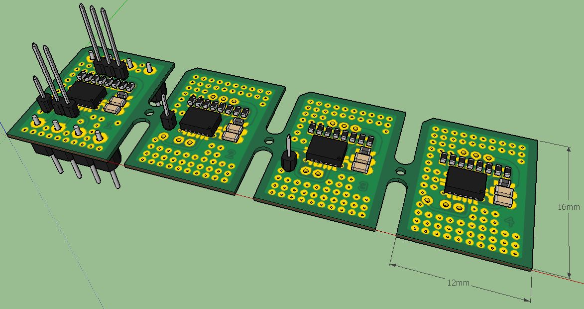

Last Version FIR32 bit:
- 0402 PANASONIC ERA-2A (8k06)
- DHVQFN16 74(AHCT, HC, HCT)595

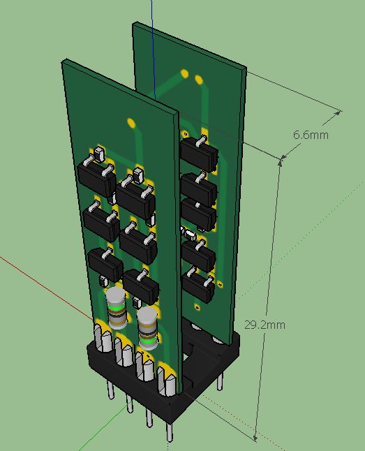

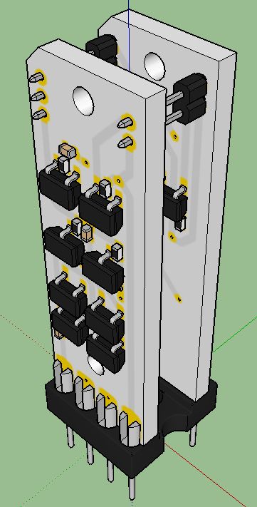

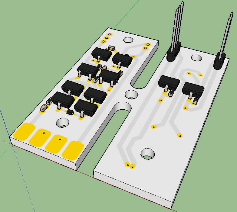

Braining about thermal coupling W-OPA... suggestions welcome: I´m thinking about 3 metal sheets and two PA 3D printed clips?
Today: SEN I/V second attempt (pinning like AD844)
JP
