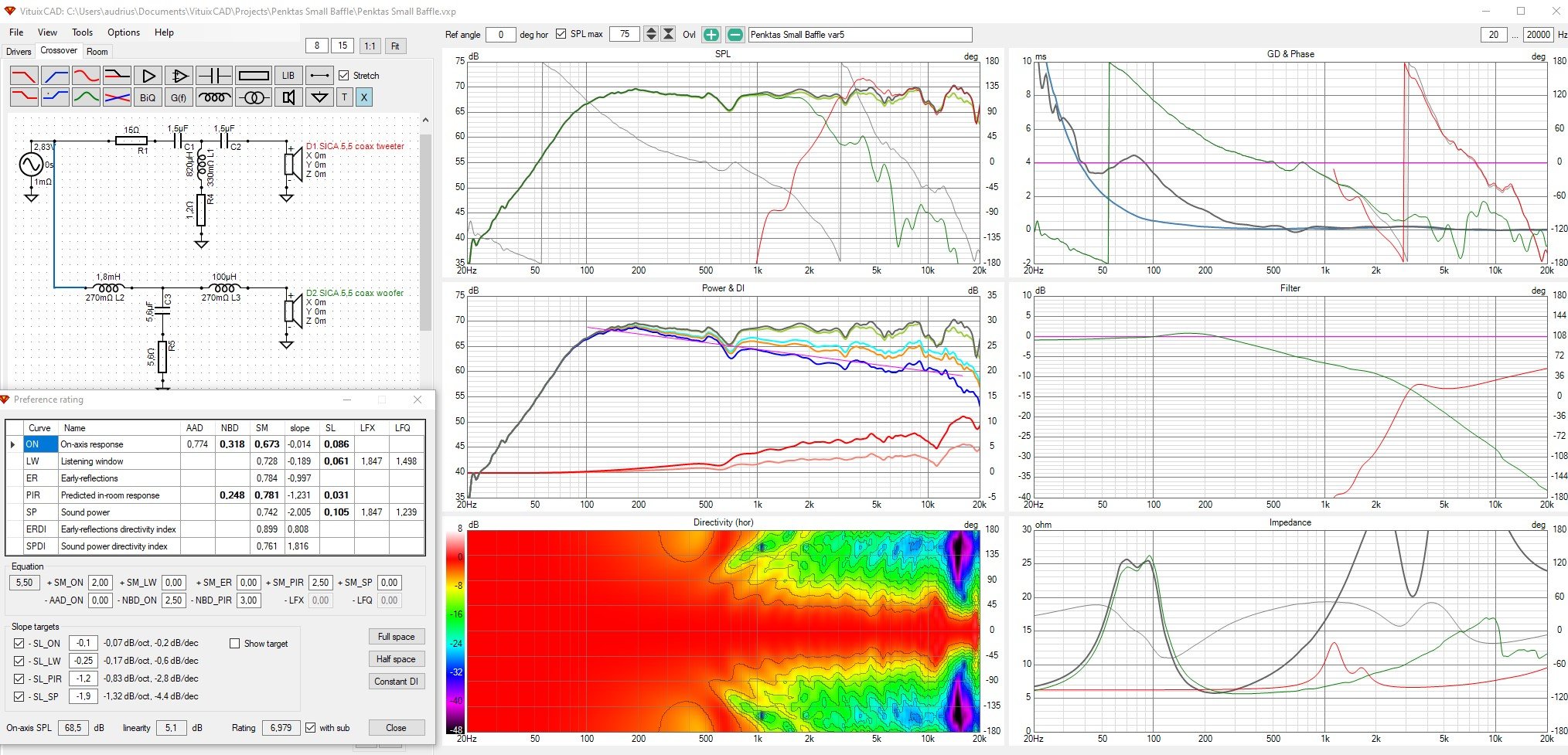

8l 60Hz does not look good, I would not use this tuning. I did mine in 5-6l, tuned below 60Hz. It was not 15W revelator kind of the bass, but it was enjoyable overall, I would not definitely call it "no bass below 200Hz". You may need more bafflestep compensation.

It is a picture from Vituixcad from your sim? I cannot get such curve as yours on 5-6L enclosure
Try 5l in your sims. The peaking will get flat.

Ok, I tried 5L sims: what tuning you recommend? 60Hz?It looks good with only ~70Hz and around it.
And another clarification - yes, I know the peaking is kind of bad, but the idea is to get some bass from it. I always thought that ~2dB "peak" is not much to worry about. It will be even less after some minor stuffing. I have built some projects with such simulated peaks - they are not troublesome IMHO. Do this peak impact some other sound qualities in lower freq (with this driver)?

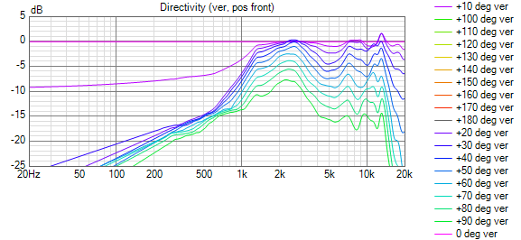

Two other alternatives for baffle/diffraction simulations are Edge (Tolvan) and Boxsim.
Both have been around for a very long time.
They all offer quite similar results, so it might just come down to which workflow and interface you prefer.
To get enough baffle-step as well as diffraction information, 1 meter is basically the minimum.
Is that "1meter plus" because of the a) wavelengths, b) wavelength/room dimensions ratio or c) distance to the mic and baffle width ratio?
For example: if my baffle is ~17cm width will I get more accurate results at 1m than if my baffle is ~34cm.
Yeah technically this distance depends on the width of the baffle, since the time difference between the source and baffle edge will change.Is that "1meter plus" because of the a) wavelengths, b) wavelength/room dimensions ratio or c) distance to the mic and baffle width ratio?
Even the size of the source matters.
You can get a decent idea by just simulating this.

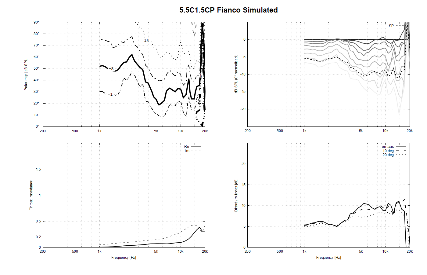

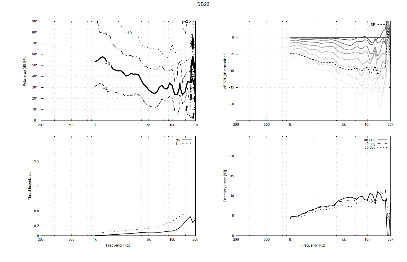

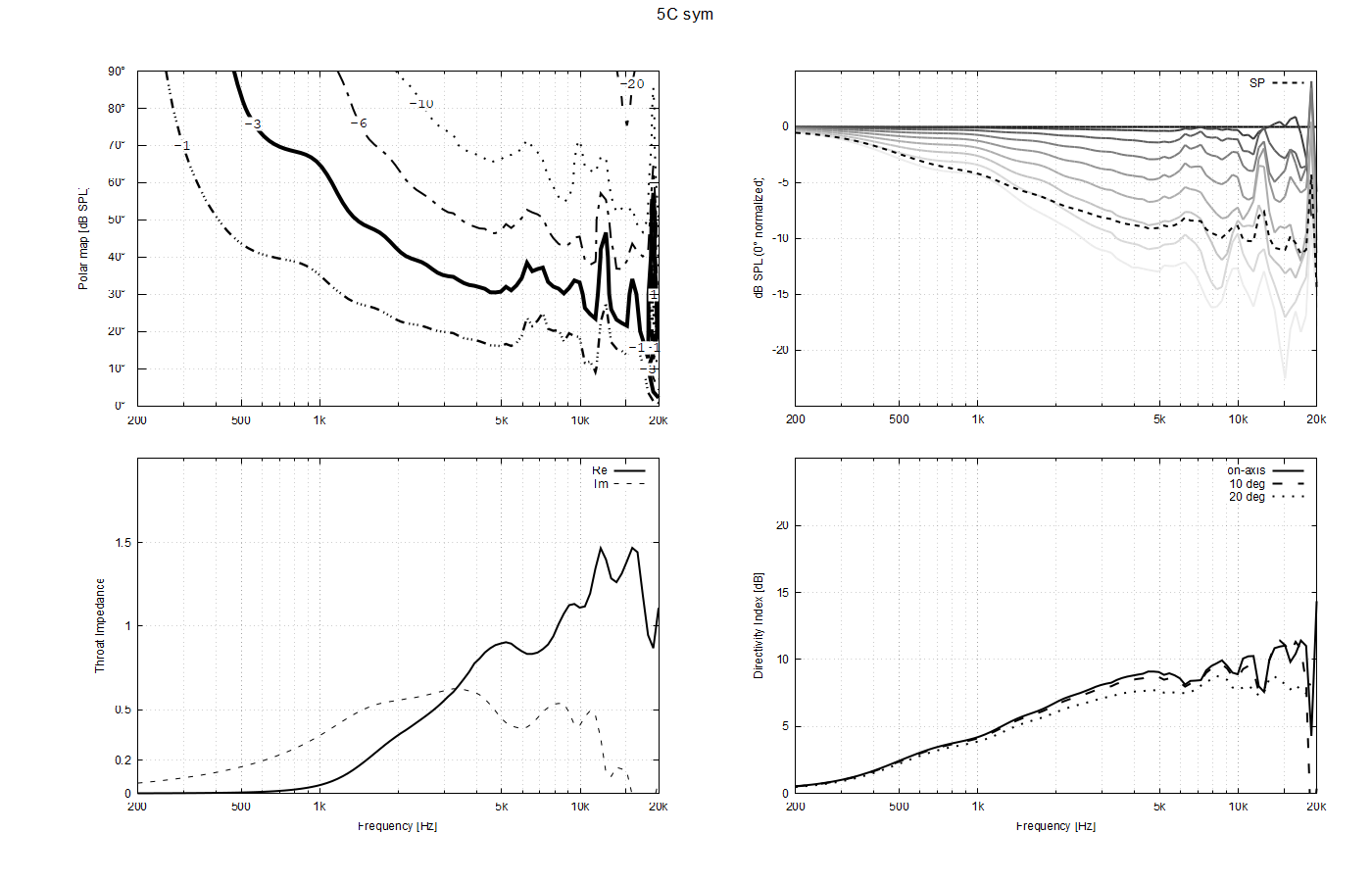

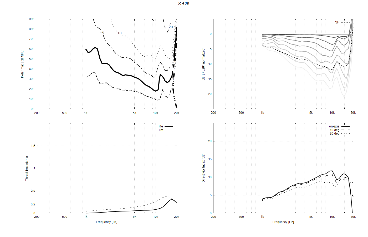

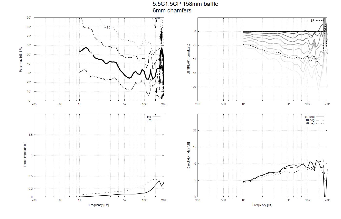

I emailed Sica out of curiosity and they kindly sent me some CAD files for the 5.5C1.5CP and the 4C1.5CP. I replicated the profiles into an Ath4 script and the results are pretty cool. I "validated" the sim by comparing directivity with the Donhighend Fianco build, and it seems to match very well.
Looking at the curved profile of the surround and the basket, it's pretty obvious to use a very narrow baffle to minimize diffraction, and as always, with a fair amount of roundover or chamfer. Just a 6mm chamfer with a 158mm wide baffle seems to almost completely remove the diffraction around 2-3kHz. I almost feel bad about all the builds hardly paying any attention to this.
Also made an axisymmetric sphere-like enclosure with a roughly continuous profile. I think a KEF-like flange covering some of the surround might help with the funk around 8kHz or so, as the innermost accordion kinda protrudes from the overall profile - will sim further
Only tried the 4C quickly in a small enclosure - couldn't make IB work for some reason. Seems pretty decent as well, I don't care much about the top octave

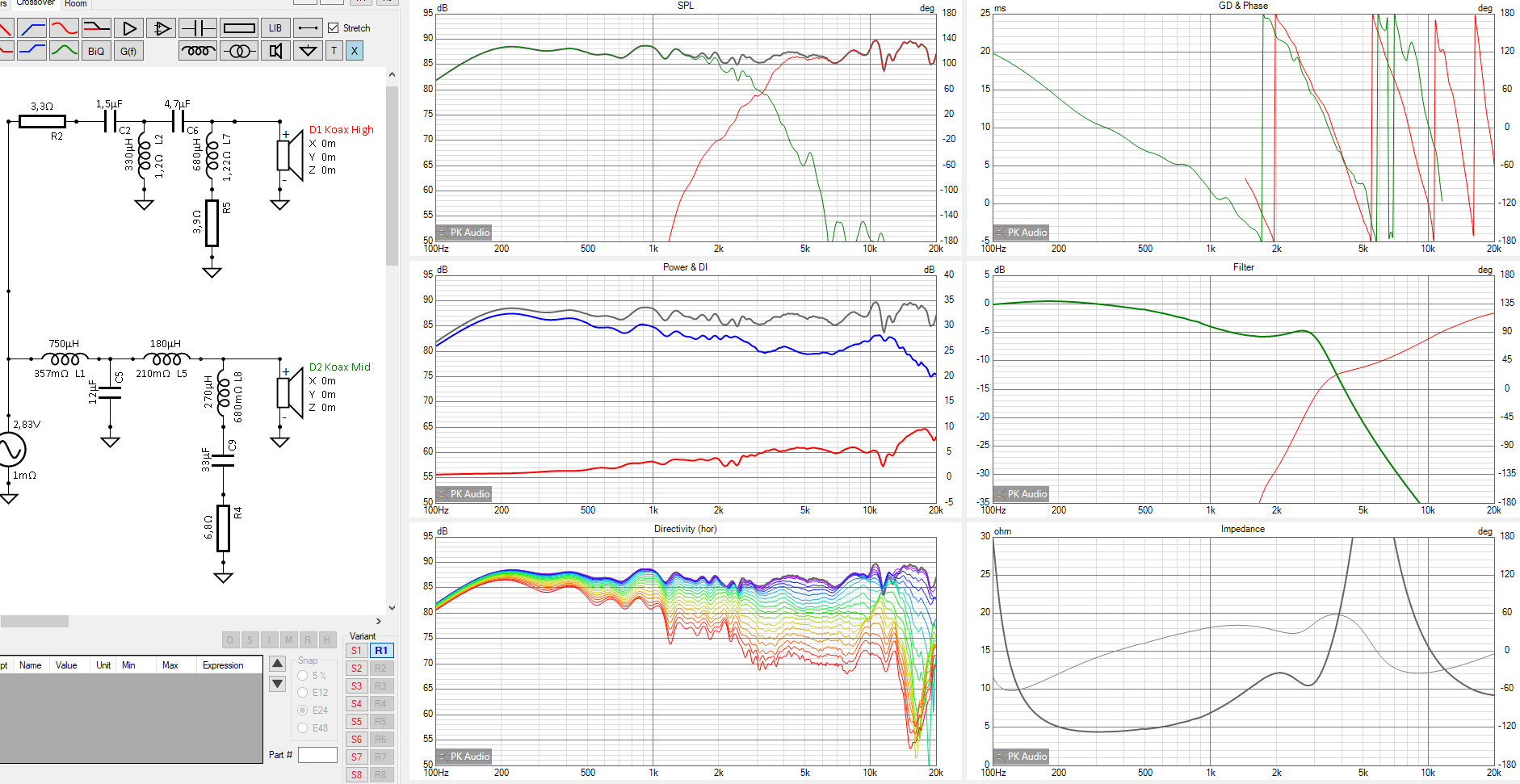

My results. BR ~7.7L (not including the vent), tuned to ~59Hz, with some stuffing, probably ~100g. Custom 3D printed baffle. Will try to make even smaller box with a bit higher tuning. Below my rookie builder opinions and screenshot. Critique is welcome.
Currently listening from PC with EQ APO virtual crossover, from passive elements only, with convolver export from VituixCAD, measurements for simulation done with Sonarworks calibrated mic, which I trust more or less, 15 degree steps only in horizontal impedance - with simple 100Ohm "rig". I feel I am 90-95% of what can be squeezed from this driver as 2-way system with reasonable crossover. Next step is for me to measure it again and to build real crossover.
Pros:
-Good driver. Hifi. Worth building a project. Not something in between. Well built, heavy, strong. Survived couple of drops from 1-1.2m heights while in test box... (facepalm) - will not survive if membrane is touched.
-Good looking - already mentioned. Will repeat, as it looks as if has some designer pedigree
-Detailed on a very broad range - lows, mids, highs.
-Pretty pleasant timbre. On the warmer side, still a bit too sharp/detailed for late night listening.
-In the nearfield it is a true coax experience: on some songs I even start to look at the driver to check if there is really someone playing inside the speaker?Daft Punk RAM sounds so cozy and good with it. This is probably one of the first times, when I look with eyes into mono playing speaker and try to locate... synthesizer
-Can make pretty flat SPL response with reasonable x-over. Screenshot attached.
-For those measuring sound quality in numbers, it is possible to squeeze a score of 7.1-7.2 Mr. Saunisto-VituixCAD coefficient with some tuning and a bit more complex passive xover. I stopped at ~6.9 (~7.05 on 10 and 20 degrees hor), because want simplicity, little BBC dip and some other personal preference. Screenshot attached.
Cons:
-Very VERY sensitive to small changes in (virtual) crossover. For example in one step in some element from 1.2 to 1.5uF or vice versa, or even smaller - you can get unlistenable sound. One small change in resistor - also.
-Very VERY sensitive to small changes in baffle size and shape - again from "wow, how good it sounds" to "smth is VERY wrong " only 3-5cm, even if it is rounded and 3D printed in both cases. My advice from personal preference is narrow very rounded baffle for this project.
-Midrange from 1-4kHz is hard to simulate: couple dB too high, and the speaker is unlistenable, couple of dB too low - it sounds extremely boxy. Personally think there is very narrow window where it sounds right/neutral.
-Little bass. It plays more like 4.5inch speaker. I tried to build bigger box, but the quality suffers, probably will get limited by excursion very soon. Need some 2.5 with other SICA non-coax 5inch or proper 3-way for primary system. Don't get me wrong, for a bookshelf or tabletop speaker it is MORE than enough. Subwoofer crossed to 100-120Hz will solve most of the deficiency problems.
-Woofer SPL needs to drop fast past 3-3.5kHz, as sound above gets distorted a lot, you can hear with ears without measuring, so need pretty aggressive filter.
Ignore this measurement thing of ~600Hz, this is because of the stand. The baffle is custom. You will get very different results in ~1-3kHz, the region which is very sensitive for this driver.
Comments are more than welcome
