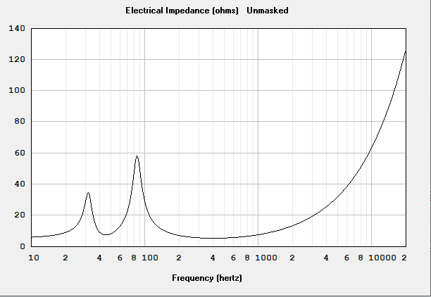

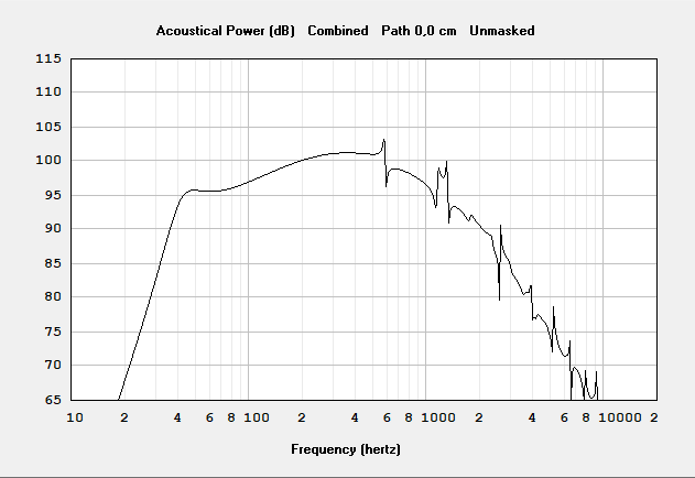

I just got a dedicated 4 channel amp with very flexible DSP settings. After blocking one of the ports and with some careful heavy eq'ing in the DSP I really enjoy these little cabs. Very deep bass for a 5.5". Again this is with heavy DSP eq'ing. In the original simulation I was clearly not getting what I was hoping for with both vents, glad I had the possibility to block one.Just listening to my own design with the 5.5c, sounding awesome. They are bi-amped using my Line 6 HX stomp as DSP. I'm experimenting with delay and I think I like .4 mS delay on the tweeter. Thanks for streering me to these coaxials.
One question: does this electrical impedance chart indicate a slightly under-sized cab? I was under the impression that if both peaks reach about the same amplitude the cabinet size is balanced to the driver. Might explain why I need rather heavy eq to get the bass I was hoping for out of the speakers.
The cab is:
8.5 internal liters total (incl port)
0.4 liter round port, 26 cm deep 4.5 cm diameter.
Amp is https://www.thomann.de/se/the_t.racks_dsp_4x4_mini_amp.htm
I don't think so, it just indicates a low tuning. that makes sense for a downward sloped bass rolloff.does this electrical impedance chart indicate a slightly under-sized cab?
Cannot answer other questions, only can add to them, as want to see full your config, but... For me ~3,6cm diam port is adequate. Maybe 4cm is the upper limit, as there is not much turbulence when used at the nearfield levels. I use smth like 55-65Hz tuning, still haven't firmly decided which sounds best, yours is... ~43Hz, I think this is overkill for this driver. But have no idea about your DSP settings
EDIT: oops, with port volume included probably ~45Hz?
